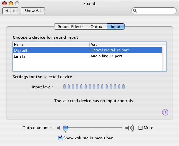

dexthageek Posted September 9, 2006 Share Posted September 9, 2006 Here is a screenshot of my Input Options I do not know if they are working... I will try them in alittle bit and see if they work. Edit* I tried both Digital In and Analog Input and both of them work. However I could not hear it directly to through speakers. I probably am doing something wrong. But what i did do was hook up a CD player through both Analog and Digital connections and used Audacity to record a quick wav file. So does Audio Input work...YES it does indeed work. DeX Link to comment https://www.insanelymac.com/forum/topic/5064-alc880-audio-works/page/7/#findComment-184887 Share on other sites More sharing options...
Rene204 Posted September 9, 2006 Share Posted September 9, 2006 wow, i dont have audacity, but did you have seen a signal on the input-levelmeter? can you adjust the level of input? have tried it with a cd-player too, but got no sound in.... Link to comment https://www.insanelymac.com/forum/topic/5064-alc880-audio-works/page/7/#findComment-184906 Share on other sites More sharing options...
dexthageek Posted September 9, 2006 Share Posted September 9, 2006 If you goto System Preferences -> Sound -> Sound Input click on DigitalIn there is no Input on Volume digital control because its a true digital signal. However, I did see the Input Level meter change as the sound was produced. Not sure why the audio didnt just loop through to the speakers but Audacity picked up the signal and I was able to record a quick sample and play it back through the speakers. Ultimately i would love to get my keyboard hooked up to my machine for midi and sound editing. here is a link to Audacity its a free download. http://audacityteam.org/mac/ Link to comment https://www.insanelymac.com/forum/topic/5064-alc880-audio-works/page/7/#findComment-184912 Share on other sites More sharing options...
Rene204 Posted September 9, 2006 Share Posted September 9, 2006 hm... my levelmeter shows no audiosignal.... equal on spdif or line in. i will try with audacity. ok, have tested it. but no sound in, maybe because we have the Realtek ALC882-Chip. Go to Start, you got no 4000$, and have to search from the beginning.... Thanks for Your Help..... Link to comment https://www.insanelymac.com/forum/topic/5064-alc880-audio-works/page/7/#findComment-184914 Share on other sites More sharing options...

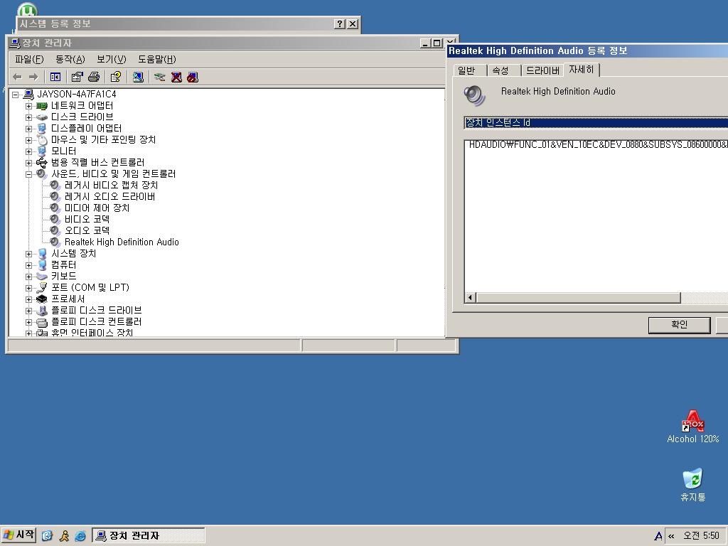

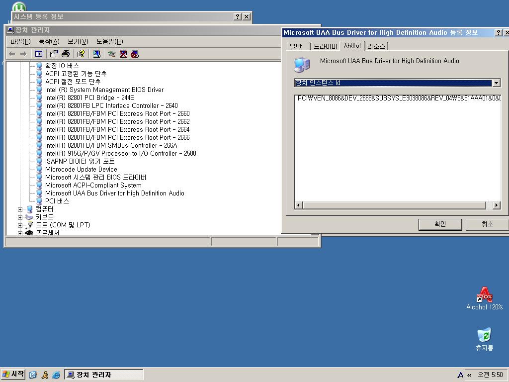

Rammjet Posted September 14, 2006 Share Posted September 14, 2006 When I do a Google on your motherboard, the Intel website says you have ALC860 audio, not ALC880. http://www.intel.com/products/motherboard/d915gvwb/index.htm When you did the vendor id/device id check, what did it say? Link to comment https://www.insanelymac.com/forum/topic/5064-alc880-audio-works/page/7/#findComment-188370 Share on other sites More sharing options...
jtekky Posted September 14, 2006 Share Posted September 14, 2006 nothing it went smooth.. im reinstalling mac os x... because on my pc vendor and device id i got 10ec and 0880 and for the hd i got 8086 with dev2668... Link to comment https://www.insanelymac.com/forum/topic/5064-alc880-audio-works/page/7/#findComment-188376 Share on other sites More sharing options...
Rammjet Posted September 14, 2006 Share Posted September 14, 2006 nothing it went smooth.. im reinstalling mac os x... Huh? When you followed the Appendix in the ALC882 guide, part A had you look up a vendor id and device id for the audio codec. It should have had a device id of either 0860 or 0880 which is used in the first set of numbers you replace. Then part B gets the vendor id and device id of the controller, which is used in the second set of numbers you replace. What device id did you get for part A, 0860 or 0880? Link to comment https://www.insanelymac.com/forum/topic/5064-alc880-audio-works/page/7/#findComment-188380 Share on other sites More sharing options...
jtekky Posted September 14, 2006 Share Posted September 14, 2006 0880... so that is where it went wrong? because all this time when i go into windows and look up those 2 vendor id and device i kept gettin 0880 ... Link to comment https://www.insanelymac.com/forum/topic/5064-alc880-audio-works/page/7/#findComment-188383 Share on other sites More sharing options...
Rammjet Posted September 14, 2006 Share Posted September 14, 2006 because on my pc vendor and device id i got 10ec and 0880 So, any possibility you misread it? Why would Intel report it as 0860 - they should know? Link to comment https://www.insanelymac.com/forum/topic/5064-alc880-audio-works/page/7/#findComment-188385 Share on other sites More sharing options...
jtekky Posted September 14, 2006 Share Posted September 14, 2006 well because from my driver cd that intel provided me with wouldnt install the sound, so i went to realtek.com and downloaded it and installed and worked fine... i dont know.... but after im done installing a new copy of mac os x i should put 0860 and how about on the other string? change it to 2668? or to the one you provided on your thread? and thank you... Link to comment https://www.insanelymac.com/forum/topic/5064-alc880-audio-works/page/7/#findComment-188392 Share on other sites More sharing options...
Rammjet Posted September 14, 2006 Share Posted September 14, 2006 but after im done installing a new copy of mac os x i should put 0860 and how about on the other string? change it to 2668? or to the one you provided on your thread? You need to use the numbers you get from Device Manager in Windows. Because when the OS quizzes the hardware and it gives a number, that number has to be in the kexts in order for it to work. Link to comment https://www.insanelymac.com/forum/topic/5064-alc880-audio-works/page/7/#findComment-188393 Share on other sites More sharing options...
jtekky Posted September 14, 2006 Share Posted September 14, 2006 ok ill post a screenshot of my pc... with the device and vendor id.. Link to comment https://www.insanelymac.com/forum/topic/5064-alc880-audio-works/page/7/#findComment-188418 Share on other sites More sharing options...
jtekky Posted September 14, 2006 Share Posted September 14, 2006 here you go~ Link to comment https://www.insanelymac.com/forum/topic/5064-alc880-audio-works/page/7/#findComment-188429 Share on other sites More sharing options...
