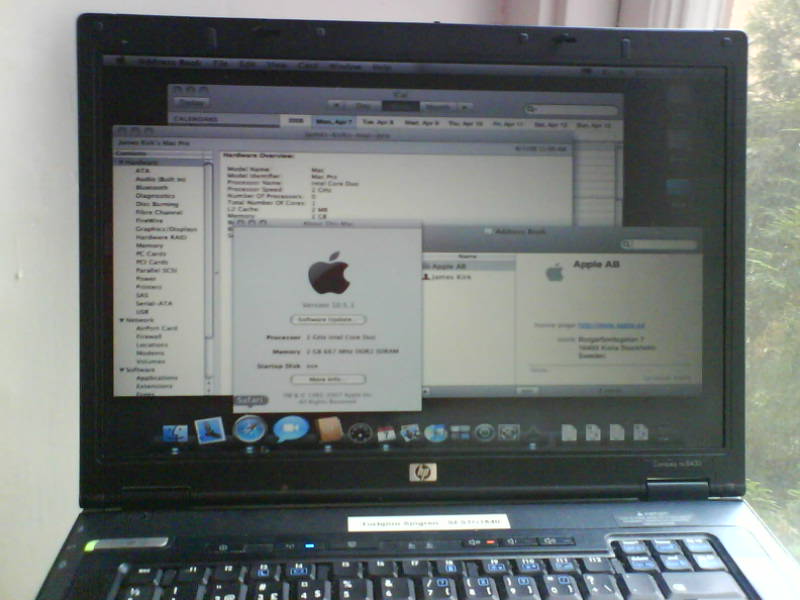

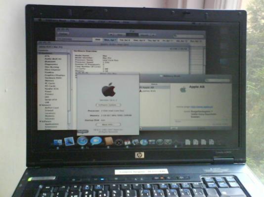

Dr.Tobbe Posted April 6, 2008 Share Posted April 6, 2008 HP Compaq nc8430 with Kalyway Leo 10.5.1 working combination: Install: CPUS=1 in BIOS, plist or prompt. Use MBR in partition options. Kalyway customizations: For Ethernet: HP_NX9420_AppleBCM5751Ethernet.kext.zip For ATI X1600: hpnx9420_atix1600mob_atiinjectkexts.zip 10.5.1: Many thanks to all driver producers, you are great! Link to comment https://www.insanelymac.com/forum/topic/46150-hp-nc8430-just-acquired-need-to-complete-experiences-here/page/2/#findComment-699025 Share on other sites More sharing options...

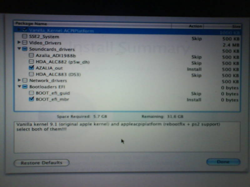

Sc00byy Posted April 18, 2008 Share Posted April 18, 2008 Hello guys, I have a nc8430 too and I did some testing in the last few days to know if this laptop can run correctly OSX. By this message, I want to share with you my overal experience with setuping a nc8430 with OSX. I will go through my entire setup to help everyone who wants to give a try to OSX. First my partitionning is like this: 1st primary: Windows XP Pro (NTFS) 2nd primary: Kalyway Leopard 10.5.2 (HFS+) Extended: One big NTFS for data share between OS I went into some trouble to be able to create my HFS+ partition using Diskutil in Leopard. Instead, I used PartedMagic 2.1, this open source program base on gparted is able to create HFS+ partition. Dual boot setup is done using XP OS loader. To be able to get this working I added to my boot.ini the following "C:\chain0="OSX86". After, I got a copy of chain0 from the wiki. No need to use any 3rd party OS loader. Added the following kexts: Graphic: hpnx9420_atix1600mob_atiinject.kexts Note: No more video glitch. Full video support (1680x1050) Network: HP_NX9420_AppleBCM5751Ethernet.kext Sound: AppleAzaliaAudioADI1981_Installer.v2.zip Note: This new installer enable the sound perfectly. Still some work to do, because for now, headphones and mic doesn't work. Bios Settings : Dual cpus = ENABLE Virtualization = DISABLE To be able to boot correctly with dual cpus enable, I changed my boot configuation by editing the following files com.apple.Boot.plist Just added CPUS=1 under Kernel flags. To be able to install OSX I disabled the dual cpus flags in bios and re-enabled it once I changed my Boot.plist. BCM5751 kext doesn't load automaticaly with 10.5.2. So, I added "kextload /System/Library/Extensions/AppleBCM5751Ethernet.kext" in /etc/rc.local to be able to have my network card active automaticaly. For now, this setup is working but is unstable for some unknow reason yet. I will investigate further next week. Maybe one kext is causing some issue. Current issue to fix : - Stabiltity - Dual screens (doesn't work even if second screen is attached before booting) - Sounds (headphones, mic) Link to comment https://www.insanelymac.com/forum/topic/46150-hp-nc8430-just-acquired-need-to-complete-experiences-here/page/2/#findComment-714106 Share on other sites More sharing options...
Sc00byy Posted April 22, 2008 Share Posted April 22, 2008 Bios Settings :Dual cpus = ENABLEVirtualization = DISABLETo be able to boot correctly with dual cpus enable, I changed my boot configuation by editing the following files com.apple.Boot.plistJust added CPUS=1 under Kernel flags. To be able to install OSX I disabled the dual cpus flags in bios and re-enabled it once I changed my Boot.plist.This trick doesn't seem to work. I tried to disable dual cpus in bios and now everything runs smootly. No glitch, with stability. Current issue to fix :- Stabiltity- Dual screens (doesn't work even if second screen is attached before booting)- Sounds (headphones, mic)Stability is fixed if I force in bios to run only on one cpu.Dual screens need more work to be fully workingSounds still lacking of major updates to get headphones and mic working. thevoiceover: Can you post your boot.plist?How come some people can't get dual core working, unlike thevoiceover? Is it a question of which version you use, Tiger or Leo?Maybe the bios version has something to do with it. If voiceover can give us his firmware version of his bios this can help to understand our issue.On my side i'm running F.15 and I can't have both cores working Link to comment https://www.insanelymac.com/forum/topic/46150-hp-nc8430-just-acquired-need-to-complete-experiences-here/page/2/#findComment-719888 Share on other sites More sharing options...
