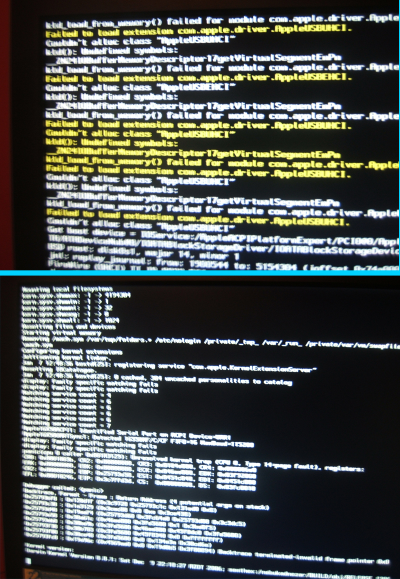

se1zure Posted January 7, 2007 Share Posted January 7, 2007 (edited) NOTE: Appearently when i boot using -v, the error is: The main thing it said was: "Failed to load Extension com.apple.driver.AppleUSBUHCI." IF that makes sense to anyone. I installed the new Jas 10.4.8 on my sata hard drive (complete install, on a blank hard drive). The install goes fine, and then, when I try to boot, it getsz tot eh gray apple screen, and then fades dark, saying "Mac OSX needs to restart" in several languages. I have tryed everything I can think of, can anyone else help me, or walk me through what I need to do, and if need be, a complete re-install. Please, if anyone can help, that would be great. I would be wiling to paypal somone some money if they can completely solve my problem, and have me result in a working osx. A video of what happens when I try to boot osx...: http://www.youtube.com/watch?v=feZSUmaWMzo it may take a moment, as I just uploaded it a moment ago, and you tube needs to refresh the page. My procedures of installation: I did NO OTHER STEPS than the ones listed below. 1) I got a brand new, 250gb, sata Samsung Hard Drive. 2) I formatted the drive using fat32 3) I downloaded the JAS install image 4) I used nero to burn this to a dvd iso disk 5) I took out all other hard drives from my computer. 6) I put int he Samsung drive. 7) I put int he disk into the dvd drive. 8) I rebooted the computer, and booted from the dvd. A Mac osx install "os" live cd-style thing opened. 9) i opened up the disk utility app in the mac install 10) I partitioned the entire drive using mac os journaled 11) I proceeded to install mac on the entire drive, using custom install, checking x11, unchecking the languages, and printer drivers, and checking the intel portion, unchecking the amd portion. 12) I let the install finish. Then I restarted my computer. 13) It boots form the mac osx hard drive (the samsung one), and the apple logo comes on the screen. THen teh screen dism, and the restar osx error comes up. My Hardware Core 2 Duo e6600 on stock cooling etc. Asus p5w Dh Deluxe Mobo 2 x 1 gb XMS corsair ram ati radeon ati radion powercolor x1950 pro GPU XCLIO GoodPower 500w PSU Screenshot of boot using "-v" Edited January 8, 2007 by se1zure Link to comment https://www.insanelymac.com/forum/topic/37966-trying-to-install-osx86-wont-boot-will-pay-for-help/ Share on other sites More sharing options...

se1zure Posted January 8, 2007 Author Share Posted January 8, 2007 Here are the erros it spits out: There is a photo of the screen. I'm assuming the errors it finds are the things in yellow. The main thing it said was: "Failed to load Extension com.apple.driver.AppleUSBUHCI." whatever that means. If you could help me figure out what to do, that would be great. Link to comment https://www.insanelymac.com/forum/topic/37966-trying-to-install-osx86-wont-boot-will-pay-for-help/#findComment-270789 Share on other sites More sharing options...

Mr Malicious Posted January 8, 2007 Share Posted January 8, 2007 (edited) It looks like the link load errors are from older kexts trying to run with the kernel.Not idea why your getting this,unless A. somehow the 10.4.8 intel combo wasn't checked off and you thought it was. B.somehow the combo update didn't install even though you checked it. C.The 10.4.8 combo update doesnt update that kext and the symbols for it are left out of the new 10.4.8 system.kext If you can, I would try for now disabling usb support in the bios just as a test to see if you get it to boot past this point. Also if you have any other kexts with undefind symbols please post info on that also. P.S:This Advice is free,no need to send money Edited January 8, 2007 by Mr Malicious Link to comment https://www.insanelymac.com/forum/topic/37966-trying-to-install-osx86-wont-boot-will-pay-for-help/#findComment-270897 Share on other sites More sharing options...

se1zure Posted January 8, 2007 Author Share Posted January 8, 2007 Okay, first off, woot! I resolved the issue, I simply did a reinstall, picking only system files, and intel under the custom install. Everythiung booted using only cpus=1! My guess is that the x11 I tried before messed me up... because I doube the video card or printer drivers would. My only problem now... NO sound. My mobo uses realtek audio drivers, but neither of the ports recognise headphones or speakers . I didn't see realtek drivers either. On their site, they have a unix driver, intentded for linux, but since it's unix it should work right? I guess I'll give it a go. I am installing my old version of mac photoshop cs1 as we speak. THe only problem, is that mac seems somewhat laggy.. not sure why, but I suppose I can live with it. Also, anyone know how I can change the screen resolution? Link to comment https://www.insanelymac.com/forum/topic/37966-trying-to-install-osx86-wont-boot-will-pay-for-help/#findComment-271366 Share on other sites More sharing options...
