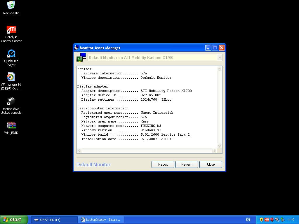

Xess666 Posted January 11, 2007 Share Posted January 11, 2007 (edited) My System VGA = ATI Mobility x1700 Monitor = 1280x800 Edited January 11, 2007 by Xess666 Link to comment https://www.insanelymac.com/forum/topic/37630-laptopdisplay/page/5/#findComment-273906 Share on other sites More sharing options...
