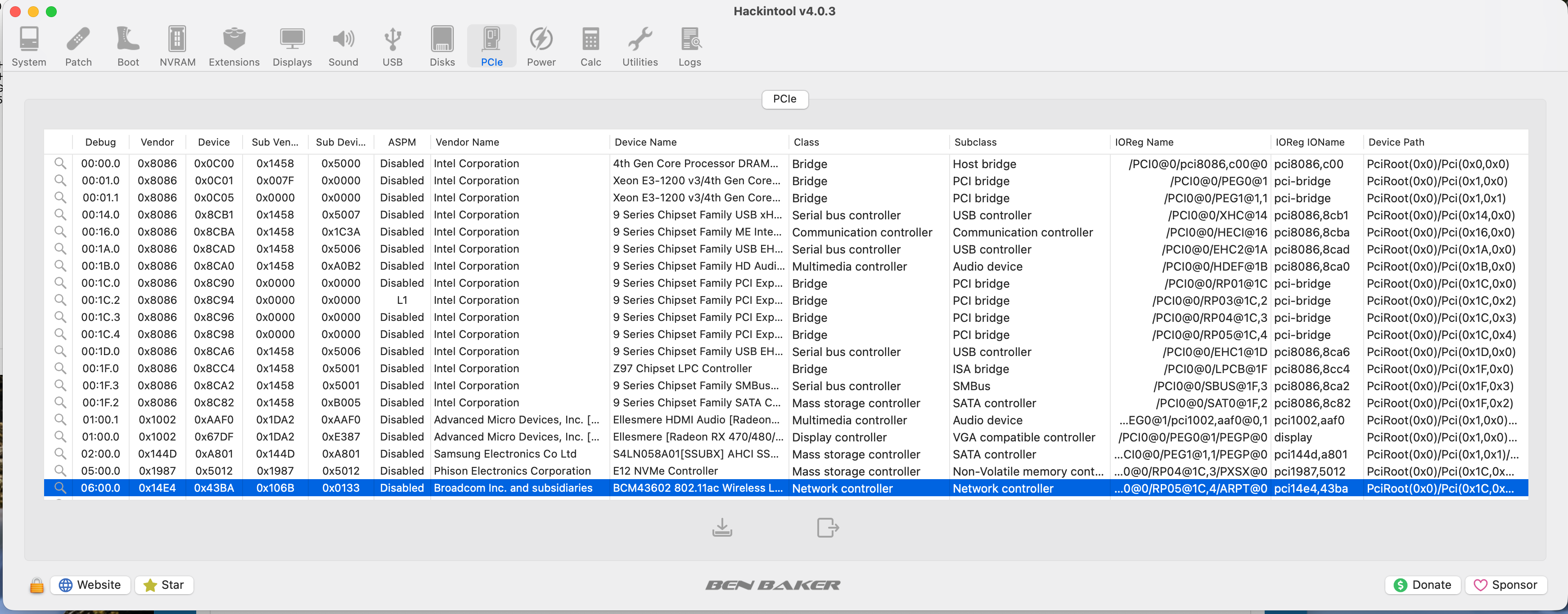

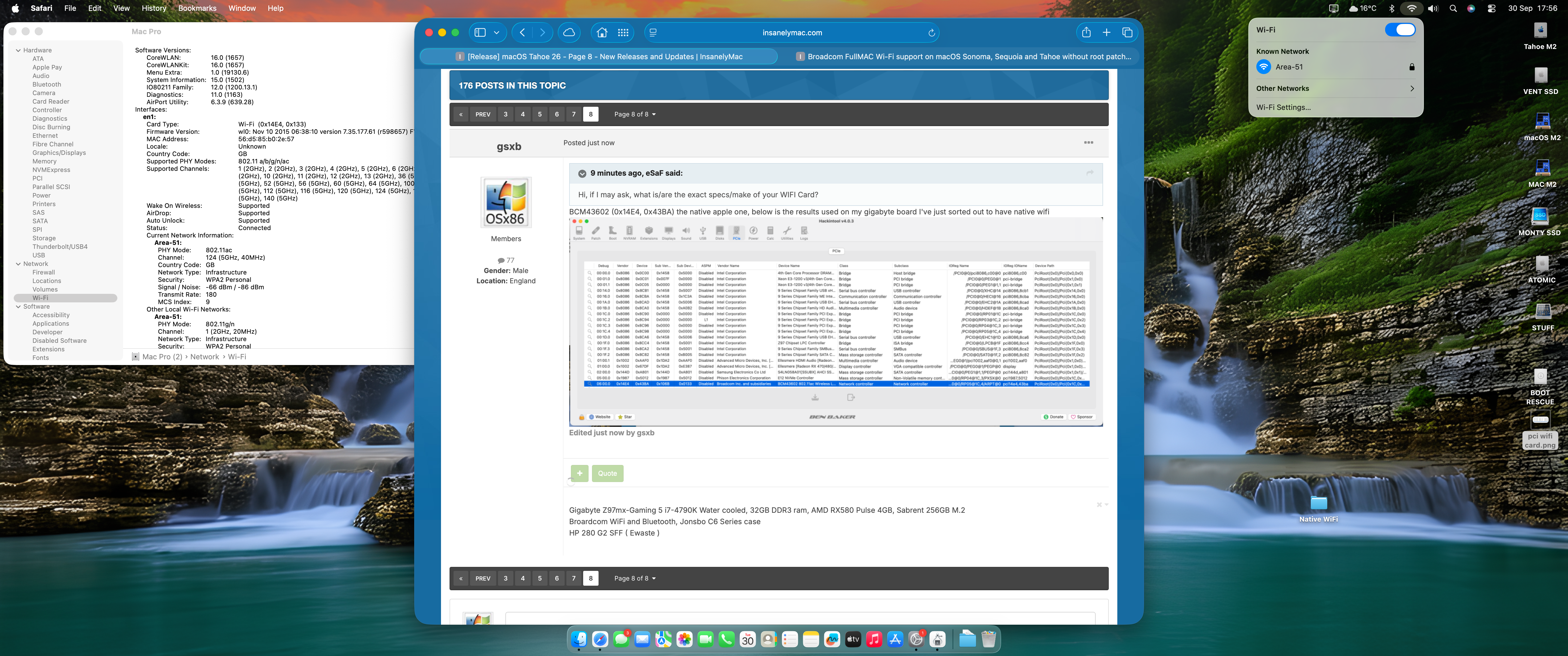

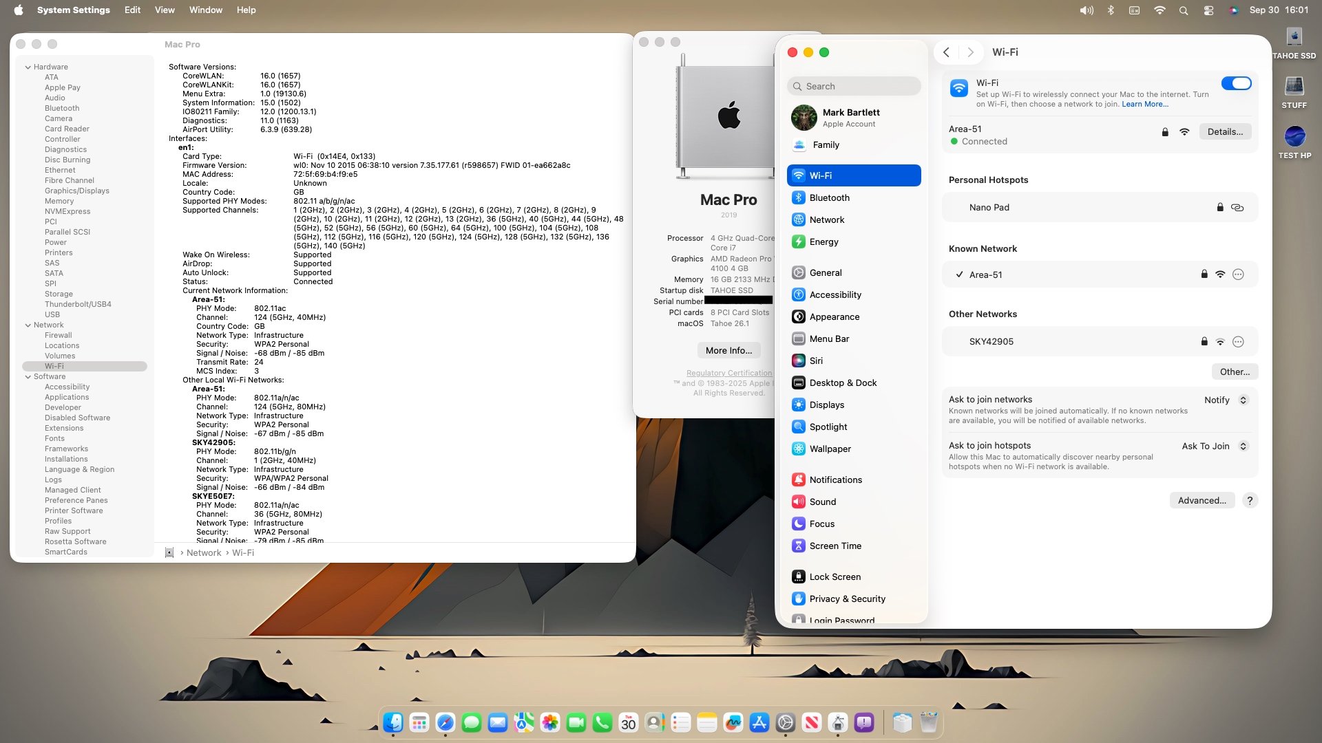

gsxb Posted September 30, 2025 Share Posted September 30, 2025 (edited) Native working WiFi macOS Tahoe 26,1, all thanks to this link Edited September 30, 2025 by gsxb 4 Link to comment https://www.insanelymac.com/forum/topic/361679-release-macos-tahoe-26/page/7/#findComment-2841540 Share on other sites More sharing options...
gsxb Posted September 30, 2025 Share Posted September 30, 2025 (edited) 9 minutes ago, eSaF said: Hi, if I may ask, what is/are the exact specs/make of your WIFI Card? BCM43602 (0x14E4, 0x43BA) the native apple one, below is the results used on my gigabyte board I've just sorted out to have native wifi working WiFi Edited September 30, 2025 by gsxb 5 Link to comment https://www.insanelymac.com/forum/topic/361679-release-macos-tahoe-26/page/7/#findComment-2841546 Share on other sites More sharing options...

iSpirit81 Posted October 2, 2025 Share Posted October 2, 2025 (edited) On 9/30/2025 at 5:10 PM, gsxb said: Native working WiFi macOS Tahoe 26,1, all thanks to this link Wall pls ? Edited October 2, 2025 by iSpirit81 Link to comment https://www.insanelymac.com/forum/topic/361679-release-macos-tahoe-26/page/7/#findComment-2841626 Share on other sites More sharing options...

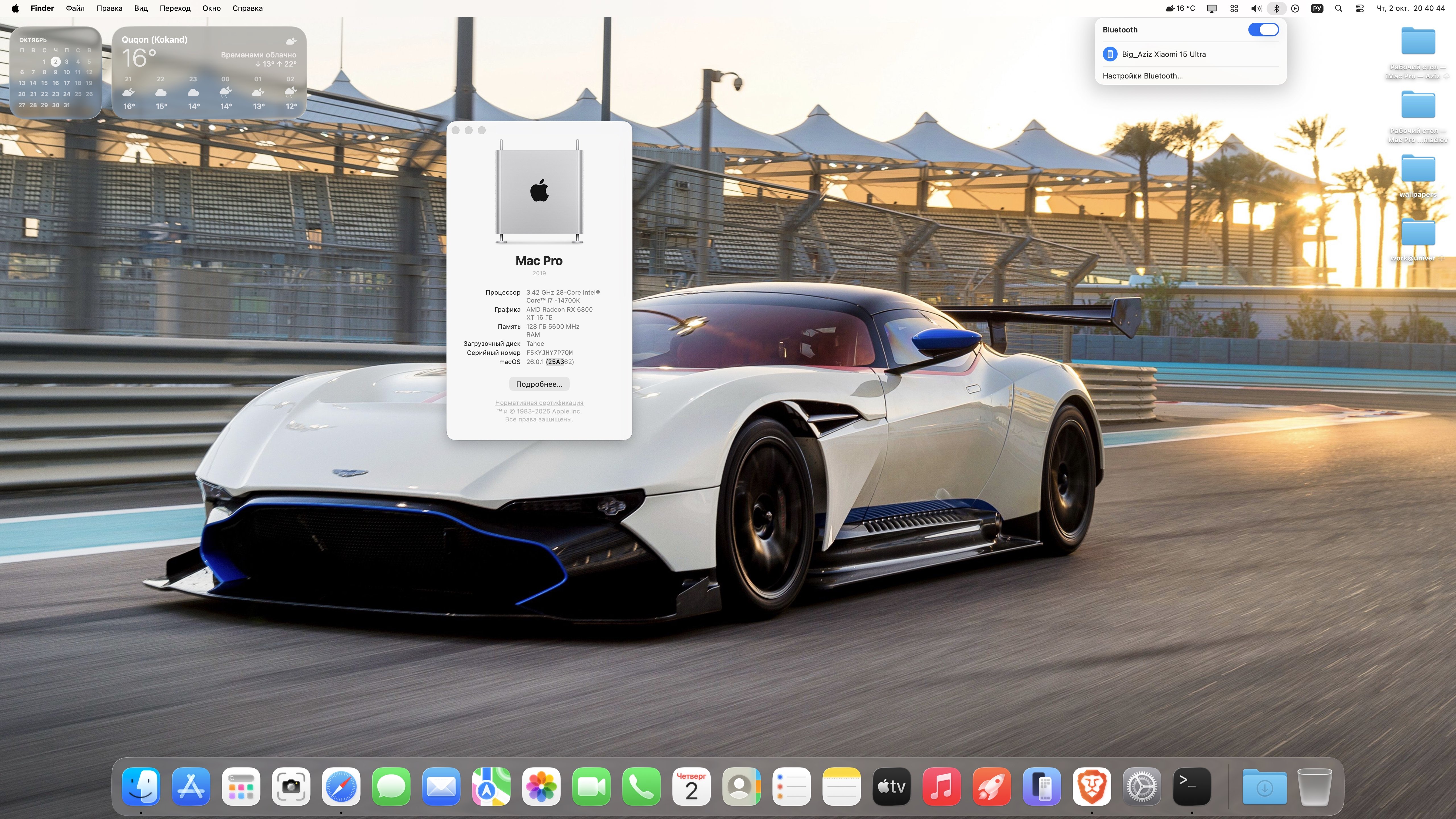

Big_Aziz Posted October 2, 2025 Share Posted October 2, 2025 28.09.2025 в 01:20 STLVNUB сказал: Как Ты Заработал Свой Синий Зуб Strangely enough, Bluetooth started working as soon as I installed the drivers, but Wi-Fi gave me a hard time. If you need the kexts themselves, I can send them to you. Link to comment https://www.insanelymac.com/forum/topic/361679-release-macos-tahoe-26/page/7/#findComment-2841632 Share on other sites More sharing options...
Big_Aziz Posted October 2, 2025 Share Posted October 2, 2025 Updated to 26.0.1 with a minor update, everything is great! 1 Link to comment https://www.insanelymac.com/forum/topic/361679-release-macos-tahoe-26/page/7/#findComment-2841633 Share on other sites More sharing options...

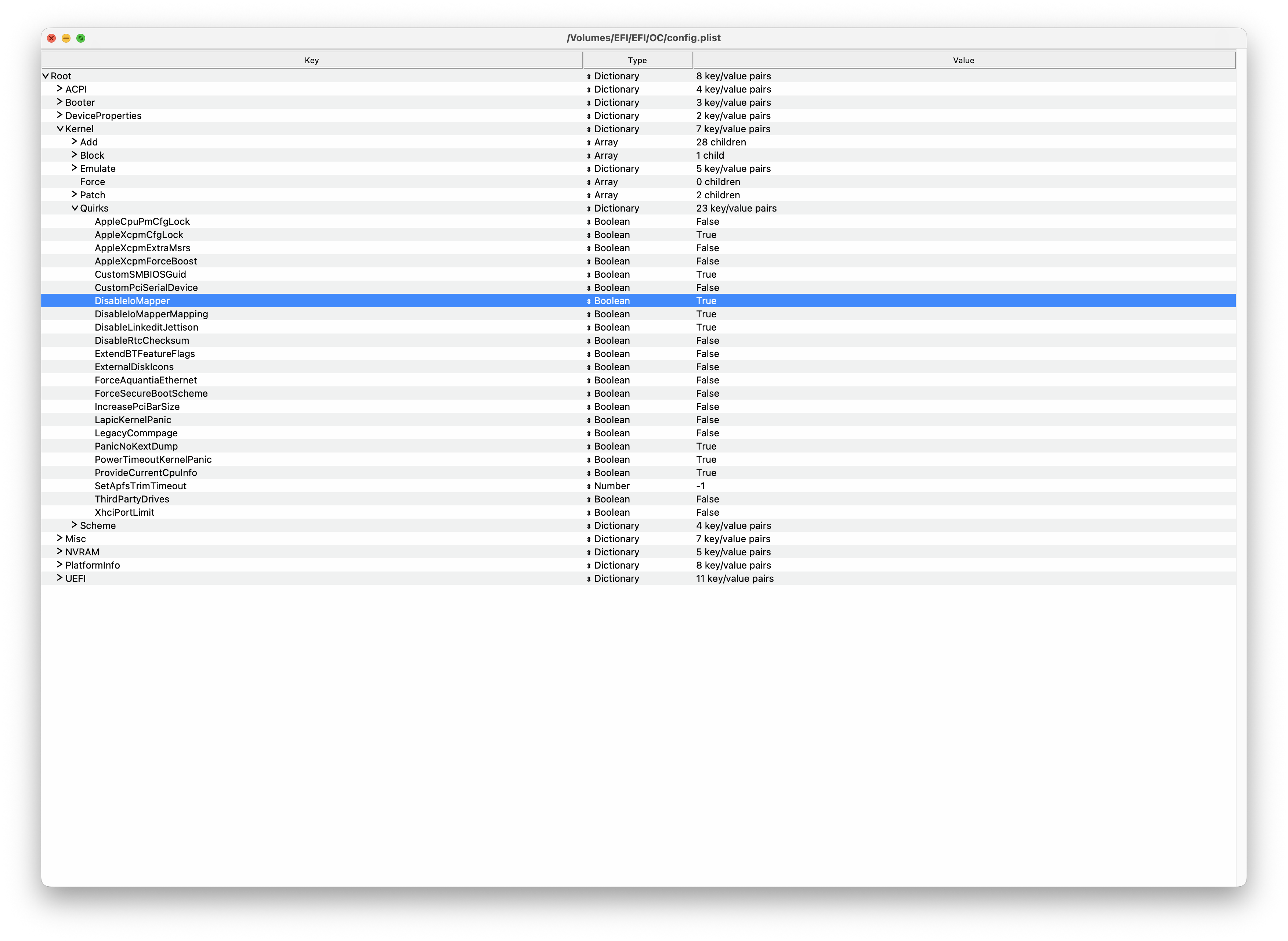

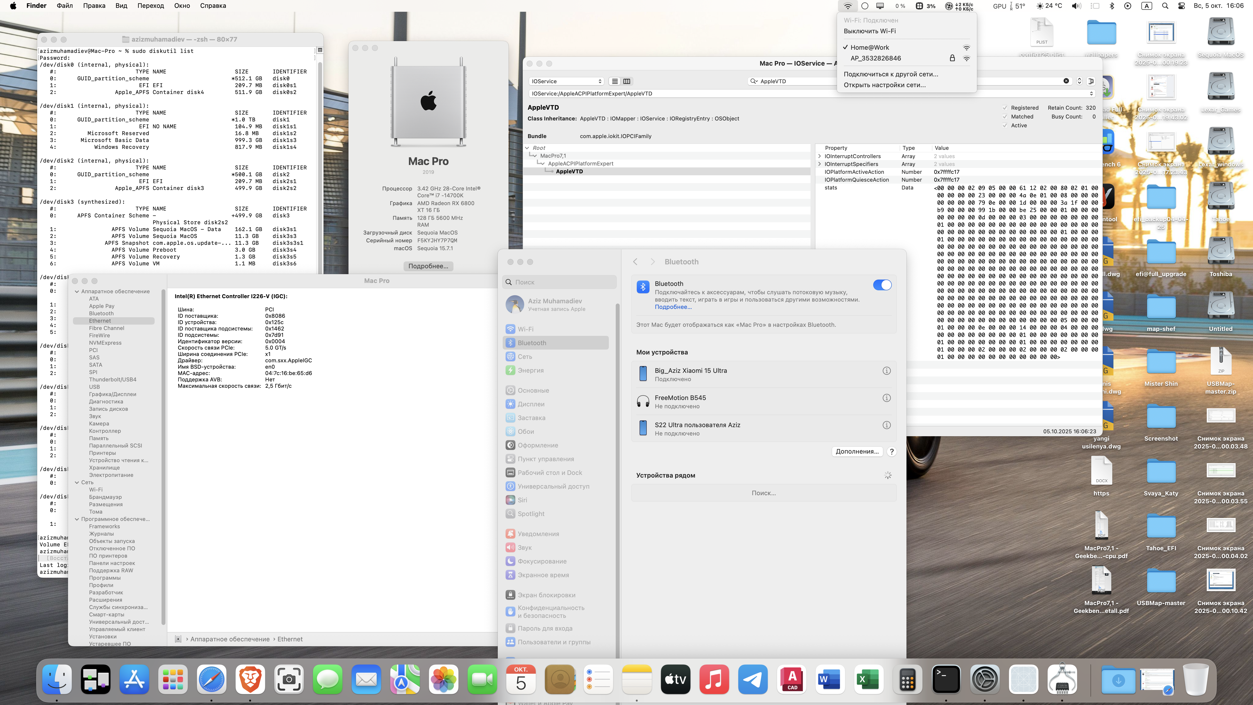

Big_Aziz Posted October 4, 2025 Share Posted October 4, 2025 (edited) 03.10.2025 в 00:54 tlac сказал: Does itlwm work for you with virtualization enabled? For me, it stops working if I try to activate AppleVTD. The itlwm cannot load the firmware. Good evening, I have two systems on my computer: Sequoia and Tahoe. In Sequoia, the DisableloMapper and DisableloMapperMapping quirks are set to false. To check the functionality of the kext in Tahoe, as you can see, I enabled them. Without it, the Wi-Fi firmware, as you correctly noted, does not load. Wi-Fi is not critical for me, the network card works, so we will wait until the kext is updated or a new open core is released. Спойлер Edited October 4, 2025 by Big_Aziz 1 Link to comment https://www.insanelymac.com/forum/topic/361679-release-macos-tahoe-26/page/7/#findComment-2841698 Share on other sites More sharing options...
tlac Posted October 4, 2025 Share Posted October 4, 2025 2 hours ago, Big_Aziz said: Good evening, I have two systems on my computer: Sequoia and Tahoe. In Sequoia, the DisableloMapper and DisableloMapperMapping quirks are set to false. To check the functionality of the kext in Tahoe, as you can see, I enabled them. Without it, the Wi-Fi firmware, as you correctly noted, does not load. Wi-Fi is not critical for me, the network card works, so we will wait until the kext is updated or a new open core is released. Setting DisableIoMapper to true disables AppleVTD. (But AppleVTD is required for the Intel i225-V ethernet DriverKit, although there’s a workaround for this - using the old AppleIntelI210Ethernet.kext from Monterey.) So can you confirm if you have AppleVTD enabled (you can check in the IORegistryExplorer) and working Wi-Fi in Sequoia at the same time? Is this issue only affecting Tahoe? 1 Link to comment https://www.insanelymac.com/forum/topic/361679-release-macos-tahoe-26/page/7/#findComment-2841704 Share on other sites More sharing options...

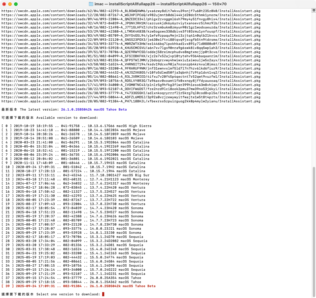

AlfredoM Posted October 5, 2025 Share Posted October 5, 2025 (edited) Don't rant, I know this is off topic. I have a problem with the "Download Full Installer" app. A download of 15.7.1 stopped at 16 GB, and now my macOS partition only shows 26 GB because the downloaded 16 GB is still taking up space. Question: Where does the "Download Full Installer" save the downloads? I go to Users/Library/Application Support and I don't see anything about the "Download Full Installer." Thanks for the quick tip. I want to install 15.7.1 Sequoia on another Mac today. Thanks for the unfriendly non-help... but I found it myself 😞 Edited October 5, 2025 by AlfredoM 1 Link to comment https://www.insanelymac.com/forum/topic/361679-release-macos-tahoe-26/page/7/#findComment-2841727 Share on other sites More sharing options...
crazybirdy Posted October 5, 2025 Share Posted October 5, 2025 (edited) 6 hours ago, AlfredoM said: Don't rant, I know this is off topic. I have a problem with the "Download Full Installer" app. A download of 15.7.1 stopped at 16 GB, and now my macOS partition only shows 26 GB because the downloaded 16 GB is still taking up space. Question: Where does the "Download Full Installer" save the downloads? I go to Users/Library/Application Support and I don't see anything about the "Download Full Installer." Thanks for the quick tip. I want to install 15.7.1 Sequoia on another Mac today. Thanks for the unfriendly non-help... but I found it myself 😞 I always use my own script to download the full installer app as below. You can download the InstallAssistant.pkg anytime as you want, FYI. installScriptAllfullapp26.zip Hide contents Edited October 5, 2025 by crazybirdy 1 Link to comment https://www.insanelymac.com/forum/topic/361679-release-macos-tahoe-26/page/7/#findComment-2841732 Share on other sites More sharing options...
gsxb Posted October 5, 2025 Share Posted October 5, 2025 On 10/2/2025 at 2:36 PM, iSpirit81 said: Wall pls ? there you goAi 1.zip 1 Link to comment https://www.insanelymac.com/forum/topic/361679-release-macos-tahoe-26/page/7/#findComment-2841736 Share on other sites More sharing options...
jlrycm Posted October 5, 2025 Share Posted October 5, 2025 18 hours ago, tlac said: Setting DisableIoMapper to true disables AppleVTD. (But AppleVTD is required for the Intel i225-V ethernet DriverKit, although there’s a workaround for this - using the old AppleIntelI210Ethernet.kext from Monterey.) So can you confirm if you have AppleVTD enabled (you can check in the IORegistryExplorer) and working Wi-Fi in Sequoia at the same time? Is this issue only affecting Tahoe? In Tahoe, VT-D must be enabled for this NIC to work. I have it enabled with patched DMAR table and dropped DMAR in ACPI-Delete as explained here https://dortania.github.io/Getting-Started-With-ACPI/Universal/dmar-methods/manual.html#dropping-the-dmar-table This works in Sequoia too obviously, with AppleIGC kext also working in Sequioa but not in Tahoe. Link to comment https://www.insanelymac.com/forum/topic/361679-release-macos-tahoe-26/page/7/#findComment-2841738 Share on other sites More sharing options...
Big_Aziz Posted October 5, 2025 Share Posted October 5, 2025 18 hours ago, tlac said: Setting DisableIoMapper to true disables AppleVTD. (But AppleVTD is required for the Intel i225-V ethernet DriverKit, although there’s a workaround for this - using the old AppleIntelI210Ethernet.kext from Monterey.) So can you confirm if you have AppleVTD enabled (you can check in the IORegistryExplorer) and working Wi-Fi in Sequoia at the same time? Is this issue only affecting Tahoe? In Sequoia, the DisableloMapper and DisableloMapperMapping quirks are set to false. As you can see in the screenshot on Sequoia, Wi-Fi, Bluetooth, AppleVTD, and the network are working perfectly. This only affects Mac OS Tahoe. I need to enable these two DisableloMapper and DisableloMapperMapping quirks for Wi-Fi to work. But in this case, Apple VTD does not work. Spoiler 1 Link to comment https://www.insanelymac.com/forum/topic/361679-release-macos-tahoe-26/page/7/#findComment-2841740 Share on other sites More sharing options...
miliuco Posted October 5, 2025 Share Posted October 5, 2025 @AlfredoM DFI downloads in the default Downloads folder. User data are in the user Library -> Containers -> DownloadFullInstaller, as is a sandboxed app. There was an issue with the permission to write in the Downloads folder, fixed in latest release. Maybe this is what happens to you. Remove the folder user/Library/Containers/DownloadFullInstaller and download latest release and comment, please. https://github.com/perez987/DownloadFullInstaller/releases/tag/2.0-123 "Thanks for the unfriendly non-help" -> Man, only 11 hours, you want an inmediate help from people who have their own lives, you're welcome (sarcasm). 3 1 2 Link to comment https://www.insanelymac.com/forum/topic/361679-release-macos-tahoe-26/page/7/#findComment-2841741 Share on other sites More sharing options...

AlfredoM Posted October 5, 2025 Share Posted October 5, 2025 (edited) 3 hours ago, miliuco said: @AlfredoM DFI downloads in the default Downloads folder. User data are in the user Library -> Containers -> DownloadFullInstaller, as is a sandboxed app. There was an issue with the permission to write in the Downloads folder, fixed in latest release. Maybe this is what happens to you. Remove the folder user/Library/Containers/DownloadFullInstaller and download latest release and comment, please. https://github.com/perez987/DownloadFullInstaller/releases/tag/2.0-123 "Thanks for the unfriendly non-help" -> Man, only 11 hours, you want an inmediate help from people who have their own lives, you're welcome (sarcasm). https://github.com/perez987/DownloadFullInstaller/releases/tag/2.2.3-120 The Download Full Installer folder in Library/Containers/Downloadfullinstallers must NOT be removed, not even in the brand new version, otherwise the DFI will no longer be available in the app !! friend @miliuco... yesterday I was visiting a friend and I wanted some quick help because he won't be with me forever! It was already 3 a.m. for me, and in the US, it was only 9 p.m. on the East Coast, and there are a lot of users online here. And I thought someone would reply quickly so I could get on with it. That's what I meant. And I've included the latest link to DFI for you. I then installed the latest DFI, and it worked without any problems, despite the limited available space on the macOS partition, which was only 25 GB. Edited October 5, 2025 by AlfredoM Link to comment https://www.insanelymac.com/forum/topic/361679-release-macos-tahoe-26/page/7/#findComment-2841750 Share on other sites More sharing options...
