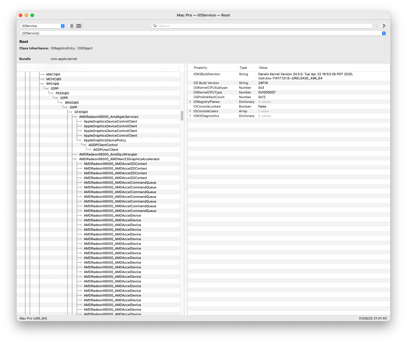

Well, I'm back working on the Proart system and as you mentioned the BRG0 section of the all in one SSDT is conflicting with the GPU bridge file.
use SSDT Chip-800 with NootRX.kext. Remove whatevergreen.
 NootRX.kext.zip
SSDT with no video device
If u want stay with whatevergreen just use this patch device properties.
Default video device on chipset serie 800 is RP01.PXSX... _ADR @6 into PC00.
Quote
RX6650
            <key>PciRoot(0x0)/Pci(0x6,0x0)/Pci(0x0,0x0)/Pci(0x0,0x0)/Pci(0x0,0x0)</key>
            <dict>
                <key>compatible</key>
                <string>pci1002,73FF</string>
                <key>device-id</key>
                <data>/3MAAA==</data>
                <key>model</key>
                <string>AMD Radeon RX 6650</string>
            </dict>
RX6950
            <dict>
                <string>pci1002,73BF</string>
                <data>v3MAAA==</data>
                <key>model</key>
                <string>AMD Radeon RX 6950</string>
            </dict>
 NootRX.kext.zip
SSDT with no video device Chip-800 no BRG0.zip
Awesome, thanks for all the excellent support
