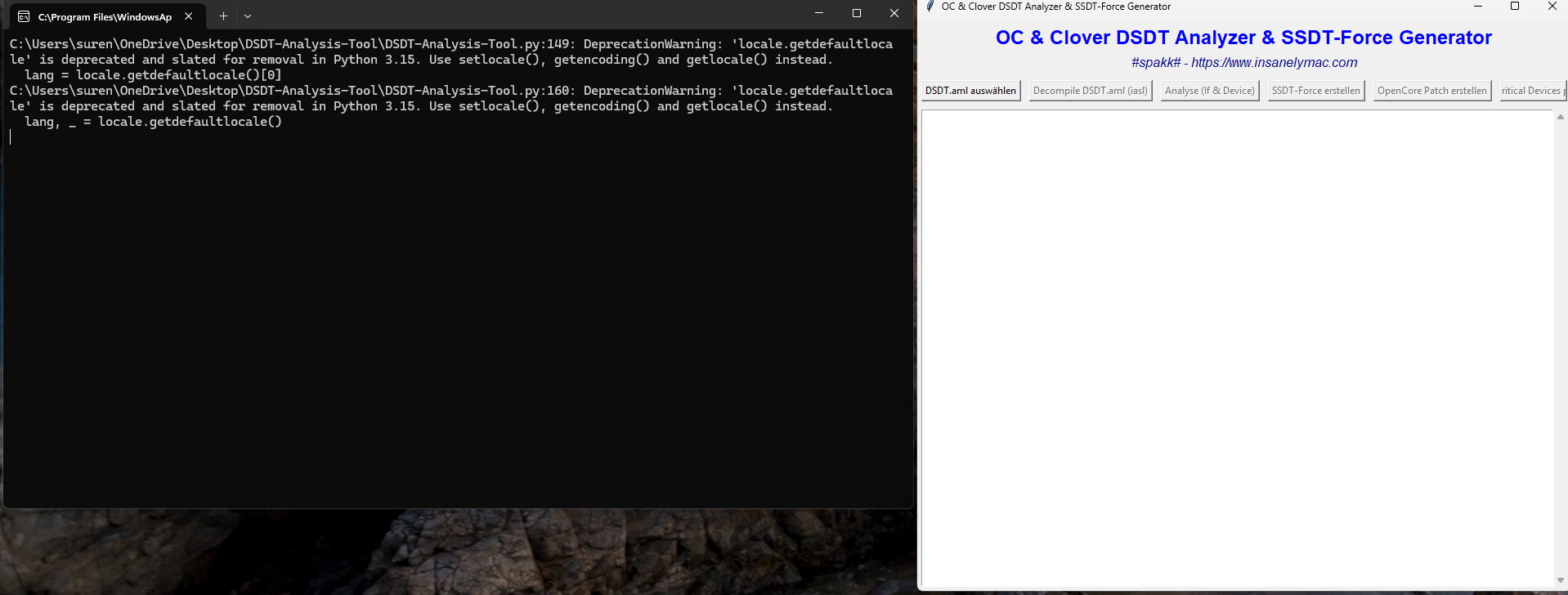

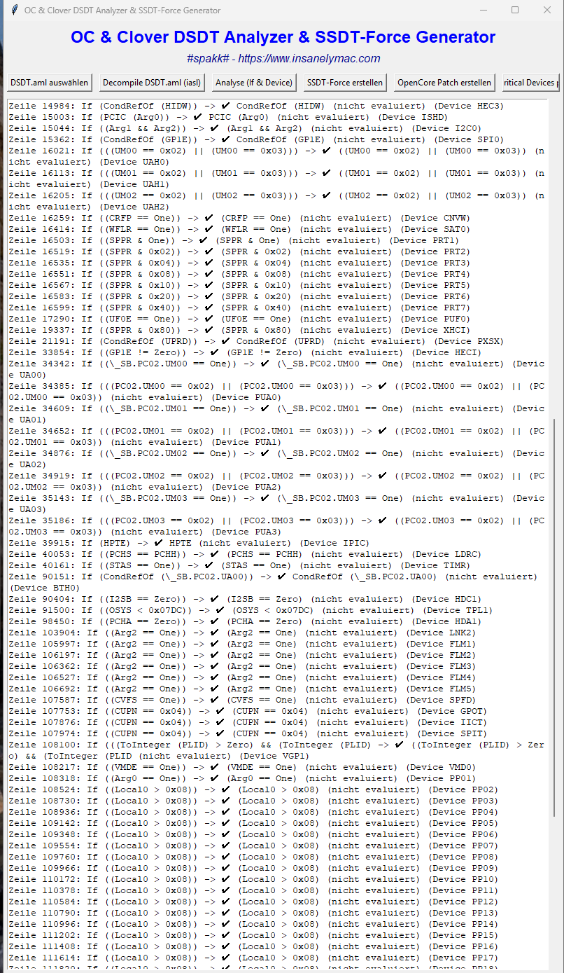

spakk Posted June 1, 2025 Share Posted June 1, 2025 1 hour ago, Cyberdevs said: @spakk Just a quick question does this work with all mainboard models or is it designed to Z890 series? The DSDT-Analysis-Tool is not only for the Z890 series. It can work with any mainboard if you can get the DSDT from your system. The tool looks at ACPI tables in general, so it should work with many different motherboards, no matter the chipset or model. This includes the Z890 series, but is not limited to it. However, the DSDT quality and layout can be different depending on the manufacturer and BIOS version. This may change how well the tool works or the results you get. It is a good idea to try it with your own board’s DSDT and tell us if you find any problems. 1 Link to comment https://www.insanelymac.com/forum/topic/361117-scanning-for-conditional-device-declarations/page/2/#findComment-2832714 Share on other sites More sharing options...

Cyberdevs Posted June 1, 2025 Share Posted June 1, 2025 @spakk Here is the DSDT for my Z690 Auros Master board. I also attached the files generated with the app. I used Clover to dump the ACPI tables. GA-Z690 Aorus Master DSDT.aml.zip OpenCore-Patch.txt full_device_check.txt conditional_devices.txt Link to comment https://www.insanelymac.com/forum/topic/361117-scanning-for-conditional-device-declarations/page/2/#findComment-2832736 Share on other sites More sharing options...

etorix Posted June 1, 2025 Author Share Posted June 1, 2025 1 hour ago, Cyberdevs said: Here is the DSDT for my Z690 Auros Master board. I also attached the files generated with the app. At this point, it may be helpful to point that this discussion is primarily about 800-series and AM5 board, which cannot boot at all without some DSDT patching. Not all conditional declarations are problematic, and USB ports being conditional on their parent being actually present should NOT be an issue. But if we find possible improvements for 600-series it will be a nice bonus. Link to comment https://www.insanelymac.com/forum/topic/361117-scanning-for-conditional-device-declarations/page/2/#findComment-2832741 Share on other sites More sharing options...

surenmunoo Posted June 1, 2025 Share Posted June 1, 2025 @spakk It does not give me in English. Language, region etc is New Zealand but the app does not show English Link to comment https://www.insanelymac.com/forum/topic/361117-scanning-for-conditional-device-declarations/page/2/#findComment-2832743 Share on other sites More sharing options...
