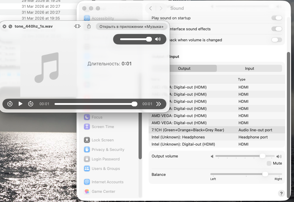

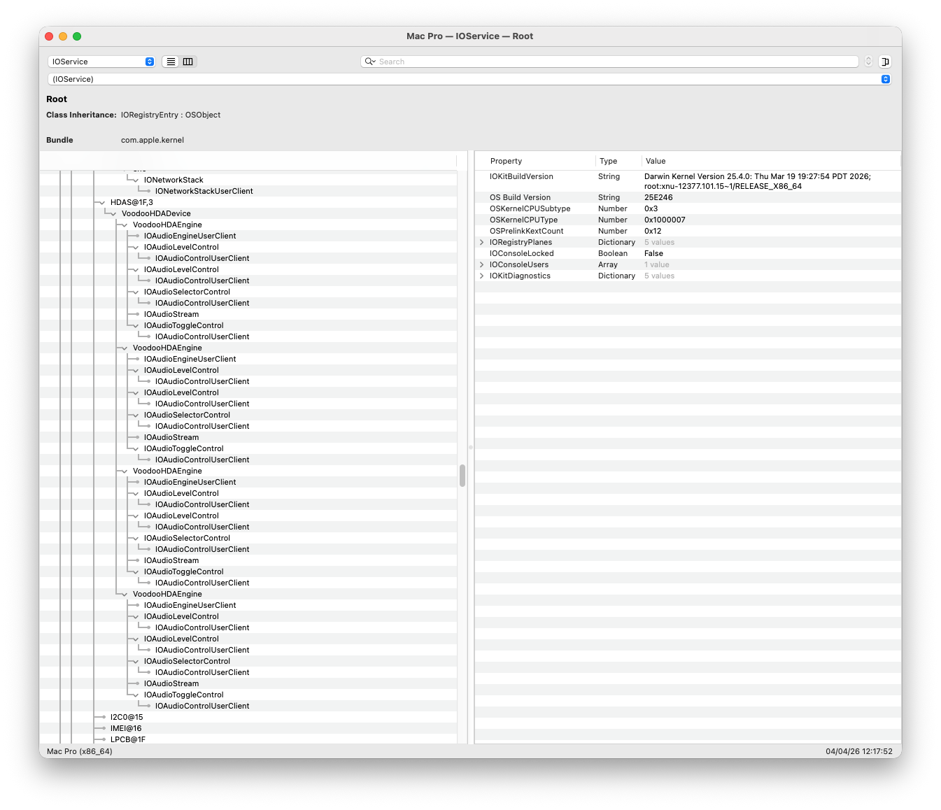

Max.1974 Posted March 20 Share Posted March 20 (edited) 13 hours ago, Slice said: The driver with latest changes concerning compatibility with some hardware (x99 for example) VoodooHDA.kext.zip 114.21 kB · 8 downloads And my result The 7.1 sound is impossible with AppleALC, this is VoodooHDA feature. And in this case the output remains the same after reboot. To do this I placed four outputs in same group 1 (second digit from right). Works nice too my friend!! Thank You!! Edited March 20 by Max.1974 3 Link to comment https://www.insanelymac.com/forum/topic/314406-voodoohda-312/page/38/#findComment-2848285 Share on other sites More sharing options...

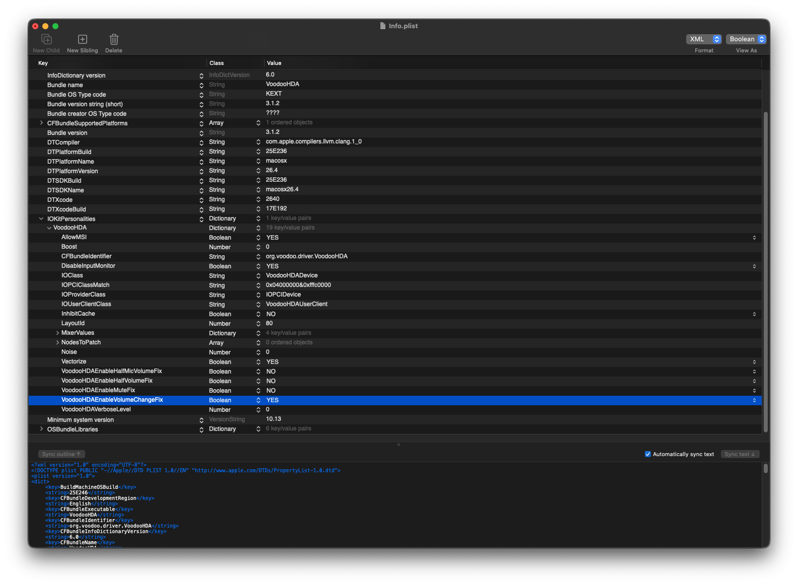

deeveedee Posted March 25 Share Posted March 25 @Slice Thank you for continuing to maintain VoodooHDA.kext. I have tested the latest version 3.1.2 that you posted and the 3.1.2 installer shared by MaLd0n here. The version shared by MaLd0n works better for me, but I don't know why since I don't have visibility into the differences. With your latest posted 3.1.2, I cannot control volume (same problem that I observed before). Moving the Volume slider does not change the audio volume for me. I am installing VoodooHDA.kext to /Library/Extensions with "cp -R" and I am not using VoodooHDA.prefPane. Link to comment https://www.insanelymac.com/forum/topic/314406-voodoohda-312/page/38/#findComment-2848444 Share on other sites More sharing options...
MaLd0n Posted March 25 Share Posted March 25 Try with this fix on plist 1 Link to comment https://www.insanelymac.com/forum/topic/314406-voodoohda-312/page/38/#findComment-2848445 Share on other sites More sharing options...
jlrycm Posted March 25 Share Posted March 25 1 hour ago, deeveedee said: With your latest posted 3.1.2, I cannot control volume (same problem that I observed before). Moving the Volume slider does not change the audio volume for me. I am installing VoodooHDA.kext to /Library/Extensions with "cp -R" and I am not using VoodooHDA.prefPane. The issue I have right now is that when I move the VoodooHDA preference pane volume slider clock wise to 12 or 2 o’clock, the audio is gone. Is this expected? @deeveedeeIs this the issue you are having? I’ll try @MaLd0n suggestion when I get home. Link to comment https://www.insanelymac.com/forum/topic/314406-voodoohda-312/page/38/#findComment-2848448 Share on other sites More sharing options...
deeveedee Posted March 25 Share Posted March 25 (edited) @MaLd0n thank you (and also thank you to Lockdown) for the suggestion. Enabling VoodooHDAEnableVolumeChangeFix does resolve the non-working volume slider problem. Note that VoodooHDAEnableVolumeChangeFix is different from VoodooHDAEnableHalfVolumeFix. @jlrycm I am not using the VoodooHDA pref pane, so I'm not sure if that problem is related. With Slice's latest posted VoodooHDA.kext here and MaLd0n's fix here, audio in Tahoe is working perfectly for me on my HP EliteBook 850 G7. Edited March 25 by deeveedee 5 Link to comment https://www.insanelymac.com/forum/topic/314406-voodoohda-312/page/38/#findComment-2848451 Share on other sites More sharing options...

Slice Posted April 3 Author Share Posted April 3 If I understand you then we can't control volume of left and right speaker separately. Use system Balance control. 1 Link to comment https://www.insanelymac.com/forum/topic/314406-voodoohda-312/page/38/#findComment-2848688 Share on other sites More sharing options...
oSxFr33k Posted April 3 Share Posted April 3 (edited) 2 hours ago, Slice said: If I understand you then we can't control volume of left and right speaker separately. Use system Balance control. That is exactly what I’m using. It’s called the audio midi set up and there’s two sliders per speaker. Under the old AppleHDA and older MacOs using VoodooHDA I was able to control balance but not with newer VoodooHDA in newer MacOS after BigSur. The left or right if slidden off completely silences both sides even if one of them is full volume and as long as both are slid toward more volume I have sound and it’s always stereo the control for balance is nonexistent. Can you see if you observe this on your device. Edited April 3 by oSxFr33k Link to comment https://www.insanelymac.com/forum/topic/314406-voodoohda-312/page/38/#findComment-2848692 Share on other sites More sharing options...
Slice Posted April 3 Author Share Posted April 3 2 hours ago, oSxFr33k said: That is exactly what I’m using. It’s called the audio midi set up and there’s two sliders per speaker. Under the old AppleHDA and older MacOs using VoodooHDA I was able to control balance but not with newer VoodooHDA in newer MacOS after BigSur. The left or right if slidden off completely silences both sides even if one of them is full volume and as long as both are slid toward more volume I have sound and it’s always stereo the control for balance is nonexistent. Can you see if you observe this on your device. I checked just now. The balance work left and right 2 1 Link to comment https://www.insanelymac.com/forum/topic/314406-voodoohda-312/page/38/#findComment-2848695 Share on other sites More sharing options...

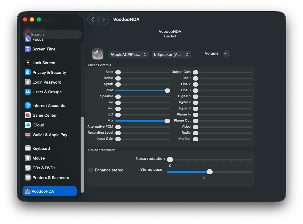

chris1111 Posted April 4 Share Posted April 4 (edited) Thanks @Slice It is really beautifull! Compiling VoodooHDAPrefPane from source It's like original of Tahoe Icon One Liner code build ⬇︎ git clone https://github.com/CloverHackyColor/VoodooHDA.git && xcodebuild -project ./VoodooHDA/VHDAPrefPane/VoodooHDA/VoodooHDA.xcodeproj -alltargets -configuration Release && Open ./VoodooHDA/VHDAPrefPane/VoodooHDA/build/Release Edited April 4 by chris1111 2 1 Link to comment https://www.insanelymac.com/forum/topic/314406-voodoohda-312/page/38/#findComment-2848707 Share on other sites More sharing options...

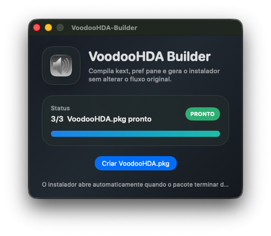

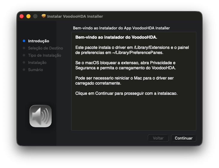

Max.1974 Posted April 4 Share Posted April 4 This work turned out so well that I created an app to compile the release of VoodooHDA.kext, downloading the original repository and creating the pkg installer. Thanks to @Slice and @chris1111. Spoiler VoodooHDA-Builder-PKG.mov VoodooHDA-Builder.dmg 👓 When compiled on your own machine, the sound works more perfectly for your hardware. 1 Link to comment https://www.insanelymac.com/forum/topic/314406-voodoohda-312/page/38/#findComment-2848720 Share on other sites More sharing options...
deeveedee Posted April 4 Share Posted April 4 12 minutes ago, Max.1974 said: When compiled on your own machine, the sound works more perfectly for your hardware. This is new information for me. Why does the build machine matter? How does building VoodooHDA on one's own machine make it better than the same version downloaded from Slice or MaLd0n? Link to comment https://www.insanelymac.com/forum/topic/314406-voodoohda-312/page/38/#findComment-2848722 Share on other sites More sharing options...
Max.1974 Posted April 4 Share Posted April 4 17 minutes ago, deeveedee said: This is new information for me. Why does the build machine matter? How does building VoodooHDA on one's own machine make it better than the same version downloaded from Slice or MaLd0n? In theory, if the same source code, compiler, and build settings are used, the result should be basically the same as the one provided by Slice or MaLd0n. However, in practice there can still be differences depending on the hardware environment. For example, on my machines the kext compiled and packaged for my desktop does not behave the same way on my laptop, and vice versa. Different audio codecs and hardware implementations can lead to slightly different results. Another point is that on macOS the Xcode toolchain interacts closely with the system environment. In some cases the build process can pick up differences related to the local hardware, SDK, or toolchain configuration. These differences are not always visible, but they can influence how the driver behaves on a specific machine. So building locally is not necessarily about making the kext “better”, but about adapting, testing, and packaging it in the same environment where it will be used. This gives more control over the build and sometimes results in better behavior on that specific hardware. 1 1 Link to comment https://www.insanelymac.com/forum/topic/314406-voodoohda-312/page/38/#findComment-2848724 Share on other sites More sharing options...
