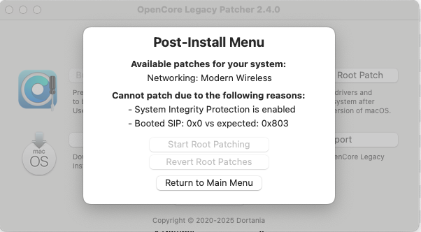

Hi guys! trying to post-install OCLP to enable wifi but got this popup, can you tell me if there's something wrong in my config.plist (attached) and how to disanle SIP as per OCLP requests to enable morder wifi post-install option.
Thanks!

Have you cleaned Nvram on opencore boot menu?
then i advice to remove amfi bootarg and use amfipass.kext (1.41

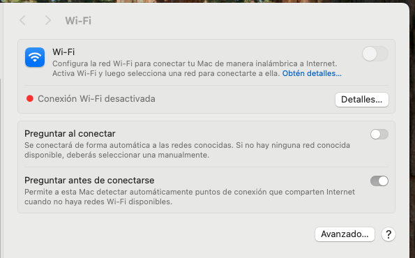

Tanks guys! resetting nvram did the trick and I was able to apply OPLP root patches, but after a reboot the wifi still doesn't work. My wifi card is a fenvi based on BCM43224
Attaching my config.plist after OPLC root patch applied
