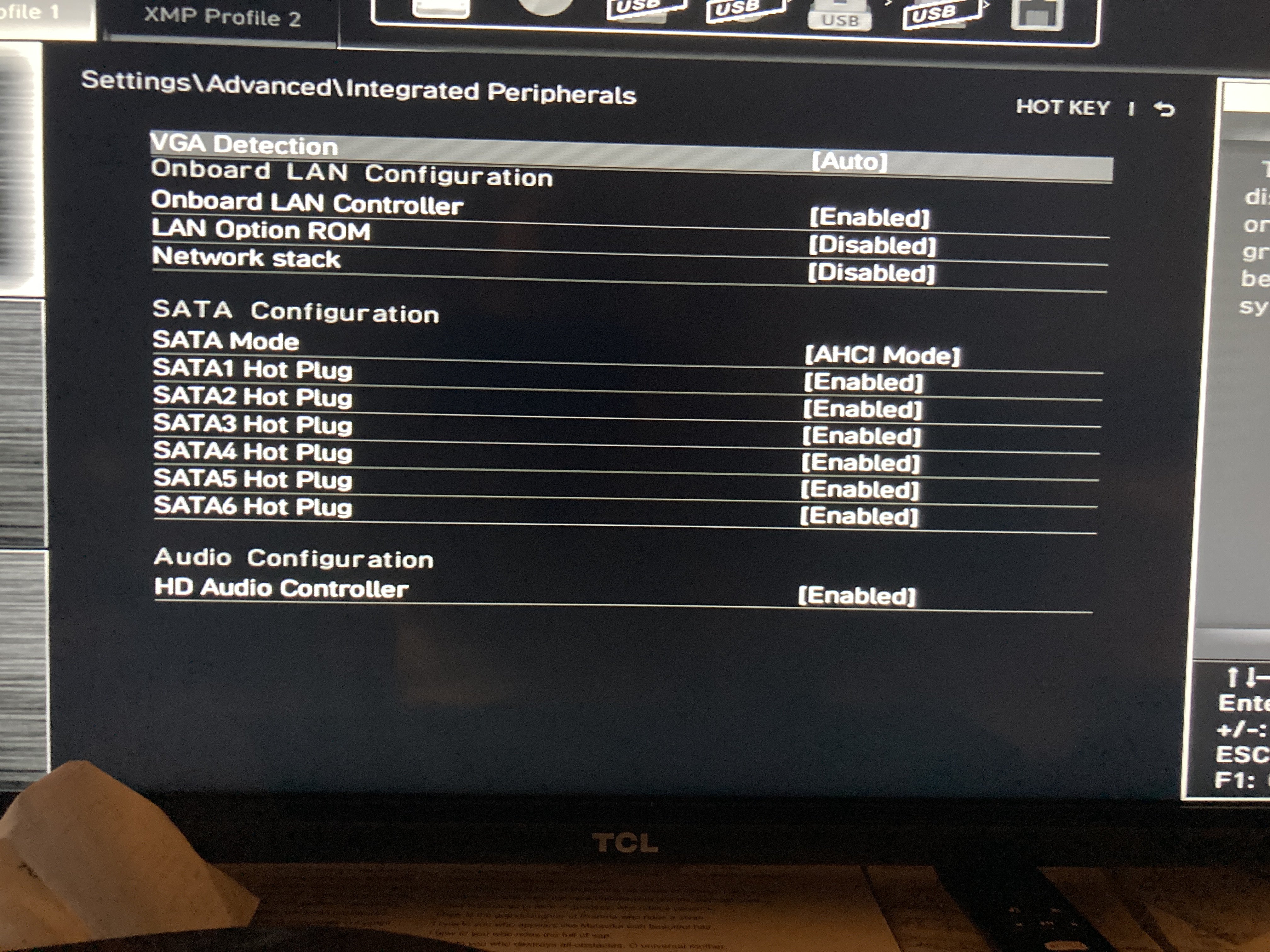

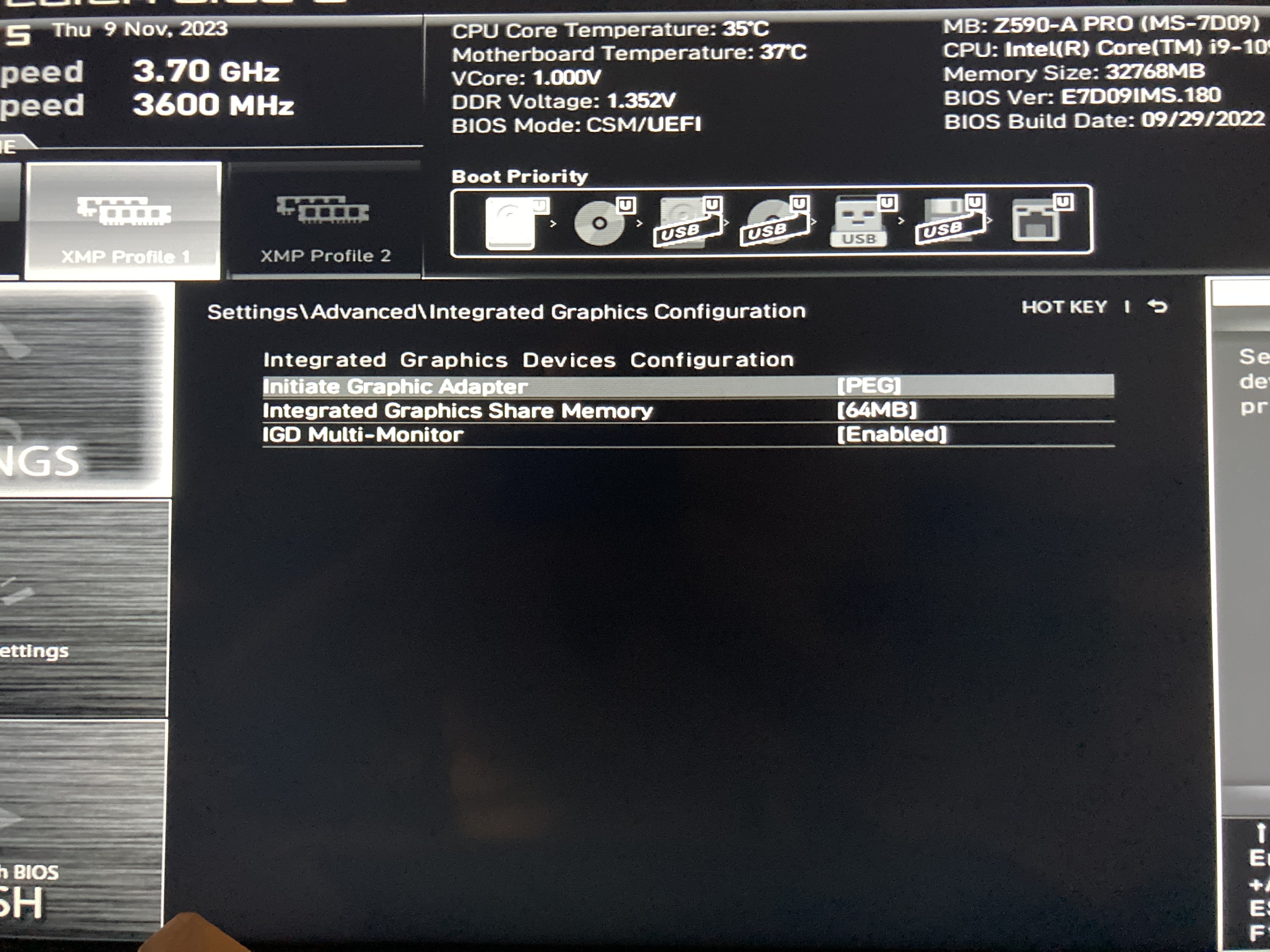

UPDATE: after switching to iMac 20,1 SMBIOS, I still see the VDA decoder failing. I added pictures of my UEFI BIOS settings just in case I need to change something here in your opinion.

Use this EFI folder EFI.zip
-Bios/UEFI in full default settings(CSM to Disable with AMD GPU - Sata to Ahci - Secure Boot Disable on mobiles)
-Delete old EFI folder and paste new. Don't use merge files
-Don't use Drag and Drop into EFI partition. Use Copy/Paste instead
-Reset NVRAM one time - with OpenCore use entry "Reset Nvram" / with Clover use F11 key on boot screen
