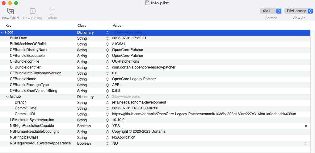

Dear @deeveedee @jsl2000 and @cankiulascmnfye,
I try to reply to all of you on the same message, so please don't shoot at me :D

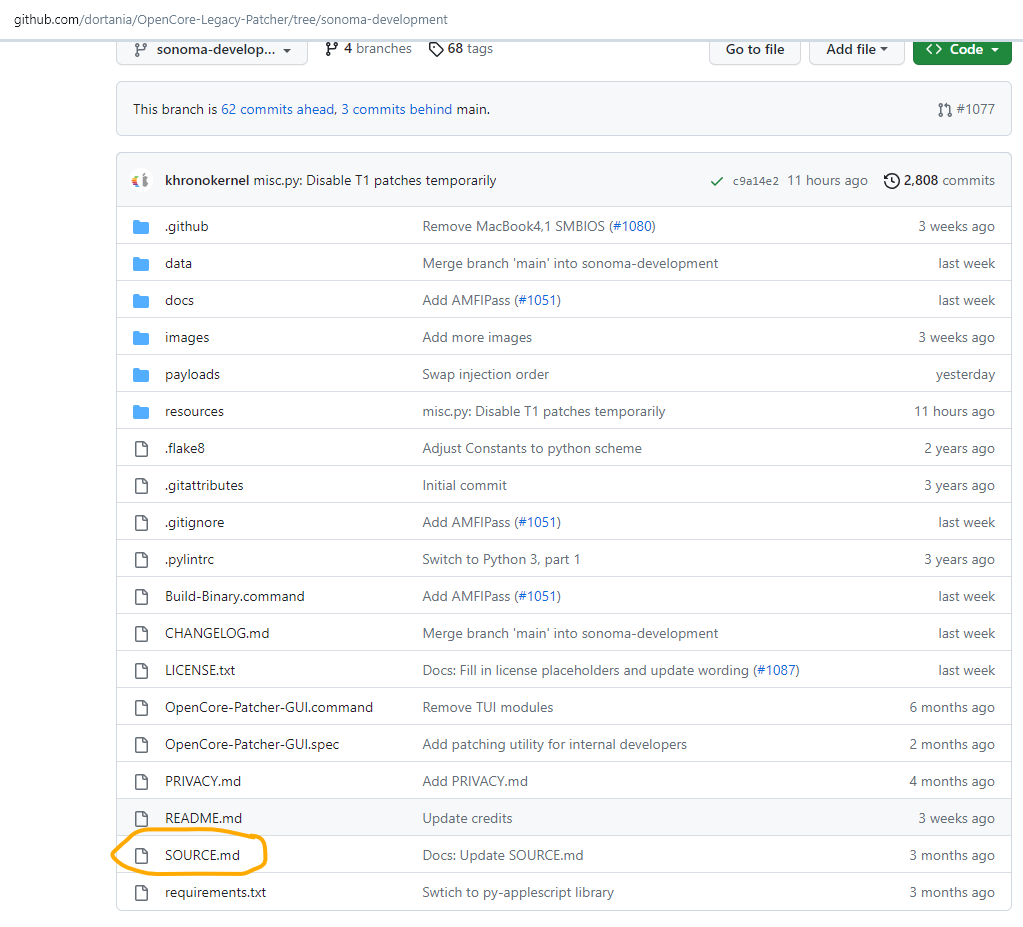

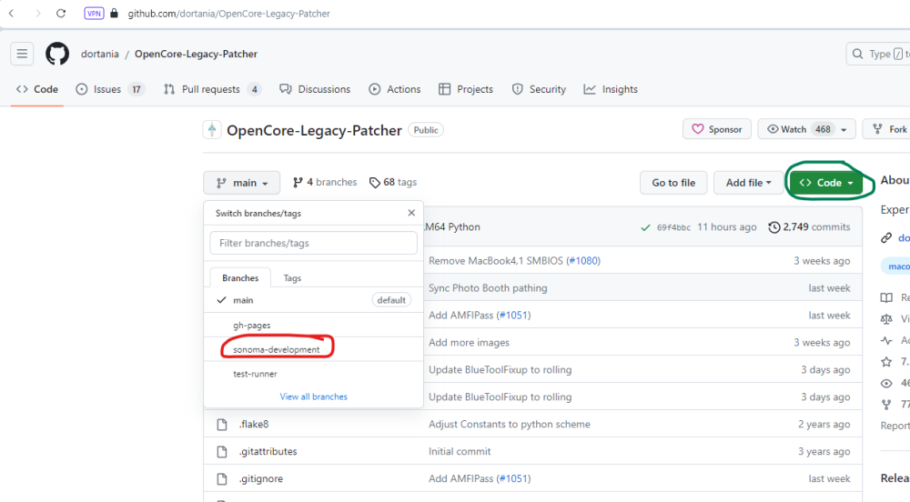

I used the sonoma-develpment branch to build the OCLP: on OCLP main github page, switch from main to sonoma-develpoment branch (red circle). Then, click on the code button (green circle) and download the entire branch as a zip file. Unzip it and start to work inside of that, searching for the sys_patch_detect.py (you can open using a plain text editor), set the self.modern_wifi variable to True and then start to build the project.image.thumb.png.9df3477b8da693ea1f4ef3bd275f32a6.png
To build the project itself, read the source.md file of the repository branch (orange circle) and apply all those steps to have a working sonoma version of OCLP that should patch also your systems. Yimage.thumb.png.b184e50dbc64219235d3afcecc921962.png

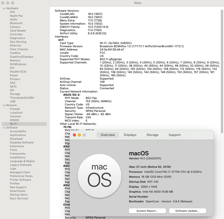

I was able to make my Dell DW1560 (BCM4352) wireless working by forcing the modern wireless patch (not the legacy one) as reported various times by @deeveedee during OCLP sonoma development build (I was lucky because I had an ethernet connection to use while building OCLP).
EFI must be correctly set, then apply the OCLP patches and, at the reboot, I had to unlink my wifi connection from macOS and reconnect again.
Then, I was finally able to have wireless connection!

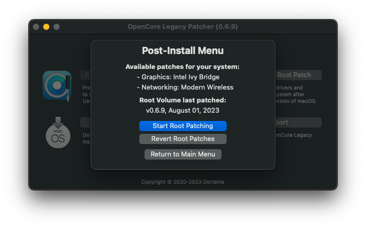

  • Next, build the Patcher App (Double-Click on OpenCore-Patcher-GUI.command). The GUI will pop-up automatically.
  • Click on "Post-Install Root Patch". You should be greeted by this (Graphics patches vary based on used CPU):

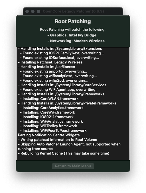

Patching… In my case, it's for a BCM94352HMB (Modern)
366682814_Bildschirmfoto2023-08-02um11_17_12.png.ad94650eb54ff5401f2320bb89b8c24b.png

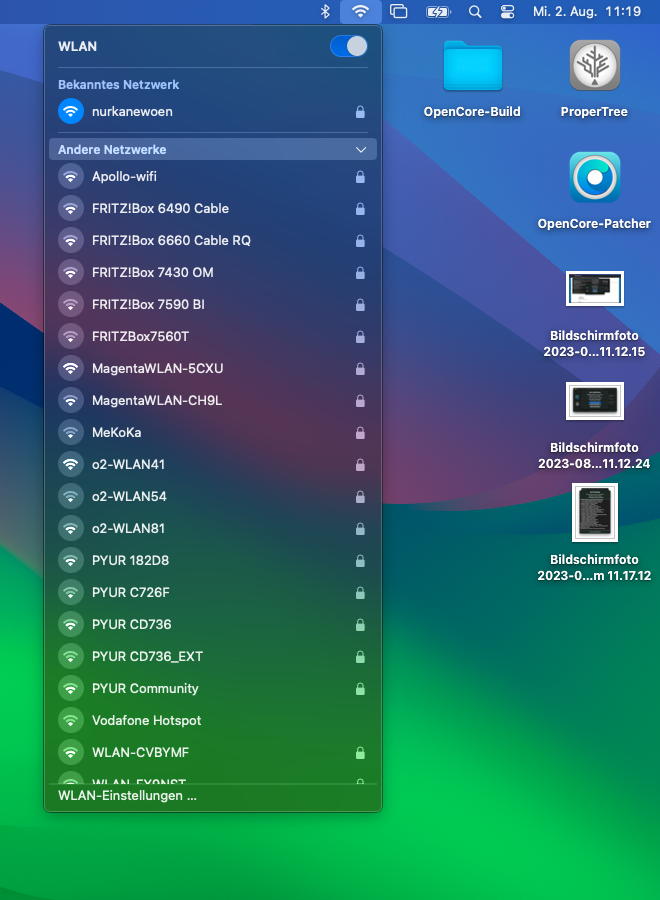

And…after reebooting… it's WORKING:…
1841481226_Bildschirmfoto2023-08-02um11_19_25.thumb.png.42f9df96caa57f9bcfeb1a4d596c5735.png
NO additional Binary Renames or SSDTs required!

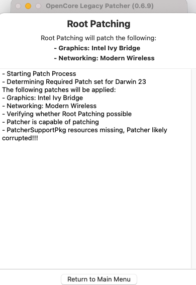

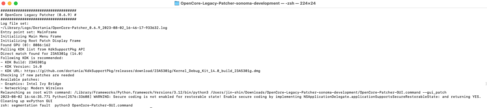

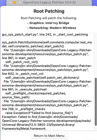

Thanks after following your instruction I can patch BCM4352 with Modern Wireless, but it got such an error and quit automatically.
How can I fix it ?
Edited by jsl2000

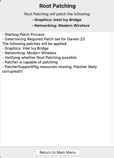

Thanks, but follow your instruction still got this same error during patching.
Run "Build Binary.command" before building the App so the Universal Binaries are present. I did this as well but I am not sure if this is a requirement.
Edited by cankiulascmnfye

55 minutes ago, acquarius13 said:
@jsl2000 delete the files you are working on, download again the sonoma-developer branch and start again to build your OCLP. Rember to modify the .py file (textedit is sufficient to edit it) prior to build OCLP
Thanks, but follow this still got the same error again !

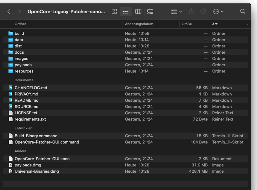

@jsl2000  This is the content of my Source Code folder. Besides the I just ran Build-Binary and OpenCore-Patcher-Gui.command. I also noticed that I added AutoPkgInstaller.kext to my EFI folder for testing. But I don't know if this makes any difference. I don't really know how that kext works. It's in the payloads folder. It was on by accident.
2035328417_Bildschirmfoto2023-08-02um14_30_42.png.f32309eb3c40f1b4e27f6008b1a0162c.png
51 minutes ago, cankiulascmnfye said:
@jsl2000  This is the ontent of my Source Code folder. Besides the I just uilt it and then ran it.
Can you share your payloads.dmg or payloads/Universal-Binaries folder to me because which was missing in mine ?

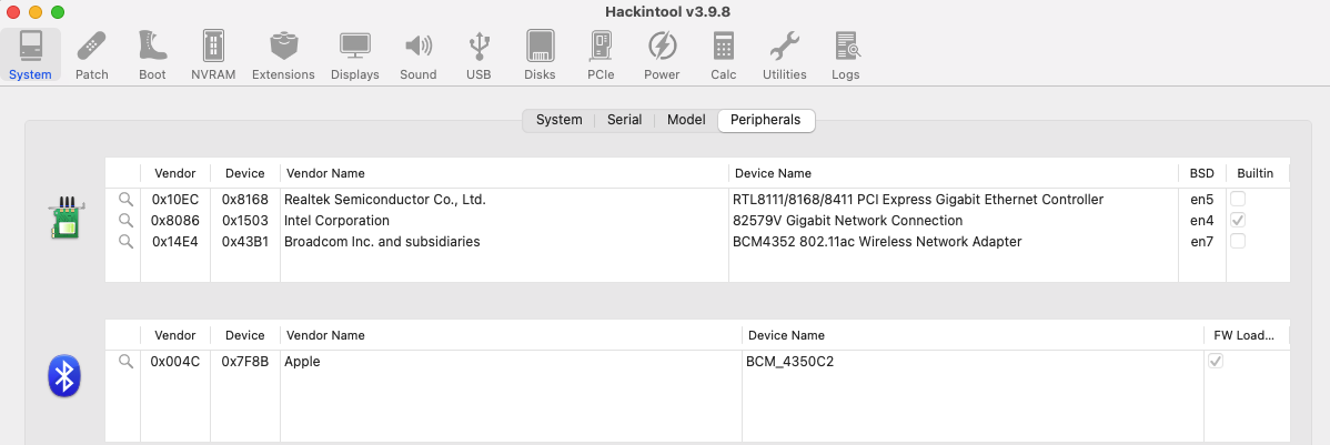

[Solved]

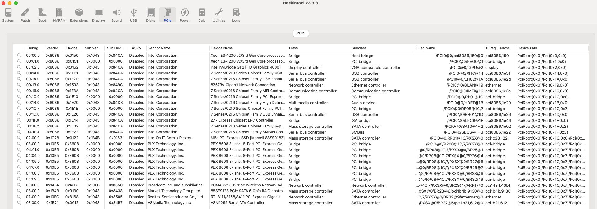

After midified my OC's config.plist either SSDT-ARPT.aml or Add DeviceProperties method both enable BCM4352 adapter properly at Sonoma now !
Correct way to enable BCM4352 in my Z77 hackintosh:
1. Boot with either Config-SSDT-ARPT.plist or Config-DeviceProperties.plist
2. Apply OCLP 0.6.9 of this version:
3. Reboot after successful patch of Modern Wireless
4. Working with BCM4352 adapter now.
SSDT-ARPT.aml
config-SSDT-ARPT.plist config-DeviceProperties.plist

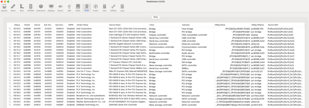

1 hour ago, jsl2000 said:
At present the only way to enable BCM4352 in my Z77 hackintosh are:
1. Insert BCM4360 adapter at PCIe x1 and got correct PCIe from Hackintool
2. Boot with SSDT-ARPT-BCM4360.aml
3. Apply OCLP 0.6.9 of this version:
4. Reboot after successful patch of Modern Wireless and make sure BCM4360 adapter working without issues
5. Shutdown and replaced BCM4360 with BCM4352 adapter in another PCIe x1 slot
6. Boot with SSDT-ARPT.aml which's compatible with BCM4352 adapter (checked by Hackintool)
7. Working again with BCM4352 adapter now.
SSDT-ARPT-BCM4360.aml 240 B · 1 download SSDT-ARPT.aml 240 B · 0 downloads config.plist 52.85 kB · 0 downloads
