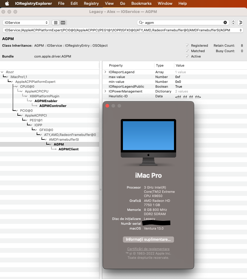

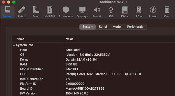

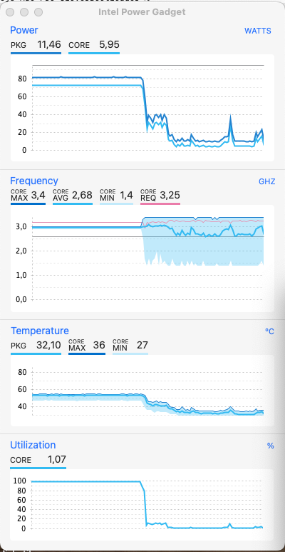

Stefanalmare Posted October 6, 2022 Share Posted October 6, 2022 1 hour ago, deeveedee said: @Stefanalmare Your results are impressive! The OCLP developers have really done some amazing work! I never would have expected to see Socket 775 with such long life. And the surprises are going on: power management working. Also finally I managed to put the right name to this unsupported processor (just needed to read a little bit 😀) Spoiler 3 Link to comment https://www.insanelymac.com/forum/topic/351969-pre-release-macos-ventura/page/121/#findComment-2794565 Share on other sites More sharing options...

RoberT_XeS Posted October 7, 2022 Share Posted October 7, 2022 10 hours ago, Stefanalmare said: And the surprises are going on: power management working. Also finally I managed to put the right name to this unsupported processor (just needed to read a little bit 😀) Hide contents Can you make a guide on how to get powermanagement working...I tried CPU Friend method and also SSDTPRgen method but none seem to work on my E5 1650 V2 Processor Link to comment https://www.insanelymac.com/forum/topic/351969-pre-release-macos-ventura/page/121/#findComment-2794597 Share on other sites More sharing options...
Slice Posted October 7, 2022 Share Posted October 7, 2022 9 minutes ago, RoberT_XeS said: Can you make a guide on how to get powermanagement working...I tried CPU Friend method and also SSDTPRgen method but none seem to work on my E5 1650 V2 Processor I have preliminary result with x79+E5 2650v2. The powermanagement works with Clover settings from 1800 up to 3200MHz. 1 1 Link to comment https://www.insanelymac.com/forum/topic/351969-pre-release-macos-ventura/page/121/#findComment-2794598 Share on other sites More sharing options...

Stefanalmare Posted October 7, 2022 Share Posted October 7, 2022 32 minutes ago, RoberT_XeS said: Can you make a guide on how to get powermanagement working...I tried CPU Friend method and also SSDTPRgen method but none seem to work on my E5 1650 V2 Processor Look at this: https://github.com/dortania/OpenCore-Legacy-Patcher/commit/964697a2c11f3f9c1ff6f0aa6919ba82200f1720 2 Link to comment https://www.insanelymac.com/forum/topic/351969-pre-release-macos-ventura/page/121/#findComment-2794602 Share on other sites More sharing options...

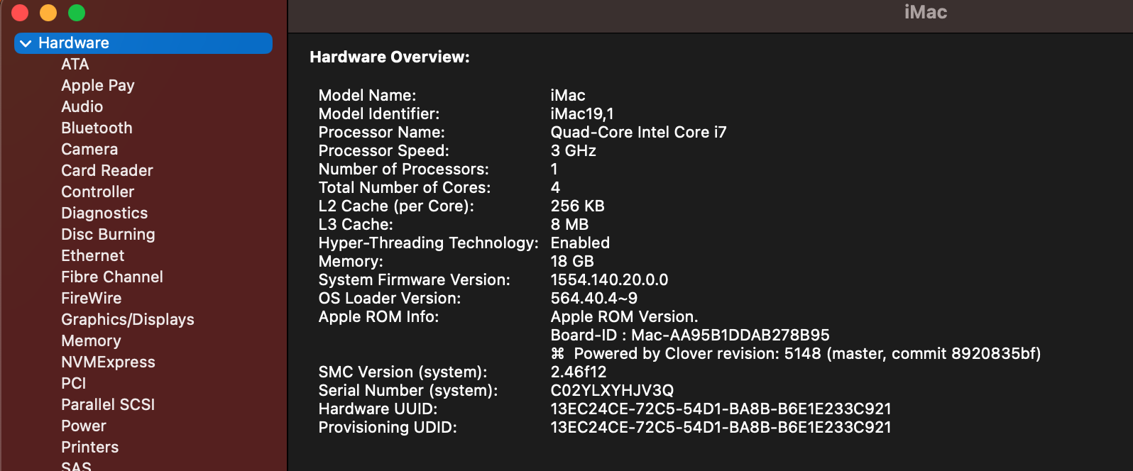

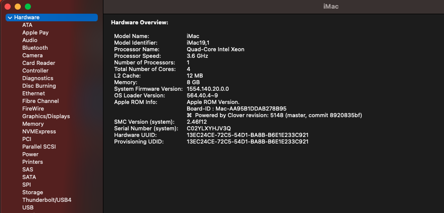

Stefanalmare Posted October 7, 2022 Share Posted October 7, 2022 (edited) 9 hours ago, jsl2000 said: One big issue: only one HDD shown and the other 2 are not recognized Other SATA kexts, scan policy............ Oh, you use clover! I'll try clover and see if I have same issue, and report. Try with attached clover. You have 5148. 9 hours ago, jsl2000 said: OCLP 0.5.0 can patch Kepler GPU GT-730 properly. But Firefox got multiple green glitches on video play Try NVRAM boot-args "ipc_control_port_options=0" Clover_r5149.pkg Edited October 7, 2022 by Stefanalmare 3 Link to comment https://www.insanelymac.com/forum/topic/351969-pre-release-macos-ventura/page/121/#findComment-2794606 Share on other sites More sharing options...
jsl2000 Posted October 7, 2022 Share Posted October 7, 2022 (edited) 1 hour ago, Stefanalmare said: Other SATA kexts, scan policy............ Oh, you use clover! I'll try clover and see if I have same issue, and report. Try with attached clover. You have 5148. Try NVRAM boot-args "ipc_control_port_options=0" Clover_r5149.pkg 7.4 MB · 3 downloads I have installed Clover 5149 before, but it always got instant red screen panic ! Your USB 1.1 Inject.kext also caused the same panic, but its plugins did not. SATA issue should be related to ICH10 problem and can be fixed by this patch now: Edited October 7, 2022 by jsl2000 3 Link to comment https://www.insanelymac.com/forum/topic/351969-pre-release-macos-ventura/page/121/#findComment-2794611 Share on other sites More sharing options...

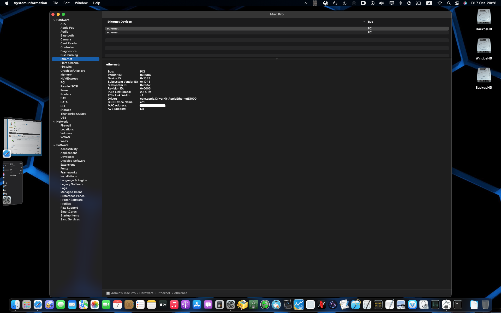

obus Posted October 7, 2022 Share Posted October 7, 2022 (edited) Intel I210 Nic:s seems to be obsolete in macOS Ventura 13 because AppleIntelI210Ethernet.kext is missing in IONetworkingFamily.kext plugin folder. Bad for me and for all X299 user. Edited October 7, 2022 by obus 1 Link to comment https://www.insanelymac.com/forum/topic/351969-pre-release-macos-ventura/page/121/#findComment-2794618 Share on other sites More sharing options...

yapan4 Posted October 7, 2022 Share Posted October 7, 2022 (edited) 3 hours ago, obus said: Intel I210 Nic:s seems to be obsolete in macOS Ventura 13 because AppleIntelI210Ethernet.kext is missing in IONetworkingFamily.kext plugin folder. Bad for me and for all X299 user. Hi. @obus i210 still native supported by macOS Spoiler Edited October 7, 2022 by yapan4 2 Link to comment https://www.insanelymac.com/forum/topic/351969-pre-release-macos-ventura/page/121/#findComment-2794627 Share on other sites More sharing options...
etorix Posted October 7, 2022 Share Posted October 7, 2022 Ventura support by OCLPFrom the page on Ventura support by OCLP, the i210 driver has moved to DriverKit : Quote Removal of Intel Ethernet support Following Network Drivers have been removed: AppleIntel8254XEthernet.kext Intel82574L.kext AppleIntelI210Ethernet.kext (transitioned to DriverKit) 2 Link to comment https://www.insanelymac.com/forum/topic/351969-pre-release-macos-ventura/page/121/#findComment-2794628 Share on other sites More sharing options...

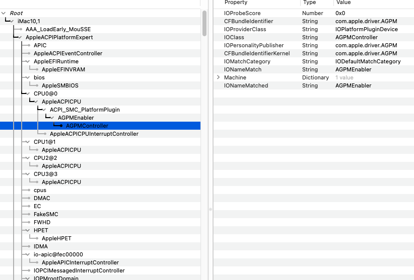

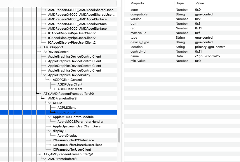

Stefanalmare Posted October 7, 2022 Share Posted October 7, 2022 Using AppleIntelCPUPowerManagement.kext, AppleIntelCPUPowerManagementClient.kext, ASPP-Override.kext I have genuine Power Management on my penryn processor and GPU. No other SSDT's or patches needed. Spoiler Spoiler Link to comment https://www.insanelymac.com/forum/topic/351969-pre-release-macos-ventura/page/121/#findComment-2794631 Share on other sites More sharing options...
axonleo Posted October 7, 2022 Share Posted October 7, 2022 25 minutes ago, Stefanalmare said: Using AppleIntelCPUPowerManagement.kext, AppleIntelCPUPowerManagementClient.kext, ASPP-Override.kext I have genuine Power Management on my penryn processor and GPU. No other SSDT's or patches needed. Reveal hidden contents Reveal hidden contents where do i find that ASPP-Override.kext ? Link to comment https://www.insanelymac.com/forum/topic/351969-pre-release-macos-ventura/page/121/#findComment-2794632 Share on other sites More sharing options...
Slice Posted October 7, 2022 Share Posted October 7, 2022 11 hours ago, RoberT_XeS said: Can you make a guide on how to get powermanagement working...I tried CPU Friend method and also SSDTPRgen method but none seem to work on my E5 1650 V2 Processor See Clover generator in work Xeon E5 2650 v2 1 Link to comment https://www.insanelymac.com/forum/topic/351969-pre-release-macos-ventura/page/121/#findComment-2794633 Share on other sites More sharing options...
