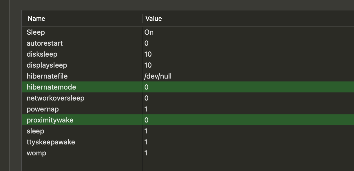

Henties Posted August 29, 2022 Share Posted August 29, 2022 The system clock of my Skylake hack, with Ventura Beta 6 installed, stops advancing during times that the hack is sleeping. As soon as it wakes I get a message that, because time is not synced the machine cannot sync files with the local cloud services. Once the system time has synced again, to a time server nearby, everything is normal and working as it should. I don't have an entry of "APCI000E" in the DSDT.aml therefore I don't believe the problem is fixable with an ACPI patch such as a SSDT-AWAC-HPET-RTC.aml file, tailored for my particular system. Not being able to find APCI000Ein the DSDT indicates that an AWAC clock is not present. I would appreciate any help to solve this nagging problem. The attached uptime folder registers a total of 1:50 hrs. that power to the machine was available, during an actual timespan of close to 4:5 hrs. All of the 1:50 hrs. were accumulated while the machine was NOT asleep, therefore the clock stopped advancing for the period the hack was sleeping. The EFI folder for this hack has also been attached. Greetings Henties EFI.zip Uptime.rtf Link to comment https://www.insanelymac.com/forum/topic/351969-pre-release-macos-ventura/page/101/#findComment-2792182 Share on other sites More sharing options...

Henties Posted August 29, 2022 Share Posted August 29, 2022 @FirstTimeCustomac My BIOS clock is advancing as it should, and a cmos reset has also been performed. I have always been hesitant to feed my EFI with patches that do not make sense to me. It could actually be that the cmos battery is flat and the clock is getting it's power from the PSU when it is fully on, which during sleep the PSU is also on standby and only supplies minimal juice to selected circuits, I will have to check it. Greetings Henties 1 Link to comment https://www.insanelymac.com/forum/topic/351969-pre-release-macos-ventura/page/101/#findComment-2792185 Share on other sites More sharing options...

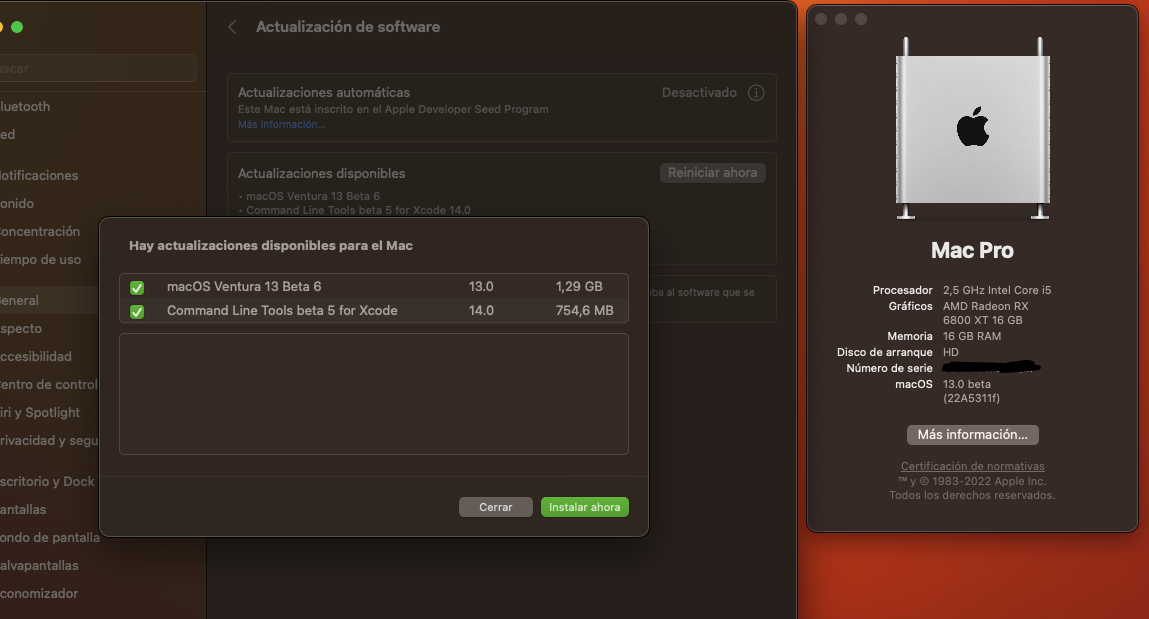

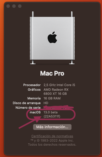

PoMpIs Posted August 29, 2022 Share Posted August 29, 2022 (edited) Two days ago I downloaded the complete beta 6 installer and created a flash drive... you hadn't tried it until today... I tried it in a virtual machine in Unraid... and now after installing the system I see in settings that I marks an update... I look and it shows that it is beta 6 ?¿? 🤪 .. I look at the version that the system marks me before letting it update and I get this: 13.0 Beta (22A5311f) It is not the same version as the beta 6 update .... And the final version of beta 6 is (22A5331f), Which is the one I have in the SSD that I normally use without virtualizing... and in the Lenovo laptop How is it possible that the full install is older than the update? Edited August 29, 2022 by PoMpIs 2 Link to comment https://www.insanelymac.com/forum/topic/351969-pre-release-macos-ventura/page/101/#findComment-2792186 Share on other sites More sharing options...
Henties Posted August 29, 2022 Share Posted August 29, 2022 @FirstTimeCustomac I rechecked my Bios clock and came to the conclusion that I need to replace a flat cmos battery. Here is how I verified that it is probably the cmos clock battery, causing the strange sleep wakeup behaviour. Disable all networking, BT included. Power down the machine for 10 minutes. Boot machine again and observe that your clock, in the menu bar is behind by the amount of time that the machine was switched off. Also observe that the clock is actually running, but stays behind by the amount of switch-off time. Reconnect the machine to the network, and voila, time synchronises with a time server out there, whereafter everything is honkey dory again. Will roll up my sleeves tomorrow and replace the cmos battery. Observing a running clock from the desktop is therefore meaningless because there are extraneous factors that make one believe the clock is actually working correctly, when it is not. Thanks for providing the actual trigger, that encouraged me to think this over again. Greetings Henties 1 Link to comment https://www.insanelymac.com/forum/topic/351969-pre-release-macos-ventura/page/101/#findComment-2792188 Share on other sites More sharing options...
Stefanalmare Posted August 29, 2022 Share Posted August 29, 2022 51 minutes ago, Henties said: @FirstTimeCustomac My BIOS clock is advancing as it should, and a cmos reset has also been performed. I have always been hesitant to feed my EFI with patches that do not make sense to me. It could actually be that the cmos battery is flat and the clock is getting it's power from the PSU when it is fully on, which during sleep the PSU is also on standby and only supplies minimal juice to selected circuits, I will have to check it. Greetings Henties Battery Link to comment https://www.insanelymac.com/forum/topic/351969-pre-release-macos-ventura/page/101/#findComment-2792189 Share on other sites More sharing options...
bisdak4920 Posted August 29, 2022 Share Posted August 29, 2022 2 hours ago, PoMpIs said: Two days ago I downloaded the complete beta 6 installer and created a flash drive... you hadn't tried it until today... I tried it in a virtual machine in Unraid... and now after installing the system I see in settings that I marks an update... I look and it shows that it is beta 6 ?¿? 🤪 .. I look at the version that the system marks me before letting it update and I get this: 13.0 Beta (22A5311f) It is not the same version as the beta 6 update .... And the final version of beta 6 is (22A5331f), Which is the one I have in the SSD that I normally use without virtualizing... and in the Lenovo laptop How is it possible that the full install is older than the update? I have two versions of Ventura installed in my system on two different SSD, one updated and one clean install. I think 22A5331f is the Developer beta and 22A531f is the public beta. Public beta is newer. 1 1 Link to comment https://www.insanelymac.com/forum/topic/351969-pre-release-macos-ventura/page/101/#findComment-2792193 Share on other sites More sharing options...
