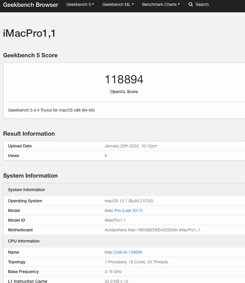

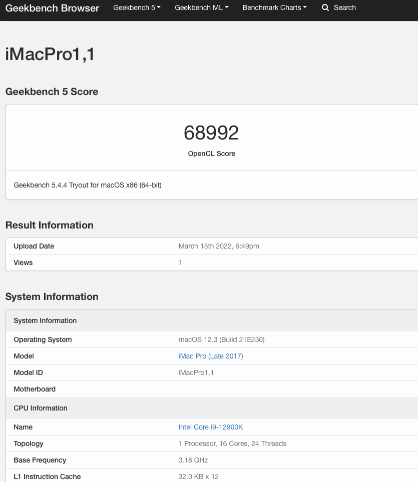

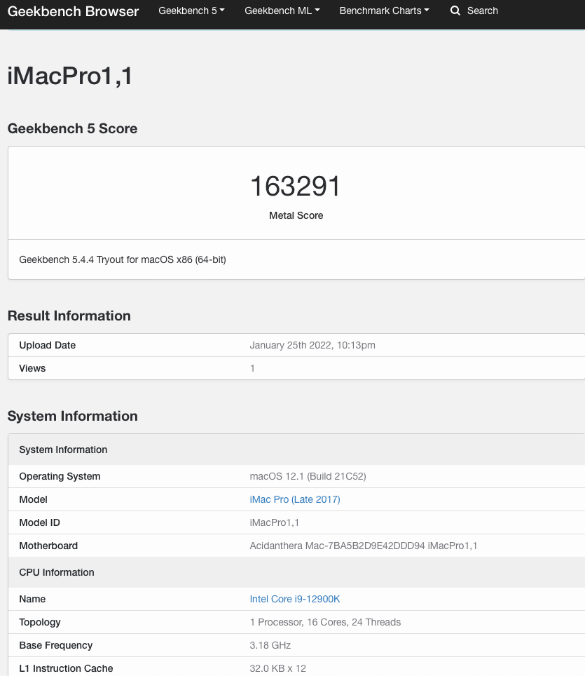

Stefanalmare Posted March 15, 2022 Share Posted March 15, 2022 (edited) Hey guys! Big downsize performance on AMD 6000 series with 12.3. On OpenGL and Metal. See attach: 1,3 before 12.3; 2,4 after. Spoiler Spoiler Spoiler Spoiler Spoiler Edited March 15, 2022 by Stefanalmare Link to comment https://www.insanelymac.com/forum/topic/351099-release-macos-monterey-123/#findComment-2778307 Share on other sites More sharing options...
dehjomz Posted March 15, 2022 Share Posted March 15, 2022 Some 3rd party Radeon 6000 series cards (e.g., 6800, 6800XT, 6900XT etc) is seeing a big performance regression in Metal in 12.3. Link to comment https://www.insanelymac.com/forum/topic/351099-release-macos-monterey-123/#findComment-2778311 Share on other sites More sharing options...

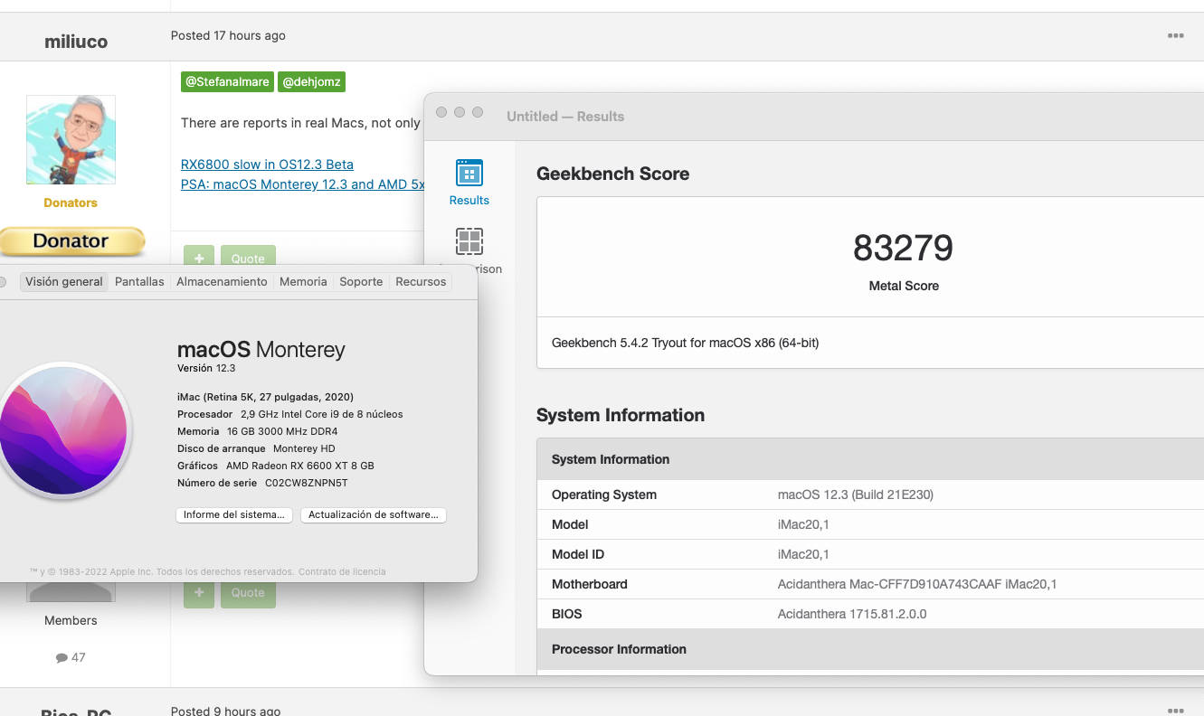

miliuco Posted March 15, 2022 Share Posted March 15, 2022 @Stefanalmare @dehjomz There are reports in real Macs, not only Hacks. I am lucky and my RX 6600 XT seems to be working fine. RX6800 slow in OS12.3 Beta PSA: macOS Monterey 12.3 and AMD 5xxx and 6xxx GPU issues 3 Link to comment https://www.insanelymac.com/forum/topic/351099-release-macos-monterey-123/#findComment-2778326 Share on other sites More sharing options...

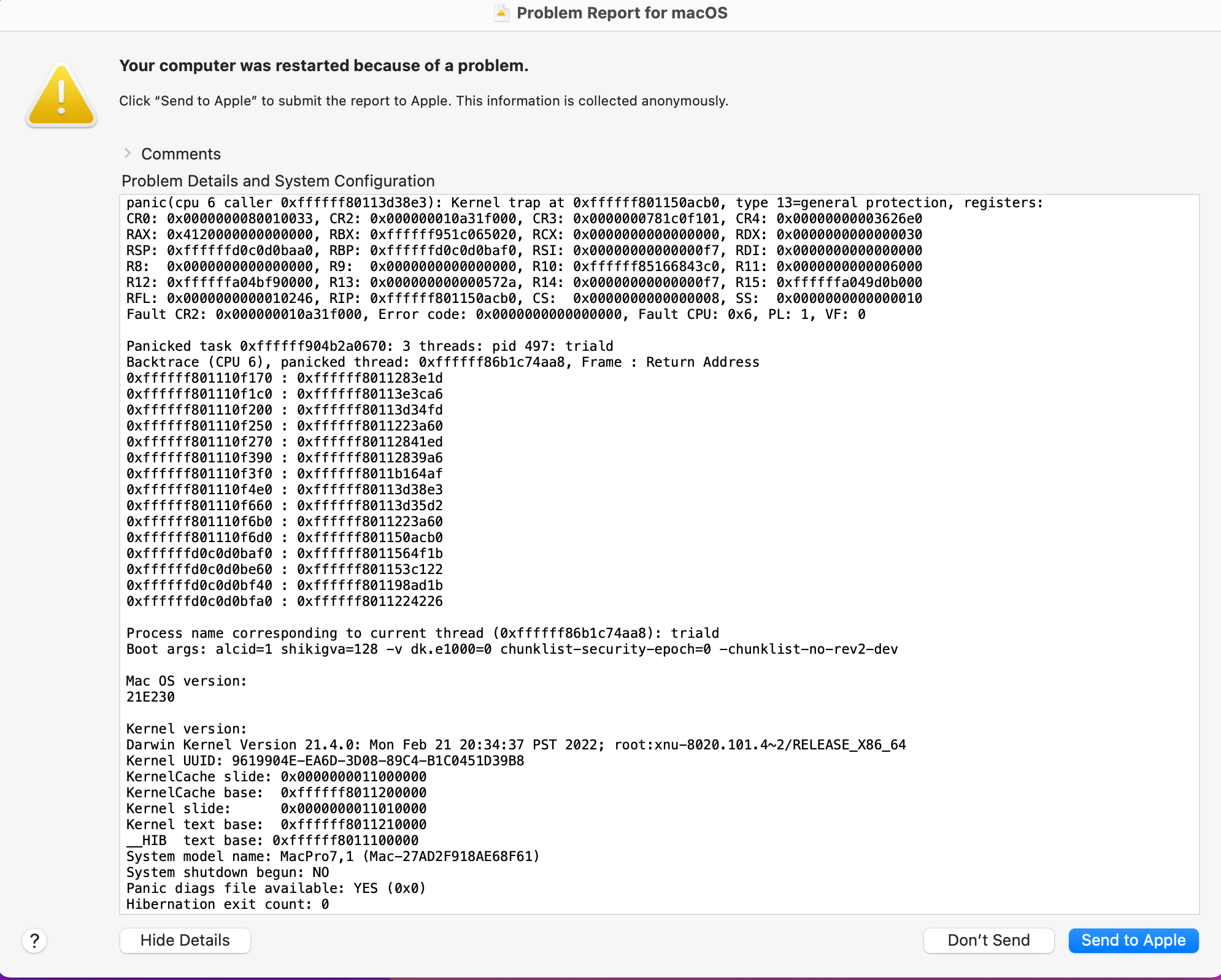

Bios-PC Posted March 16, 2022 Share Posted March 16, 2022 6 hours ago, Slice said: that's not my problem , my problem after login just crash and rebooted can't use the system all the time I got crash after login Link to comment https://www.insanelymac.com/forum/topic/351099-release-macos-monterey-123/#findComment-2778368 Share on other sites More sharing options...
Slice Posted March 16, 2022 Share Posted March 16, 2022 13 minutes ago, Bios-PC said: can't use the system all the time I got crash after login If you think it is related to I225 then I can suggest you to fake the device to something unreal for the kext will not load. I can show you how to do this with Clover if you want. 1 Link to comment https://www.insanelymac.com/forum/topic/351099-release-macos-monterey-123/#findComment-2778369 Share on other sites More sharing options...
Bios-PC Posted March 16, 2022 Share Posted March 16, 2022 17 minutes ago, Slice said: If you think it is related to I225 then I can suggest you to fake the device to something unreal for the kext will not load. I can show you how to do this with Clover if you want. I will disable the ethernet via bios and I will check here is crash report Link to comment https://www.insanelymac.com/forum/topic/351099-release-macos-monterey-123/#findComment-2778370 Share on other sites More sharing options...
Derty Posted March 16, 2022 Share Posted March 16, 2022 everything stays the same here 2 Link to comment https://www.insanelymac.com/forum/topic/351099-release-macos-monterey-123/#findComment-2778373 Share on other sites More sharing options...
miliuco Posted March 16, 2022 Share Posted March 16, 2022 @Derty Do you have this RX 6600 XT in the Z490 motherboard? I say because I don't see it in the signature. Link to comment https://www.insanelymac.com/forum/topic/351099-release-macos-monterey-123/#findComment-2778381 Share on other sites More sharing options...
Slice Posted March 16, 2022 Share Posted March 16, 2022 4 hours ago, Bios-PC said: I will disable the ethernet via bios and I will check here is crash report Too many boot-args, isn't it? Link to comment https://www.insanelymac.com/forum/topic/351099-release-macos-monterey-123/#findComment-2778382 Share on other sites More sharing options...
blaatschaap Posted March 16, 2022 Share Posted March 16, 2022 apparently for that ethernet kernel panic issue above you need to change the "dk.e1000=0" boot arg to "e1000=0" Link to comment https://www.insanelymac.com/forum/topic/351099-release-macos-monterey-123/#findComment-2778385 Share on other sites More sharing options...
Ellybz Posted March 16, 2022 Share Posted March 16, 2022 (edited) 44 minutes ago, blaatschaap said: apparently for that ethernet kernel panic issue above you need to change the "dk.e1000=0" boot arg to "e1000=0" I tried already. no KP but I225 is still with " self-assigned IP address and will not be able to connect to the Internet" Obviously with Preference network reset, etc... Still need to run few more tests with other options associated with e1000=0 Edited March 16, 2022 by Ellybz Link to comment https://www.insanelymac.com/forum/topic/351099-release-macos-monterey-123/#findComment-2778389 Share on other sites More sharing options...
