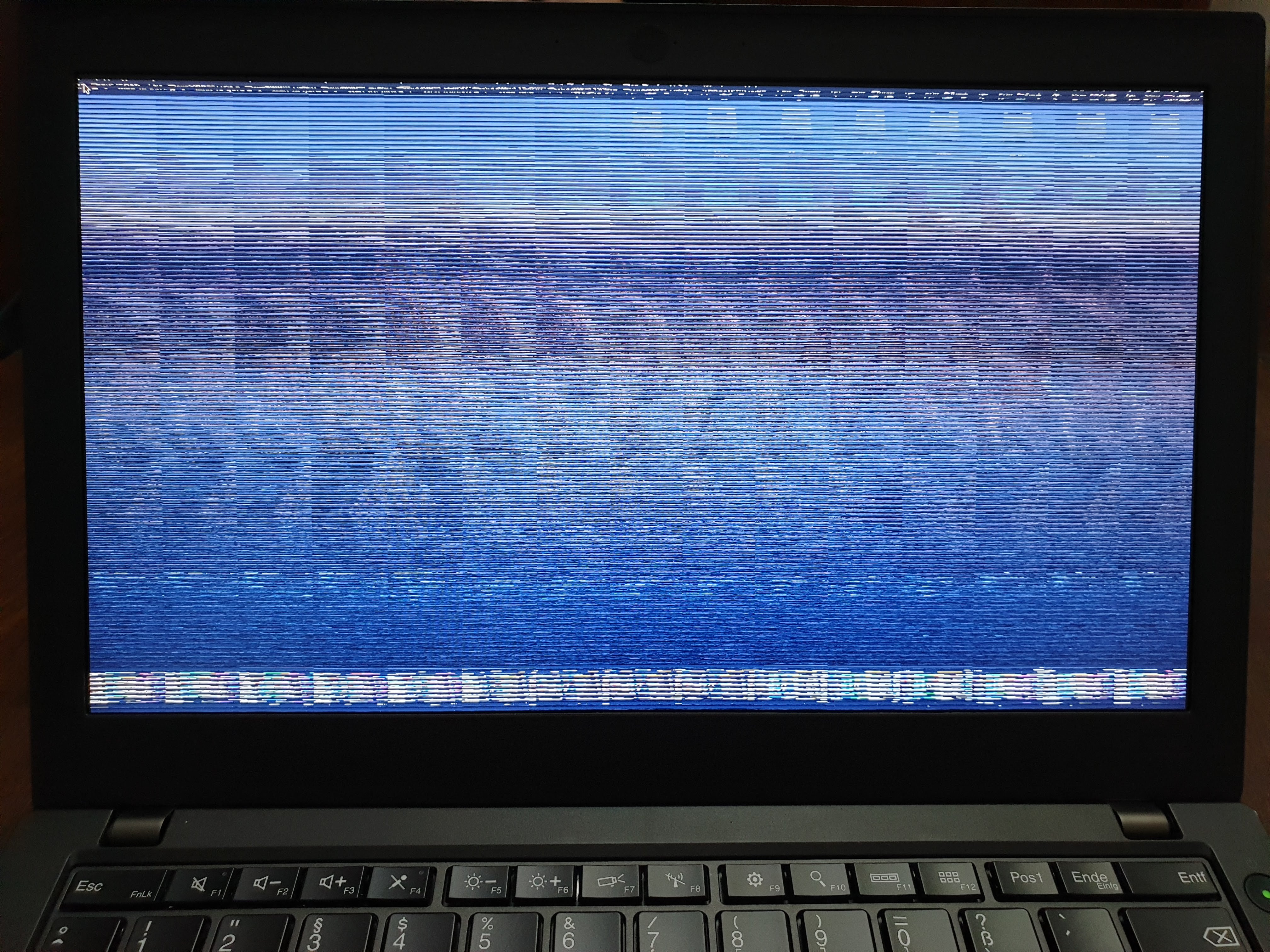

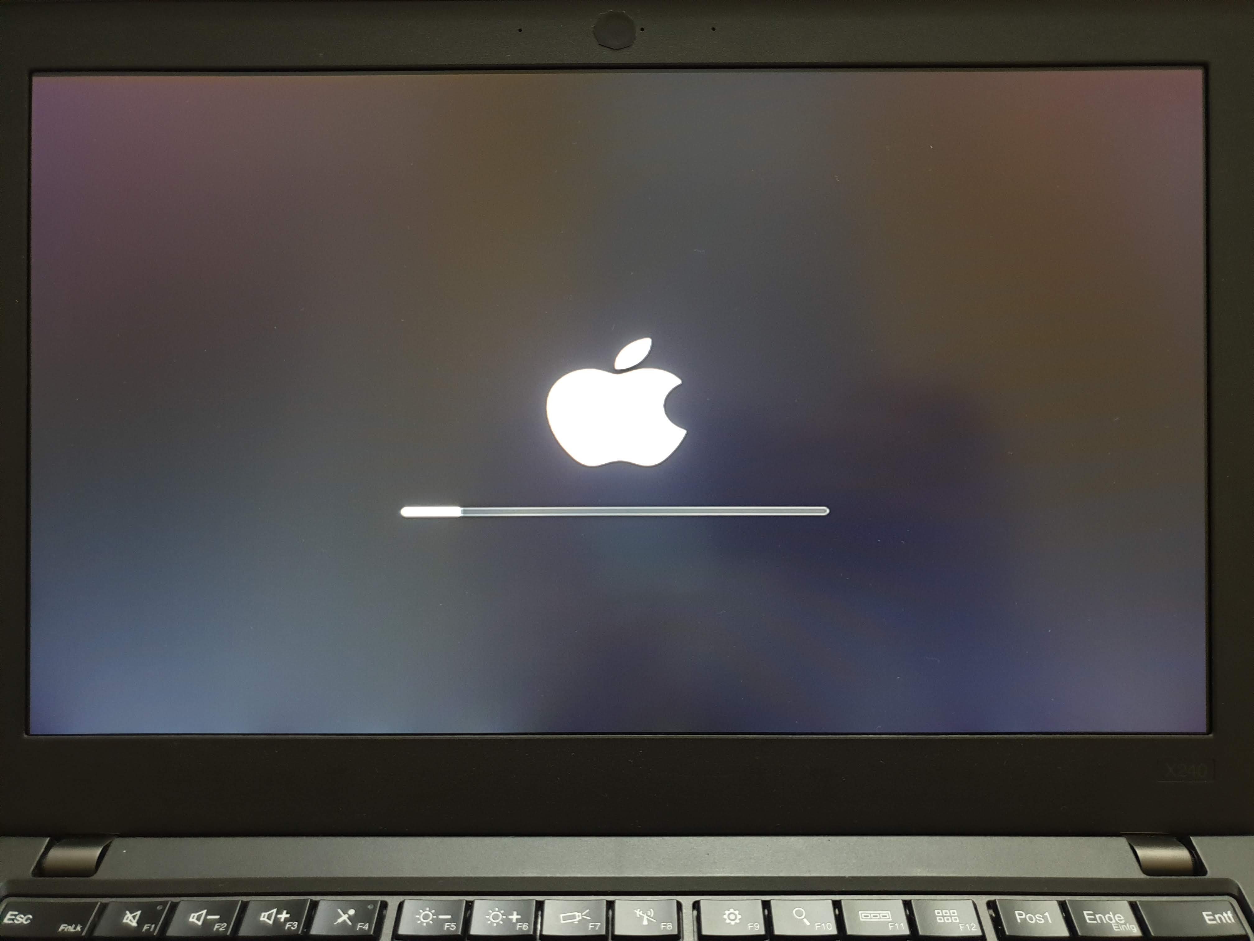

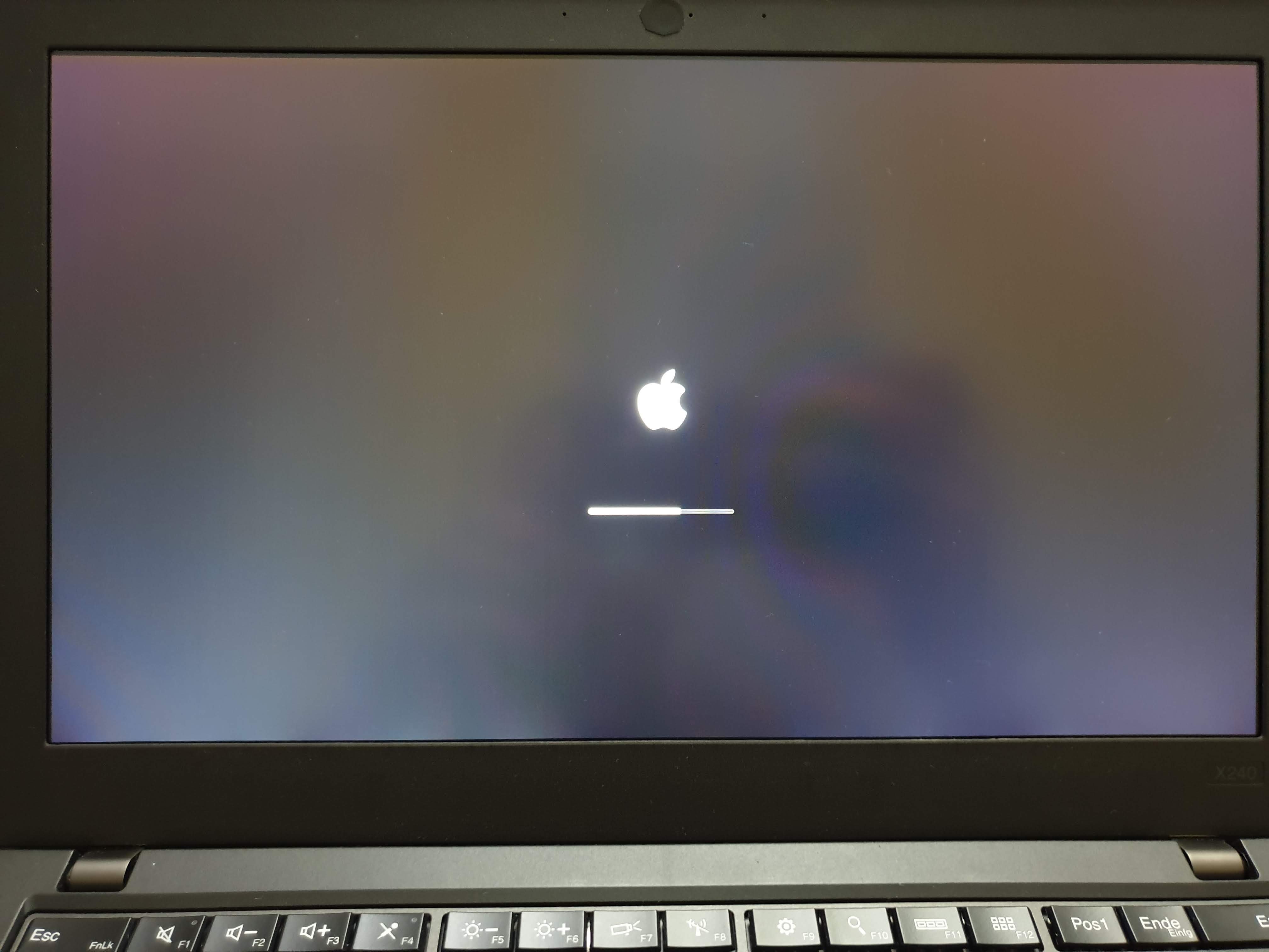

Sniki Posted October 16, 2019 Share Posted October 16, 2019 Hi everyone, What are the necessary Quirks to fix Big Apple boot logo, in short words here is my explained problem: Disabling CSM does show correct size of Apple Boot Logo and OC display scaling correctly but as soon as Apple Logo reaches 60% when it blinks, screen get's garbled like this: However if i close and open the lid (without waiting for sleep, the screen comes back to normal The second option is leaving CSM enabled shows Massive Apple Logo progress bar like this: And when it reaches 60% of the apple boot logo bar (when screen blinks), it goes back to normal and glitches don't occur: So with CSM disabled i get glitchy screen, how to fix that (closing and opening lid is a workaround but it's pain in the a..) CSM enabled Huge OC text (small resolution) and huge apple logo but no glitch (possibly a fix for this if none for glitchy screen with csm disabled) Here is my EFI.zip Link to comment https://www.insanelymac.com/forum/topic/350754-opencore-general-discussion/page/83/#findComment-2693866 Share on other sites More sharing options...
Andrey1970 Posted October 16, 2019 Share Posted October 16, 2019 13 minutes ago, Sniki said: Hi everyone, What are the necessary Quirks to fix Big Apple boot logo, in short words here is my explained problem: Disabling CSM does show correct size of Apple Boot Logo and OC display scaling correctly but as soon as Apple Logo reaches 60% when it blinks, screen get's garbled like this: However if i close and open the lid (without waiting for sleep, the screen comes back to normal The second option is leaving CSM enabled shows Massive Apple Logo progress bar like this: And when it reaches 60% of the apple boot logo bar (when screen blinks), it goes back to normal and glitches don't occur: So with CSM disabled i get glitchy screen, how to fix that (closing and opening lid is a workaround but it's pain in the a..) CSM enabled Huge OC text (small resolution) and huge apple logo but no glitch (possibly a fix for this if none for glitchy screen with csm disabled) Here is my EFI.zip Try ProvideConsoleGop=Yes Link to comment https://www.insanelymac.com/forum/topic/350754-opencore-general-discussion/page/83/#findComment-2693868 Share on other sites More sharing options...
obus Posted October 16, 2019 Share Posted October 16, 2019 (edited) 1 hour ago, Andres ZeroCross said: Try this.. replace OC and BOOT folder with this EFI.zip Sorry but that EFI dosen't work. Stuck at boot menu. Stuck at:StartImage failed- Not Found. It was no debug version so I can't provide any logs. Any other suggestions? Edited October 16, 2019 by obus still stuck at:StartImage failed- Not Found Link to comment https://www.insanelymac.com/forum/topic/350754-opencore-general-discussion/page/83/#findComment-2693874 Share on other sites More sharing options...
Sniki Posted October 16, 2019 Share Posted October 16, 2019 43 minutes ago, Andrey1970 said: Try ProvideConsoleGop=Yes Thanks @Andrey1970 With CSM disabled that didn't fix the glitch, so it's a firmware issue, However i managed to fix with CSM enabled, i set ConsoleMode and Resolution to Max, that fixed the big Apple logo and with CSM enabled the glitch doesn't occur so problem is solved. Link to comment https://www.insanelymac.com/forum/topic/350754-opencore-general-discussion/page/83/#findComment-2693876 Share on other sites More sharing options...

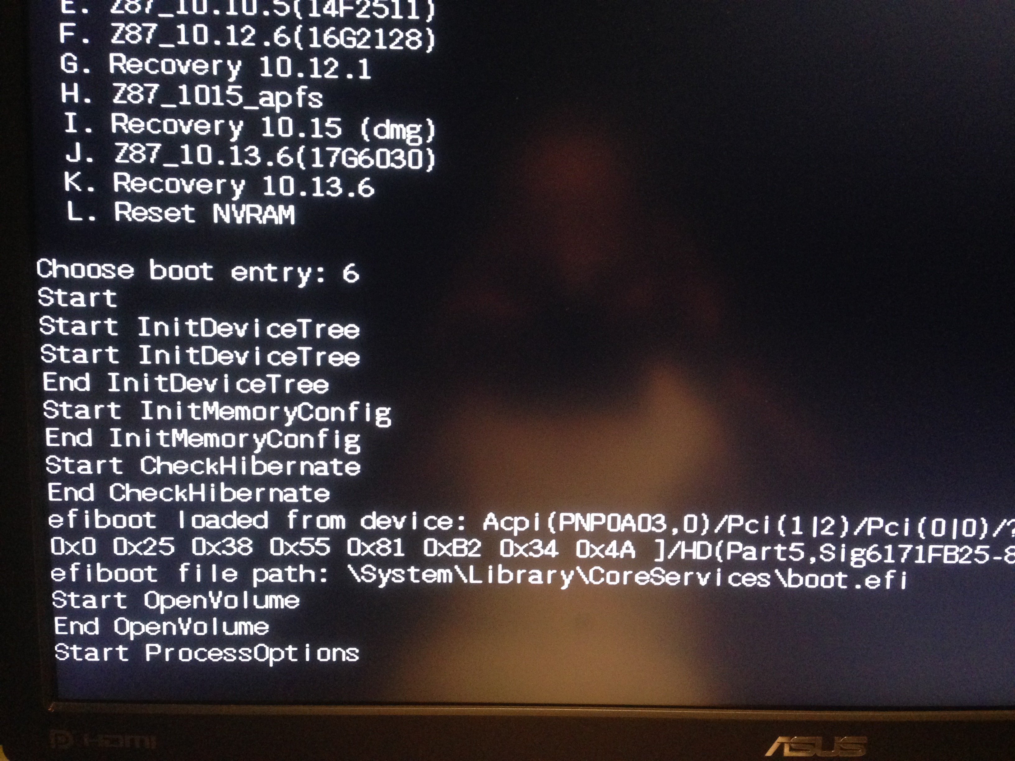

jsl2000 Posted October 17, 2019 Share Posted October 17, 2019 (edited) On 10/13/2019 at 11:37 AM, jsl2000 said: In Z87 hackintosh booting OpenCore 0.5.1 got a different frozen as shown here How to fix it with my OpenCore folder attached here too: Only removal of AMD R9 290X GPU can work on Intel HD 4600 alone now ! [Solved] Need disable Thunderbolt, Fast Boot, & CSM in BIOS. OC.zip Edited October 18, 2019 by jsl2000 Link to comment https://www.insanelymac.com/forum/topic/350754-opencore-general-discussion/page/83/#findComment-2693941 Share on other sites More sharing options...

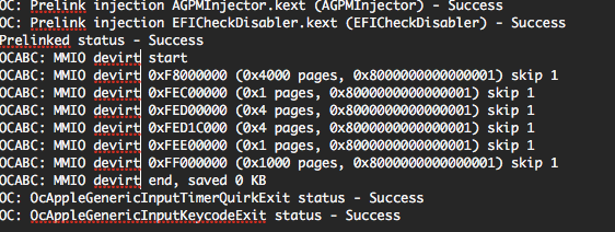

hardcorehenry Posted October 17, 2019 Share Posted October 17, 2019 (edited) I gave a try to new feature in OpenCore MmioWhitelist and I’m a bit confused, because in doc one can read that this feature can reduce stolen memory from 64 to 256 megabytes, in my log it states 0KB saved. Is it how it suppose to look like? Edited October 17, 2019 by hardcorehenry Link to comment https://www.insanelymac.com/forum/topic/350754-opencore-general-discussion/page/83/#findComment-2693962 Share on other sites More sharing options...

mhaeuser Posted October 18, 2019 Share Posted October 18, 2019 @hardcorehenry The whitelist declares what is *not* devirtualised 1 Link to comment https://www.insanelymac.com/forum/topic/350754-opencore-general-discussion/page/83/#findComment-2694039 Share on other sites More sharing options...
