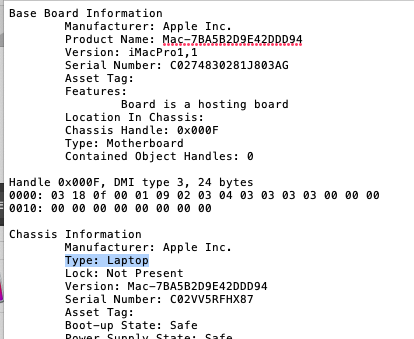

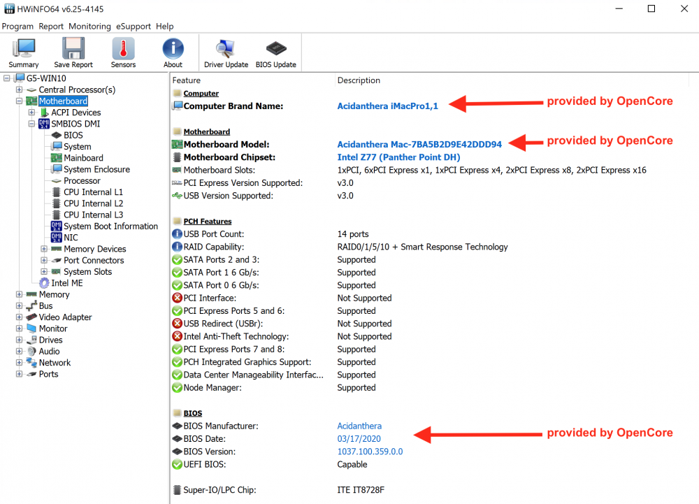

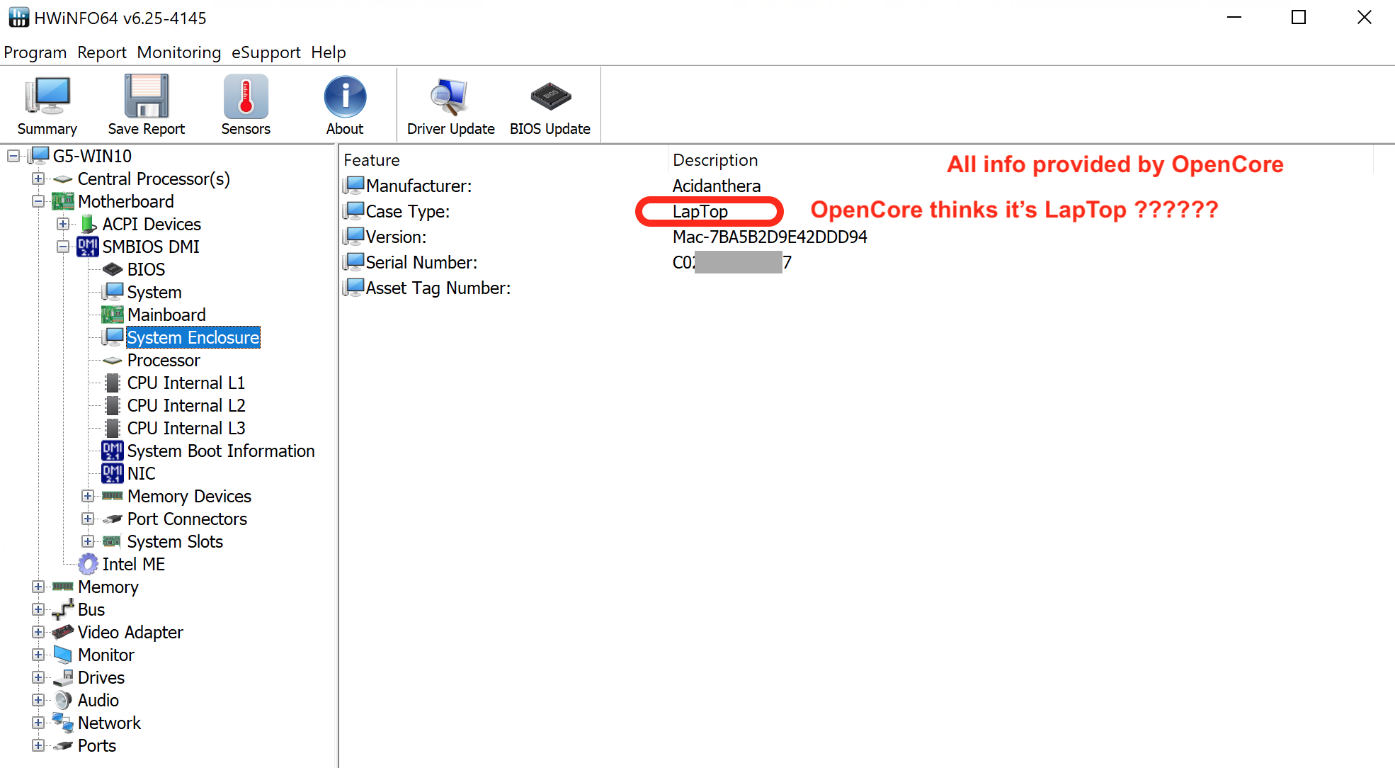

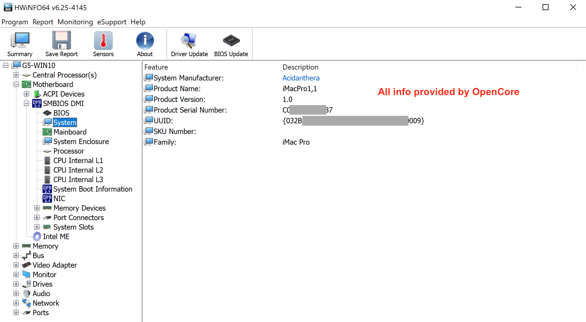

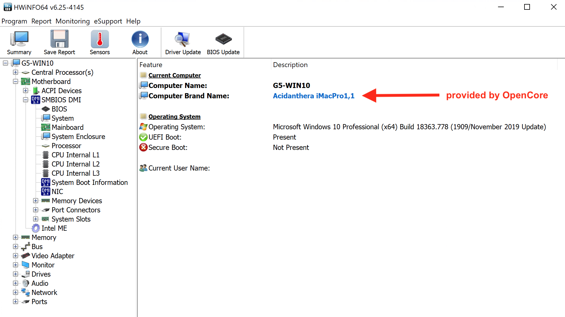

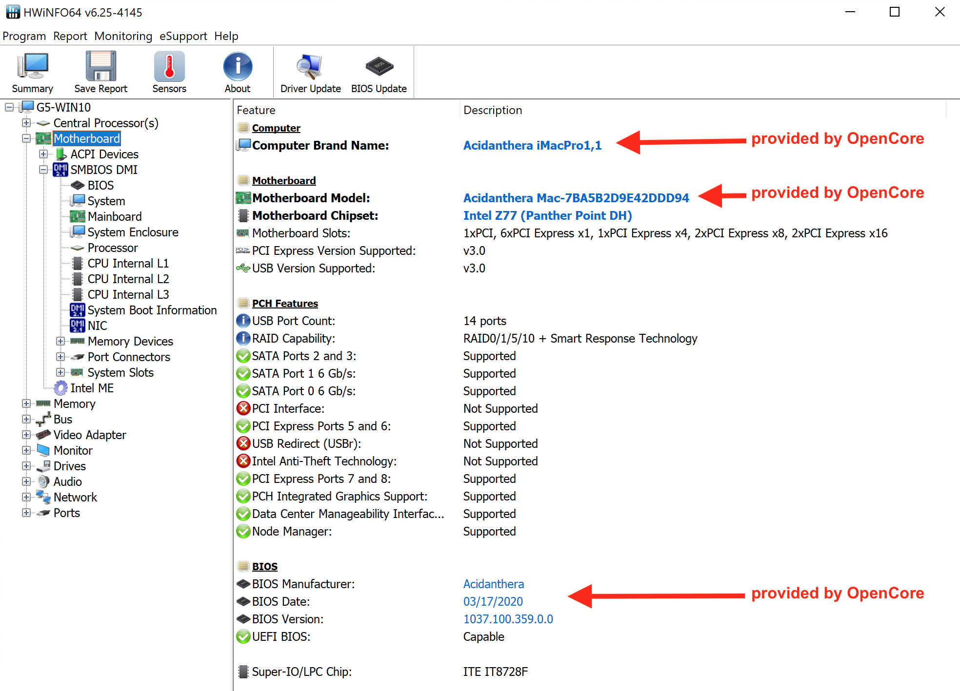

Andrey1970 Posted May 1, 2020 Share Posted May 1, 2020 10 minutes ago, MacNB said: The only strange thing is HwInfo thinks that the Case Type is a LapTop for an iMacPro. Therefore so in real iMacPro1,1. Link to comment https://www.insanelymac.com/forum/topic/350754-opencore-general-discussion/page/176/#findComment-2720413 Share on other sites More sharing options...
MacNB Posted May 1, 2020 Share Posted May 1, 2020 37 minutes ago, Andrey1970 said: Therefore so in real iMacPro1,1. Wow that's pretty sloppy of Apple ! Thanks for the info. It's only cosmetic but I guess I can overwrite that by setting PlatformInfo->SMBIOS->ChassisType to a number equal to Desktop ? Link to comment https://www.insanelymac.com/forum/topic/350754-opencore-general-discussion/page/176/#findComment-2720419 Share on other sites More sharing options...

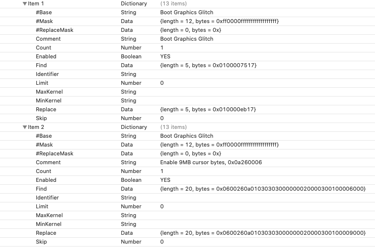

ltooz_audis Posted May 2, 2020 Share Posted May 2, 2020 I have a really big problem with screen flickering black every so often with Haswell HD4400 and HD4600 laptops. The Clover patches work perfectly but I don't know how to patch the OC since it's different, please help me patching these 2: and the other thing is how to set the timeout 5 seconds to boot to Catalina with open canopy graphics. Thanks, Louis Link to comment https://www.insanelymac.com/forum/topic/350754-opencore-general-discussion/page/176/#findComment-2720470 Share on other sites More sharing options...
MacNB Posted May 2, 2020 Share Posted May 2, 2020 9 hours ago, ltooz_audis said: I have a really big problem with screen flickering black every so often with Haswell HD4400 and HD4600 laptops. The Clover patches work perfectly but I don't know how to patch the OC since it's different, please help me patching these 2: and the other thing is how to set the timeout 5 seconds to boot to Catalina with open canopy graphics. Thanks, Louis Those patches will not work because you have not specified in the Identifier field which binary this patch applies to (e.g. driver, kernel, etc). You have to look at your Clover patches (which you did not post here) and use them as the basis for OC patch. Besides, if you use Whatevergreen kext, those patches you are trying should not be necessary. If you want timeout on the boot picker to work, you have to build the latest version of OC 0.5.8. If you do, be warned that the certain fields on the Config files have changed to reflect the changes in the OC features. You have to read the Differences.pdf file to find what has changed and look at the new Samples.plist file. 1 1 Link to comment https://www.insanelymac.com/forum/topic/350754-opencore-general-discussion/page/176/#findComment-2720495 Share on other sites More sharing options...

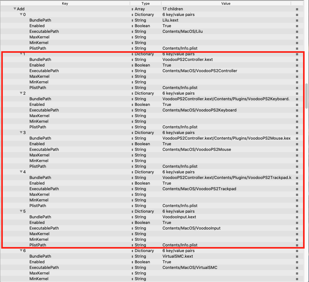

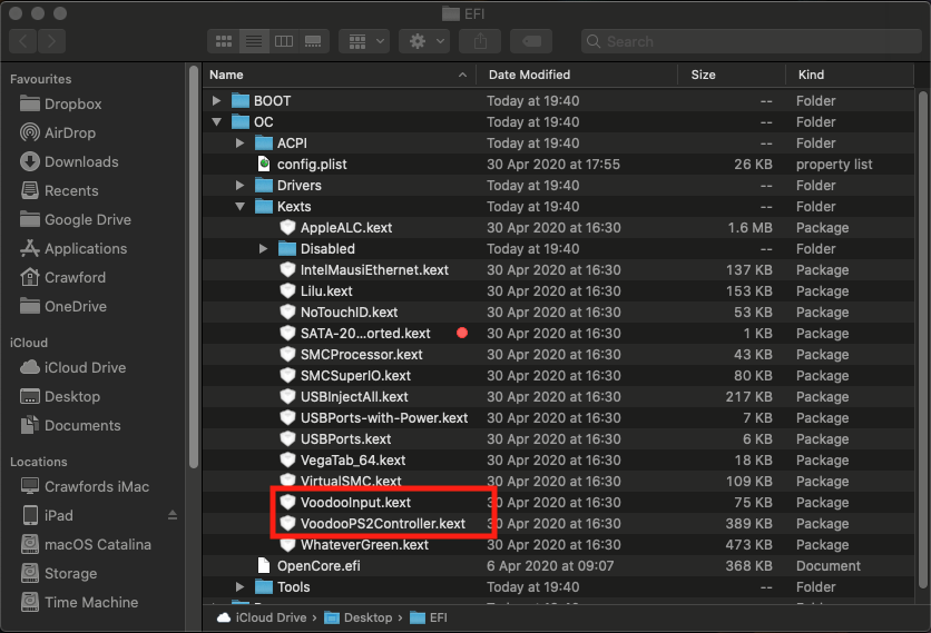

Humanate Posted May 2, 2020 Share Posted May 2, 2020 (edited) I am successfully running opencore on my rig but I didn't create the EFI, got it from Pastrychef over at TM. I am a real noob when it comes to Opencore and the documentation is hard for me to follow. My question is, if I want to remove kexts, how do I do this? I know where the kexts are in EFI/OC/Kexts - so I can remove from there but do I also need to update my config.plist? Can anyone give me an idiots guide on how to do? Edited May 2, 2020 by crawfyp1 Link to comment https://www.insanelymac.com/forum/topic/350754-opencore-general-discussion/page/176/#findComment-2720556 Share on other sites More sharing options...
Matgen84 Posted May 2, 2020 Share Posted May 2, 2020 2 minutes ago, crawfyp1 said: I am successfully running opencore on my rig but I didn't create it, got it from Pastrychef over at TM. I am a real noob when it comes to Opencore and the documentation is hard for me to follow. My question is, if I want to remove kexts, how do I do this? I know where the kexts are in EFI/OC/Kexts - so I can remove from there but do I also need to update my config.plist? Can anyone give me an idiots guide on how to do? Right, if you want to remove kexts from EFI/OC/Kexts, you have to remove in config.plist. For a guide, dortiana support only release: Here Link to comment https://www.insanelymac.com/forum/topic/350754-opencore-general-discussion/page/176/#findComment-2720558 Share on other sites More sharing options...

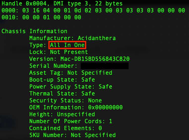

Paksman Posted May 2, 2020 Share Posted May 2, 2020 On 5/1/2020 at 8:03 PM, MacNB said: Wow that's pretty sloppy of Apple ! Thanks for the info. It's only cosmetic but I guess I can overwrite that by setting PlatformInfo->SMBIOS->ChassisType to a number equal to Desktop ? Thanks to @Andrey1970 and this change:https://github.com/acidanthera/MacInfoPkg/commit/a29c9fa2e762cb2c7015a89349f20a8eb5f9934b it is corrected. 1 Link to comment https://www.insanelymac.com/forum/topic/350754-opencore-general-discussion/page/176/#findComment-2720569 Share on other sites More sharing options...
Humanate Posted May 2, 2020 Share Posted May 2, 2020 1 hour ago, Matgen84 said: Right, if you want to remove kexts from EFI/OC/Kexts, you have to remove in config.plist. For a guide, dortiana support only release: Here I have been reading the guide there alot, but much of it is over my head. Let's say I want to remove 2 kexts, VoodoInput.kext and VoodooPS2Controller.kext, shown here: So, would I be able to open the config.plist in ProperTree and remove the info shown here: Then remove the kexts from EFI/OC/KEXTS, save the config.plist and replace in EFI/OC Is that the right way to do it? Excuse my ignorance, I'm completely new to this 1 Link to comment https://www.insanelymac.com/forum/topic/350754-opencore-general-discussion/page/176/#findComment-2720570 Share on other sites More sharing options...
jon7 Posted May 2, 2020 Share Posted May 2, 2020 2 hours ago, crawfyp1 said: I have been reading the guide there alot, but much of it is over my head. Let's say I want to remove 2 kexts, VoodoInput.kext and VoodooPS2Controller.kext, shown here: So, would I be able to open the config.plist in ProperTree and remove the info shown here: Then remove the kexts from EFI/OC/KEXTS, save the config.plist and replace in EFI/OC Is that the right way to do it? Excuse my ignorance, I'm completely new to this Remove Kexts from EFI/OC/KEXTS then run Proper Tree click open navigate to config.plist then open snapshot navigate to OC then open clear snapshot navigate to OC and then Save. Link to comment https://www.insanelymac.com/forum/topic/350754-opencore-general-discussion/page/176/#findComment-2720589 Share on other sites More sharing options...

pastrychef Posted May 3, 2020 Share Posted May 3, 2020 15 hours ago, crawfyp1 said: I am successfully running opencore on my rig but I didn't create the EFI, got it from Pastrychef over at TM. I am a real noob when it comes to Opencore and the documentation is hard for me to follow. My question is, if I want to remove kexts, how do I do this? I know where the kexts are in EFI/OC/Kexts - so I can remove from there but do I also need to update my config.plist? Can anyone give me an idiots guide on how to do? Just delete the kexts from /EFI/OC/Kexts/. Then, delete the associated kexts from config.plist > Kernel > Add. The PS/2 kexts you want to remove don't cause any problems and enables the PS/2 port on the motherboard. Link to comment https://www.insanelymac.com/forum/topic/350754-opencore-general-discussion/page/176/#findComment-2720639 Share on other sites More sharing options...
MacNB Posted May 3, 2020 Share Posted May 3, 2020 16 hours ago, Paksman said: Thanks to @Andrey1970 and this change:https://github.com/acidanthera/MacInfoPkg/commit/a29c9fa2e762cb2c7015a89349f20a8eb5f9934b it is corrected. Thanks @Andrey1970. Those Type codes now match the SMBIOS Spec Page 37 (that Apple clearly ignored). 2 Link to comment https://www.insanelymac.com/forum/topic/350754-opencore-general-discussion/page/176/#findComment-2720669 Share on other sites More sharing options...
