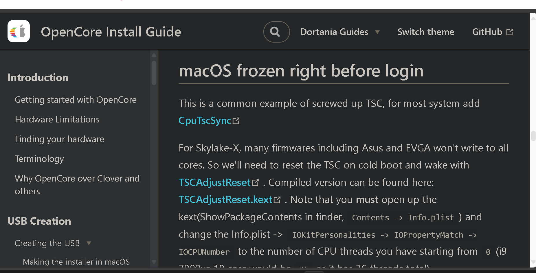

Cpustscsync maybe broken on macOS Monterey · Issue #1676 · acidanthera/bugtracker (github.com)
Tried CpuTscSync.V1.5.3, CpuTscSync, VooDooTSC, TScAdjustReset kext , ResetTSCAdjust.efi,  with no luck,
1. either KP or reboot loop on Monterey
No description available.
2. (actually work on Big Sur on supplement monitor :D sorry for ugly guy, the PC is him ) system freeze before logon screen on Big Sur
Open photo
I think it is still TScSync problem on Big Sur

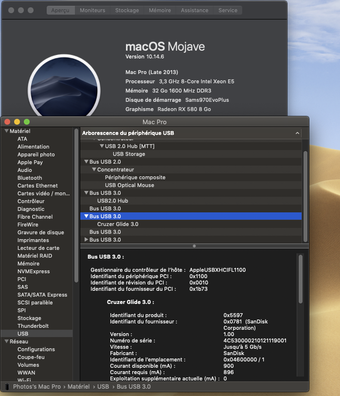

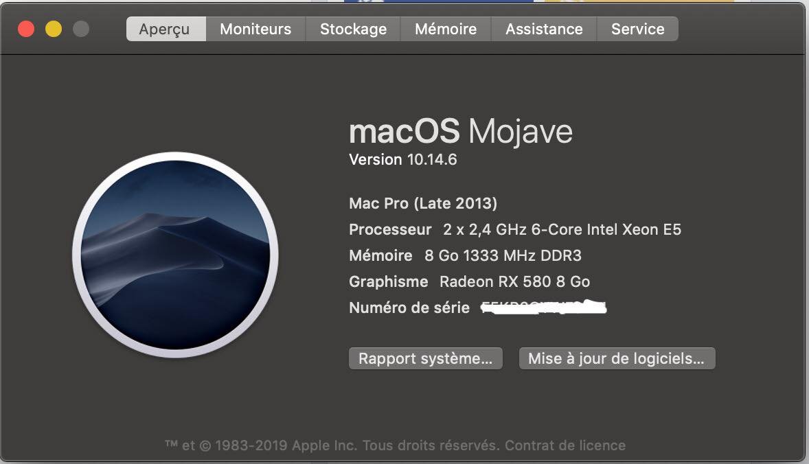

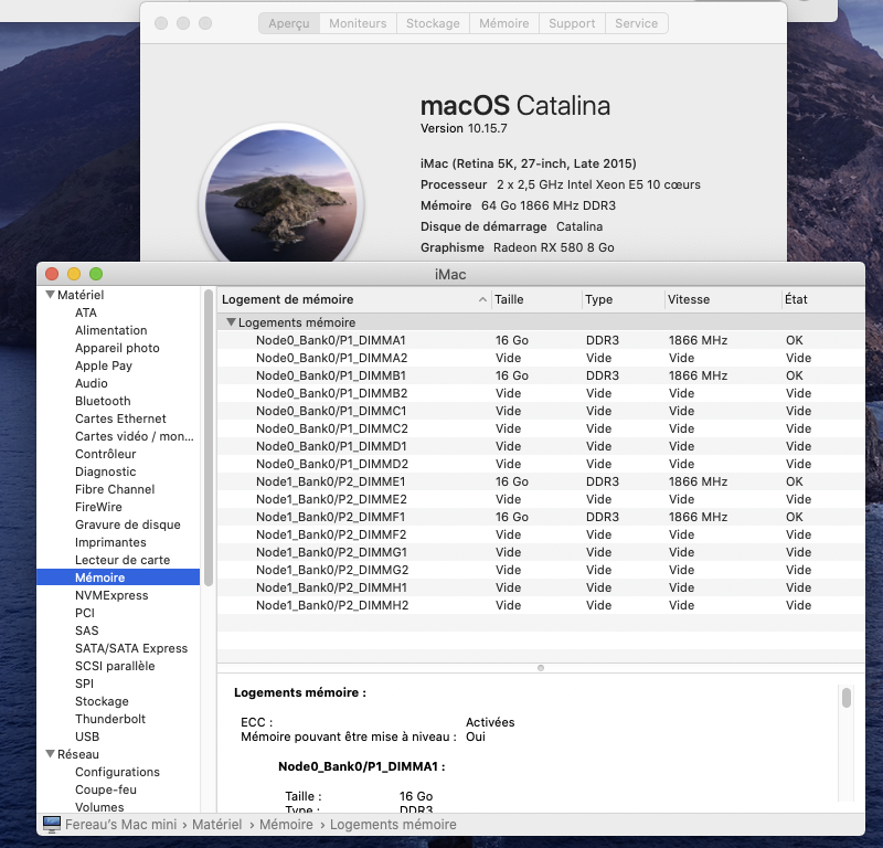

I have successfully installed Mojave on Dual Xeon E5 v2 motherboard (JingSha/Kllisre Dual X79 + 2x E5-2630L v2 Clover), Mojave/Catalina (Supermicro X9DAi + 2x E5-2670 v2 OpenCore) and High Sierra/Mojave/Catalina on a dual X58 (Asus Z8NA-D6 Clover). On a ??? (without name) "X79 Server" board with 2 E5-2697v2, never success, but these mobo doesn't work very well in Windows, then no hope for MacOS.
With Catalina, it is necessary to add MCEReporterDisabler.kext in the EFI because Apple add a reporter to avoid install of 10.15+ on dual socket systems.
This kext doesn't work with 11 Big Sur and higher. I have try (on X9DAi) with an other SMBIOS (iMacPro), Monterey or Big Sur boot without MCEReporterDisabler.kext but the system freeze completely after about 1 minute, if I works with or not.
I think there is a problem with XCPM, probably I should set another setting? I would like also try solutions of these tread, because Sleep is working, but not Wake.
Trying this (and upgrade with the two E5-2697 v2 of the X79 Server) is on my (long!) to-do list
The JingSha/Kllisre Dual X79 needs patches for the RAM. The BIOS shown 12 banks of RAM per CPU and the mobo have only 4 per CPU. These cheap chinese mobo (and X79 Server all well) doesn't have a optimized BIOS... It doesn't have Sleep in Windows nor MacOS.
I try flash the BIOS of X79 Server with the one of a similar HuananZhi, but the chip is too small 😕
Dual processoring is less useful now, because most of the tasks optimized for Multithreading (Cinema4D, ffmpeg, ...) run better now on graphic cards than CPU

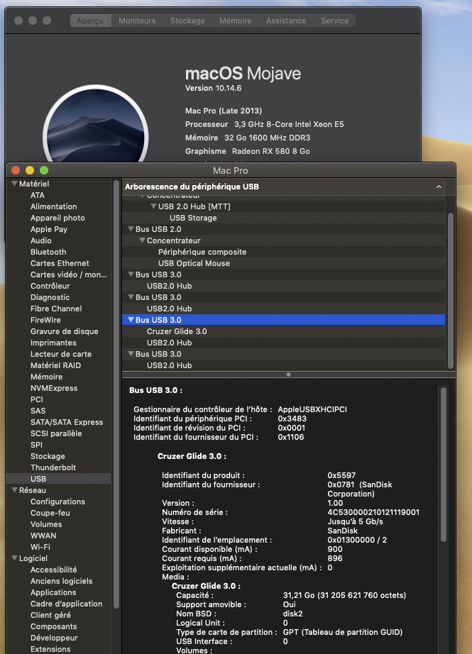

I want also try the patches of this threads on my JingSha X79-P3 mobo.
I had a lot of difficulties to install Mojave on it, because the core count of the Xeon E5-2667 v2 are special (80, 82, 84, 00, 02...) and it was a long way to find how edit the DSDT.aml file
Strangely, these CPU work very well in an real MacPro6,1 but I have recently seen the E5-1680 v2 of a real MacPro having the same core count problem in Hackintoshes.
With another CPU (E5-2630L v2 or E5-2697 v2) there is no need of this kind of DSDT editing
For now, the X79-P3 work relatively well with Mojave, except Wake. Sleep/Wake work in Windows, but if I remember it correctly, not in Linux. I always think this is due to VIA USB 3.0 chip who use the Intel driver for work (on some Hackintoshes, adding an USB 3.0 VIA card broke the working sleep as well) but this tread let me hope another solution.
The FrescoLogic FL1100 USB 3 chip use it's own driver and doesn't make problem
DSDT needs a lot of patches (for CPU, but also for SATA and USB) and I doesn't know if the patches of these thread can work
Since I have added SSDT to enable Turbo Boost (up to 4,0 GHz), the inboard soundcard (ALC 889) doesn't work. Probably I should use the patches of these thread :
Then, the computer will be obsolete (due to long delay) when we have a perfectly working Hackintosh 😆

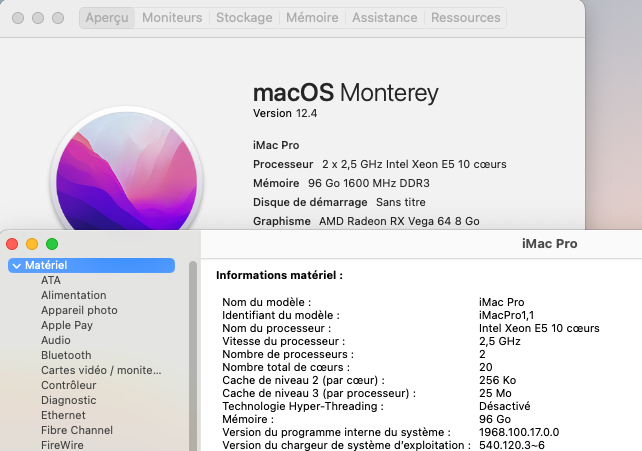

Hi all, @RoberT_XeS, I finally managed to install Monterey on my X79 rig. @MaLd0n says it's the last stable/compatible version for this platform, so I'm wondering how you're doing with Sonoma on your X79 setups, on a day to day basis. No issues? Thanks 🙏
Where did I say that? I told you yesterday that the problem was the kext tsc HERE and if problem is AVX2.0 CPU instruction u can use CryptexFixup
:yoji:
I have very old hardware run new systems HERE
Ok cool! In April 2023 I asked you what OS I could install on this hardware and you said Big Sur or Monterey. So I mistakenly assumed that they were the last iterations I could go with, for compatibility reasons. MY BAD 🙂
I’m currently installing Sonoma, I’ll let you know. Thank you again @MaLd0n, your support to the community is priceless 🤘🖤
