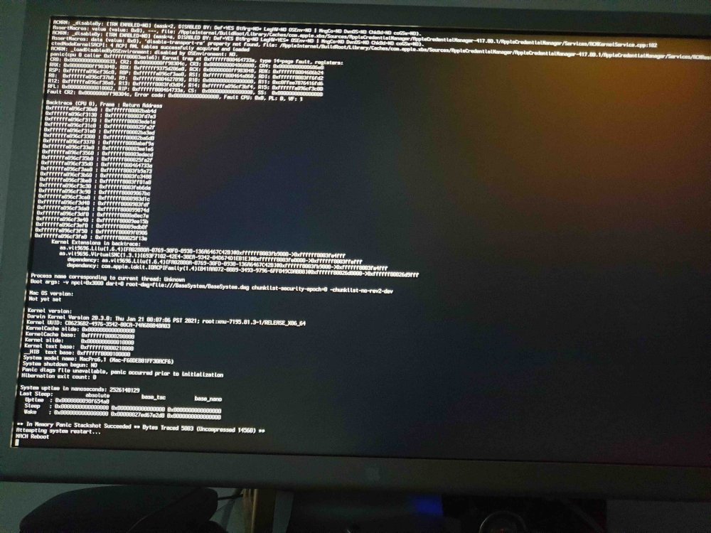

 Hi Robert
I tried VoodoTSCsync and FakeSMC ,Cleaned NVram,  also tried your kexts files  mostly black screen and had to hard reboot, this last was best I got till it KP.
It reboot loops , I got a quick snap shot for you
here is my files last used  .

14 hours ago, drone4zone said:
 Hi Robert

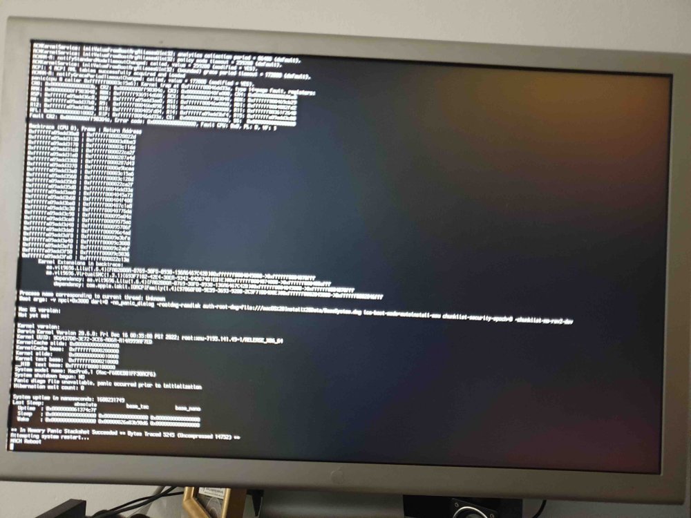

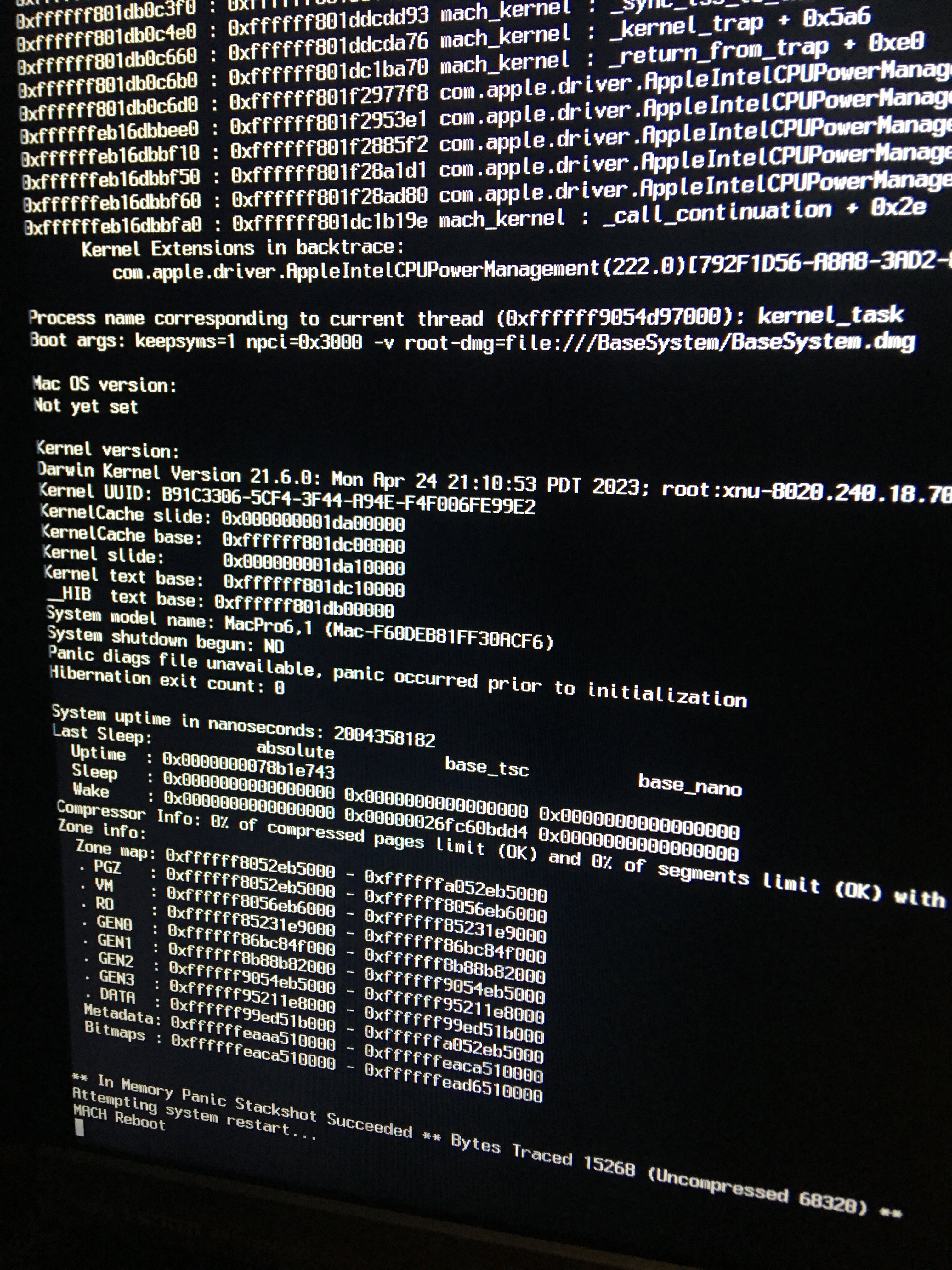

11 hours ago, drone4zone said:
Ok  I tried   EFI and same KP Tried other EFI  and they would not even make it to picker screen only black screen and I  restarted.
here is the best  EFI i at least made it to KP with attatched  with  errors  screen .
My Mojave SSD drive on Clover runs well with SSDTS patching USB 2.0Mojave-patched.zip,AHCIPort patching USB 3.0 GenericUSB kext
  • 2 weeks later...
Try this EFI it should work for you. Just disable AppleIntelCPUPowermanagement.kext and AppleIntelCPUPowerManagementClient.kext under kernel section
https://www.insanelymac.com/applications/core/interface/file/attachment.php?id=387506&key=0a37f4311bcc1cb2f01cdbba0780e9aa
Edited by RoberT_XeS

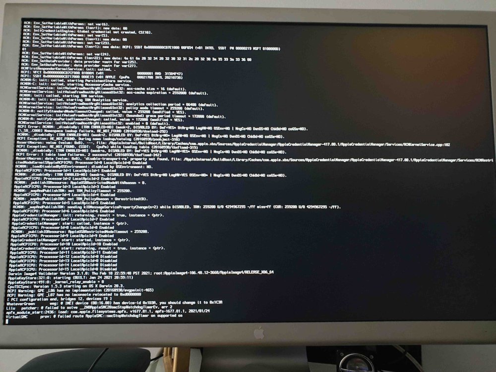

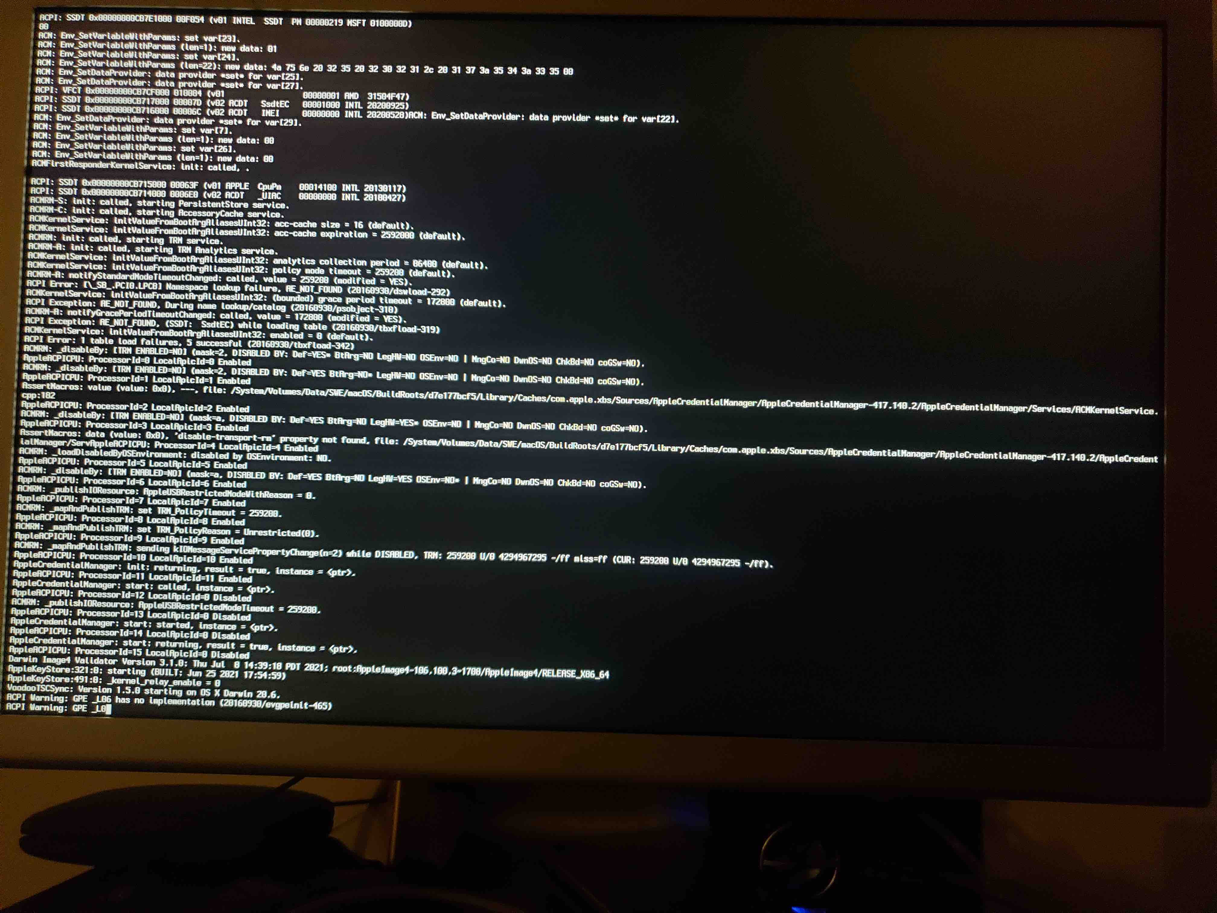

Hangs at this  for over 15 minutes, then it continues  to a quick restart  here is the  snapshot . I also tried VoodoTSCSYncKex. same result. I notice the smbios was different on this EFI  from  macPro6,1  to iMacPro1,1 .
I use OCAuxillaryTools to edit configPlist I only disabled the  two patches under kernel like you mentioned  powerManagement kexts.

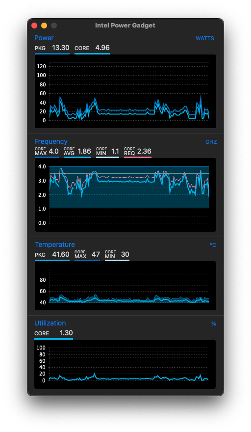

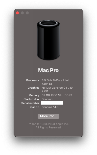

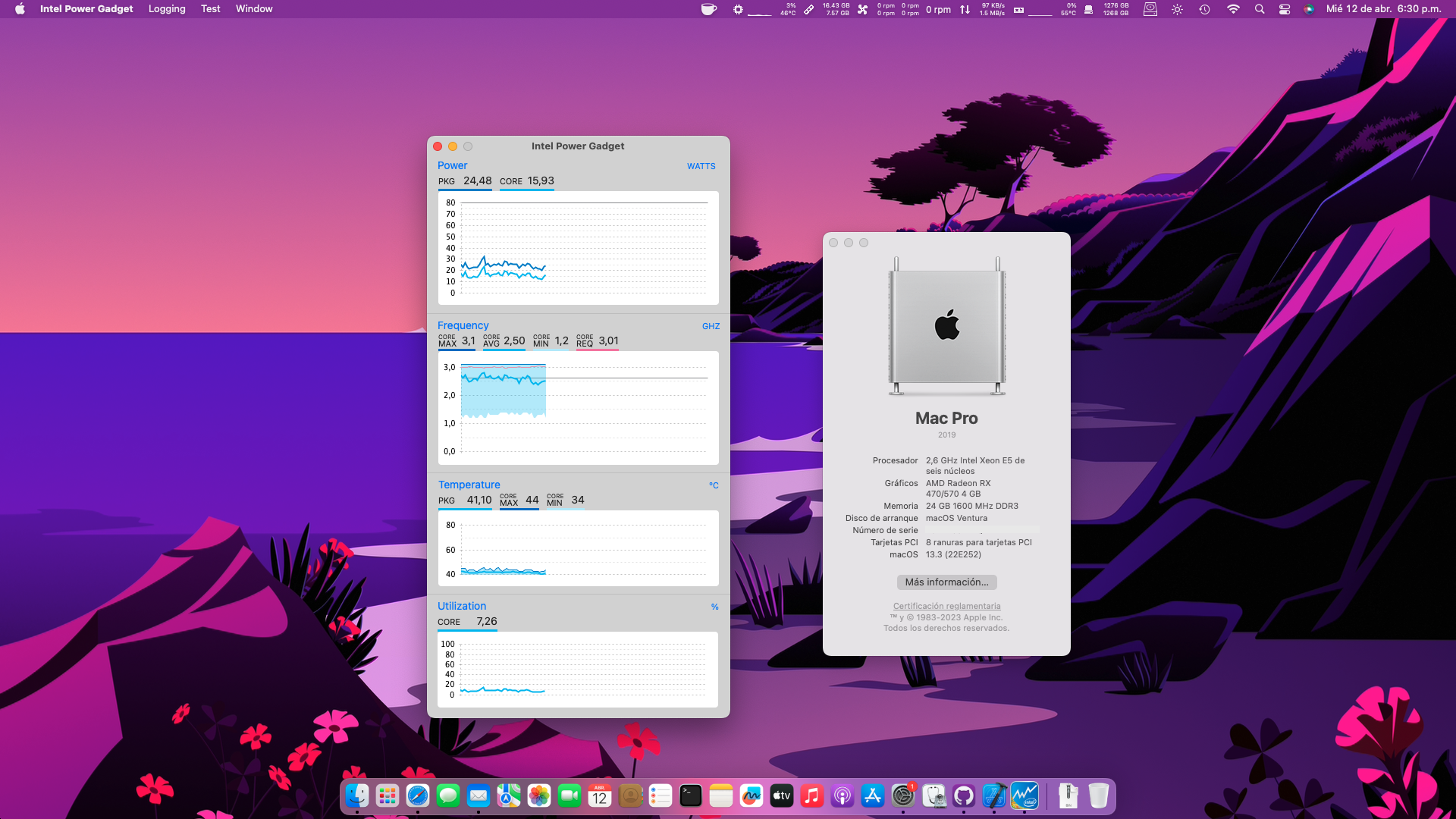

On 4/13/2023 at 5:28 AM, anerik70 said:
Finally!  Ventura with PowerManagement in Chinese Mobo Atermiter X79G.
I had to unlock MSRE2 with a modified Bios using FPT tool under Windows
Use Mac Pro 6,1. It will give you proper Power Management. Look at my PowerManagement.
Screenshot2023-10-09at13_01_59.thumb.png.b8cd73757ead28009b600596fe0fc773.pngScreenshot2023-10-09at12_59_19.png.207716d8dde322e46f543e69e05007c2.png

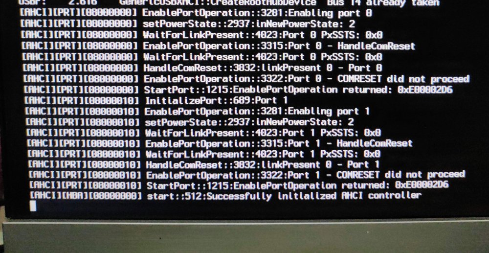

RobertT_XeS motherboard P9X79 processor 4930k graphics card RX 580. I have attached my EFI file and system report. I can't boot, getting an AHCI error. Which opencore patches should I use? Can you patch my config file?
EFI_2_x79.rar 4.5 MB · 0 downloads Results.zip 24.18 kB · 0 downloads Report.htm 937.52 kB · 0 downloads
Try this DSDT and let me know if it works for you
DSDT clean no GFX.amlDSDT Final 2GFX.aml
