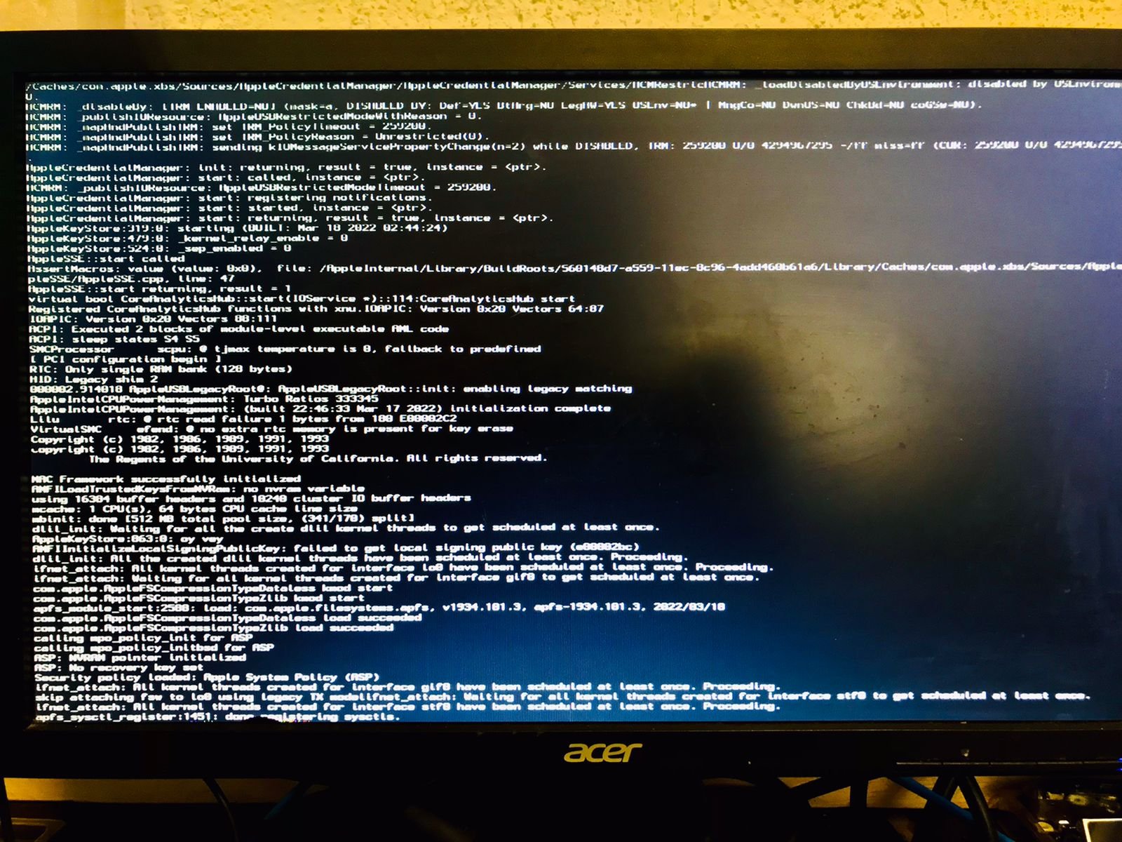

luciano_frc Posted April 11, 2022 Share Posted April 11, 2022 On 4/7/2022 at 5:33 PM, luciano_frc said: hello all right, i have one Huananzhi X79 8D Two Xeon E5 2620 V2 processors VGA RX 470 Sapphire 4G I tried with your EFI folder both the newest and the oldest, and I always get Kernel panic. I believe, it could be, because I use 2 processors, is there any additional configuration I should do? I made a configuration in open core with CPUS=1 Now go ahead with the boot, but I'm stuck at the attached screen. Link to comment Share on other sites More sharing options...
RoberT_XeS Posted April 12, 2022 Author Share Posted April 12, 2022 (edited) On 4/12/2022 at 12:16 AM, luciano_frc said: I made a configuration in open core with CPUS=1 Now go ahead with the boot, but I'm stuck at the attached screen. EFI.zip try this... I have added a modified DSDT for your motherboard. Try and let me know I have removed the resources folder...You can add it Others please don't use this EFI..this is only for Huananzhi X79 8D Edited April 13, 2022 by RoberT_XeS Link to comment Share on other sites More sharing options...
luciano_frc Posted April 13, 2022 Share Posted April 13, 2022 hello all right, sorry for the delay in responding to the topic, but I was doing new tests, so the delay in responding On 4/12/2022 at 5:42 AM, RoberT_XeS said: EFI.zip 5.09 MB · 2 downloads try this... I have added a modified DSDT for your motherboard. Try and let me know I have removed the resources folder...You can add it Others please don't use this EFI..this is only for Huananzhi X79 8D tested this EFI on Huananzhi X79-8D (Dual CPU E5 2620 V2) VGA RX 470 4GB Saphire CPU Info, for my GPU but still, I'm still stuck on this screen below I did some tests with BIG Sur and Catalina, but still, I have been having crashes in the installation and restart of the system taking a look at other posts on the internet, I found a CLOVER EFI that allowed me to install BIG SUR, but I couldn't install Monterey, because I get an error, asking to update the firmware and I can't get out of this screen. in this clover EFI, I don't need to use CPUS=1 because it already has the DSDT for my processor, I just needed to put the Fake ID of my VGA Audio is not working with this Clover EFI But I would like to use OpenCore, to install Monterey My question is.. I'll leave below the Clover EFI I used, it would be possible, then, to use the DSDTs files of this EFI, and convert to your OpenCore EFI is possible !!! clover-5131-bigsur-huanan-2-49b-xeon-e5-2680-v2-rx580-nvme-ssd.zip Link to comment Share on other sites More sharing options...
RoberT_XeS Posted April 14, 2022 Author Share Posted April 14, 2022 18 hours ago, luciano_frc said: hello all right, sorry for the delay in responding to the topic, but I was doing new tests, so the delay in responding tested this EFI on Huananzhi X79-8D (Dual CPU E5 2620 V2) VGA RX 470 4GB Saphire CPU Info, for my GPU but still, I'm still stuck on this screen below I did some tests with BIG Sur and Catalina, but still, I have been having crashes in the installation and restart of the system taking a look at other posts on the internet, I found a CLOVER EFI that allowed me to install BIG SUR, but I couldn't install Monterey, because I get an error, asking to update the firmware and I can't get out of this screen. in this clover EFI, I don't need to use CPUS=1 because it already has the DSDT for my processor, I just needed to put the Fake ID of my VGA Audio is not working with this Clover EFI But I would like to use OpenCore, to install Monterey My question is.. I'll leave below the Clover EFI I used, it would be possible, then, to use the DSDTs files of this EFI, and convert to your OpenCore EFI is possible !!! clover-5131-bigsur-huanan-2-49b-xeon-e5-2680-v2-rx580-nvme-ssd.zip 9.16 MB · 0 downloads You need to update the SMBIOS ..Then it will work... Link to comment Share on other sites More sharing options...
luciano_frc Posted April 18, 2022 Share Posted April 18, 2022 On 4/14/2022 at 2:11 PM, RoberT_XeS said: You need to update the SMBIOS ..Then it will work... correct, I updated SMBIOS But even so, I stop at the same screen, asking for firmware update with clover Link to comment Share on other sites More sharing options...
Slice Posted April 19, 2022 Share Posted April 19, 2022 12 hours ago, luciano_frc said: asking for firmware update with clover This means you have to define ExtendedFirmwareFeatures in Smbios section of config.plist. Clover must be latest not 5131 as I see. Link to comment Share on other sites More sharing options...
luciano_frc Posted April 19, 2022 Share Posted April 19, 2022 1 hour ago, Slice said: This means you have to define ExtendedFirmwareFeatures in Smbios section of config.plist. Clover must be latest not 5131 as I see. Thanks for the info, I'll do some new tests with Clover. at this moment, I'm still trying with opencore, I activated sysreport, to see the errors later here, I still can't load the installation, I'll leave my sysreport below, in case anyone has any tips, what the error might be 00:000 00:000 OC: Setting NVRAM 4D1FDA02-38C7-4A6A-9CC6-4BCCA8B30102:boot-path = PciRoot(0x0)/Pci(0x1D,0x0)/USB(0x0,0x0)/USB(0x3,0x0)/HD(1,GPT,7A5846DA-E5D8-42C0-9421-2644298DC413,0x28,0x64000)/EFI\OC\OpenCore.efi - Invalid Parameter 07:771 07:771 AAPL: #[EB.H.IS|!] Err(0xE) <- RT.GV boot-signature 7C436110-AB2A-4BBB-A880-FE41995C9F82 07:813 00:042 AAPL: #[EB.H.IS|!] Err(0xE) <- RT.GV boot-image-key 7C436110-AB2A-4BBB-A880-FE41995C9F82 07:836 00:022 AAPL: #[EB|H:IS] 0 07:858 00:022 AAPL: #[EB|LOG:INIT] 2022-04-18T17:42:11 07:880 00:022 AAPL: #[EB|VERSION] <"bootbase.efi 540.100.7~23 (Official), built 2022-03-18T00:54:10-0700"> 07:903 00:022 AAPL: #[EB|BUILD] <"BUILD-INFO[308]:{"DisplayName":"bootbase.efi","DisplayVersion":"540.100.7~23","RecordUuid":"95A45EEA-740F-49F0-8EE6-966F338D48AA","BuildTime":"2022-03-18T00:54:10-0700","ProjectName":"efiboot","ProductName":"bootbase.efi","SourceVersion":"540.100.7","BuildVersion":"23","BuildConfiguration":"Release","BuildType":"Official"}"> 07:925 00:022 AAPL: #[EB.CFG.DEV|!] Err(0xE) <- RT.GV booter-strict-xmlparser 7C436110-AB2A-4BBB-A880-FE41995C9F82 07:947 00:022 AAPL: #[EB|CFG:DEV] r5 0x0 0x0 07:969 00:022 AAPL: #[EB|H:IS] 0 07:992 00:022 AAPL: #[EB|WL:MODE] 0 08:014 00:022 AAPL: #[EB|CFG:ARG] boot-save-log 0x0000000000000002 (0x0000000000000002 < 0xFFFFFFFFFFFFFFFF) default 08:036 00:022 AAPL: #[EB|CFG:ARG] wake-save-log 0x0000000000000002 (0x0000000000000002 < 0x0000000000000002) default 08:058 00:022 AAPL: #[EB|CFG:ARG] console 0x0000000000000001 (0x0000000000000001 < 0x0000000000000001) default 08:080 00:022 AAPL: #[EB|CFG:ARG] serial 0x0000000000000001 (0x0000000000000001 < 0x0000000000000000) default 08:103 00:022 AAPL: #[EB|CFG:ARG] preoslog 0x0000000000000001 (0x0000000000000001 < 0xFFFFFFFFFFFFFFFF) default 08:125 00:022 AAPL: #[EB|CFG:ARG] timestamps 0x0000000000000000 (0x0000000000000000 < 0xFFFFFFFFFFFFFFFF) default 08:147 00:022 AAPL: #[EB|CFG:ARG] log-level 0x0000000000000001 (0x0000000000000001 & 0x0000000000000021) default 08:169 00:022 AAPL: #[EB|CFG:ARG] breakpoint 0x0000000000000000 (0x0000000000000000 & 0x0000000000000000) default 08:192 00:022 AAPL: #[EB|CFG:ARG] kc-read-size 0x0000000000100000 (0x0000000000100000 < 0xFFFFFFFFFFFFFFFF) default 08:214 00:022 AAPL: #[EB|H:IS] 0 08:236 00:022 AAPL: #[EB|WL] 0 0 0x01 0x01 0 0x00 08:258 00:022 AAPL: #[EB|BRD:NV] Mac-F60DEB81FF30ACF6 08:281 00:022 AAPL: #[EB|B:VAw] 08:303 00:022 AAPL: #[EB|B:IAw] 08:325 00:022 AAPL: #[EB|WL] 0 0 0x01 0x01 2 0x00 08:348 00:022 AAPL: #[EB.BST.IDT|+] 08:370 00:022 AAPL: #[EB|BM] X86LEGACYAP 08:392 00:022 AAPL: #[EB.BST.IDT|-] 08:415 00:022 AAPL: #[EB|WL] 0 0 0x01 0x01 3 0x00 08:437 00:022 AAPL: #[EB|WL] 0 0 0x01 0x01 4 0x00 08:459 00:022 AAPL: #[EB|BRD:NV] Mac-F60DEB81FF30ACF6 08:481 00:022 AAPL: #[EB|WL] 0 0 0x01 0x01 5 0x00 08:504 00:022 AAPL: #[EB.H.CHK|BM] 0x0000000000000000 08:526 00:022 AAPL: #[EB.H.LV|!] Err(0xE) <- RT.GV boot-signature 7C436110-AB2A-4BBB-A880-FE41995C9F82 08:548 00:022 AAPL: #[EB|WL] 0 0 0x01 0x01 23 0x0E 08:570 00:022 AAPL: #[EB.H.LV|!] Err(0xE) <- RT.GV boot-image-key 7C436110-AB2A-4BBB-A880-FE41995C9F82 08:593 00:022 AAPL: #[EB|WL] 0 0 0x01 0x01 24 0x0E 08:615 00:022 AAPL: #[EB.H.LV|!] Err(0xE) <- RT.GV boot-image 7C436110-AB2A-4BBB-A880-FE41995C9F82 08:637 00:022 AAPL: #[EB.H.LV|!] Err(0xE) <- RT.SV- boot-signature 7C436110-AB2A-4BBB-A880-FE41995C9F82 08:660 00:022 AAPL: #[EB.H.LV|!] Err(0xE) <- RT.SV- boot-image-key 7C436110-AB2A-4BBB-A880-FE41995C9F82 08:682 00:022 AAPL: #[EB.H.LV|!] Err(0xE) <- RT.SV- boot-image 7C436110-AB2A-4BBB-A880-FE41995C9F82 08:704 00:022 AAPL: #[EB|H:NOT] 08:823 00:118 AAPL: #[EB|SB:P] 0x1 08:845 00:022 AAPL: #[EB.B.MN|BM:+SB] 08:867 00:022 AAPL: #[EB|LIMG:DP] Acpi(PNP0A03,0)/Pci(1D|0)/Usb(0, 0)/Usb(3, 0)/HD(Part2,Sig9CE258F7-E6BA-4C14-AB00-E039790CB5DB) 08:889 00:022 AAPL: #[EB|LIMG:FP] \System\Library\CoreServices\boot.efi 08:912 00:022 AAPL: #[EB|LIMG:OPT] 08:934 00:022 AAPL: #[EB|RPS] 0 0 0 08:964 00:029 AAPL: #[EB.OPT.LXF|F] <"\\System\\Library\\CoreServices\\com.apple.Boot.plist"> 08:982 00:018 AAPL: #[EB.LD.LF|IN] 0 1 <"\\System\\Library\\CoreServices\\com.apple.Boot.plist"> <"0"> 09:004 00:022 AAPL: #[EB.LD.OFS|OPEN!] Err(0xE) <"\\System\\Library\\CoreServices\\com.apple.Boot.plist"> 09:027 00:022 AAPL: #[EB.OPT.LXF|LF!] Err(0xE) 09:049 00:022 AAPL: #[EB.OPT.LXF|F] <"Library\\Preferences\\SystemConfiguration\\com.apple.Boot.plist"> 09:071 00:022 AAPL: #[EB.LD.LF|IN] 0 1 <"Library\\Preferences\\SystemConfiguration\\com.apple.Boot.plist"> <"0"> 09:103 00:031 AAPL: #[EB|KF] <"root-dmg=file:///BaseSystem/BaseSystem.dmg"> 09:121 00:018 AAPL: #[EB|MBA:CL] <""> 09:143 00:022 AAPL: #[EB|MBA:NV] <"-v keepsyms=1 debux=0x100 alcid=1"> 09:166 00:022 AAPL: #[EB|MBA:KF] <"root-dmg=file:///BaseSystem/BaseSystem.dmg"> 09:188 00:022 AAPL: #[EB|MBA:OUT] <"-v keepsyms=1 debux=0x100 alcid=1 root-dmg=file:///BaseSystem/BaseSystem.dmg chunklist-security-epoch=0 -chunklist-no-rev2-dev"> 09:210 00:022 AAPL: #[EB|LOG:VERBOSE] 2022-04-18T17:42:12 09:232 00:022 AAPL: #[EB|OPT:BM] 0x200002 09:255 00:022 AAPL: #[EB.OPT.LXF|F] <"\\System\\Library\\CoreServices\\PlatformSupport.plist"> 09:277 00:022 AAPL: #[EB.LD.LF|IN] 0 1 <"\\System\\Library\\CoreServices\\PlatformSupport.plist"> <"0"> 09:306 00:029 AAPL: #[EB|P:CPR] N 09:324 00:018 AAPL: #[EB|P:MPI] Y 09:347 00:022 AAPL: #[EB.P.DCMOSP|!] Err(0xE) <- RT.GV AAPL,PanicInfoLog 7C436110-AB2A-4BBB-A880-FE41995C9F82 09:377 00:030 AAPL: #[EB|P:LOG1] 09:399 00:022 AAPL: #[EB|P:BPI] N 09:422 00:022 AAPL: 09:444 00:022 AAPL: ************************************************** 09:466 00:022 AAPL: This system was automatically rebooted after panic 09:489 00:022 AAPL: ************************************************** 14:522 05:032 AAPL: #[EB|MBA:CL] <"-v keepsyms=1 debux=0x100 alcid=1 root-dmg=file:///BaseSystem/BaseSystem.dmg chunklist-security-epoch=0 -chunklist-no-rev2-dev"> 16:626 02:104 AAPL: #[EB|MBA:NV] <"<null string>"> 16:650 00:024 AAPL: #[EB|MBA:KF] <"<null string>"> 16:686 00:035 AAPL: #[EB|MBA:OUT] <"-v keepsyms=1 debux=0x100 alcid=1 root-dmg=file:///BaseSystem/BaseSystem.dmg chunklist-security-epoch=0 -chunklist-no-rev2-dev chunklist-security-epoch=0 -chunklist-no-rev2-dev"> 16:710 00:023 AAPL: #[EB|KMR] 499052544 16:733 00:023 AAPL: #[EB.CS.CSKSD|+] 16:761 00:028 AAPL: #[EB.CS.CSKSD|!] Err(0xE) <- RT.GV boot-info-payload 8D63D4FE-BD3C-4AAD-881D-86FD974BC1DF 16:785 00:023 AAPL: #[EB.G.CS|-?] Ok(0) 16:810 00:025 AAPL: #[EB.LD.LF|IN] 0 1 <"<null string>"> <"1"> 16:878 00:067 AAPL: #[EB.B.SBS|SZ] 723512 16:905 00:026 AAPL: #[EB|B:SHA] <c35b58c39dc8d0820df41b446facb27c95a3e016> 16:933 00:028 AAPL: #[EB.WL.PWLFNV|!] Err(0xE) <- RT.GV wake-failure 7C436110-AB2A-4BBB-A880-FE41995C9F82 16:958 00:024 AAPL: #[EB.WL.DT|!] Err(0xE) <- EB.WL.PWLFNV 17:077 00:119 AAPL: #[EB.WL.PWLFRTC|NONE] 17:102 00:024 AAPL: #[EB.WL.DT|!] Err(0xE) <- EB.WL.PWLFRTC 17:131 00:028 AAPL: #[EB.LD.LKC|D] <"System\Library\KernelCollections\BootKernelExtensions.kc.development"> 17:161 00:030 AAPL: #[EB.LD.LF|IN] 0 1 <"System\\Library\\KernelCollections\\BootKernelExtensions.kc.development"> <"0"> 17:190 00:029 AAPL: #[EB.LD.OFS|OPEN!] Err(0xE) <"System\\Library\\KernelCollections\\BootKernelExtensions.kc.development"> 17:218 00:027 AAPL: #[EB.LD.LKC|R.2] <"System\Library\KernelCollections\BootKernelExtensions.kc"> 17:247 00:029 AAPL: #[EB.LD.LF|IN] 0 1 <"System\\Library\\KernelCollections\\BootKernelExtensions.kc"> <"0"> 25:600 08:352 OC: Prelinked injection VoodooHDA.kext (VoodooHDA.kext) - Invalid Parameter 26:293 00:692 AAPL: #[EB|SB:P] 0x1 26:318 00:024 AAPL: #[EB|SB:SBGMFNS] x86legacyap.im4m 26:346 00:028 AAPL: #[EB|SB:MF] System\\Library\\KernelCollections\\BootKernelExtensions.kc.x86legacyap.im4m 26:376 00:029 AAPL: #[EB.LD.LF|IN] 0 1 <"System\\Library\\KernelCollections\\BootKernelExtensions.kc.x86legacyap.im4m"> <"0"> 26:881 00:504 AAPL: #[EB|SB:MKRN] 26:918 00:037 AAPL: #[EB.LD.LKFS|-?] Ok(0) 26:942 00:023 AAPL: #[EB.LD.LKC|-?] Ok(0) 26:965 00:023 AAPL: #[EB|BST:REV1] 26:989 00:023 AAPL: #[EB|CSR:IN] 0x00000FFF 27:013 00:024 AAPL: #[EB|CSR:OUT] 0x00000FEF 27:043 00:029 AAPL: #[EB.BST.FBS|+] 27:064 00:021 AAPL: #[EB.BST.FBS|ADSZ] 0 27:088 00:023 AAPL: #[EB.BST.FBS|KSSZ] 0 27:113 00:024 AAPL: #[EB|SB:SBGMFNS] x86legacyap.im4m 27:138 00:025 AAPL: #[EB|RH:PF] usr\standalone\OS.dmg.root_hash 27:166 00:027 AAPL: #[EB|RH:MF] <"usr\\standalone\\OS.dmg.root_hash.x86legacyap.im4m"> 27:192 00:026 AAPL: #[EB.LD.LF|IN] 0 1 <"usr\\standalone\\OS.dmg.root_hash"> <"0"> 27:219 00:027 AAPL: #[EB.LD.OFS|OPEN!] Err(0xE) <"usr\\standalone\\OS.dmg.root_hash"> 27:244 00:024 AAPL: #[EB.RH.LRH|P!] Err(0xE) <- EB.LD.LF 27:269 00:025 AAPL: #[EB.BST.FBS|!] Err(0xE) <- EB.RH.LRH 27:294 00:024 AAPL: #[EB|LOG:DT] 2022-04-18T17:42:30 27:319 00:025 AAPL: #[EB|LOG:EXITBS:START] 2022-04-18T17:42:30 Link to comment Share on other sites More sharing options...
RoberT_XeS Posted April 19, 2022 Author Share Posted April 19, 2022 (edited) 4 hours ago, luciano_frc said: Thanks for the info, I'll do some new tests with Clover. at this moment, I'm still trying with opencore, I activated sysreport, to see the errors later here, I still can't load the installation, I'll leave my sysreport below, in case anyone has any tips, what the error might be 00:000 00:000 OC: Setting NVRAM 4D1FDA02-38C7-4A6A-9CC6-4BCCA8B30102:boot-path = PciRoot(0x0)/Pci(0x1D,0x0)/USB(0x0,0x0)/USB(0x3,0x0)/HD(1,GPT,7A5846DA-E5D8-42C0-9421-2644298DC413,0x28,0x64000)/EFI\OC\OpenCore.efi - Invalid Parameter 07:771 07:771 AAPL: #[EB.H.IS|!] Err(0xE) <- RT.GV boot-signature 7C436110-AB2A-4BBB-A880-FE41995C9F82 07:813 00:042 AAPL: #[EB.H.IS|!] Err(0xE) <- RT.GV boot-image-key 7C436110-AB2A-4BBB-A880-FE41995C9F82 07:836 00:022 AAPL: #[EB|H:IS] 0 07:858 00:022 AAPL: #[EB|LOG:INIT] 2022-04-18T17:42:11 07:880 00:022 AAPL: #[EB|VERSION] <"bootbase.efi 540.100.7~23 (Official), built 2022-03-18T00:54:10-0700"> 07:903 00:022 AAPL: #[EB|BUILD] <"BUILD-INFO[308]:{"DisplayName":"bootbase.efi","DisplayVersion":"540.100.7~23","RecordUuid":"95A45EEA-740F-49F0-8EE6-966F338D48AA","BuildTime":"2022-03-18T00:54:10-0700","ProjectName":"efiboot","ProductName":"bootbase.efi","SourceVersion":"540.100.7","BuildVersion":"23","BuildConfiguration":"Release","BuildType":"Official"}"> 07:925 00:022 AAPL: #[EB.CFG.DEV|!] Err(0xE) <- RT.GV booter-strict-xmlparser 7C436110-AB2A-4BBB-A880-FE41995C9F82 07:947 00:022 AAPL: #[EB|CFG:DEV] r5 0x0 0x0 07:969 00:022 AAPL: #[EB|H:IS] 0 07:992 00:022 AAPL: #[EB|WL:MODE] 0 08:014 00:022 AAPL: #[EB|CFG:ARG] boot-save-log 0x0000000000000002 (0x0000000000000002 < 0xFFFFFFFFFFFFFFFF) default 08:036 00:022 AAPL: #[EB|CFG:ARG] wake-save-log 0x0000000000000002 (0x0000000000000002 < 0x0000000000000002) default 08:058 00:022 AAPL: #[EB|CFG:ARG] console 0x0000000000000001 (0x0000000000000001 < 0x0000000000000001) default 08:080 00:022 AAPL: #[EB|CFG:ARG] serial 0x0000000000000001 (0x0000000000000001 < 0x0000000000000000) default 08:103 00:022 AAPL: #[EB|CFG:ARG] preoslog 0x0000000000000001 (0x0000000000000001 < 0xFFFFFFFFFFFFFFFF) default 08:125 00:022 AAPL: #[EB|CFG:ARG] timestamps 0x0000000000000000 (0x0000000000000000 < 0xFFFFFFFFFFFFFFFF) default 08:147 00:022 AAPL: #[EB|CFG:ARG] log-level 0x0000000000000001 (0x0000000000000001 & 0x0000000000000021) default 08:169 00:022 AAPL: #[EB|CFG:ARG] breakpoint 0x0000000000000000 (0x0000000000000000 & 0x0000000000000000) default 08:192 00:022 AAPL: #[EB|CFG:ARG] kc-read-size 0x0000000000100000 (0x0000000000100000 < 0xFFFFFFFFFFFFFFFF) default 08:214 00:022 AAPL: #[EB|H:IS] 0 08:236 00:022 AAPL: #[EB|WL] 0 0 0x01 0x01 0 0x00 08:258 00:022 AAPL: #[EB|BRD:NV] Mac-F60DEB81FF30ACF6 08:281 00:022 AAPL: #[EB|B:VAw] 08:303 00:022 AAPL: #[EB|B:IAw] 08:325 00:022 AAPL: #[EB|WL] 0 0 0x01 0x01 2 0x00 08:348 00:022 AAPL: #[EB.BST.IDT|+] 08:370 00:022 AAPL: #[EB|BM] X86LEGACYAP 08:392 00:022 AAPL: #[EB.BST.IDT|-] 08:415 00:022 AAPL: #[EB|WL] 0 0 0x01 0x01 3 0x00 08:437 00:022 AAPL: #[EB|WL] 0 0 0x01 0x01 4 0x00 08:459 00:022 AAPL: #[EB|BRD:NV] Mac-F60DEB81FF30ACF6 08:481 00:022 AAPL: #[EB|WL] 0 0 0x01 0x01 5 0x00 08:504 00:022 AAPL: #[EB.H.CHK|BM] 0x0000000000000000 08:526 00:022 AAPL: #[EB.H.LV|!] Err(0xE) <- RT.GV boot-signature 7C436110-AB2A-4BBB-A880-FE41995C9F82 08:548 00:022 AAPL: #[EB|WL] 0 0 0x01 0x01 23 0x0E 08:570 00:022 AAPL: #[EB.H.LV|!] Err(0xE) <- RT.GV boot-image-key 7C436110-AB2A-4BBB-A880-FE41995C9F82 08:593 00:022 AAPL: #[EB|WL] 0 0 0x01 0x01 24 0x0E 08:615 00:022 AAPL: #[EB.H.LV|!] Err(0xE) <- RT.GV boot-image 7C436110-AB2A-4BBB-A880-FE41995C9F82 08:637 00:022 AAPL: #[EB.H.LV|!] Err(0xE) <- RT.SV- boot-signature 7C436110-AB2A-4BBB-A880-FE41995C9F82 08:660 00:022 AAPL: #[EB.H.LV|!] Err(0xE) <- RT.SV- boot-image-key 7C436110-AB2A-4BBB-A880-FE41995C9F82 08:682 00:022 AAPL: #[EB.H.LV|!] Err(0xE) <- RT.SV- boot-image 7C436110-AB2A-4BBB-A880-FE41995C9F82 08:704 00:022 AAPL: #[EB|H:NOT] 08:823 00:118 AAPL: #[EB|SB:P] 0x1 08:845 00:022 AAPL: #[EB.B.MN|BM:+SB] 08:867 00:022 AAPL: #[EB|LIMG:DP] Acpi(PNP0A03,0)/Pci(1D|0)/Usb(0, 0)/Usb(3, 0)/HD(Part2,Sig9CE258F7-E6BA-4C14-AB00-E039790CB5DB) 08:889 00:022 AAPL: #[EB|LIMG:FP] \System\Library\CoreServices\boot.efi 08:912 00:022 AAPL: #[EB|LIMG:OPT] 08:934 00:022 AAPL: #[EB|RPS] 0 0 0 08:964 00:029 AAPL: #[EB.OPT.LXF|F] <"\\System\\Library\\CoreServices\\com.apple.Boot.plist"> 08:982 00:018 AAPL: #[EB.LD.LF|IN] 0 1 <"\\System\\Library\\CoreServices\\com.apple.Boot.plist"> <"0"> 09:004 00:022 AAPL: #[EB.LD.OFS|OPEN!] Err(0xE) <"\\System\\Library\\CoreServices\\com.apple.Boot.plist"> 09:027 00:022 AAPL: #[EB.OPT.LXF|LF!] Err(0xE) 09:049 00:022 AAPL: #[EB.OPT.LXF|F] <"Library\\Preferences\\SystemConfiguration\\com.apple.Boot.plist"> 09:071 00:022 AAPL: #[EB.LD.LF|IN] 0 1 <"Library\\Preferences\\SystemConfiguration\\com.apple.Boot.plist"> <"0"> 09:103 00:031 AAPL: #[EB|KF] <"root-dmg=file:///BaseSystem/BaseSystem.dmg"> 09:121 00:018 AAPL: #[EB|MBA:CL] <""> 09:143 00:022 AAPL: #[EB|MBA:NV] <"-v keepsyms=1 debux=0x100 alcid=1"> 09:166 00:022 AAPL: #[EB|MBA:KF] <"root-dmg=file:///BaseSystem/BaseSystem.dmg"> 09:188 00:022 AAPL: #[EB|MBA:OUT] <"-v keepsyms=1 debux=0x100 alcid=1 root-dmg=file:///BaseSystem/BaseSystem.dmg chunklist-security-epoch=0 -chunklist-no-rev2-dev"> 09:210 00:022 AAPL: #[EB|LOG:VERBOSE] 2022-04-18T17:42:12 09:232 00:022 AAPL: #[EB|OPT:BM] 0x200002 09:255 00:022 AAPL: #[EB.OPT.LXF|F] <"\\System\\Library\\CoreServices\\PlatformSupport.plist"> 09:277 00:022 AAPL: #[EB.LD.LF|IN] 0 1 <"\\System\\Library\\CoreServices\\PlatformSupport.plist"> <"0"> 09:306 00:029 AAPL: #[EB|P:CPR] N 09:324 00:018 AAPL: #[EB|P:MPI] Y 09:347 00:022 AAPL: #[EB.P.DCMOSP|!] Err(0xE) <- RT.GV AAPL,PanicInfoLog 7C436110-AB2A-4BBB-A880-FE41995C9F82 09:377 00:030 AAPL: #[EB|P:LOG1] 09:399 00:022 AAPL: #[EB|P:BPI] N 09:422 00:022 AAPL: 09:444 00:022 AAPL: ************************************************** 09:466 00:022 AAPL: This system was automatically rebooted after panic 09:489 00:022 AAPL: ************************************************** 14:522 05:032 AAPL: #[EB|MBA:CL] <"-v keepsyms=1 debux=0x100 alcid=1 root-dmg=file:///BaseSystem/BaseSystem.dmg chunklist-security-epoch=0 -chunklist-no-rev2-dev"> 16:626 02:104 AAPL: #[EB|MBA:NV] <"<null string>"> 16:650 00:024 AAPL: #[EB|MBA:KF] <"<null string>"> 16:686 00:035 AAPL: #[EB|MBA:OUT] <"-v keepsyms=1 debux=0x100 alcid=1 root-dmg=file:///BaseSystem/BaseSystem.dmg chunklist-security-epoch=0 -chunklist-no-rev2-dev chunklist-security-epoch=0 -chunklist-no-rev2-dev"> 16:710 00:023 AAPL: #[EB|KMR] 499052544 16:733 00:023 AAPL: #[EB.CS.CSKSD|+] 16:761 00:028 AAPL: #[EB.CS.CSKSD|!] Err(0xE) <- RT.GV boot-info-payload 8D63D4FE-BD3C-4AAD-881D-86FD974BC1DF 16:785 00:023 AAPL: #[EB.G.CS|-?] Ok(0) 16:810 00:025 AAPL: #[EB.LD.LF|IN] 0 1 <"<null string>"> <"1"> 16:878 00:067 AAPL: #[EB.B.SBS|SZ] 723512 16:905 00:026 AAPL: #[EB|B:SHA] <c35b58c39dc8d0820df41b446facb27c95a3e016> 16:933 00:028 AAPL: #[EB.WL.PWLFNV|!] Err(0xE) <- RT.GV wake-failure 7C436110-AB2A-4BBB-A880-FE41995C9F82 16:958 00:024 AAPL: #[EB.WL.DT|!] Err(0xE) <- EB.WL.PWLFNV 17:077 00:119 AAPL: #[EB.WL.PWLFRTC|NONE] 17:102 00:024 AAPL: #[EB.WL.DT|!] Err(0xE) <- EB.WL.PWLFRTC 17:131 00:028 AAPL: #[EB.LD.LKC|D] <"System\Library\KernelCollections\BootKernelExtensions.kc.development"> 17:161 00:030 AAPL: #[EB.LD.LF|IN] 0 1 <"System\\Library\\KernelCollections\\BootKernelExtensions.kc.development"> <"0"> 17:190 00:029 AAPL: #[EB.LD.OFS|OPEN!] Err(0xE) <"System\\Library\\KernelCollections\\BootKernelExtensions.kc.development"> 17:218 00:027 AAPL: #[EB.LD.LKC|R.2] <"System\Library\KernelCollections\BootKernelExtensions.kc"> 17:247 00:029 AAPL: #[EB.LD.LF|IN] 0 1 <"System\\Library\\KernelCollections\\BootKernelExtensions.kc"> <"0"> 25:600 08:352 OC: Prelinked injection VoodooHDA.kext (VoodooHDA.kext) - Invalid Parameter 26:293 00:692 AAPL: #[EB|SB:P] 0x1 26:318 00:024 AAPL: #[EB|SB:SBGMFNS] x86legacyap.im4m 26:346 00:028 AAPL: #[EB|SB:MF] System\\Library\\KernelCollections\\BootKernelExtensions.kc.x86legacyap.im4m 26:376 00:029 AAPL: #[EB.LD.LF|IN] 0 1 <"System\\Library\\KernelCollections\\BootKernelExtensions.kc.x86legacyap.im4m"> <"0"> 26:881 00:504 AAPL: #[EB|SB:MKRN] 26:918 00:037 AAPL: #[EB.LD.LKFS|-?] Ok(0) 26:942 00:023 AAPL: #[EB.LD.LKC|-?] Ok(0) 26:965 00:023 AAPL: #[EB|BST:REV1] 26:989 00:023 AAPL: #[EB|CSR:IN] 0x00000FFF 27:013 00:024 AAPL: #[EB|CSR:OUT] 0x00000FEF 27:043 00:029 AAPL: #[EB.BST.FBS|+] 27:064 00:021 AAPL: #[EB.BST.FBS|ADSZ] 0 27:088 00:023 AAPL: #[EB.BST.FBS|KSSZ] 0 27:113 00:024 AAPL: #[EB|SB:SBGMFNS] x86legacyap.im4m 27:138 00:025 AAPL: #[EB|RH:PF] usr\standalone\OS.dmg.root_hash 27:166 00:027 AAPL: #[EB|RH:MF] <"usr\\standalone\\OS.dmg.root_hash.x86legacyap.im4m"> 27:192 00:026 AAPL: #[EB.LD.LF|IN] 0 1 <"usr\\standalone\\OS.dmg.root_hash"> <"0"> 27:219 00:027 AAPL: #[EB.LD.OFS|OPEN!] Err(0xE) <"usr\\standalone\\OS.dmg.root_hash"> 27:244 00:024 AAPL: #[EB.RH.LRH|P!] Err(0xE) <- EB.LD.LF 27:269 00:025 AAPL: #[EB.BST.FBS|!] Err(0xE) <- EB.RH.LRH 27:294 00:024 AAPL: #[EB|LOG:DT] 2022-04-18T17:42:30 27:319 00:025 AAPL: #[EB|LOG:EXITBS:START] 2022-04-18T17:42:30 I have seen this before....Last time I tried very hard to get dual CPU in OpenCore but it never works...We wasted more than a month on this but it never worked with Open Core Edited April 19, 2022 by RoberT_XeS Link to comment Share on other sites More sharing options...

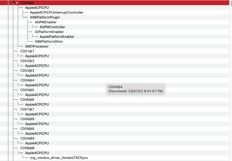

anerik70 Posted July 23, 2022 Share Posted July 23, 2022 Finally I found an Opencore patch to disable unused cores and boot x79 without DSDT. Here is it https://applelife.ru/threads/patchi-dsdt-x79-x99-x299-voprosy-reshenija.2945315/page-12#post-987847 It works fantastic in my Atermiter X79G Link to comment Share on other sites More sharing options...
anerik70 Posted July 23, 2022 Share Posted July 23, 2022 IoReg proof. 🙃 1 Link to comment Share on other sites More sharing options...
RoberT_XeS Posted July 24, 2022 Author Share Posted July 24, 2022 7 hours ago, anerik70 said: IoReg proof. 🙃 Where did you add this patch ....In the config.plist? Link to comment Share on other sites More sharing options...
anerik70 Posted July 24, 2022 Share Posted July 24, 2022 6 hours ago, RoberT_XeS said: Where did you add this patch ....In the config.plist? Under acpi/patch here is my plist. config.plist 1 1 Link to comment Share on other sites More sharing options...
