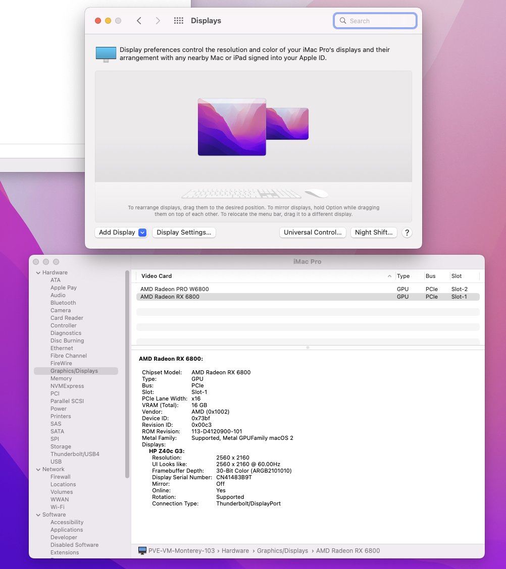

Monterey Progress!!!!!
After re-flashing and resetting the bios, I've got Progress!!!!!
771361204_ScreenShot2022-02-07at4_26_47PM.thumb.png.8a990edcce8bf42eb5b2509d98b116aa.png
1795157355_ScreenShot2022-02-07at4_47_33PM.thumb.png.83cc66823e96121fd002a74a51860e65.png
1366585894_ScreenShot2022-02-07at4_48_44PM.thumb.png.0f5b64b70d70b71c167425c0940274be.png
832599546_ScreenShot2022-02-07at4_46_54PM.thumb.png.034281110fd7910c724a778bf716c4eb.png

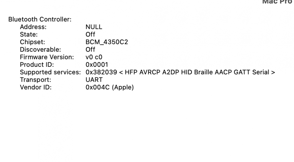

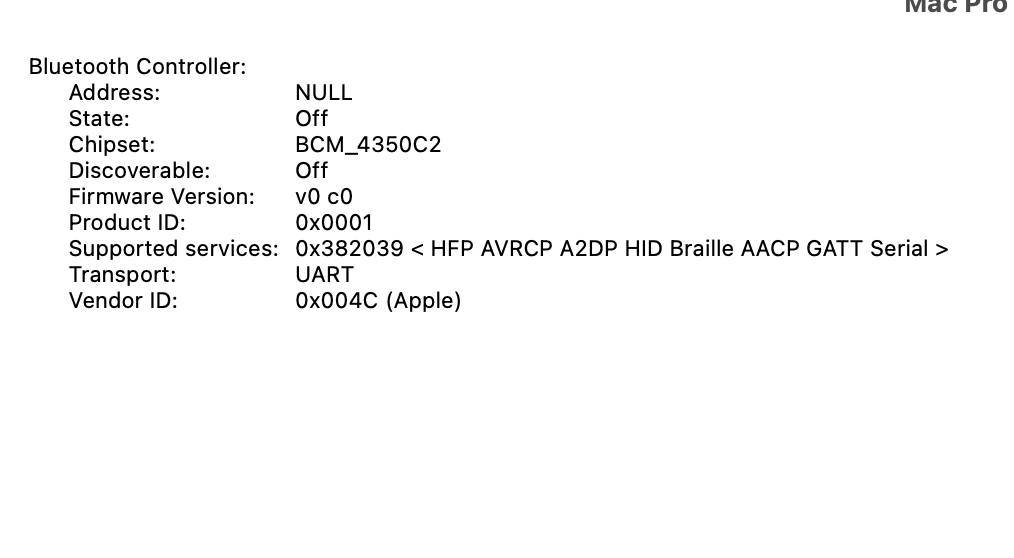

Bluetooth is a no go for Fenvi.

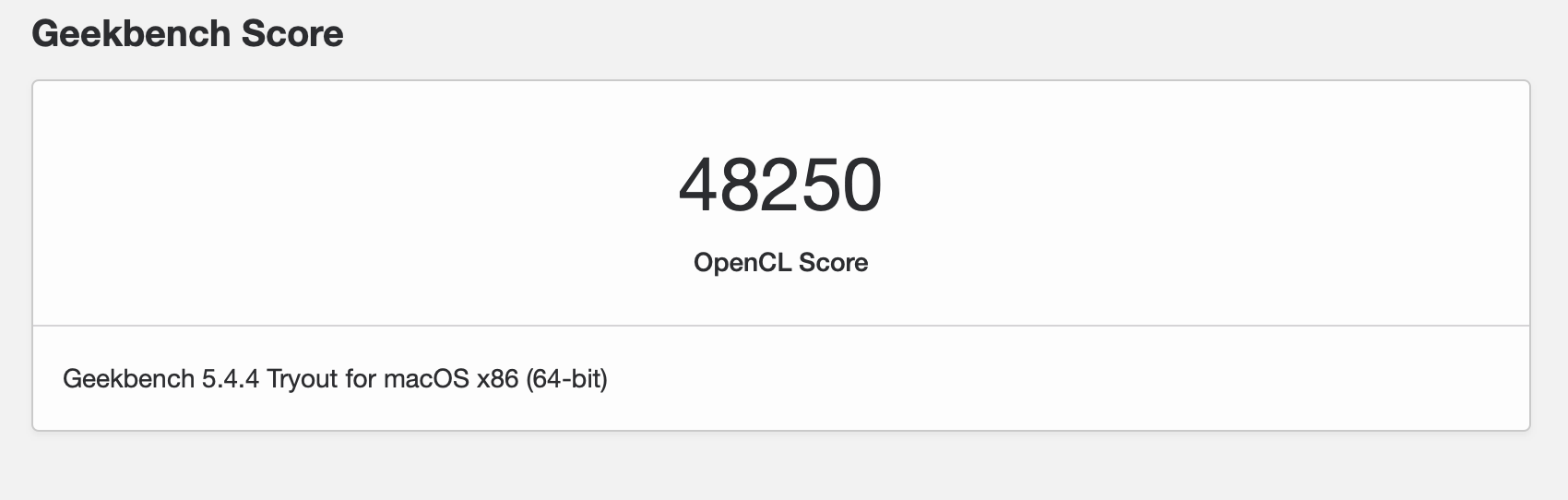

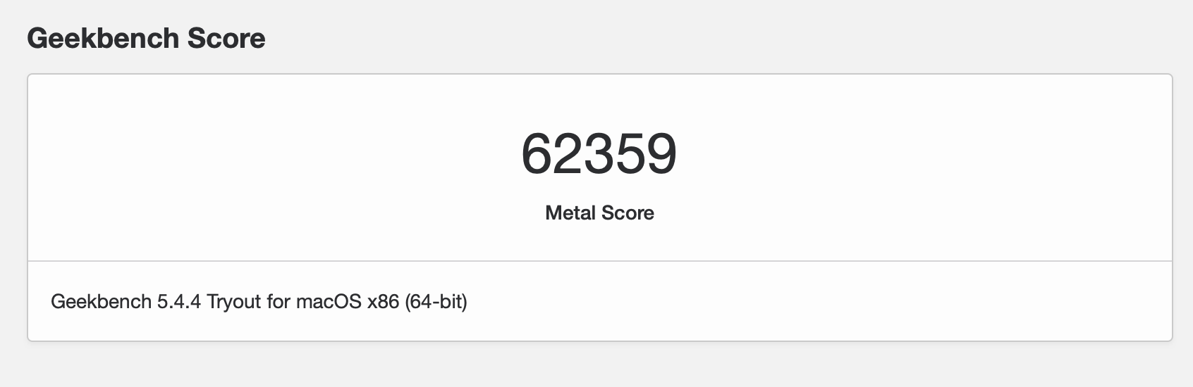

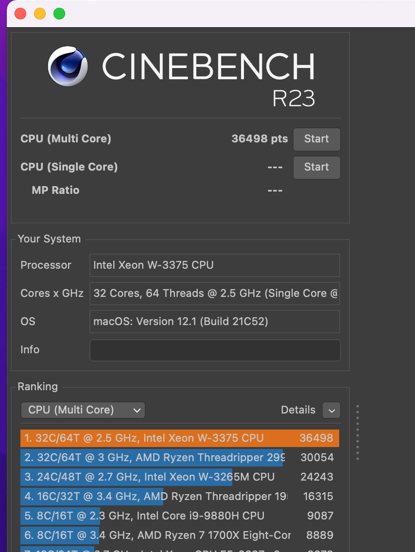

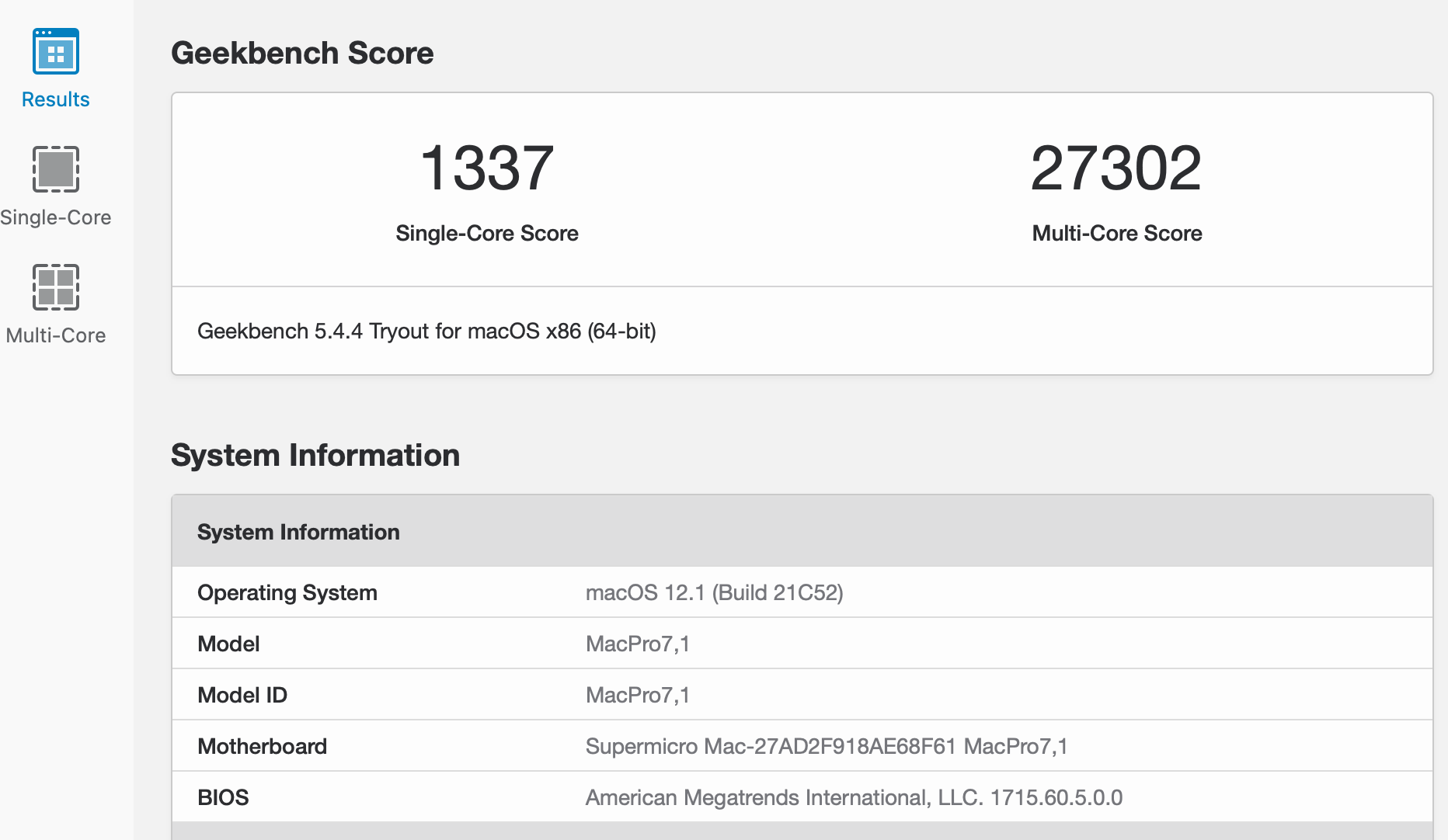

Run the benches multiple times so far so good, no issues.
268291095_ScreenShot2022-02-07at4_45_35PM.thumb.png.3de41c2f21a5e0a4e40b4723f0b1a57b.png
1945838721_ScreenShot2022-02-07at4_55_21PM.thumb.png.574e95ec47426ee5413ed76f7876697e.png
1167225146_ScreenShot2022-02-07at4_56_59PM.thumb.png.5cc39494853cd23300d7917a1ccb20e4.png
762840650_ScreenShot2022-02-07at4_58_56PM.thumb.png.745e3222455dc0f92a1bd830907154bc.png

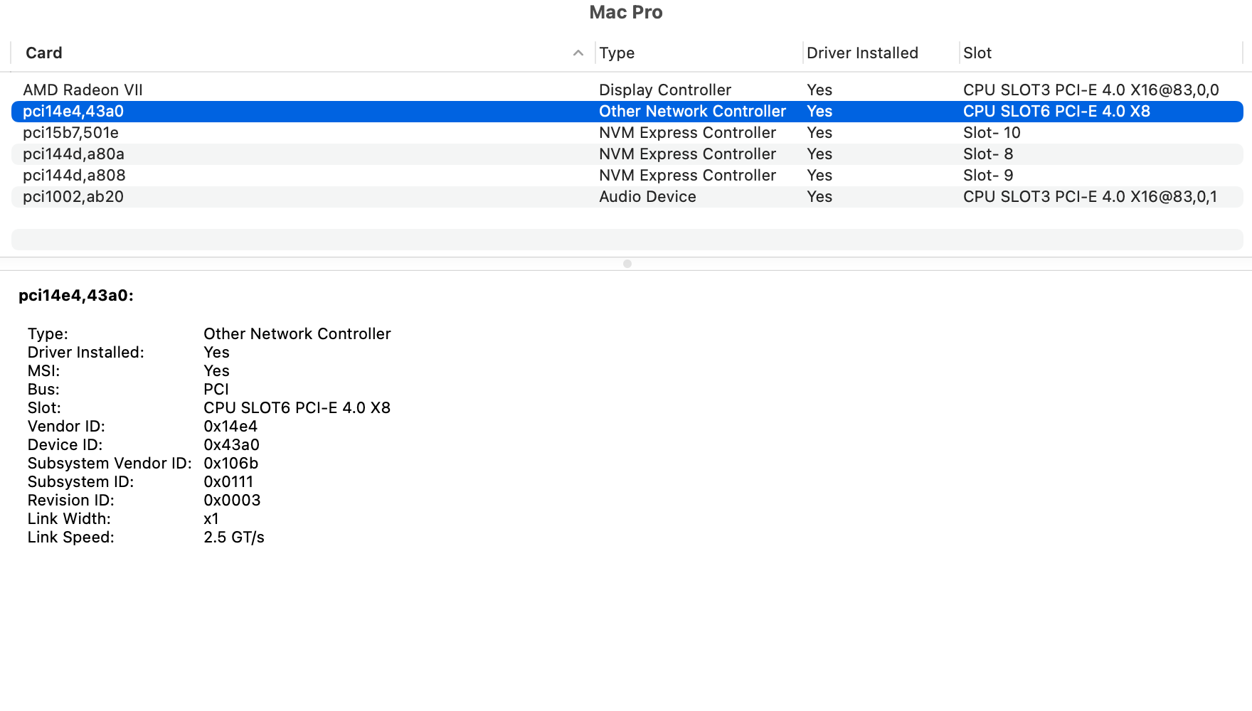

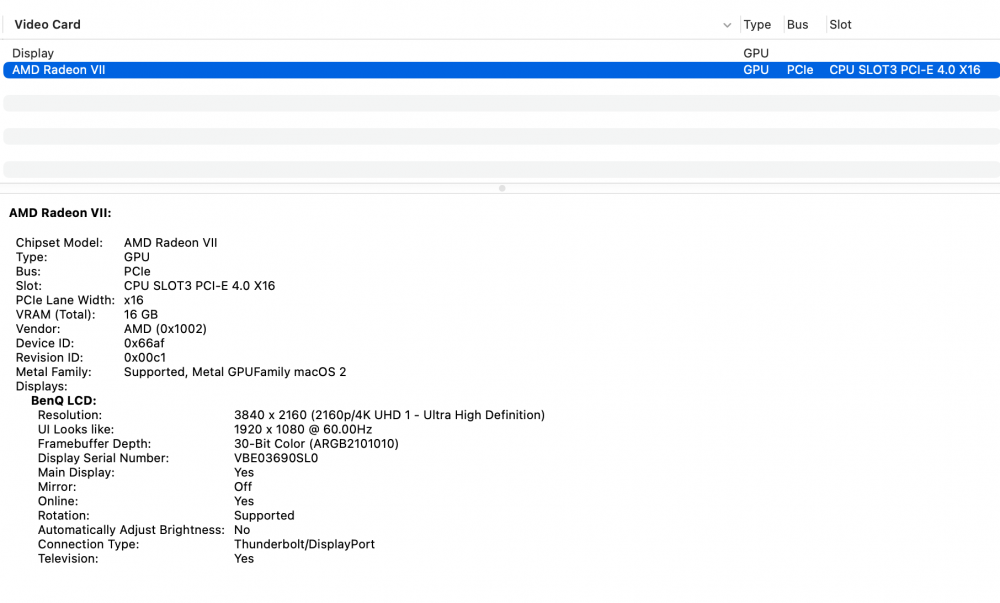

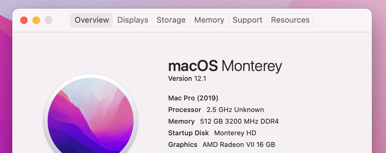

So far seems like everything works, will install 12.2 later on tonight to test it, then will work on AQC113 to get it working without freezes. Will post full BIOS settings later on.
Seems like everything is solid except sleep, will have more tests as in Photoshop/Lightroom/Final Cut in a few days to see if it is sold and can be a daily driver.

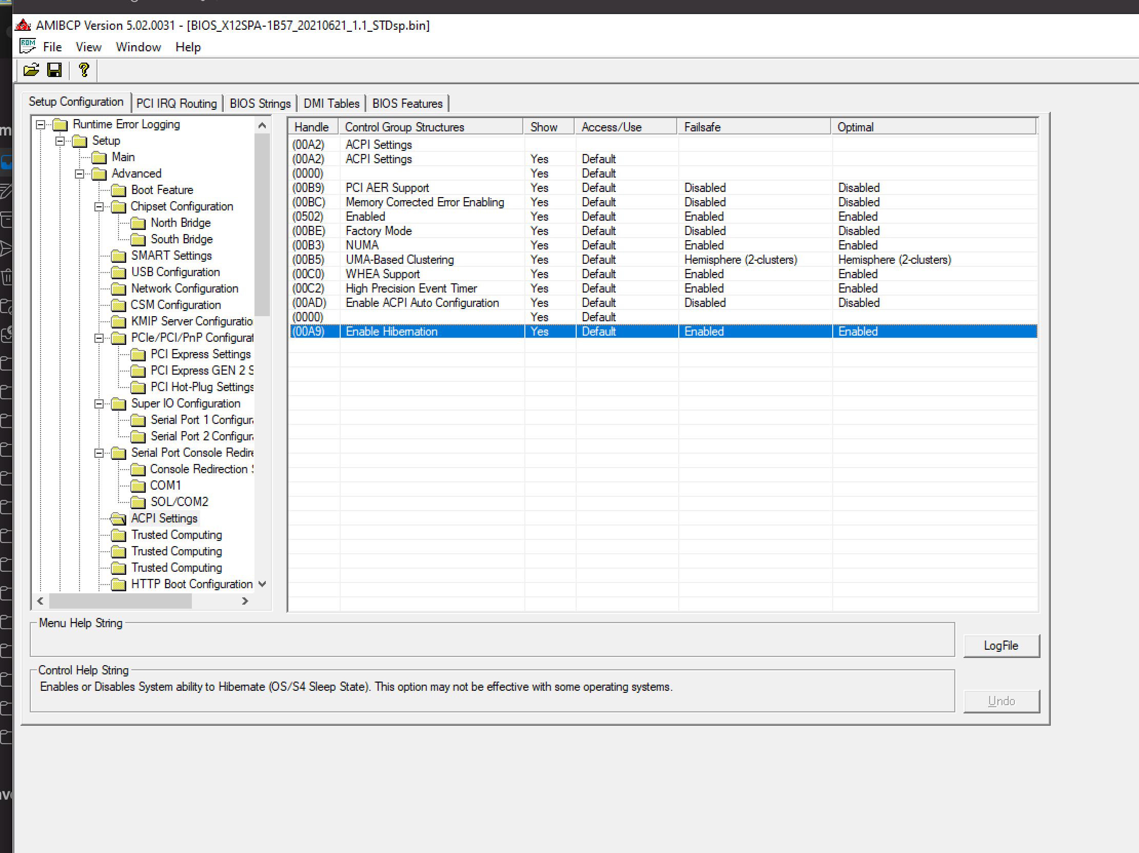

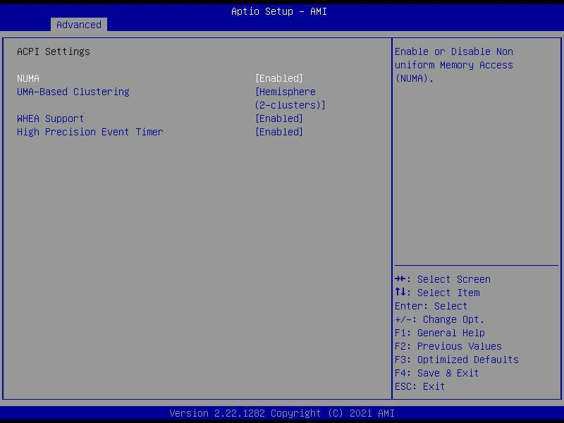

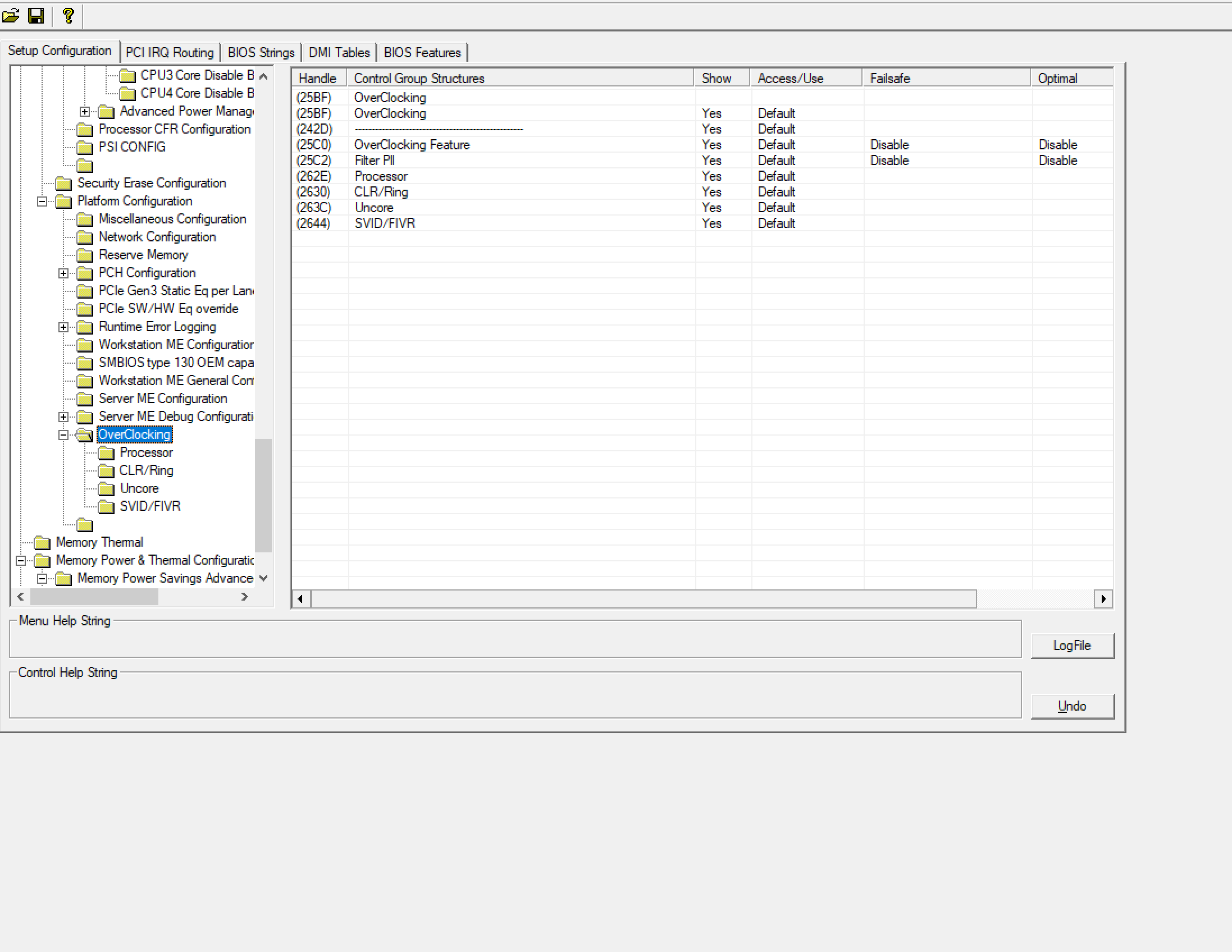

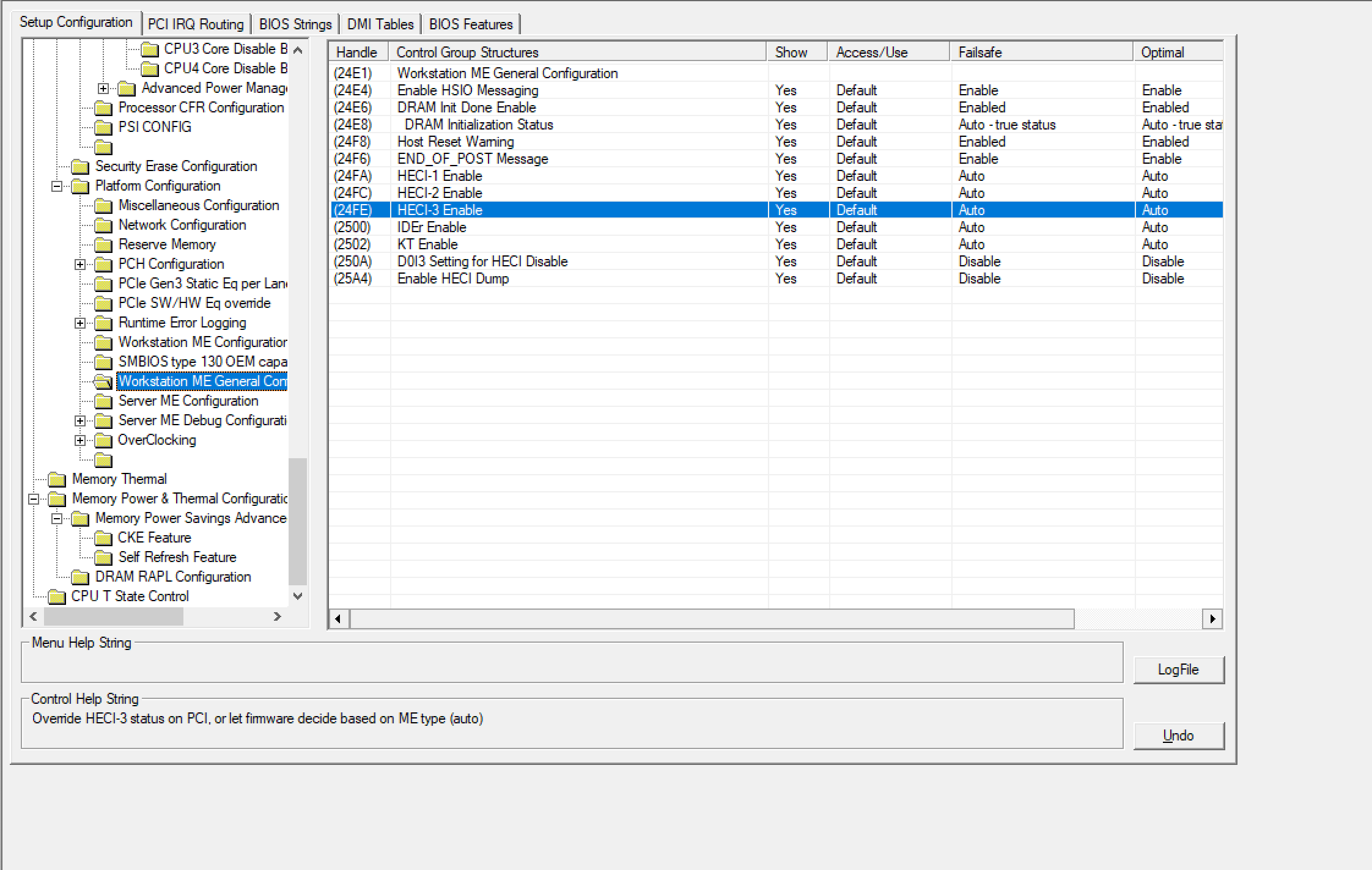

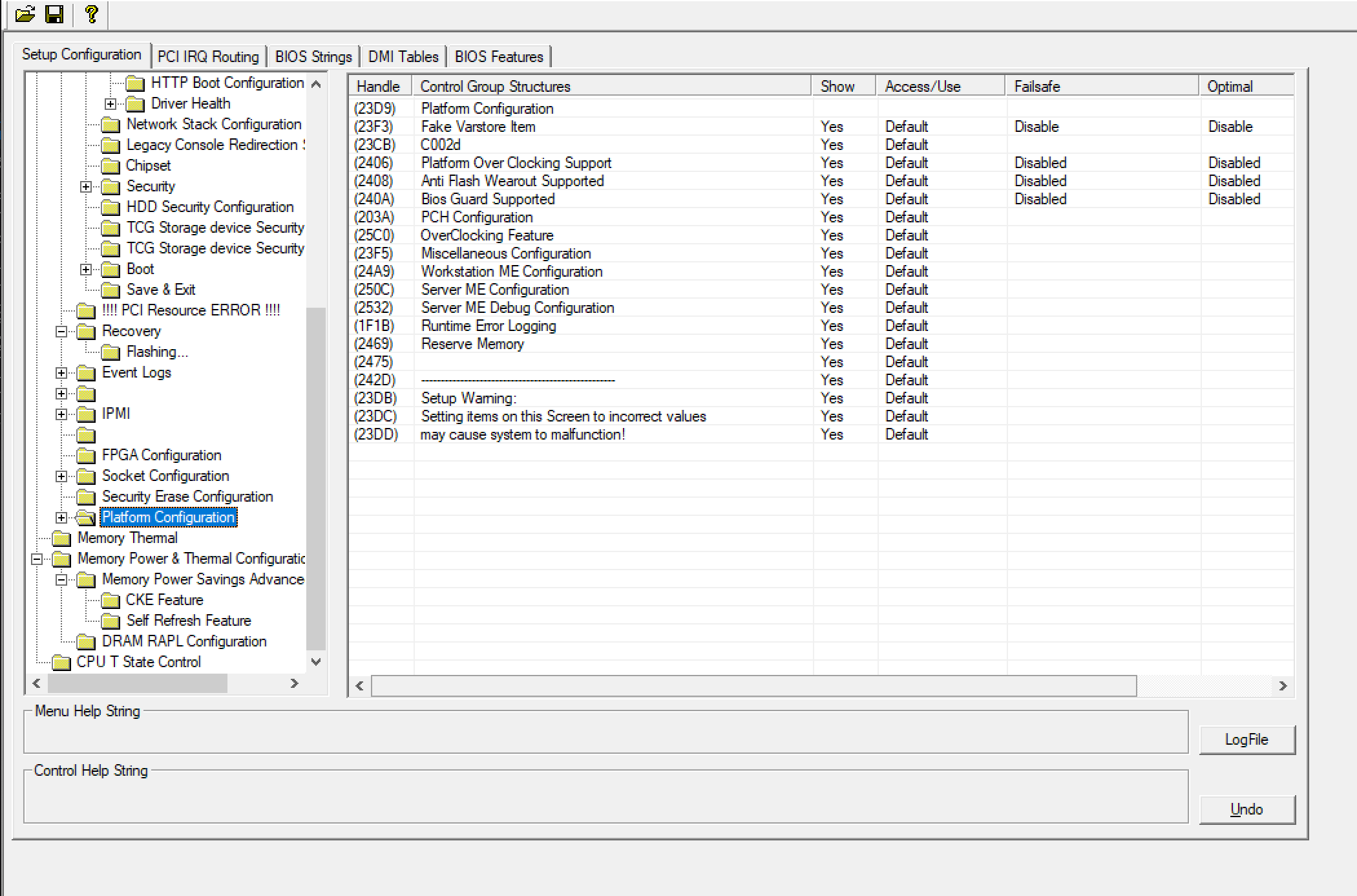

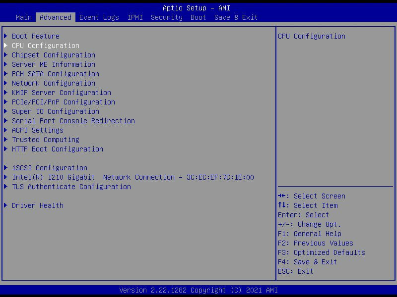

Small update from the Supermicro people:
According to our BIOS team’s update, AMI has provided the solution of “Enabled/Disable Resize bar for the GPUs”.   However, we’re still waiting for the information regarding to “CFG Lock of the CPU” feature.

@yapan4 Thank you for the app, still trying to figure out how to properly use it but initial observation:
BIOS does contain S4/Hibernate sleep state, at least its in the BIOS, it shows Show: Yes but I can't seem to see it in the bios.
31517140_ScreenShot2022-02-23at11_59_31AM.thumb.png.09cd3ff00f641a9e4ff882a837f33135.png
Didn't know the Xeon Ws can be overclocked??
1452985290_ScreenShot2022-02-23at12_07_35PM.thumb.png.310af4c70265a1e85271440d095fefd3.png
188168881_ScreenShot2022-02-23at12_38_02PM.thumb.png.9ae5e70f6a1f991c7e384d619a42d06b.png

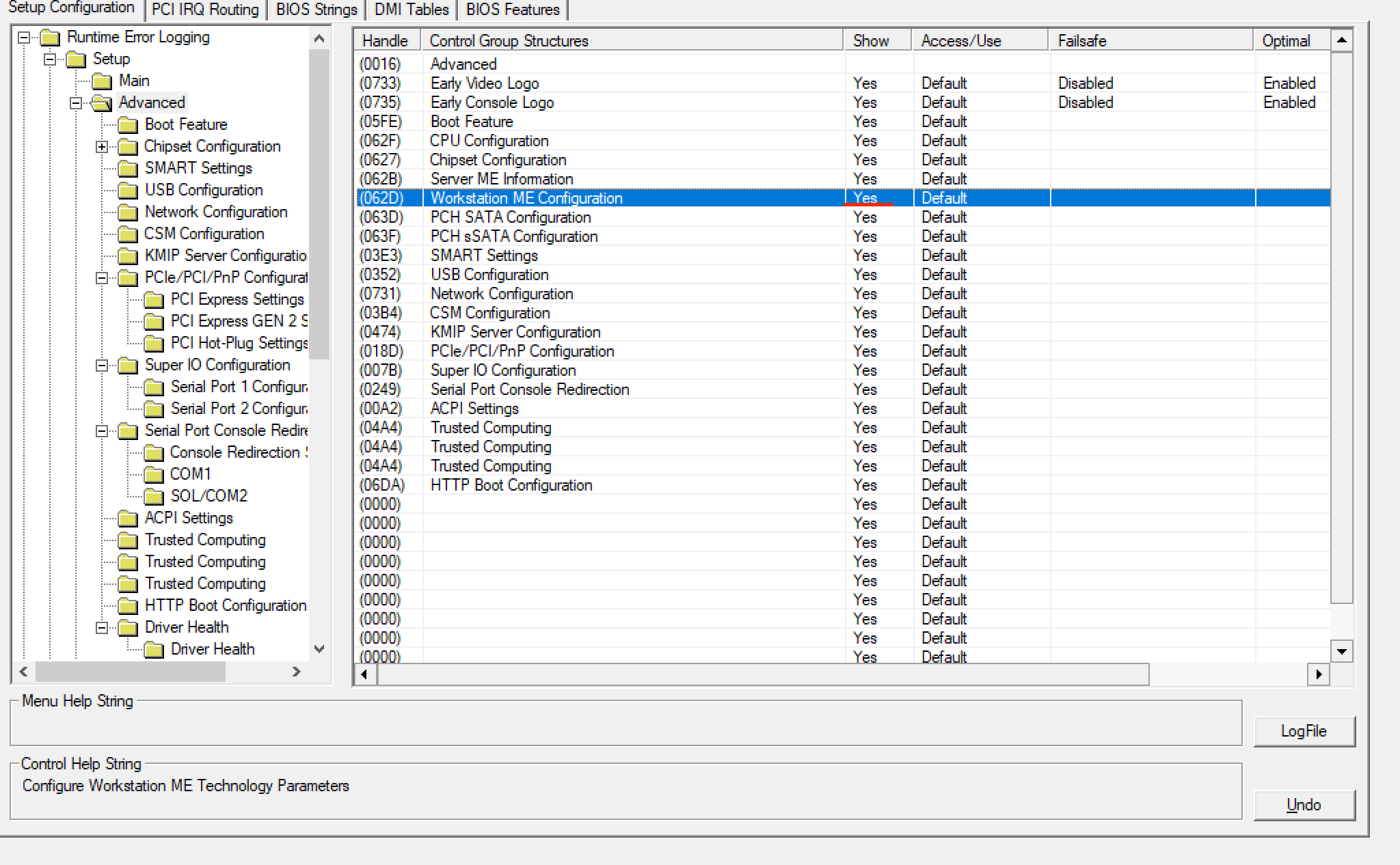

And HEC1-3 not showing int he BIOS, the entire Workstation ME is not showing.
1297309872_ScreenShot2022-02-23at12_04_52PM.thumb.png.9b3e5e3fe44248e691a053fef3778b24.png
Do you guys know how to enable them to show in the BIOS? Red the manual but it doesn't make sense. For example, AMiBCP says Show: Yes
271591882_ScreenShot2022-02-23at12_25_35PM.thumb.png.43fa95f153c15a18cb11b2e0000176a7.png
But the BIOS is missing a lot of the items.
Is it because of the Access/Use is set to default? Should it be changed to Supervisor?
Thanks fellas.
Edited by Balamut

On 2/23/2022 at 9:36 PM, Balamut said:
@yapan4
Thanks fellas.
@BalamutSet it to User and safe the firmware…
How do you flashed the firmware ?

Don't waste your time editing the BIOS menus. Supermicro typically has an option to unlock the chipset (which normally will unlock the 0E2h MSR in most other motherboard vendors' BIOSes) hidden away that you can reveal with the AMI bios editor, but the option doesn't do anything with Supermicro.  They just didn't bother to remove it, but it is just a dummy placeholder and turning it to Enabled or Disabled has no effect.
But don't worry, I got you fam
Let me see.... oh yep, there's the little varmit!  Setting the lock bit, which is bit 15 (0x8000 in hex) of the 0E2h MSR upon system initialization:
We can't have that, can we?  Better just have it do exactly what it was doing, only without bit 15 set.  In this case, just a somewhat pointless but liberating write of 0x0000 to 0E2h:
I'll put together a pull request for UEFIPatch if you test it and it works.  It should work, but sometimes there is another spot where they will check if the lock bit is set, and if not, lock it.  I typically see that kind of bs from Asus  but never from Supermicro.  So hopefully this is all you'll need.
And just to be clear, there is no way this can cause any problems or brick your motherboard (and even if it did, you can just flash the BIOS from IPMI so it is about as safe as you can get).
My other patch still works for unlocking the 1AAh MSR for your BIOS.  So grab UEFIPatch if you don't have it already, and replace the patches.txt file in the UEFIPatch folder with the new one I've attached.
Then just run UEFIPatch from the terminal on the .bin bios image, you should see 2 successful patches applied.   Both your 1AAh and 0E2h MSRs should be unlocked and you can boot macOS without any power management patches turned on.
