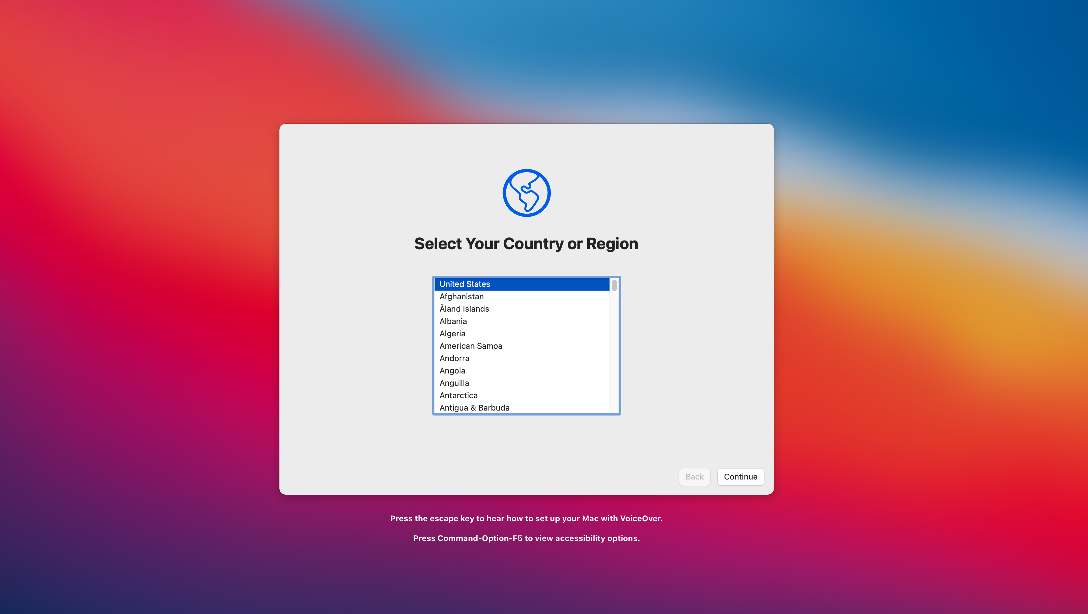

This is where the installer's GUI starts. I saw similar behavior on my X11SPA-F with newer versions of the BIOS and Open Core boot loader, where the boot reached the gray background of the installer and then hung. On Clover he moved a little further. I never found a solution and just went back to the previous version of the BIOS.
Regarding kernel panic on AppleMCEReporter.kext. Are ECC memory modules used in your configuration?
Regarding "still waiting for root device". Without npci=0x2000 chipset's USB don't work(on my X11SRA), so this is normal behavior.

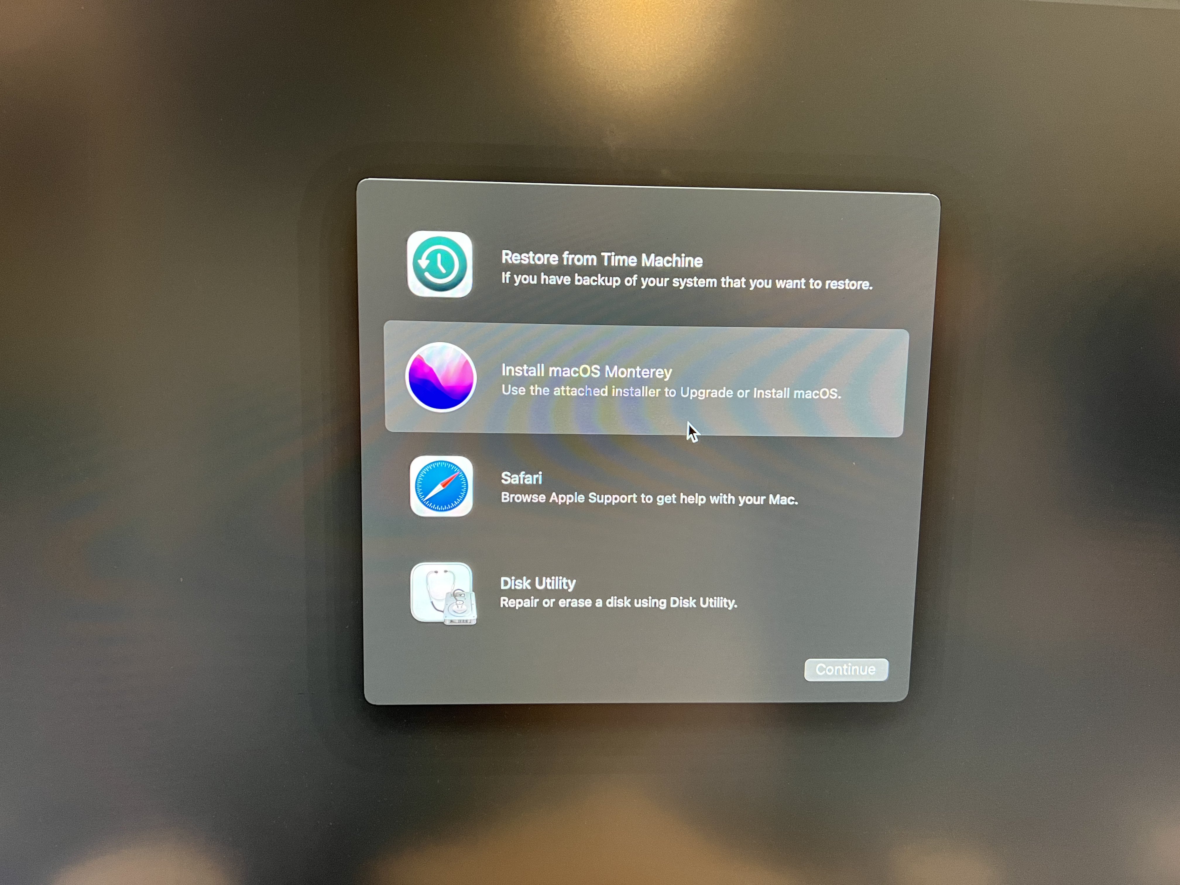

Hey guys, I'm still working on it.
Small update, man aged to boot into installer but bit minute in it froze, so there is something panicking in the middle, sadly can't get the kernel log.

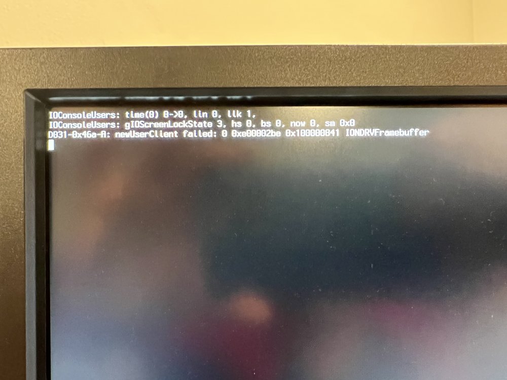

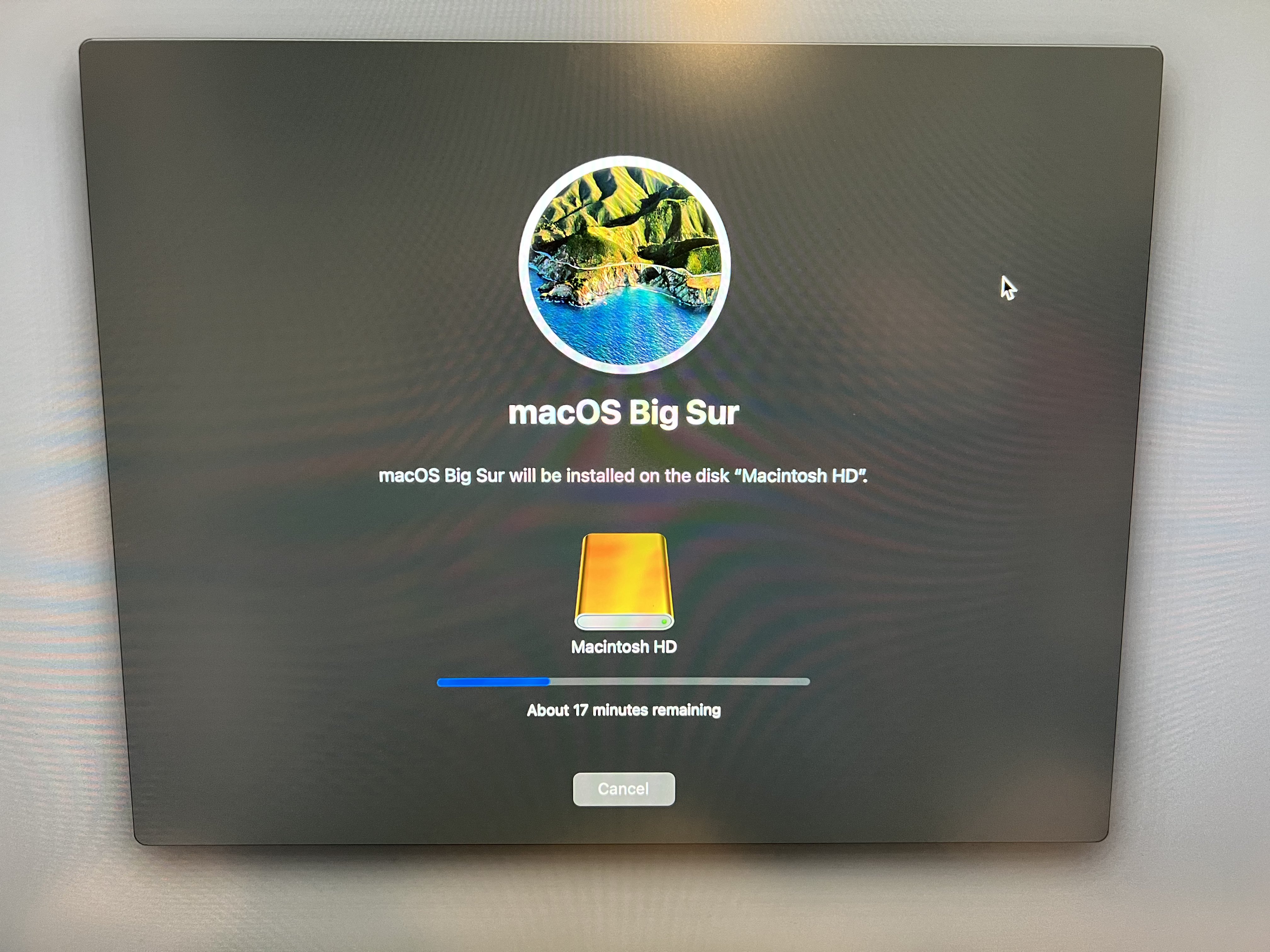

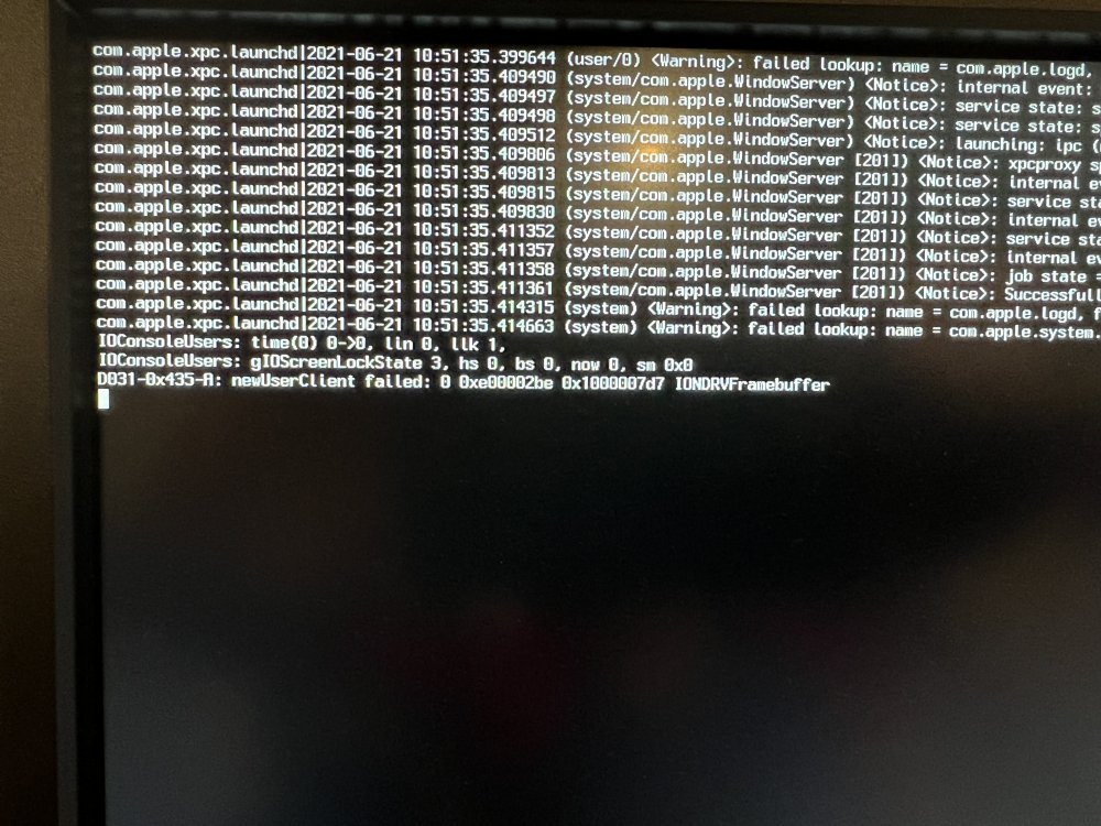

Small update, played a bit more and:
Monterey Beta gets to the installer and freezes are a few min. no KP to see anything.
Big Sure managed to Partition HD and run the installer but same freezing.
Do you guys know what that error is?
Even with the bare minimum ACPI (Just CPU wrapper) and Kext (FakeSMC, Audio, USB, CPUAdjust) the system still freezes when installer opens up.

deferred rematching count 3
IOG flags 0x3 (0x51)
that HEC2 error might be the culprit.
Also any thoughts on BIOS time/date reset after every boot?
  • Like 3
Audio may not be essential, but Whatevergreen is missing in this list. IONDrvFramebuffer is the default VGA driver, which should not be involved if you're using a supported GPU. (Not one of the problematic RX 6900 I hope?)
Nope, it’s RX 580 should be mo problem with or without WhateverGreen.
it’s just locks up right on the installer GUI, I’ve even manage to partition the HD and start the install once.
There is onboard asmedia video, I’ll disable it see if it’ll make any difference.
Gonna try Clover tomorrow see if it makes any difference.
The time/date in bios bothers me, RTC might be screwed up.

On 12/5/2021 at 2:59 AM, XLNC said:
@Balamut dissconnect your lan ports
its the I210 ethernet port causing the random freeze.
WORKED!!!!!

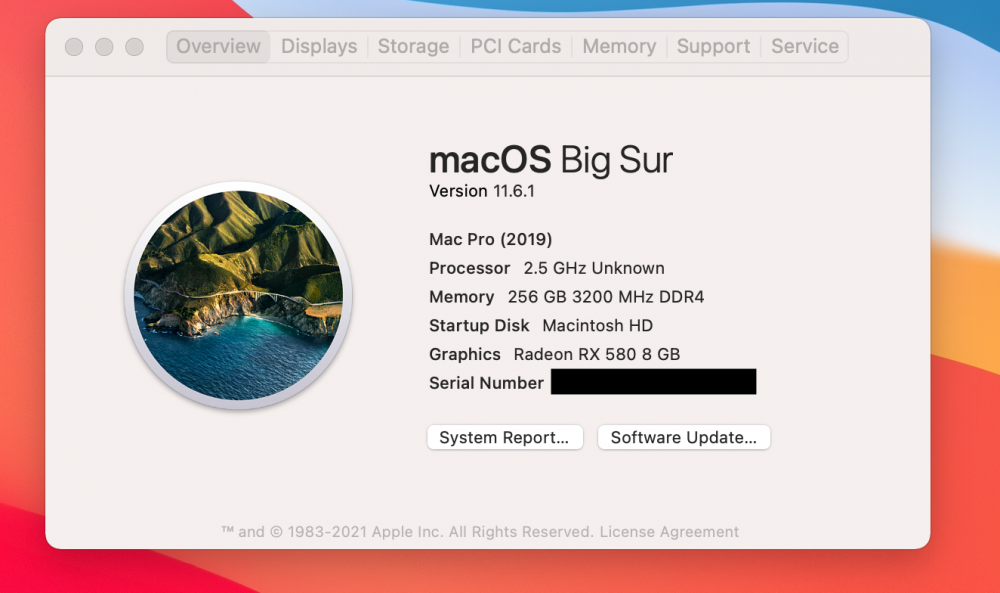

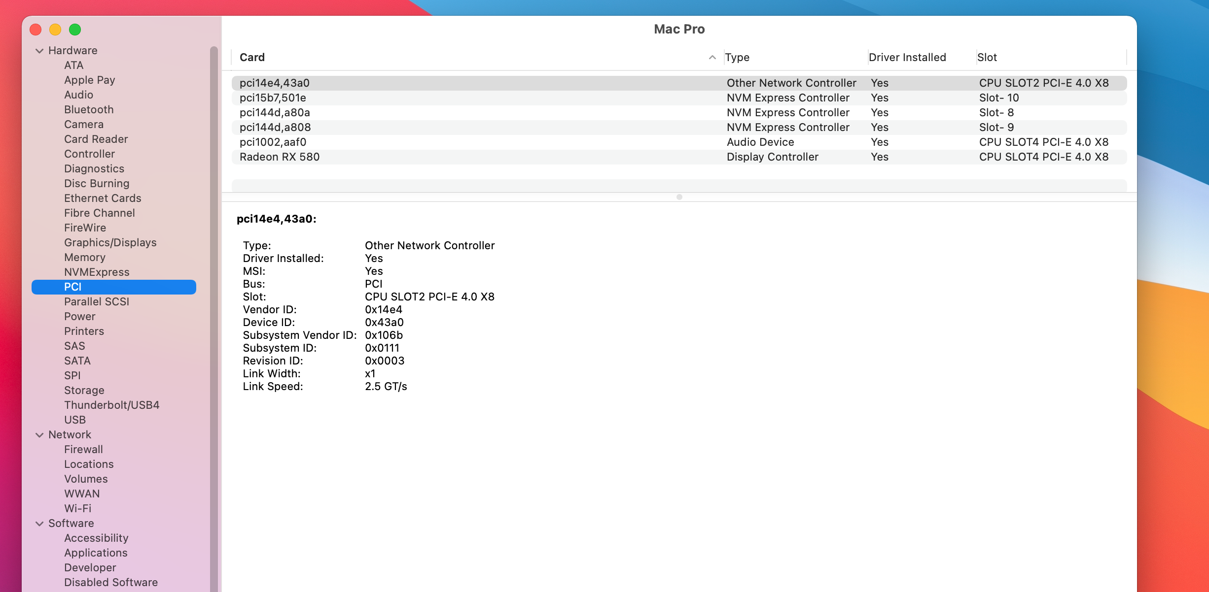

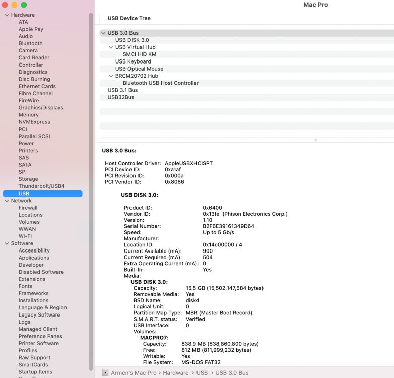

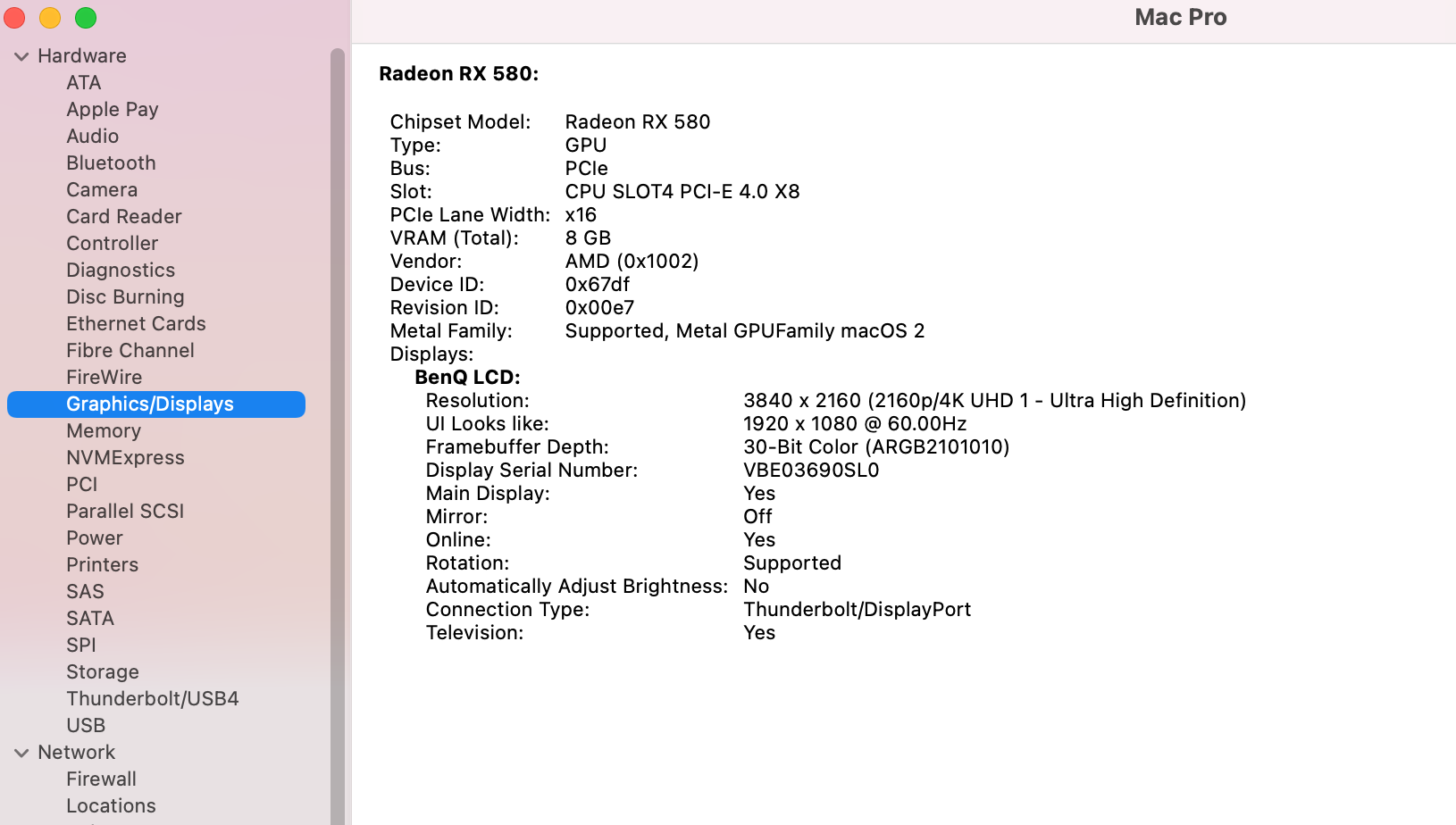

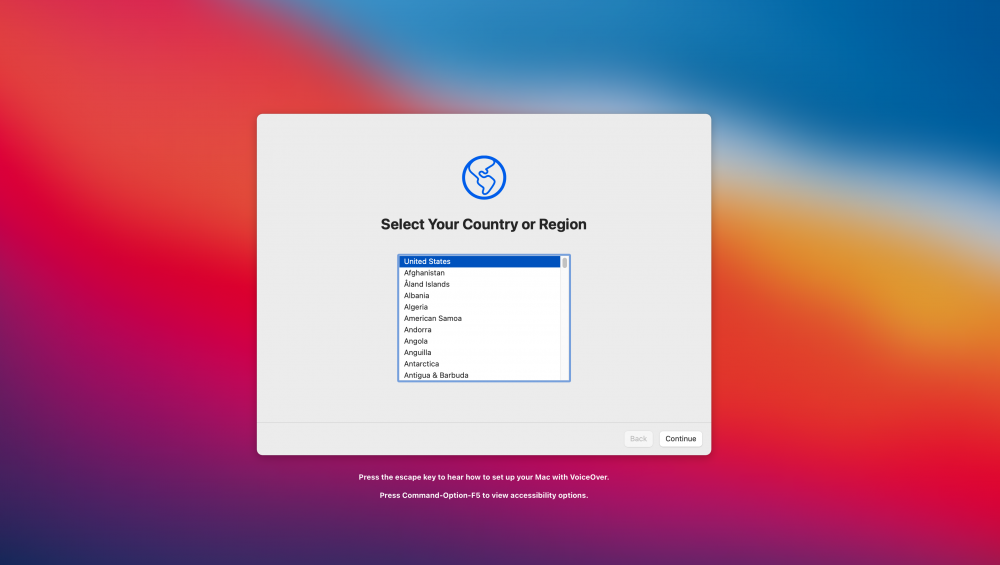

Well fellas I've managed with your help install Big Sur. Thank you @etorix @yapan4 @XLNC @Loloflat6 and anyone I've managed to miss.
77852299_LWScreenShot2021-06-21at3_50_50AM.thumb.png.d8c16acc5171ecf90c44cfb7e208b189.png
1598146905_ScreenShot2021-12-07at2_10_47PM.thumb.png.d1ba242b0b65b7b51c48332d6bc93c77.png
502588514_ScreenShot2021-12-07at2_12_09PM.thumb.png.8c897c4f8bcdedb65c6bef1976371a7b.png
403890181_ScreenShot2021-12-07at2_13_38PM.thumb.png.63774a1e097cec85e72c2ba2a1de0759.png
2083520044_ScreenShot2021-12-07at2_15_47PM.thumb.png.1e3c9cc89a044a75e9577e5a7dd40734.png

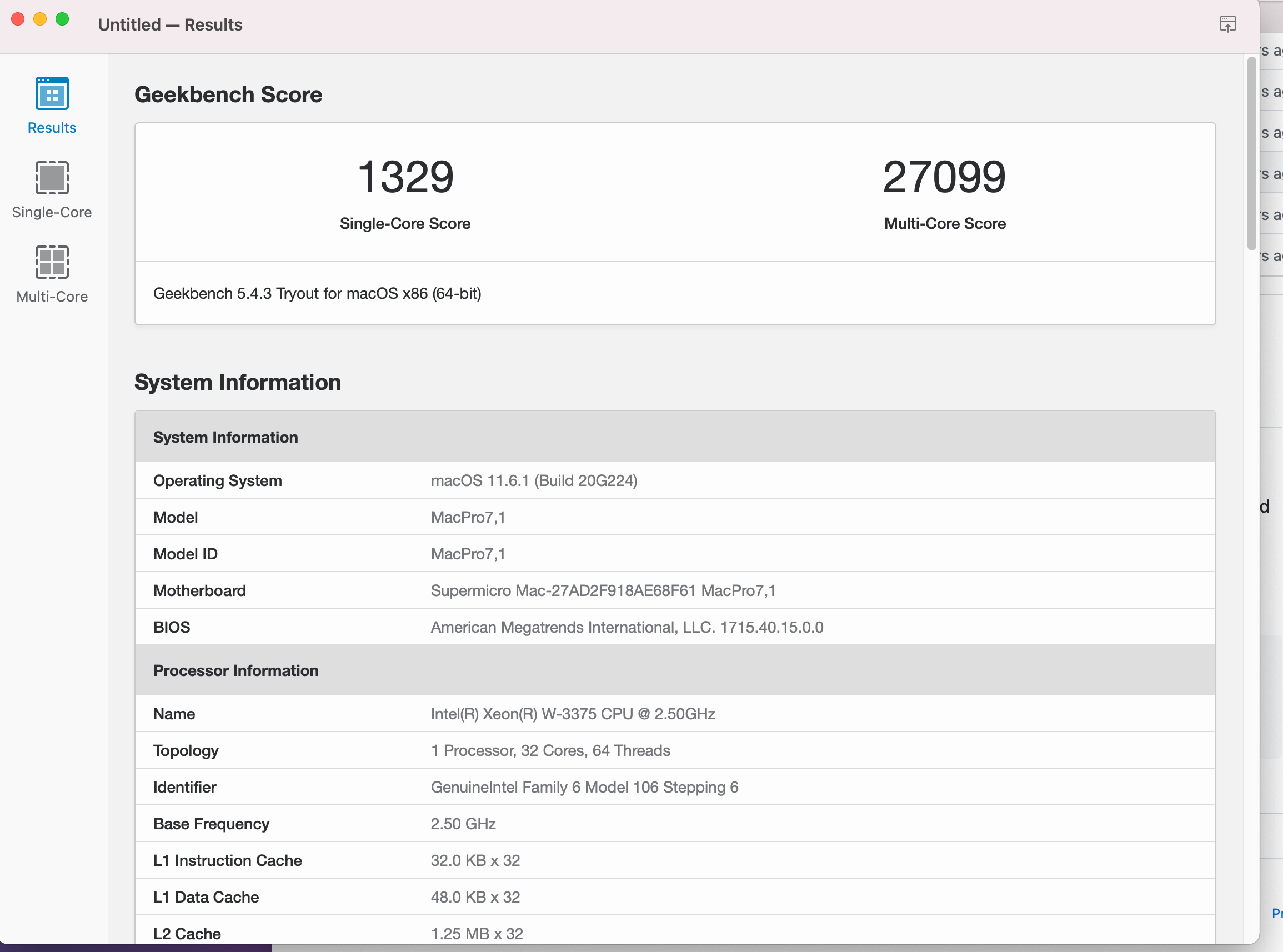

Geekbench:
1833616951_ScreenShot2021-12-07at2_27_18PM.thumb.png.a222f6f1e4cbc70dc42fe414b483dba7.png
Sleep doesn't work (Doesn't go to sleep).
AQC 113 doesn't work.
Got a random kernel panic.

Shutdown restarts.
Got IORegs.
Clean IOReg with just CPU Wrap.
 Balamuts’s Mac Pro CLEAN.ioreg.zip
IOReg with SSDTs (Without touching HEC2).
Balamuts’s Mac Pro WITH SSDTs.ioreg.zip
Will replace RX 580 with 5700 XT see if it'll stop the panic.
Gonna try Monterey Next on the WD SN750 drive see how it works.
Big step, but still a lot of work left until its fully working.
Thank you ALL for your help.
  • Thanks 1
At long last! Great result! :thumbsup_anim:
