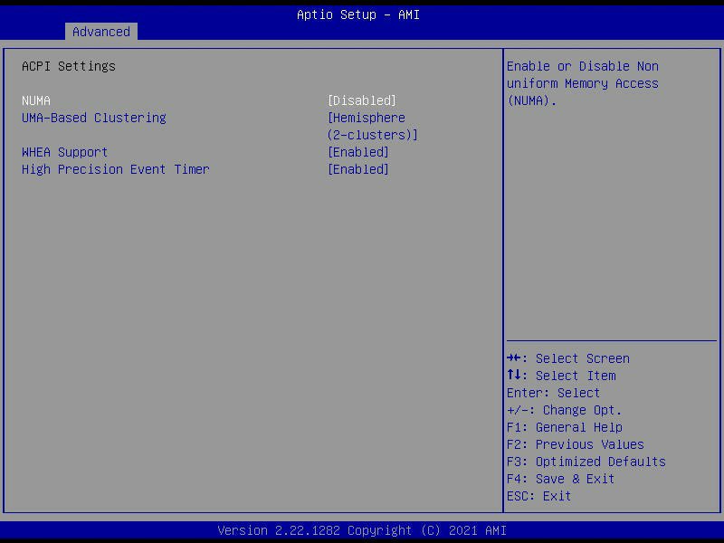

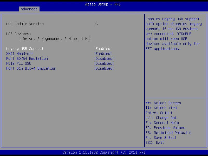

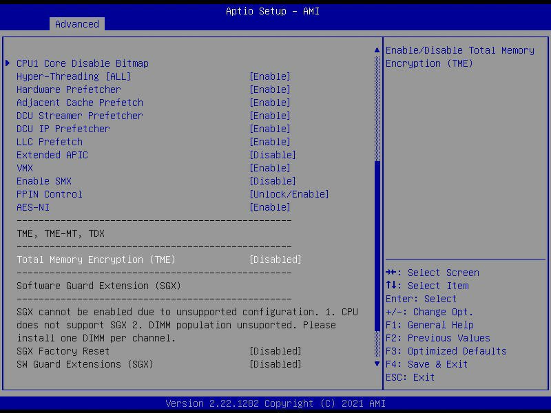

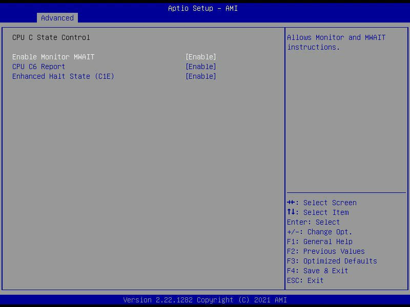

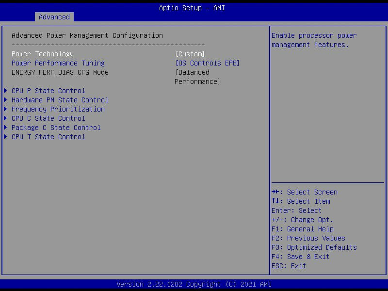

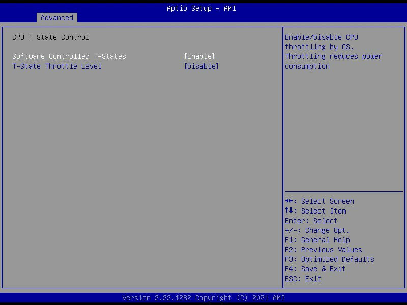

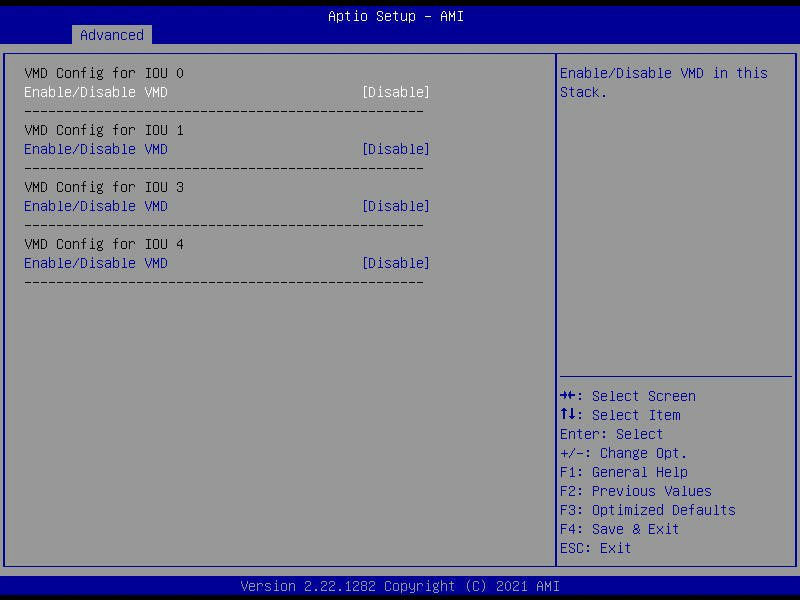

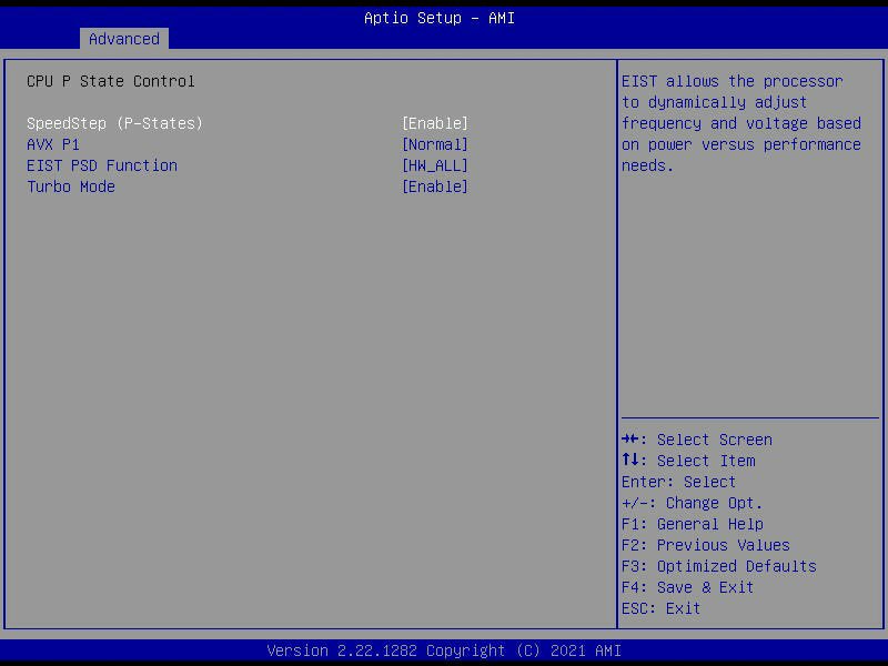

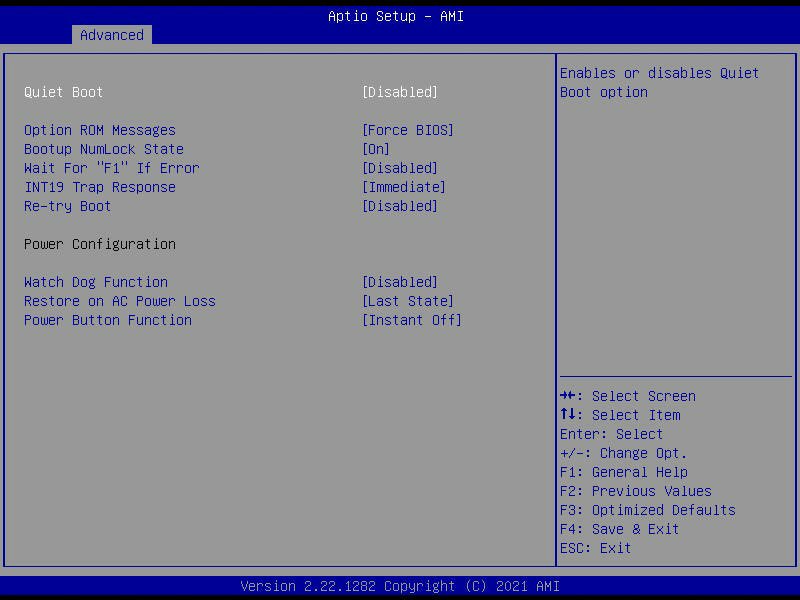

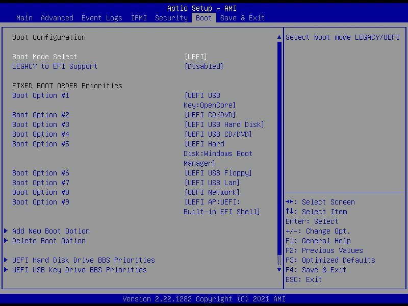

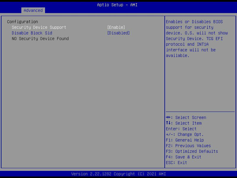

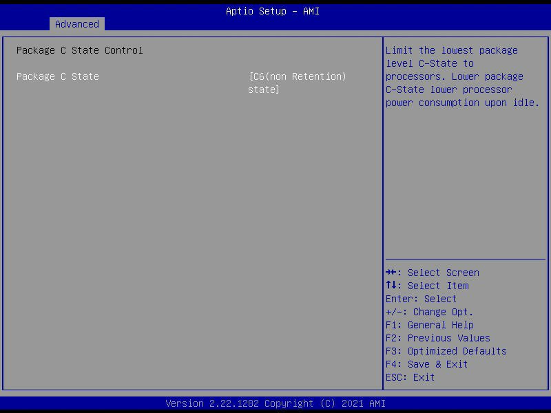

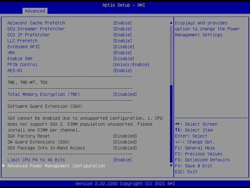

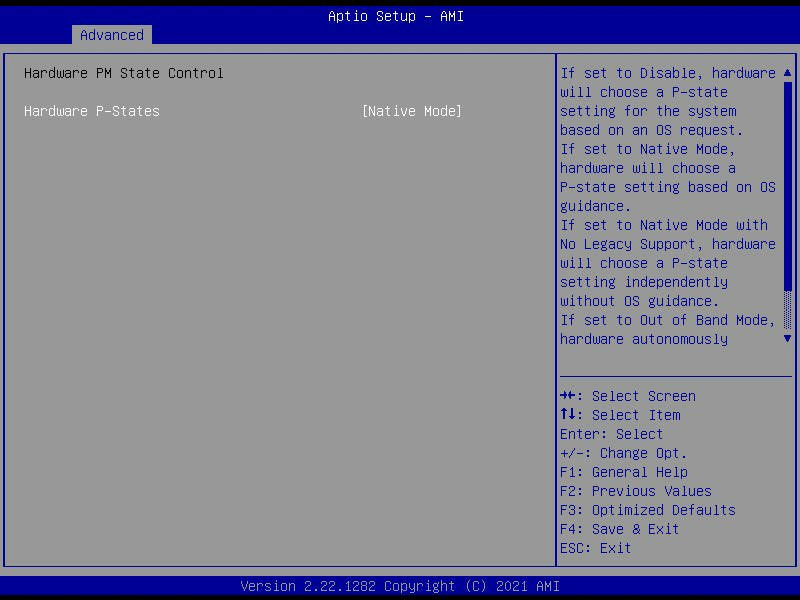

A very clear and comprehensive BIOS!
There are quite a few options I do not understand, and at least one I think I've never seen ("Limit CPU PA to 46 Bits"). Have you identified which options allowed to advance in the boot process?
There is no fake EC device in @Loloflat6's SSDT-EC-USBX but one should be needed. You may use the older version (306 bytes).
@Balamut
I checked Clover bootablity with a locked BIOS 2.4 on X11SPA-F - it works, at least on my motherboard. I will find out later where Quirk KernelPatch went.
Later I compare your and my BIOS settings, maybe I'll see some differences,,,

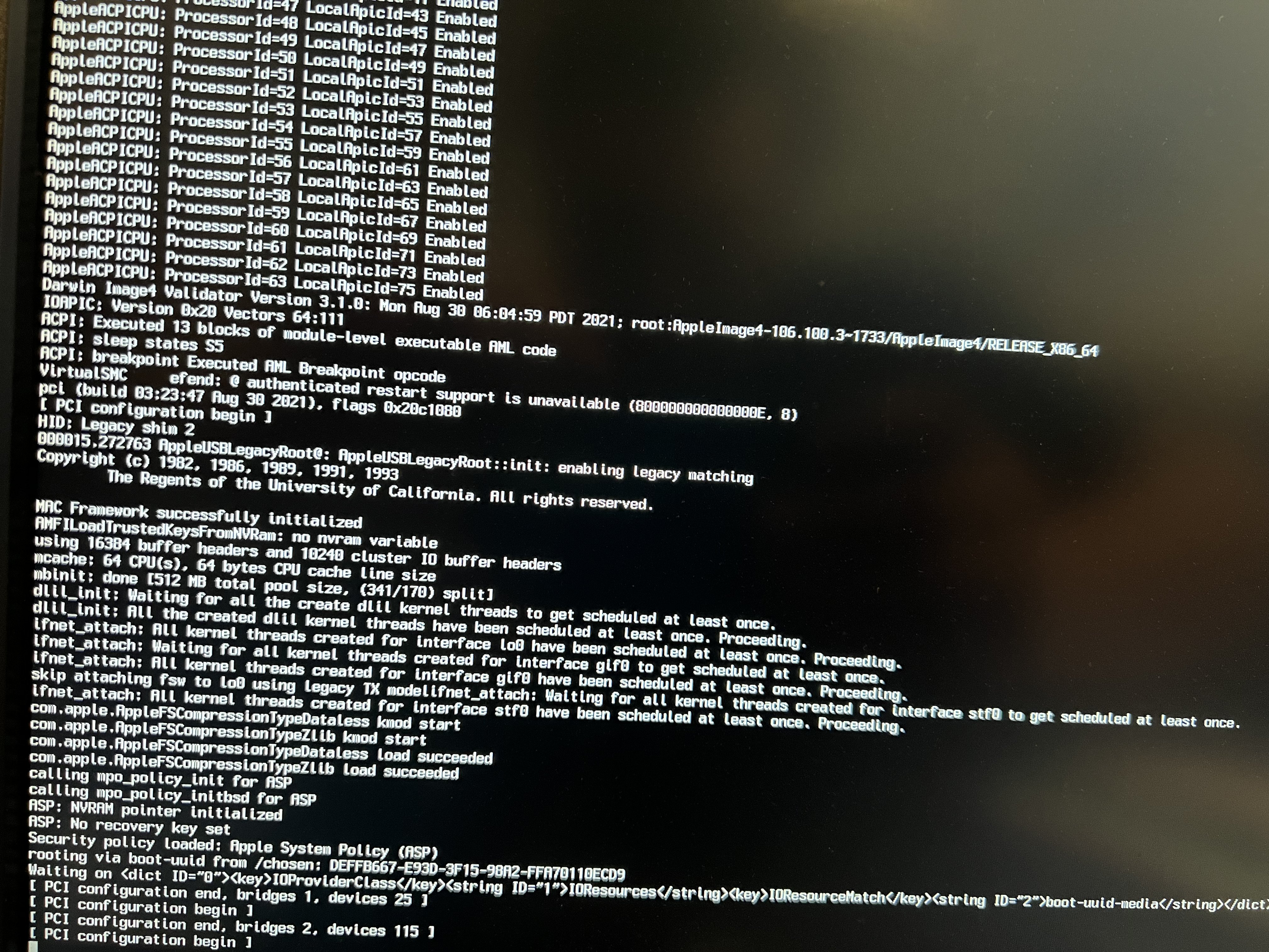

Some progress but :
Spoiler
Yeah, there's a persistent breakpoint 🤨
So one thing to explore is HEC2
Try to boot this SSDT-HEC2 and see if you have gone further 🤔

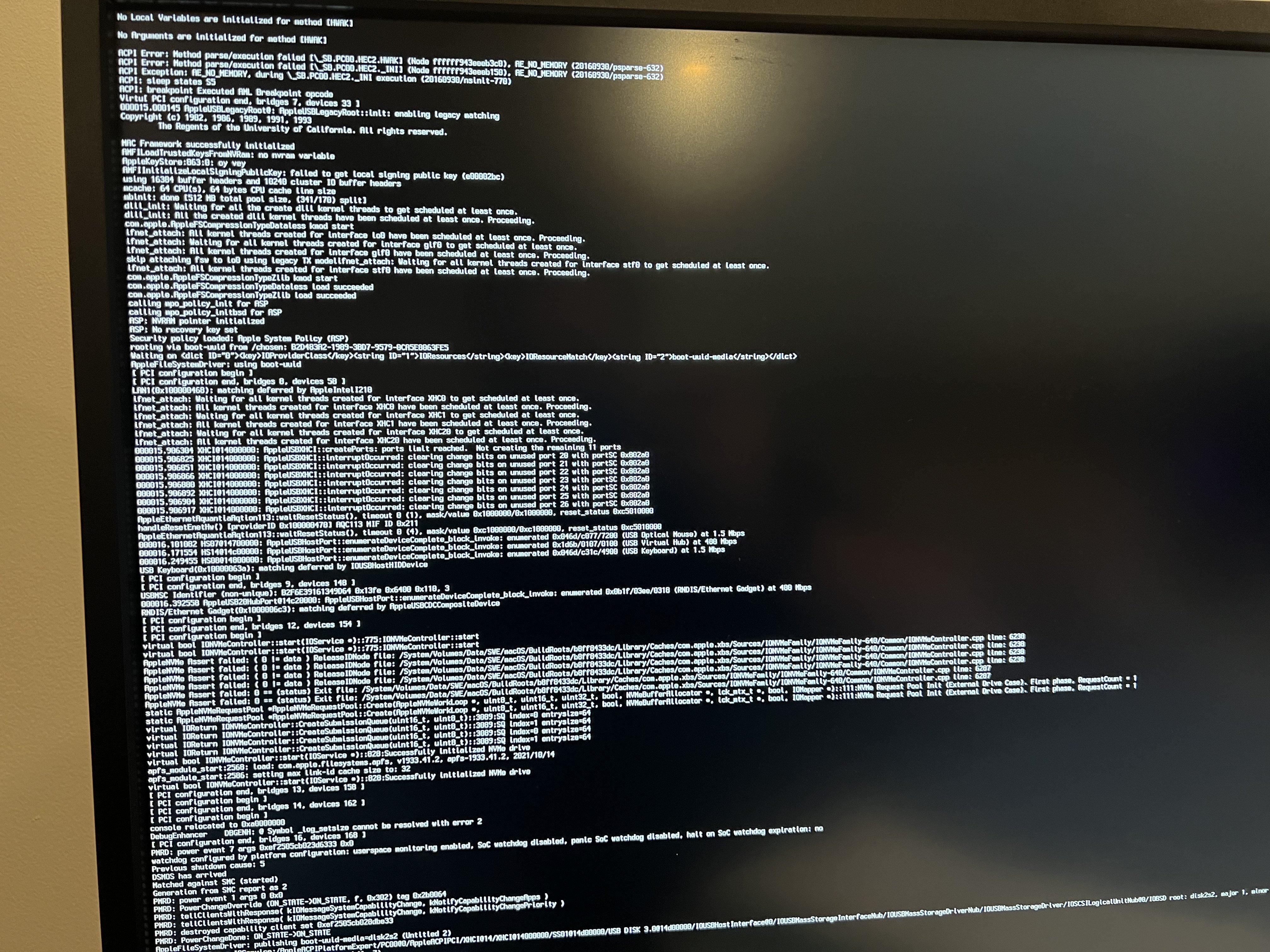

Disabled the quirks and disable the HEC2 and progress, no more HEC2 and memory errors, but still stuck on the PCI Configuration begin.
Can the problem with in the CPUID masks?
Going to download Monterey RC2 and try with it.
Thank you all as always for great help.
Good to hear from you again!
So, HEC2 can be disabled, but it doesn't help. Disabling booter quirks doesn't help either… but does not make things worse, correct?
Have you tried with a fake EC?
Have you tried with HEC2 enabled (not disabled) but the quirks disabled? (To check if one of the memory quirks was responsible for the error and/or whether HEC2 is actually required for boot.)
I'm afraid I'm out of ideas for now. But don't give up, it seems to be very close to boot… even if it takes a lot of time, many tries (and quite possibly a fair amount of good luck) to make the last step.

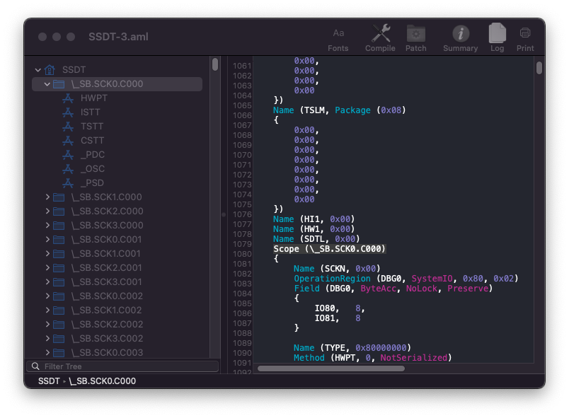

(this Supermicro X12SPA-TF: 0x0000200FFFF69000
your Asus WS C621-64L: 0x8000000080000000 in SSDT-4
my Gigabyte C621-SU8: 0x0000383FFFF45000 in SSDT-3
and then the same code, from three different manufacturers—why the different addresses then, and where do they come come from?)
ACPI C621SU8.zip

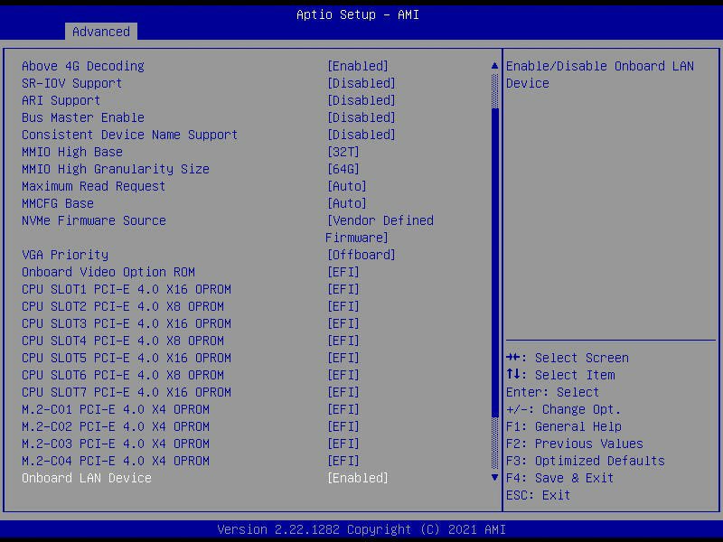

5 hours ago, etorix said:
Great find! Does HEC2 loads correctly with Above 4G decoding disabled? (Its OperationRegion is below 4G but who knows…)
Yup. No this is with HEC2 disabled, I'll try to enable it tonight with @Loloflat6 SSDT and do more testing.

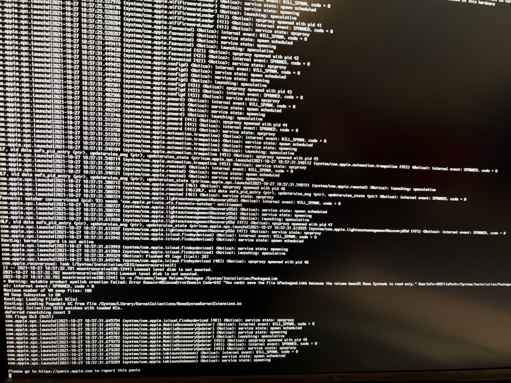

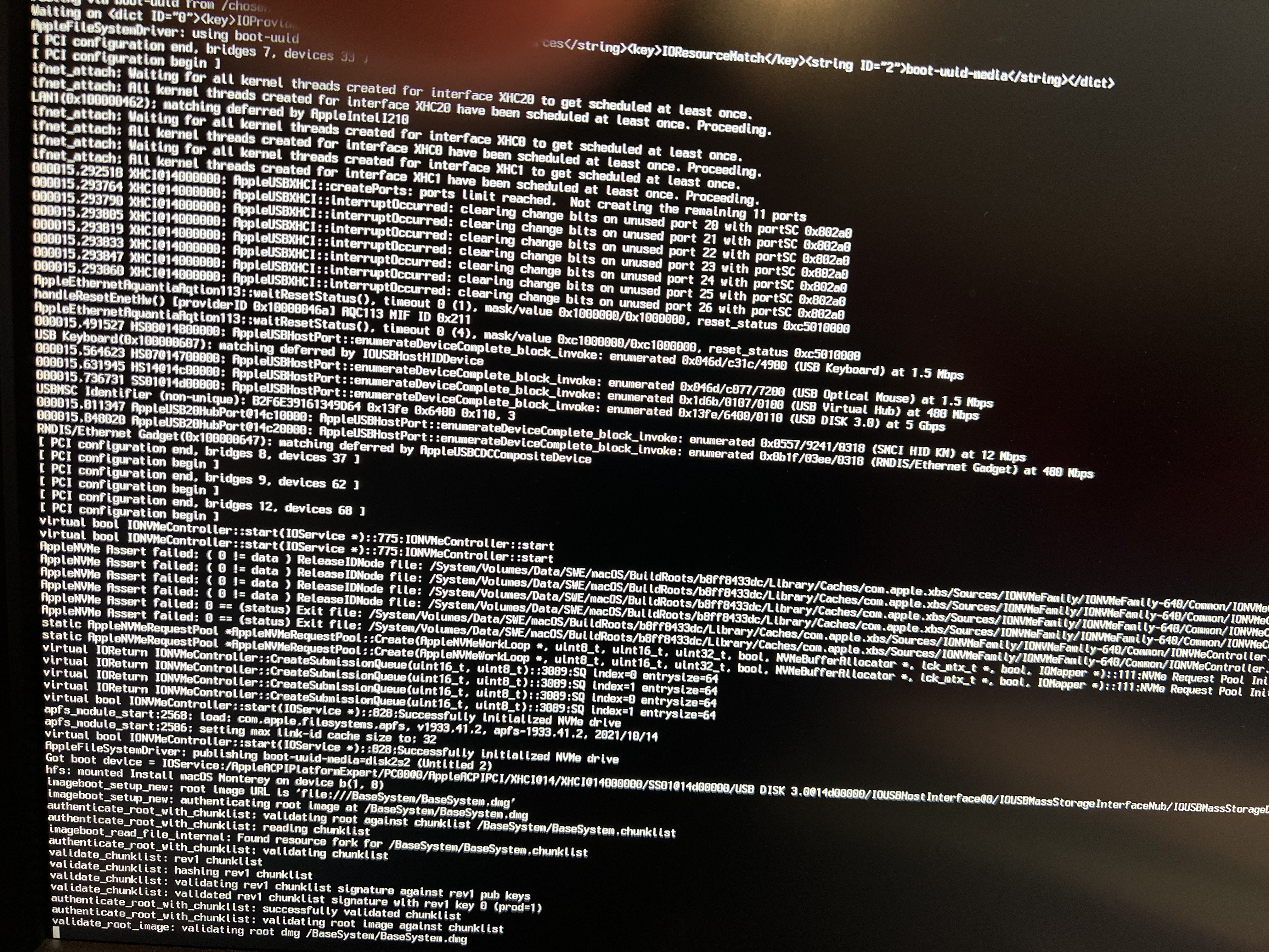

4 hours ago, yapan4 said:
In this place you need wait some time until system complete validating root dmg

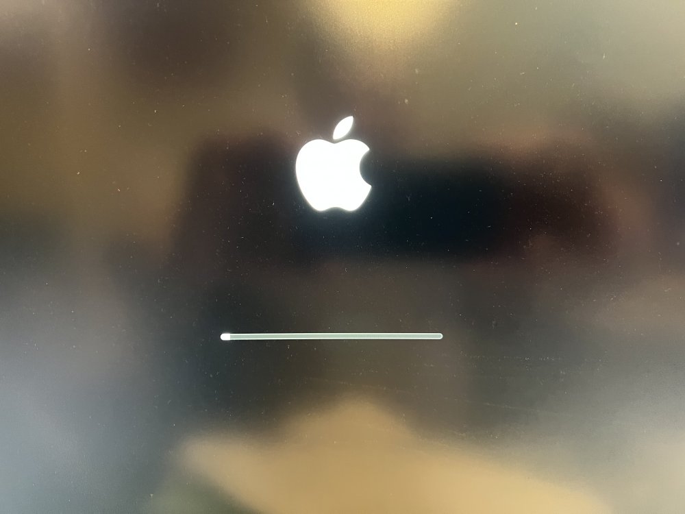

For almost 1.5h?
Is it possible that ResizeBar is active somewhere hidden and it conflicts with 4G?
Ah! We didn't notice that you last screenshot was a caption from an Andy Warhol movie
Spoiler
Spoiler: If you ever see "Sleep", there's reportedly some action in it: The sleeper turns the other way. Once. In five hours and a half.
I had the idea to look again in the DSDT. The two calls to HEC2 methods are conditional (CondRefOf()); if the DSDT does not assume that HEC2 exists, it is presumably NOT critical to boot.
The BIOS only contains the sentence "64-bit PCI BAR addresses not supported", within a list of error messages. No hidden option to resize, as far as I can tell.
Being serious does not bring any idea, so let's go back to the initial joke: You could actually make a movie of the boot screen to catch the actual panic before the flow of com.apple.xpc.launchd messages.

Looks like Enabling only AvoidRuntimeDefrag, DevirtualiseMmio, EnableWriteProtect, ProvideCustomSlide, Enabling 4G Manages to get me into booting the longest until KP.

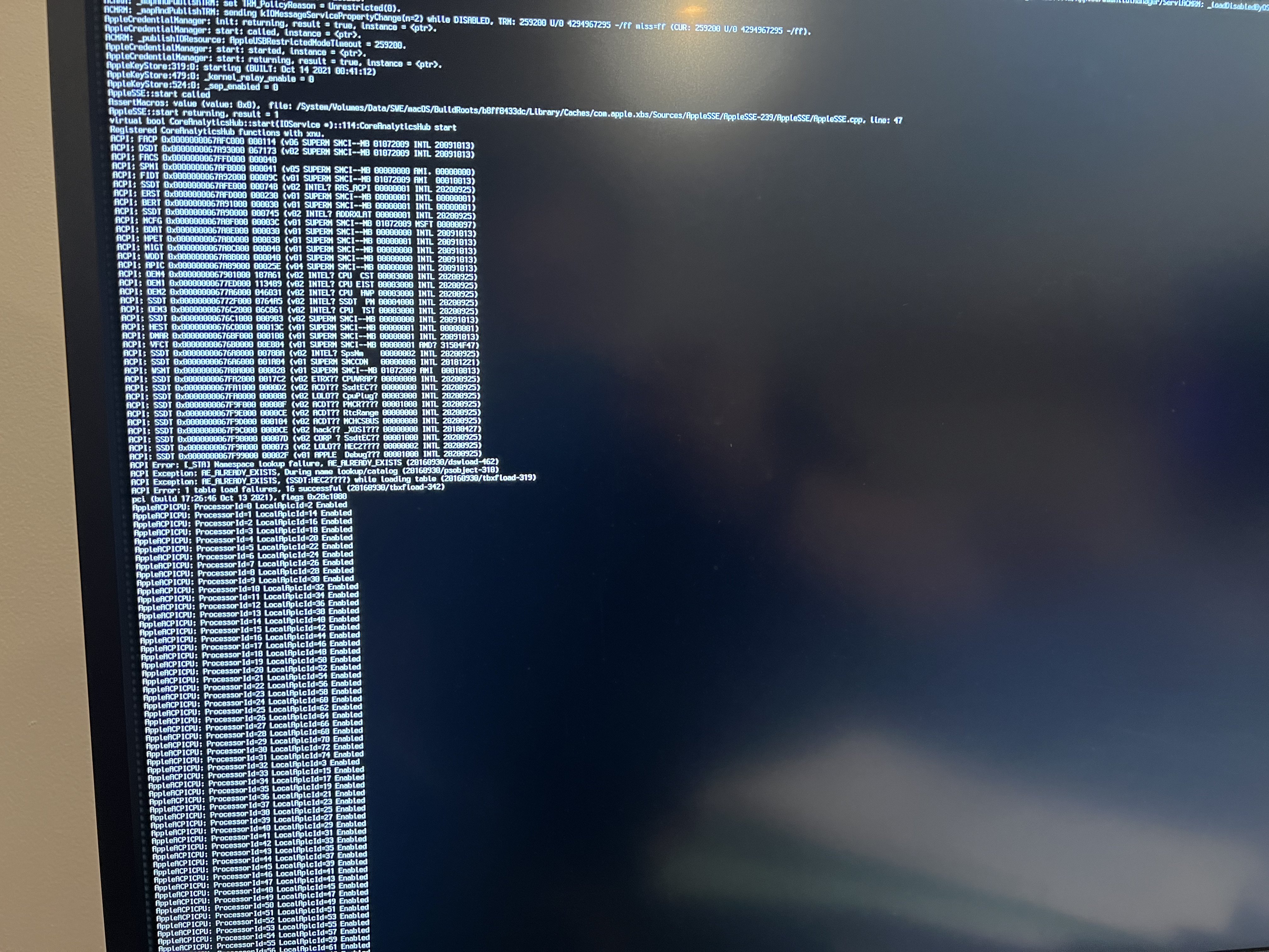

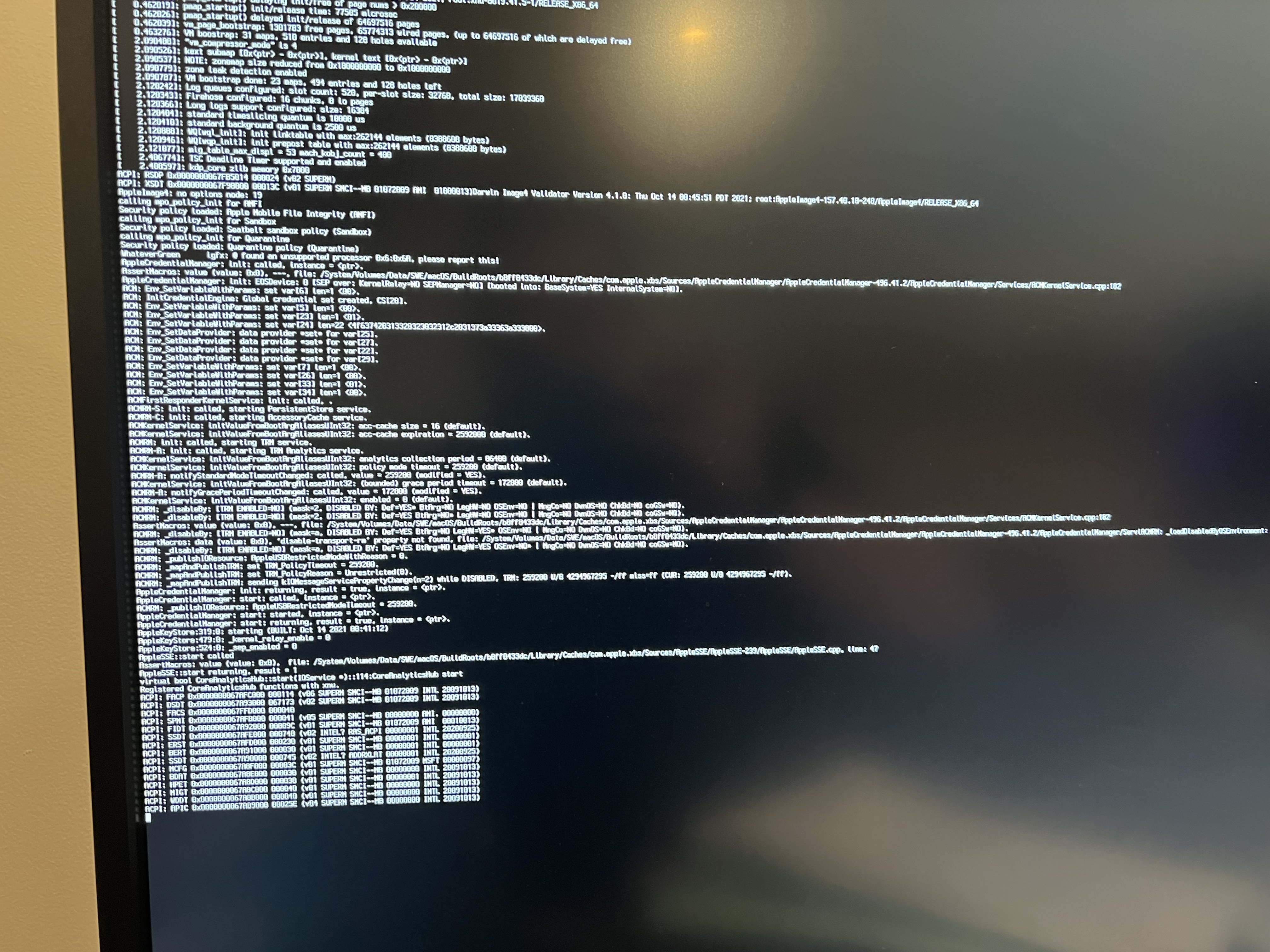

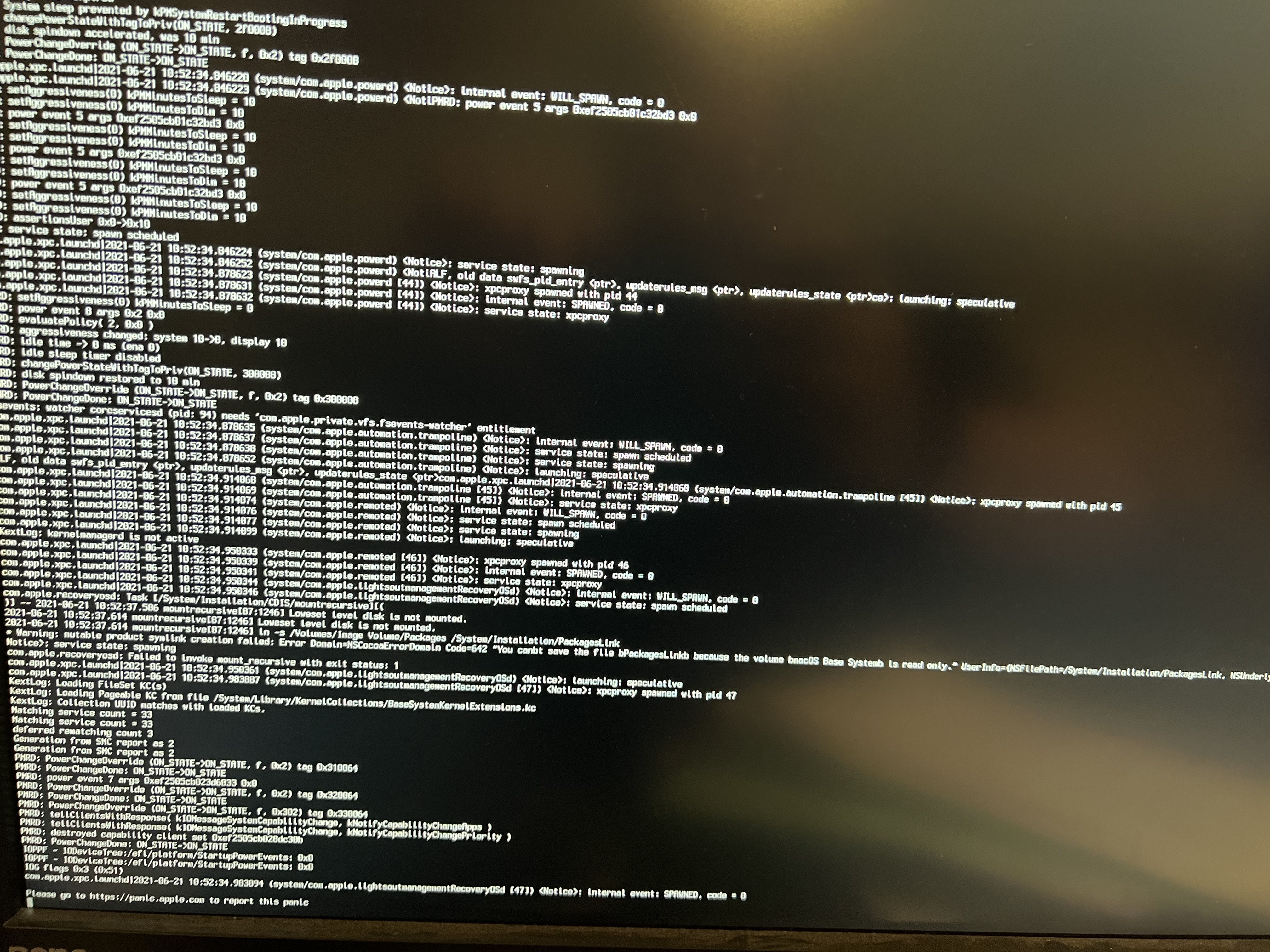

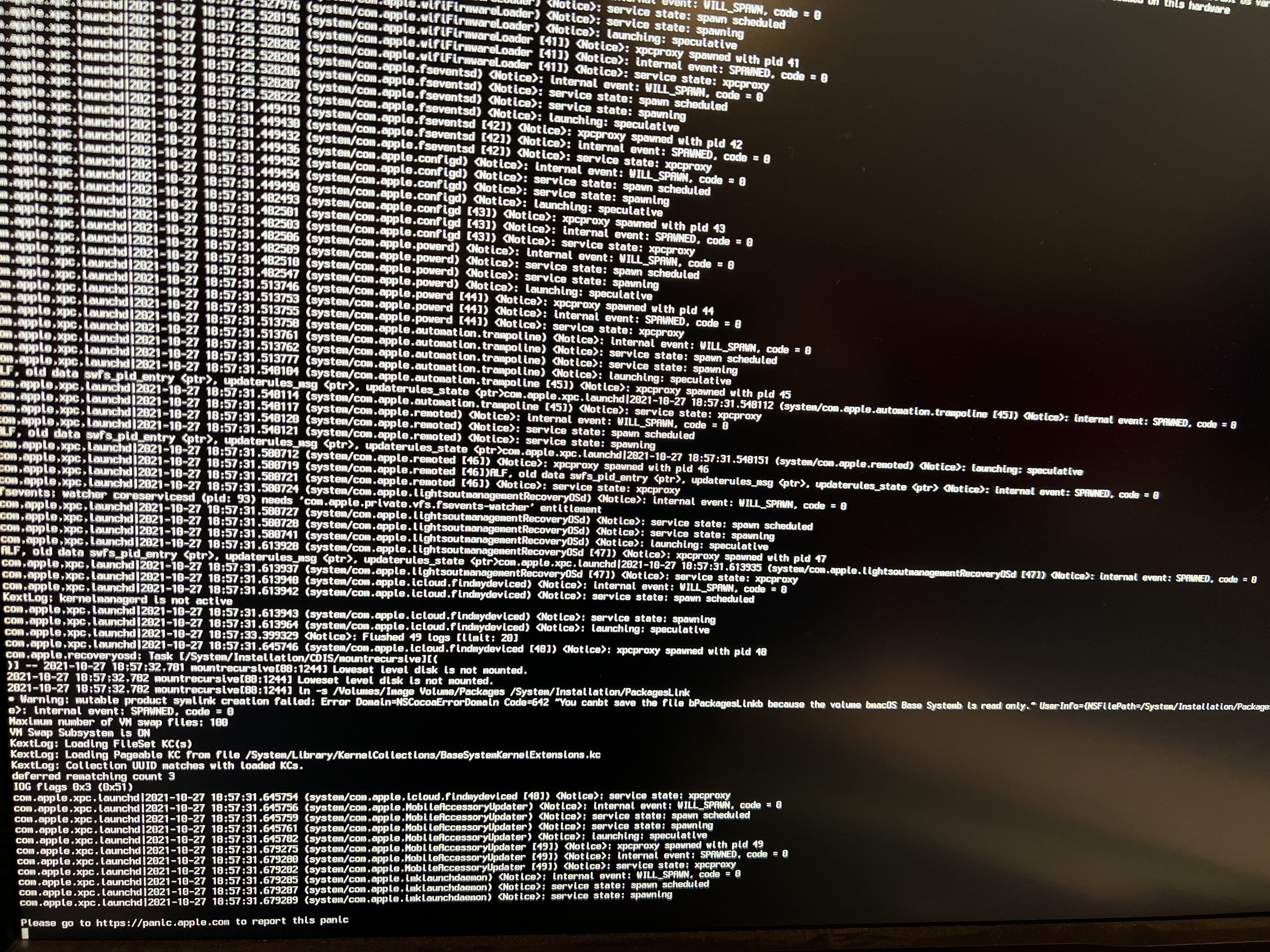

Couple of things I've noticed.
Whatevergreen says that it found unsupported processor.
There is an ACPI Error _STA
 Even with the SSDT still issue with HEC2 (DebugEnhancer is the kext error)
And there is no log on any kernel panics (Sorry for weird photos.)
Just ordered Serial to USB should here by Saturday and hopefully I can finally debug the kernel and see what's the panic is.
Attaching ACPI's just in case (SSDT-HEC2-DISABLE is off in the config).

Lilu & Plugins need on "second" macOS boot stage, you still on "first" stage. So at moment I recommend minimal set for kext - only FakeSMC w/o sensors.

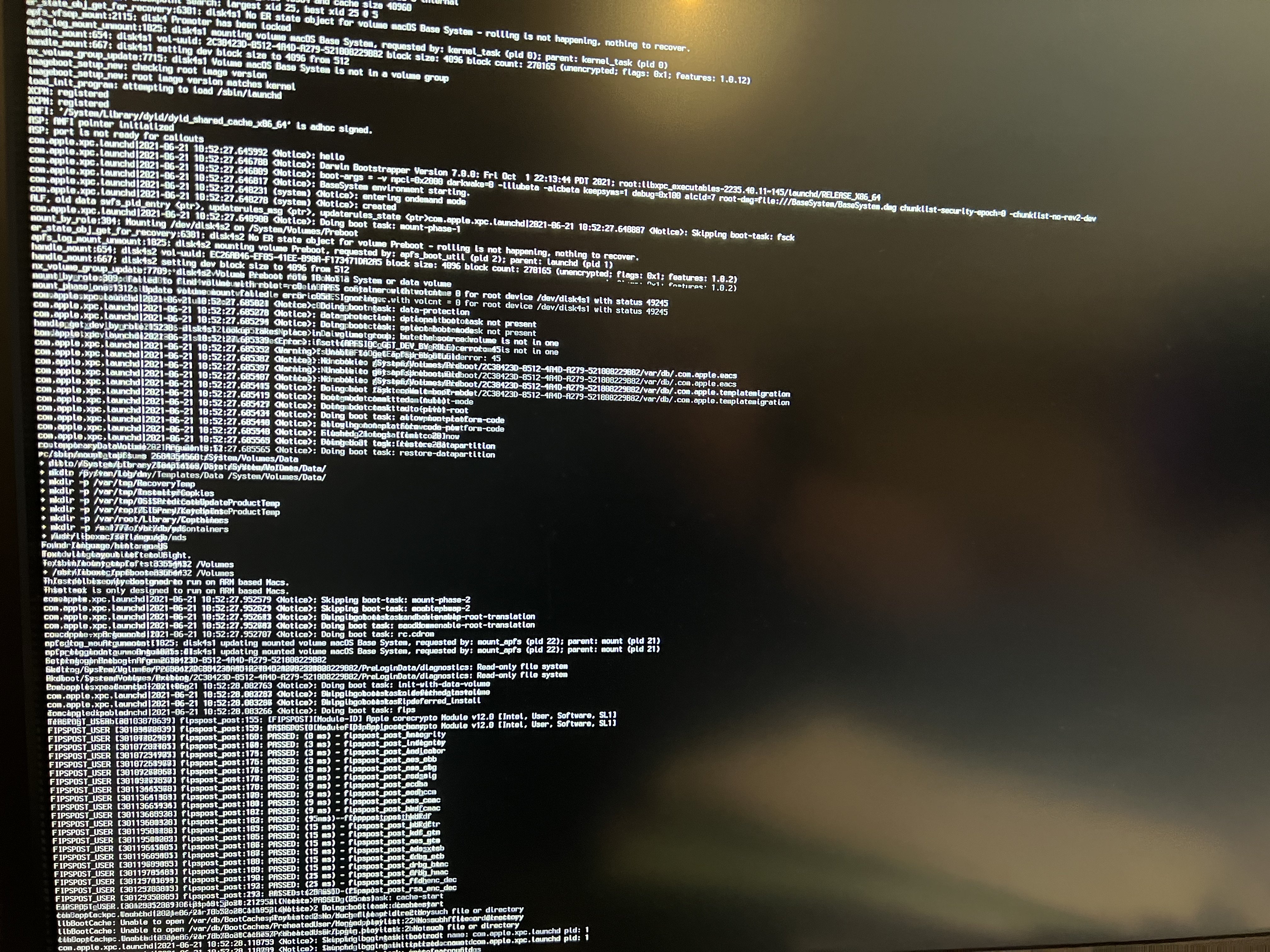

Hey guys, sorry for the late reply, work was kicking my butt.
Well after days of testing I finally managed to get a KP in the debug and you never gonna guess on what.
Disabled HT and enabled all the cores.
com.apple.xpc.launchd|2021-06-21 10:54:11.01626mp2 _(kdspys_etenmte/cro()m. acappn'lte. giecot nsx8e6rv_tiocepos._ilococnk!se rDevibcugesgdin) g< aNonytwicaey!>: # YseOLrOvi
cIOPlatformPanicAction -> IONVMeController
IOPlatformPanicAction -> AppleSMC
panic(cpu 0 caller 0xffffff801f9e5b53): Kernel trap at 0xffffff7fa1880cfb, type 13=general protection, registers:

Kernel version:
Darwin Kernel Version 21.1.0: Wed Oct 13 17:33:23 PDT 2021; root:xnu-8019.41.5~1/RELEASE_X86_64
Kernel UUID: 19BD4E1B-0268-3EE0-BC66-91F035BC9429
KernelCache slide: 0x000000001f600000
KernelCache base:  0xffffff801f800000
Kernel slide:      0x000000001f610000
Kernel text base:  0xffffff801f810000
__HIB  text base: 0xffffff801f700000
System model name: MacPro7,1 (Mac-27AD2F918AE68F61)
System shutdown begun: NO
Panic diags file unavailable, panic occurred prior to initialization
Hibernation exit count: 0
System uptime in nanoseconds: 22255785332
Last Sleep:           absolute           base_tsc          base_nano
  Uptime  : 0x000000052f246afd
  Sleep   : 0x0000000000000000 0x0000000000000000 0x0000000000000000
  Wake    : 0x0000000000000000 0x000001b3c5dd6217 0x0000000000000000
Zone info:
Foreign   : 0xffffff802a3f9000 - 0xffffff802a406000
Native    : 0xffffff81bed98000 - 0xffffffa1bed98000
Readonly  : 0 - 0
Metadata  : 0xffffffd42b387000 - 0xffffffd44ccd1000
Bitmaps   : 0xffffffd44ccd1000 - 0xffffffd48ccd1000
** In Memory Panic Stackshot Succeeded ** Bytes Traced 63530 (Uncompressed 168896) **
Some weird observations.
When not using npci=0x2000
start() provider ID 0x10000046f, supported 0, update 0
AssertMacros: configSupported,  file: /System/Volumes/Data/SWE/macOS/BuildRoots/b8ff8433dc/Library/Caches/com.apple.xbs/Sources/AppleEthernetAquantiaAqtion/AppleEthernetAquantiaAqtion-178.40.2/AppleEthernetAquantiaAqtion/if_axge.cpp, line: 359, value: 0
AppleEthernetAquantiaAqtion113::waitResetStatus(), timeout 0 (1), mask/value 0x1000000/0x1000000, reset_status 0xc5010000
handleResetEnetHw() [providerID 0x10000046f] AQC113 MIF ID 0x211
AppleEthernetAquantiaAqtion113::waitResetStatus(), timeout 0 (4), mask/value 0xc1000000/0xc1000000, reset_status 0xc5010000
patched fwFilterCaps on behalf of FW
using fwFilterCaps 0x60801000100022c4, fwFilterExtCaps 0x0f018080, RPF ART [8,127]
Still waiting for root device
On the side note, does anyone knows why the time is constantly getting messed up in BIOS?
KP Log.txt No Root.txt
Edited by Balamut
Progress!!
Freezes on the Apple logo without any kernel logs. Getting closer.
Attaching the log, am I missing something? This is with the AppleMCEReporterDisabler.kext.
Apple Logo.txt
  • Like 3
