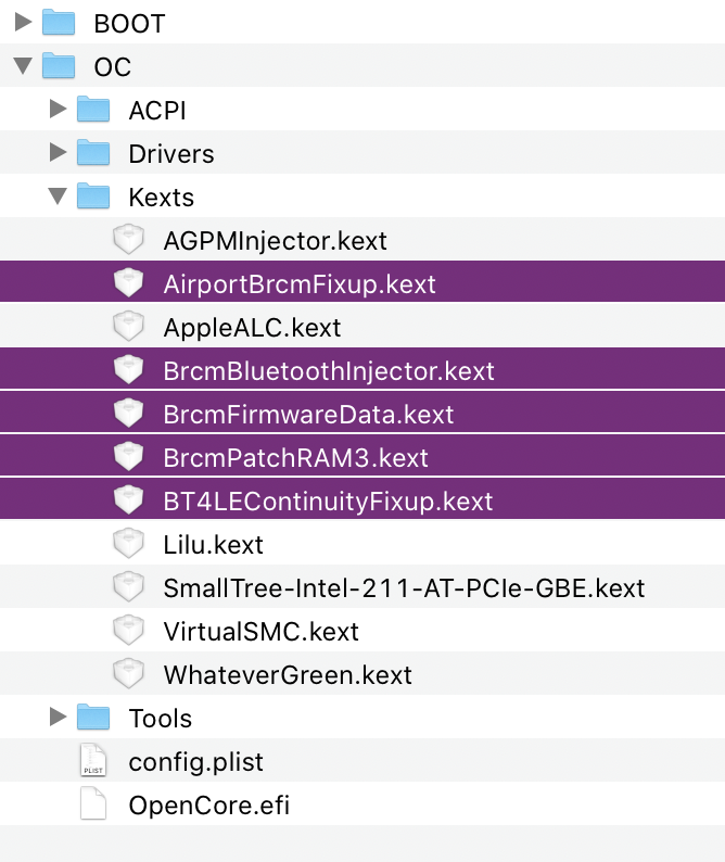

AJC Posted April 3, 2021 Author Share Posted April 3, 2021 how do I get my BCM94352z working ? I know I need to get kexts for it somewhere then do something to the config ? Link to comment https://www.insanelymac.com/forum/topic/347028-help-catalina-install-on-hp-zbook-14u-g6/page/4/#findComment-2754624 Share on other sites More sharing options...

HenryV Posted April 6, 2021 Share Posted April 6, 2021 On 4/3/2021 at 5:41 PM, AJC said: how do I get my BCM94352z working ? I know I need to get kexts for it somewhere then do something to the config ? Make sure your BIOS is not whitelisted against installing the card. Make sure the card is the correct form factor for your motherboard (i.e PCIe or NGFF/M.2) Collect your current kexts. In Open Core make sure kexts are loaded in the correct order after Lilu.kext. Link to comment https://www.insanelymac.com/forum/topic/347028-help-catalina-install-on-hp-zbook-14u-g6/page/4/#findComment-2754841 Share on other sites More sharing options...
AJC Posted April 6, 2021 Author Share Posted April 6, 2021 I’ve collected the kext I need but how do I insert them into the situation? I assume I put them into the kext folder in the EFI but then what ? How do I adjust the config.plist to reflect the new kexts ? Link to comment https://www.insanelymac.com/forum/topic/347028-help-catalina-install-on-hp-zbook-14u-g6/page/4/#findComment-2754853 Share on other sites More sharing options...

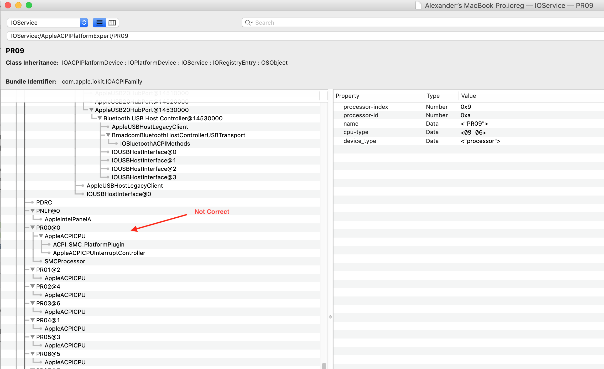

theroadw Posted April 8, 2021 Share Posted April 8, 2021 Yes that's the file. I see a couple of minor things are still off. Your CPU doesn't have Power management, you need SSDT-PLUG You need to map your USB ports Your Thunderbolt device tree needs a SSDT. (It may work as is, but may be glitchy) You have your serial port enabled, (may not be a problem though) There's a few devices without names, but mostly cosmetic so I don't think it matters. You mentioned your brightness is ok? Does the slider work? do your brightness keys change it and it changes in a similar way to Windows? Trackpad has 2 buttons, all working? smooth? CPU usage low while moving trackpad? Sound has no issues? Speaker/Microphone/Headphone? External monitor HDMI port works? All resolutions? and with HDMI audio? Lid close = laptop sleeps / open = wakes? Ethernet works? Webcam? SD Card Reader? Link to comment https://www.insanelymac.com/forum/topic/347028-help-catalina-install-on-hp-zbook-14u-g6/page/4/#findComment-2755026 Share on other sites More sharing options...

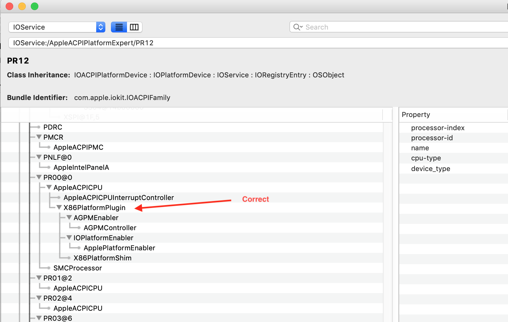

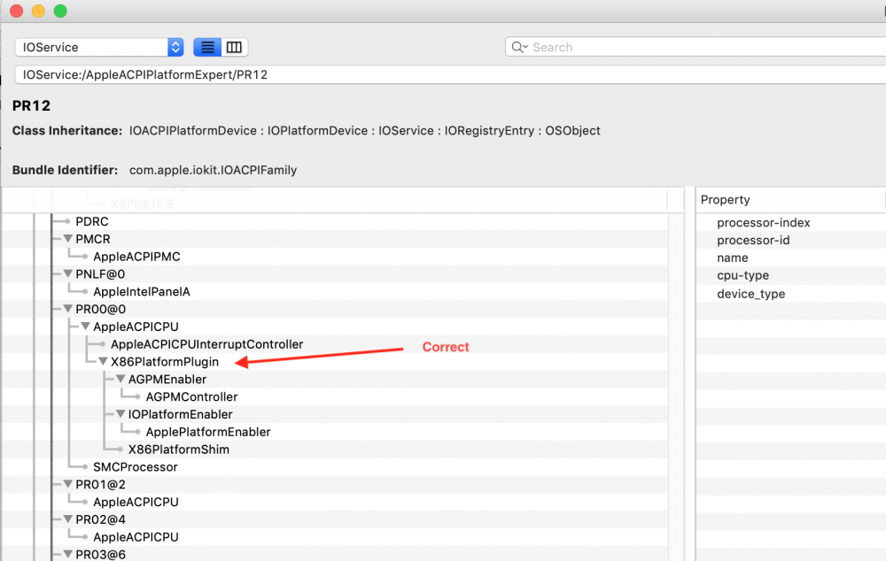

theroadw Posted April 9, 2021 Share Posted April 9, 2021 No, it's good everything else is working! Try adding this SSDT-TB3HP+PLUG.aml SSDT, it has both the Thunderbolt3 and the CPU PM stuff. You have to put it in the EFI-OC-ACPI folder and run Propertree to add to your config.plist If properly loaded you should see: Link to comment https://www.insanelymac.com/forum/topic/347028-help-catalina-install-on-hp-zbook-14u-g6/page/4/#findComment-2755035 Share on other sites More sharing options...

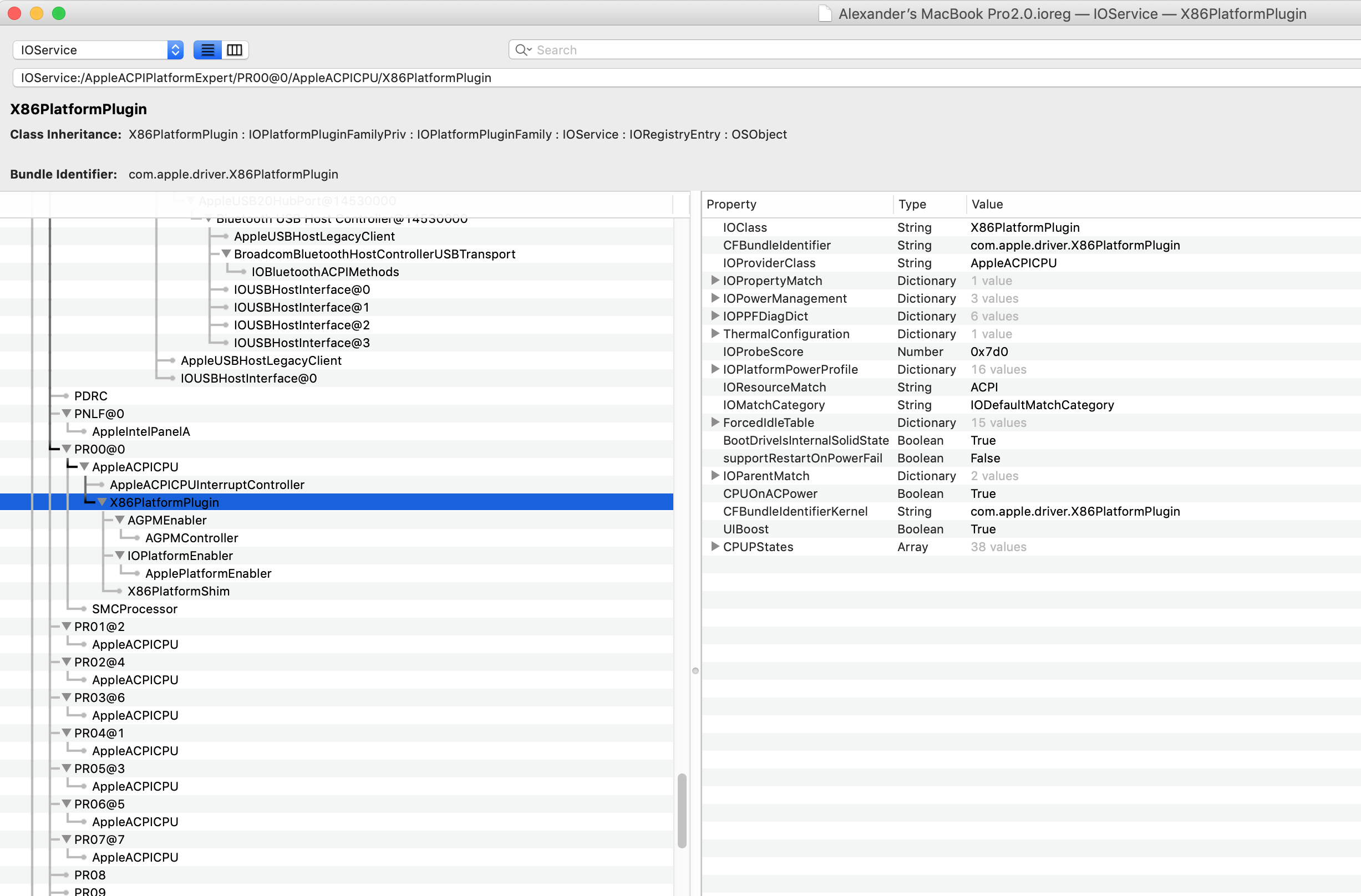

theroadw Posted April 9, 2021 Share Posted April 9, 2021 (edited) PM should be working, TB3 needs method DTGP for some extra device info, so here's a new SSDT SSDT-TB3HP+PLUG.aml to replace the one you have. As far as the SMBIOS, you could also try MacBookPro 16,1 but don't know if you'll see a difference especially if your CPU Friend data is correct for your CPU. -edit- If you're done setting up you machine, I recommend generating new Serial/UUID numbers and don't upload/share your EFI with those numbers. Edited April 9, 2021 by theroadw Link to comment https://www.insanelymac.com/forum/topic/347028-help-catalina-install-on-hp-zbook-14u-g6/page/4/#findComment-2755092 Share on other sites More sharing options...

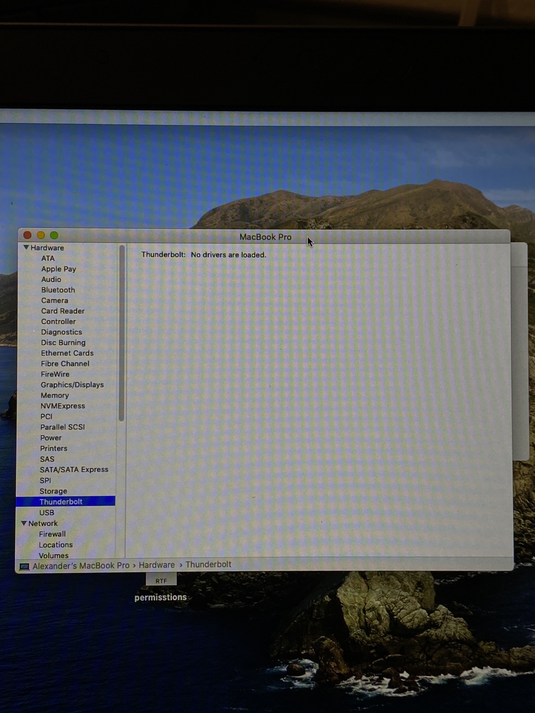

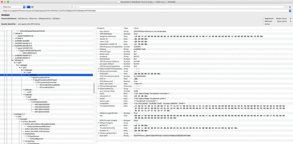

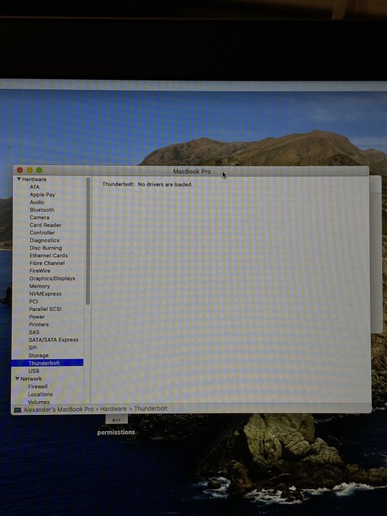

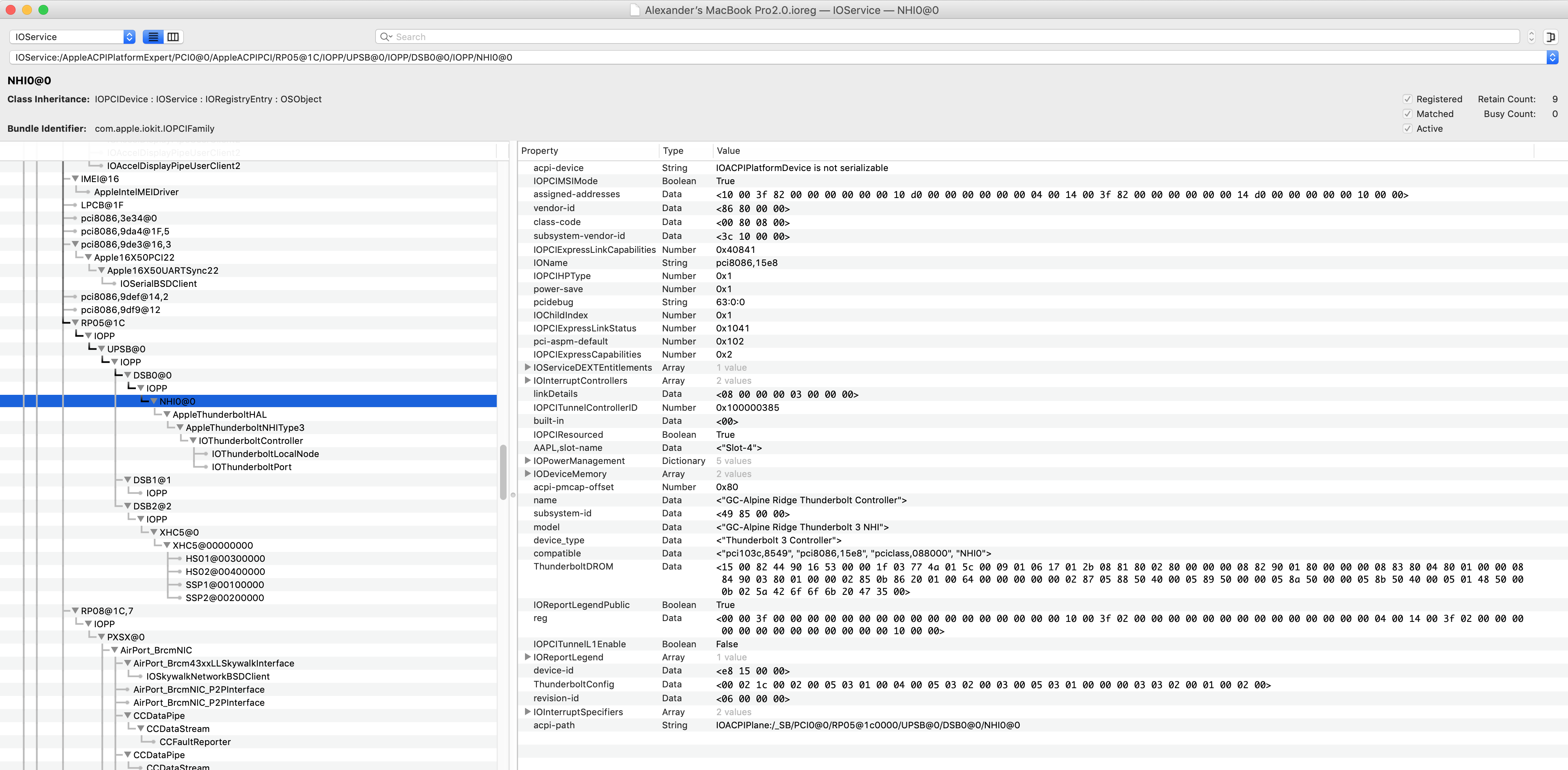

AJC Posted April 9, 2021 Author Share Posted April 9, 2021 here is the new I/O after I replaced the file you just gave me . https://easyupload.io/9ohz4m if thunderbolt is working properly should it be showing up here ? ( see picture ) Also, I tried to test face time and it doesn't work, acts weird when a call tries to come in and it says there is no camera, so I need to get it to recognize the built in camera some how. Link to comment https://www.insanelymac.com/forum/topic/347028-help-catalina-install-on-hp-zbook-14u-g6/page/4/#findComment-2755127 Share on other sites More sharing options...
theroadw Posted April 9, 2021 Share Posted April 9, 2021 Thunderbolt will not show there unles you have flashed the TB Controller Chip with Apple Firmware, but it will show in PCI tab, and here in IOREG you can see the thunderbolt tree is populated. Also the USB-C. As for power management, you can see you now have a bunch of CPU-P States you didn't before, so it is working. Run some benchmarks and see if they compare (roughly) to the same windows benchmarks done in your same computer, and they should be about the same give or take a few points. (CINEBENCH, GEEKBENCH) You can also download intel power gadget and it will show you how the CPU is scaling up and down depending on load. For the camera, it's most lilkely USB, so google time again. You need to find the model (maybe look in device manager in windows) and see if anyone has made a kext for that device id. By the looks of it, your machine is working nicely, enjoy. Link to comment https://www.insanelymac.com/forum/topic/347028-help-catalina-install-on-hp-zbook-14u-g6/page/4/#findComment-2755129 Share on other sites More sharing options...
