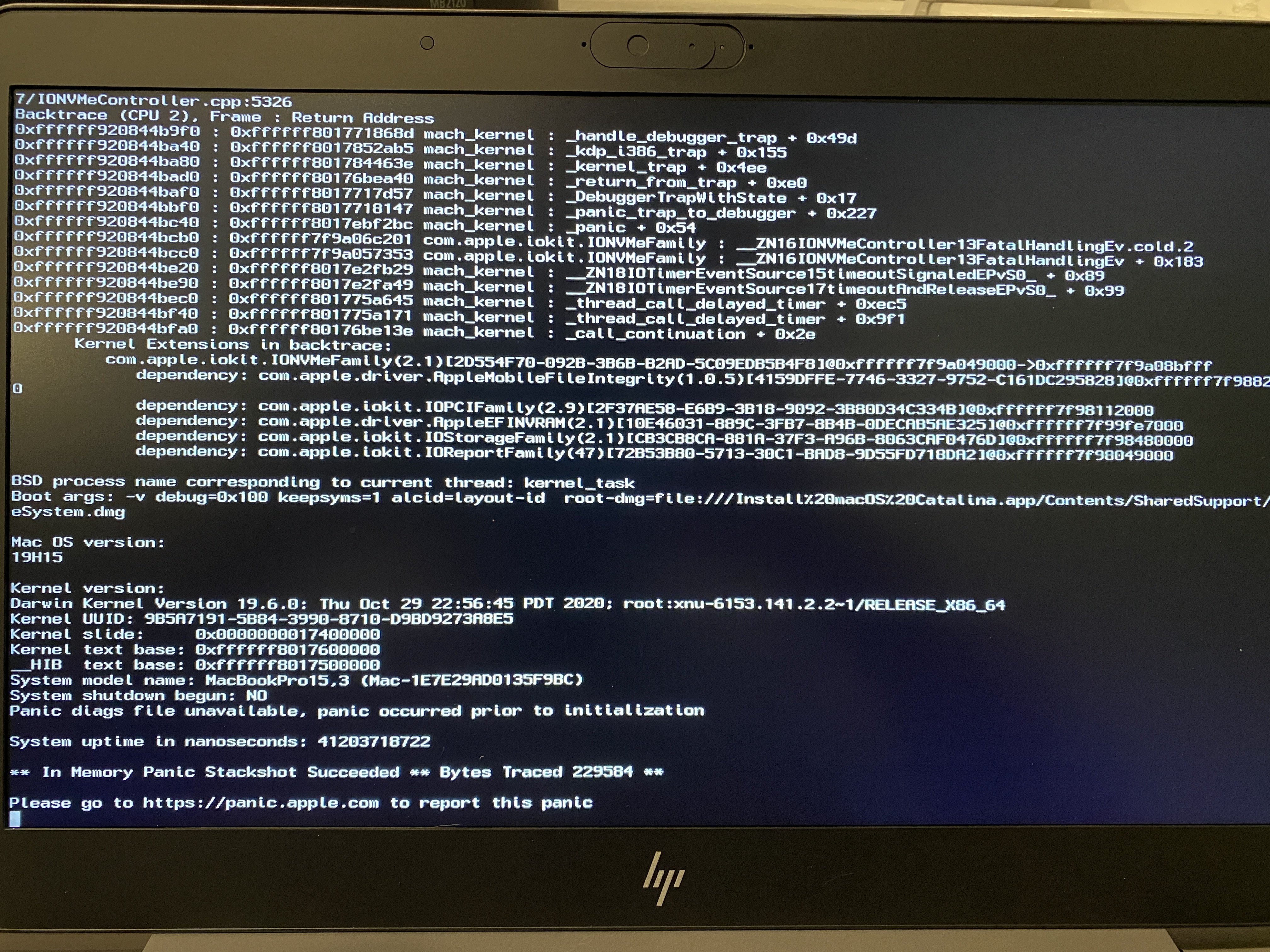

theroadw Posted March 17, 2021 Share Posted March 17, 2021 Also your NVME drive may be the culprit, as these Zbooks come with OEM Samsung drives that refuse to work, and there's no firmware update for them. Link to comment https://www.insanelymac.com/forum/topic/347028-help-catalina-install-on-hp-zbook-14u-g6/#findComment-2753273 Share on other sites More sharing options...

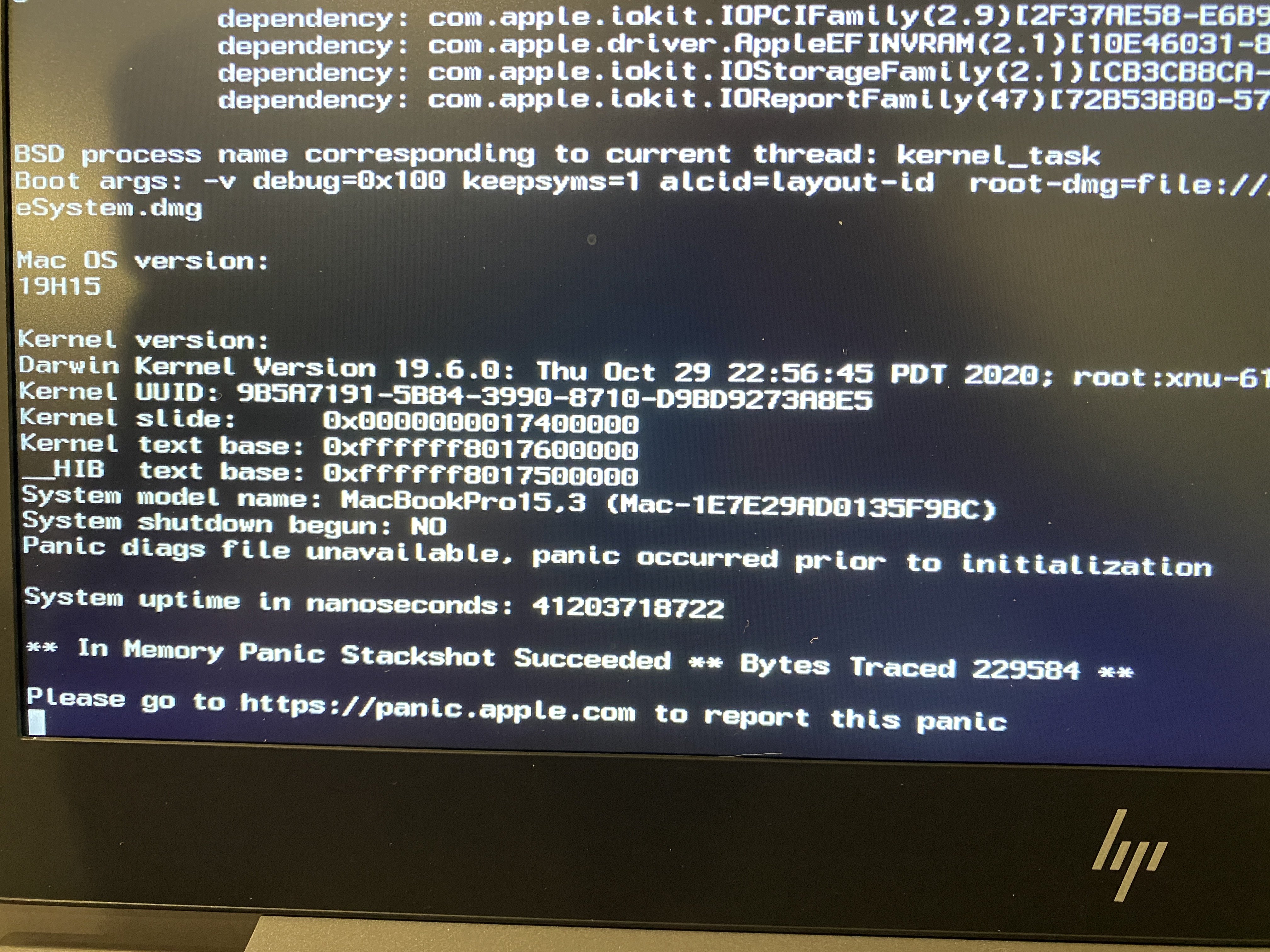

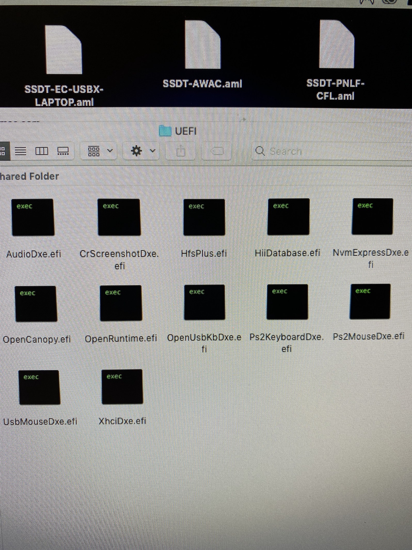

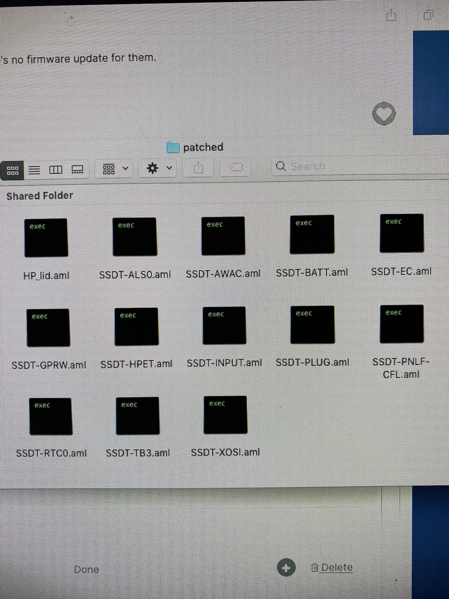

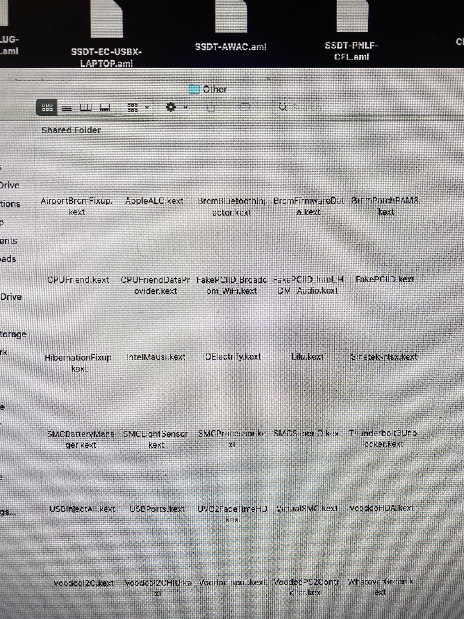

AJC Posted March 17, 2021 Author Share Posted March 17, 2021 Ive attached my Config.plist, and pictures of my drivers, ACPI and kexts folders . if someone could take a look at it and see if you notice a mistake I've made in regards to this laptop I would really appreciate it. ive also attached a couple screen shots of the kernel panics. config.plist Link to comment https://www.insanelymac.com/forum/topic/347028-help-catalina-install-on-hp-zbook-14u-g6/#findComment-2753317 Share on other sites More sharing options...
AJC Posted March 17, 2021 Author Share Posted March 17, 2021 More attachments config.plist Also, what M.2 NVMe Drive do you recommend ? what brand / model is good for a Hackintosh ? Link to comment https://www.insanelymac.com/forum/topic/347028-help-catalina-install-on-hp-zbook-14u-g6/#findComment-2753318 Share on other sites More sharing options...
theroadw Posted March 17, 2021 Share Posted March 17, 2021 I believe you have 2 many things in your config, trim it down and slowly add one thing at a time once you're up and running. Look for NVMEFix.kext to add it and hopefully it will work. The KP could also be dGPU related, turn it off you shouldn't have to fake PCI id's, that could also cause trouble. I've trimmed down your config and it should boot. just add the NVMEFIX in case you get another KP. config.plist Link to comment https://www.insanelymac.com/forum/topic/347028-help-catalina-install-on-hp-zbook-14u-g6/#findComment-2753319 Share on other sites More sharing options...

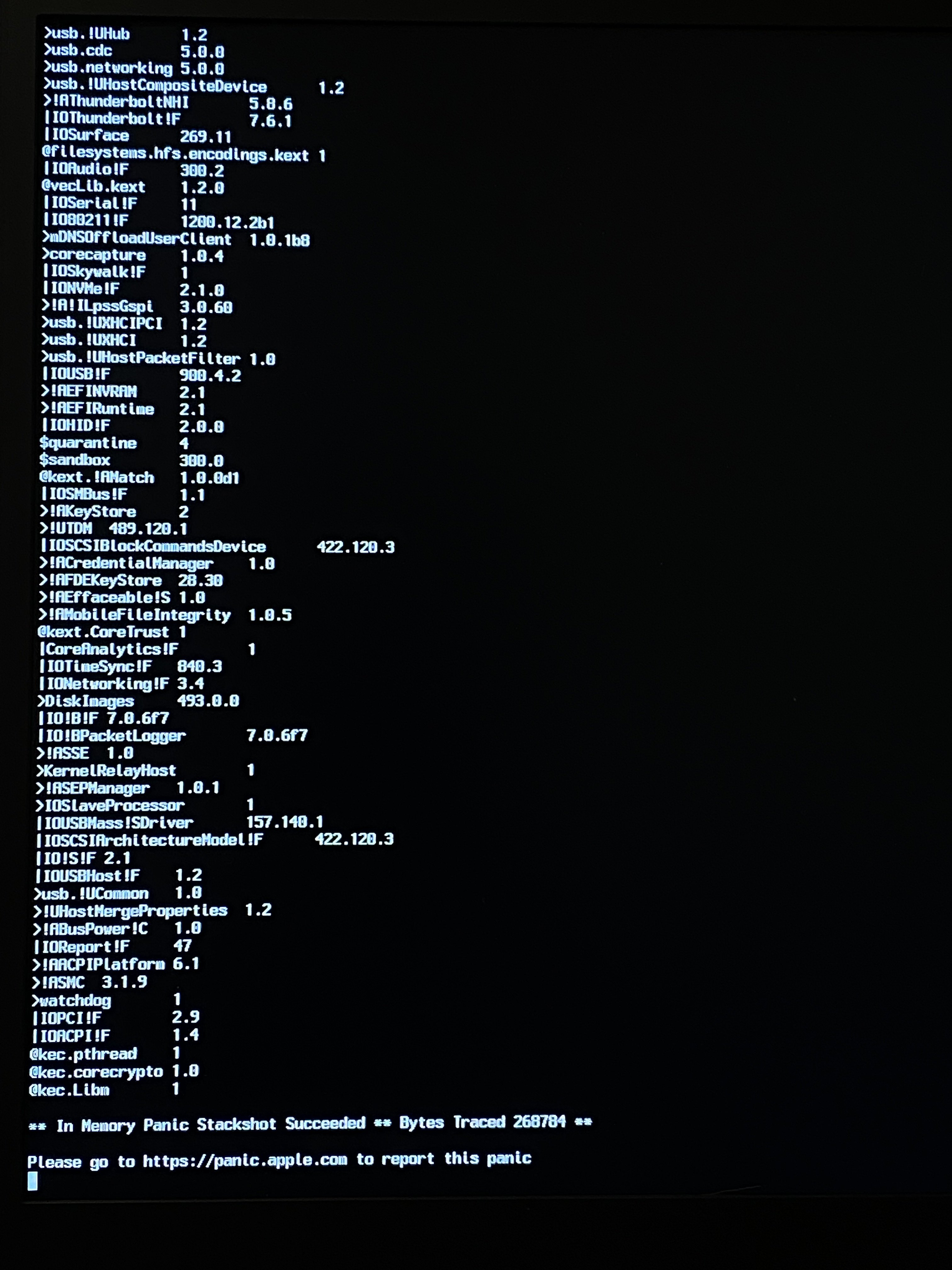

AJC Posted March 18, 2021 Author Share Posted March 18, 2021 I added the NVMe kext that you wanted me to add then I replace the config with your new config , the picture below is what I got when I tried to boot using OC. Link to comment https://www.insanelymac.com/forum/topic/347028-help-catalina-install-on-hp-zbook-14u-g6/#findComment-2753324 Share on other sites More sharing options...

etorix Posted March 19, 2021 Share Posted March 19, 2021 That would be difficult without having the same ZBook… You have indeed way too many things in your EFI folder. There should only be two drivers, Hfsplus.efi and OpenRuntime.efi, and four kexts, Lilu, VirtualSMC, WhateverGreen and possibly AppleALC. Use a USB mouse and try booting with a minimal EFI folder. The trackpad may come once you have succeeded to boot. I use Toshiba/Kioxia XG5 or XG6 M.2 SSDs on all my hacks. Link to comment https://www.insanelymac.com/forum/topic/347028-help-catalina-install-on-hp-zbook-14u-g6/#findComment-2753478 Share on other sites More sharing options...

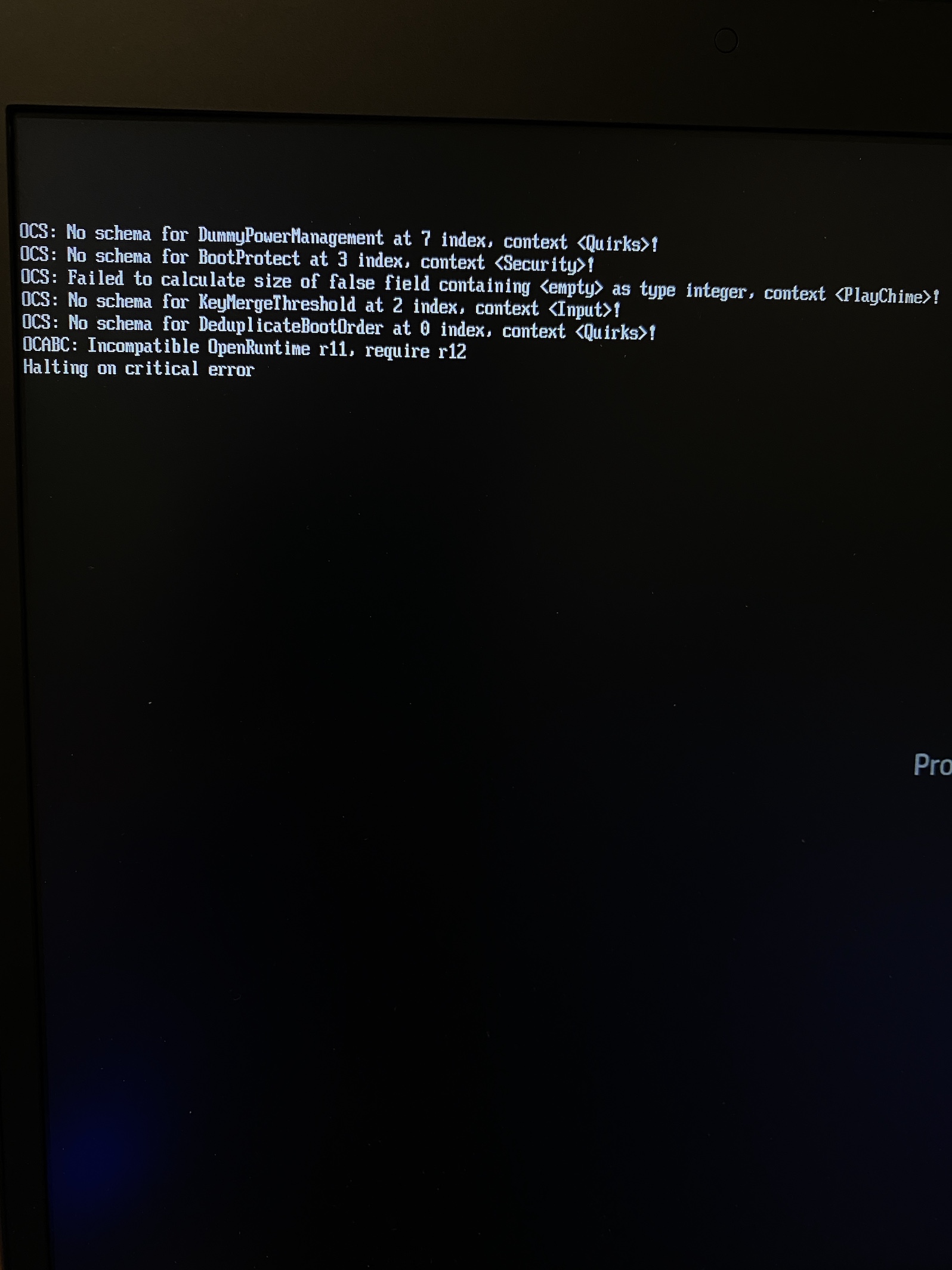

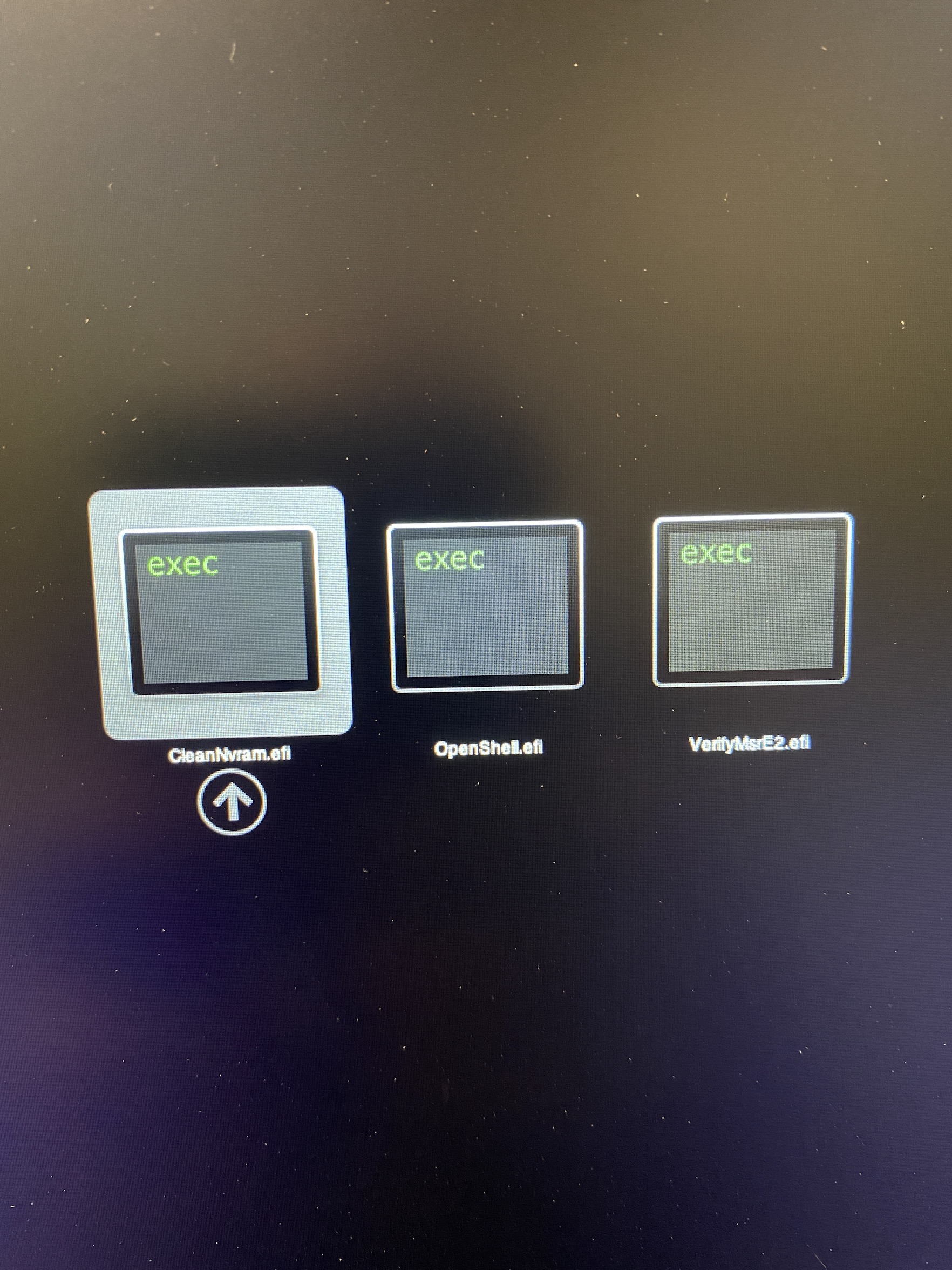

AJC Posted March 28, 2021 Author Share Posted March 28, 2021 I'm confused, the EFI he gave me is in OC not clover. Also, I loaded the refi folder onto the install drive and fired it up and this is what I got ( picture attached) I don't recognize it / know what to do here. Link to comment https://www.insanelymac.com/forum/topic/347028-help-catalina-install-on-hp-zbook-14u-g6/#findComment-2754105 Share on other sites More sharing options...
theroadw Posted March 28, 2021 Share Posted March 28, 2021 Download https://github.com/corpnewt/GenSMBIOS Open terminal and drag and drop GenSMBIOS.command Enter Press 2 Drag and drop your config.plist Press 3 MacBookPro15,1 Q done Link to comment https://www.insanelymac.com/forum/topic/347028-help-catalina-install-on-hp-zbook-14u-g6/#findComment-2754107 Share on other sites More sharing options...
AJC Posted March 28, 2021 Author Share Posted March 28, 2021 what about the picture I just posted ? when it boots off the usb stick there is no option to install ozx , just the options in the picture and I don't recognize any of them. Link to comment https://www.insanelymac.com/forum/topic/347028-help-catalina-install-on-hp-zbook-14u-g6/#findComment-2754108 Share on other sites More sharing options...
theroadw Posted March 28, 2021 Share Posted March 28, 2021 You need to create install media as per dortania opencore guide. Once your install media is done, you replace the EFI folder in the install drive with the one I posted above (With the serial number mods) Right now the OpenCore bootloader from the files above can't find the install drive, so it only shows the tools, (you must have pressed escape or space) Link to comment https://www.insanelymac.com/forum/topic/347028-help-catalina-install-on-hp-zbook-14u-g6/#findComment-2754109 Share on other sites More sharing options...
AJC Posted March 28, 2021 Author Share Posted March 28, 2021 I mounted the EFI partition of the catalina install drive then copied your EFI folder over to it, your refi folder is the only thing on the EFI partition of the install drive Link to comment https://www.insanelymac.com/forum/topic/347028-help-catalina-install-on-hp-zbook-14u-g6/#findComment-2754111 Share on other sites More sharing options...
