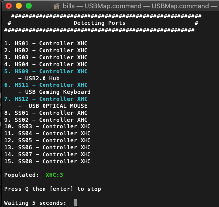

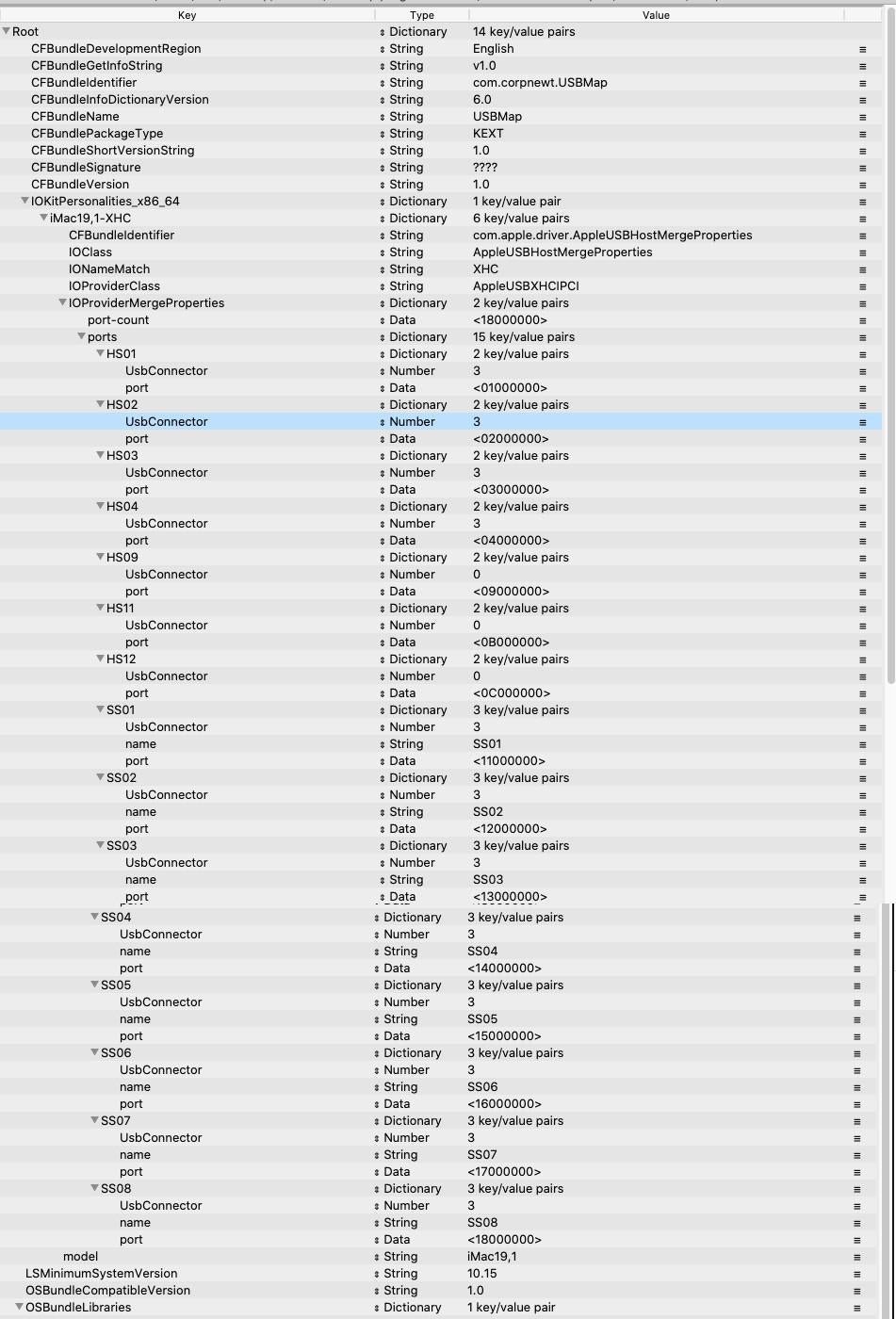

I am having a USB3.0 problem with OpenCore, 10.15.6 catalina, and 400 series motherboard. I have been over this with the guys on the discord channel, and none of us can figure it out.
All of us looked over the USBMap.kext Plist, (below) and could not find any mistakes. Also posted are the USBMap terminal printouts, showing the USBMap.kext as installed is only letting through the USB ports we requested. I ran it through the sanity checker, and it said OK.
Anybody have any ideas?? We are all thinking its some kind of problem with the new 400 series motherboards... HELP!!
Motherboard -- Gigabyte B460M DS3H & i5 chip 10,500
PS. all the ports work in linux. And all the ports show up when the OpenCore boot loader starts up! I put in USB 3.0 flash drives (with Linux ) in the ports, and the boot loader sees and displays them. They do not show up once MacOS gets going. Screwy!!!
Thanks!!!
I did use Hackintool also... and IOReg...
The ports are already mapped. look at the kext  PLIST.  I am looking for errors in the  KEXT- PLIST... or some kind of error that is making this setup not work... People are saying its some kind of BUG having to do with 400 series mother boards...  Any ideas??  Thanks!

remove all the USB related SSDTs and settings in the config (you can use port limit patches) and only boot with USBInjectAll.kext and try to map them again and see if that helps.
yea, i did that. the problem is not the "mapping"-- the mapping seems to be accurate.  there are 2 hubs.  usb 2.0 and usb3.0.   and the 2.0 has 12 ports. And the 3.0 has 8 ports.  I turned off 7 of the usb 2.0 ports, and kept all 8 of the usb 3.0 ports .   to have a total of 15 ports.  The mac limit is 15 ports. Still no Bueno.
I went through all the steps with Cobo (CorpNewt) on Discord, and he could not figure it out. I think its a BUG, since this is a 400 series Mboard.
Also, people say USBInjecaAll.kext does not work on 400 series Mboards... but i am not an expert... so i don't know...
Any ideas??

IIRC, USB3 ports count as 2 ports (HS+SS) so you've got 19 ports. You need to delete more.
