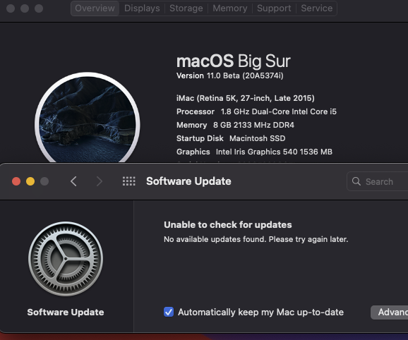

Sherlocks Posted September 23, 2020 Share Posted September 23, 2020 simply changing SIP from E7030000 to 67000000 after reboot the update is immediately activatedyou save me.!!!! perfect!!Sent from my SM-N960N using Tapatalk 1 Link to comment https://www.insanelymac.com/forum/topic/344428-pre-release-macos-big-sur/page/112/#findComment-2738154 Share on other sites More sharing options...
Moviemakergr Posted September 23, 2020 Share Posted September 23, 2020 In my case they needed 3 moves.Rename the disk from preboot change of Sip E7030000 to 67000000and cleaning nVram. 1 Link to comment https://www.insanelymac.com/forum/topic/344428-pre-release-macos-big-sur/page/112/#findComment-2738157 Share on other sites More sharing options...

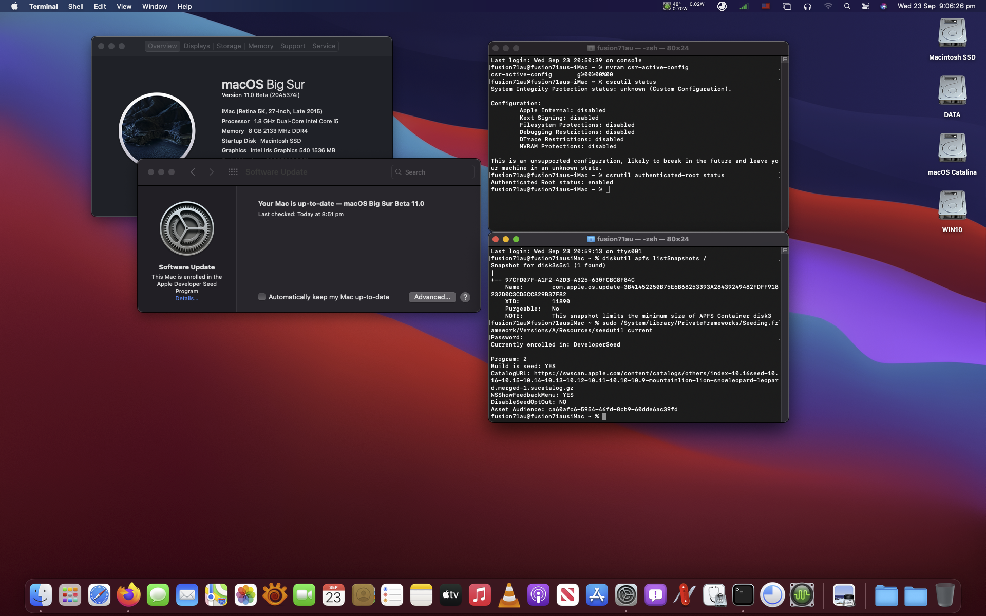

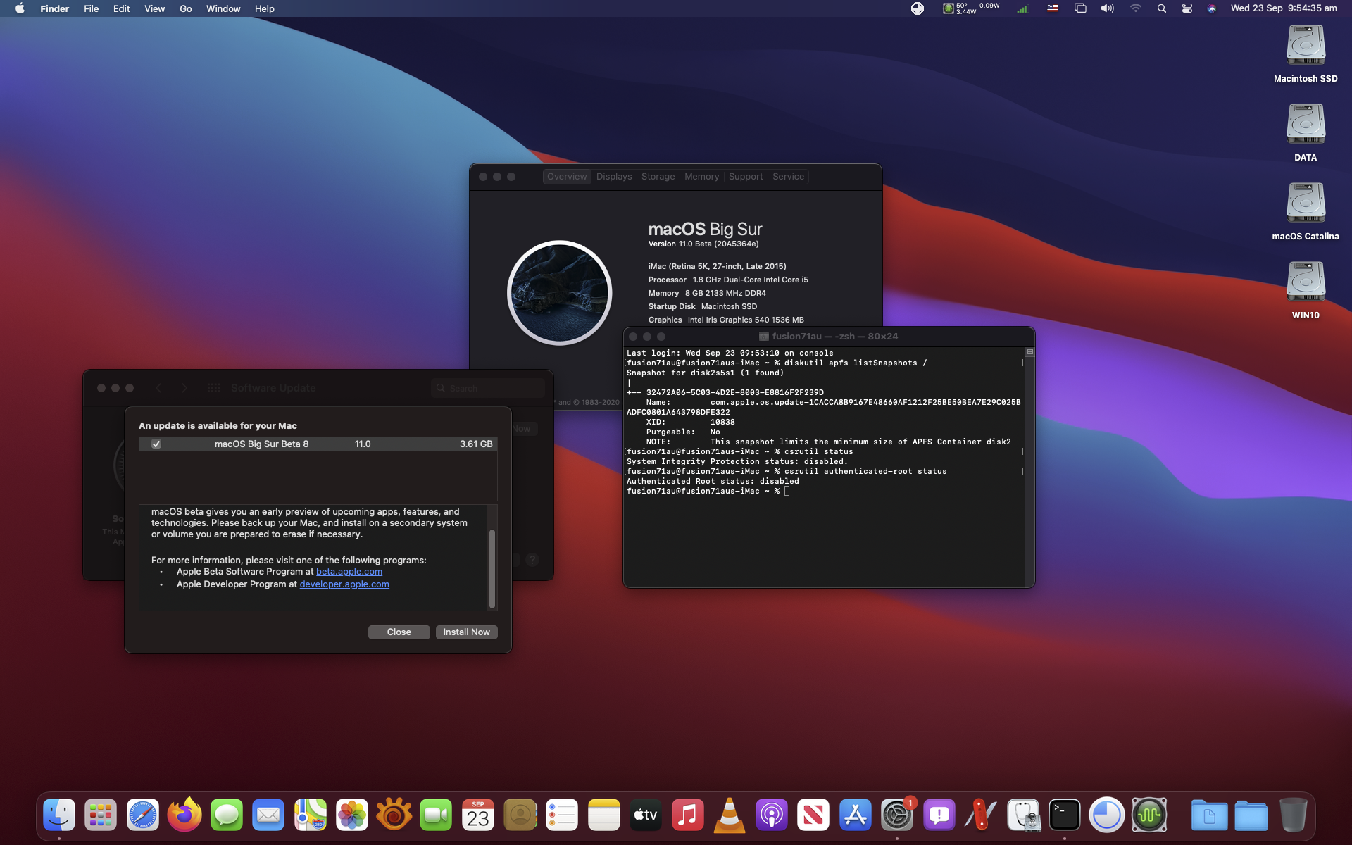

fusion71au Posted September 23, 2020 Share Posted September 23, 2020 (edited) 6 hours ago, rubenpp said: I had to enable SIP for Software Update to get Beta8 to download. Ideally, should enable SIP for OTA software updates to work. However, I needed SIP disabled for my third party USB wifi kexts to load. In Beta6, when you disable SIP with csrutil disable in Recovery terminal —> csr-active-config gets set to g%00%00%00 in nvram —> OTA software update still offered and my update succeeded... Spoiler However in Beta7 and Beta8, when you disable SIP with csrutil disable in Recovery terminal —> csr-active-config gets set to %7f%00%00%00 —> “Unable to check for updates” when running System Preferences/Software Update... Spoiler With csr-active-config = 67000000 in OC config.plist/NVRAM section, reset NVRAM in OC picker, then boot to Beta7/Beta8, software update happy again (csr-active-config now g%00%00%00) and SIP disabled enough for third party USB wifi kexts to load ... Spoiler Edited September 23, 2020 by fusion71au 3 Link to comment https://www.insanelymac.com/forum/topic/344428-pre-release-macos-big-sur/page/112/#findComment-2738166 Share on other sites More sharing options...
Alex HQuest Posted September 23, 2020 Share Posted September 23, 2020 @fusion71au the update process doesn’t care about SIP status; it cares about authenticated root volume status and booting off the snapshot partition. I might wanna look for how to recreate the disk snapshot and re-seal it (or just pay attention to the installer log, since this is done during it)... might come handy. 1 Link to comment https://www.insanelymac.com/forum/topic/344428-pre-release-macos-big-sur/page/112/#findComment-2738171 Share on other sites More sharing options...

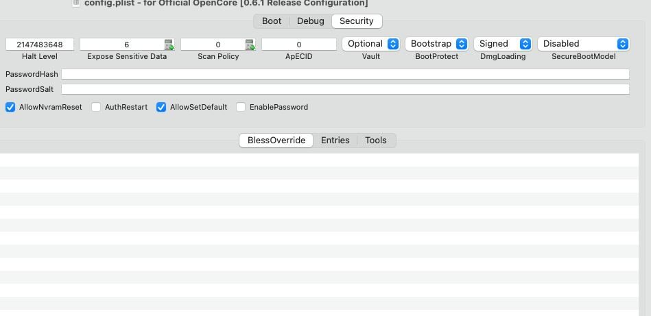

Max.1974 Posted September 23, 2020 Share Posted September 23, 2020 Oh my gosh!!! Open Core update to Beta 8 with securityBootModel > Disable, but real Mac not (Unbelievable) hahahahahaha!!! lol 3 1 Link to comment https://www.insanelymac.com/forum/topic/344428-pre-release-macos-big-sur/page/112/#findComment-2738227 Share on other sites More sharing options...

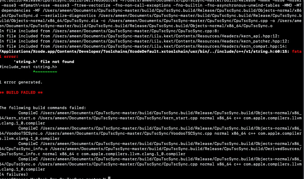

ameenjuz Posted September 23, 2020 Share Posted September 23, 2020 @Andrey1970 i m facing issue to compiling kexts with xcode12 and command line tool xcode 12 please help me what is issue what i should do? Spoiler Link to comment https://www.insanelymac.com/forum/topic/344428-pre-release-macos-big-sur/page/112/#findComment-2738228 Share on other sites More sharing options...
Max.1974 Posted September 23, 2020 Share Posted September 23, 2020 1 Link to comment https://www.insanelymac.com/forum/topic/344428-pre-release-macos-big-sur/page/112/#findComment-2738229 Share on other sites More sharing options...
Pavo Posted September 23, 2020 Share Posted September 23, 2020 30 minutes ago, ameenjuz said: @Andrey1970 i m facing issue to compiling kexts with xcode12 and command line tool xcode 12 please help me what is issue what i should do? Reveal hidden contents You need to git clone the kext repo like normal, cd into that directory after and do a git clone https://github.com/acidanthera/MacKernelSDK inside the kext directory. Then you can compile the kext. 1 Link to comment https://www.insanelymac.com/forum/topic/344428-pre-release-macos-big-sur/page/112/#findComment-2738231 Share on other sites More sharing options...
MaLd0n Posted September 23, 2020 Share Posted September 23, 2020 1 hour ago, ameenjuz said: i m facing issue to compiling kexts with xcode12 and command line tool xcode 12 work fine here Quote echo "##### !!! DOWNLOADING FILES !!! #####" echo " " mkdir /$HOME/Desktop/Lilu4All cd /$HOME/Desktop/Lilu4All git clone https://github.com/acidanthera/MacKernelSDK git clone https://github.com/acidanthera/Lilu git clone https://github.com/acidanthera/VirtualSMC echo "##### !!! COMPILE AND COPY LILU TO FOLDER !!! #####" echo " " cd /$HOME/Desktop/Lilu4All cp -r ./MacKernelSDK ./Lilu xcodebuild -project ./Lilu/Lilu.xcodeproj -configuration Debug clean build ARCHS=x86_64 ONLY_ACTIVE_ARCH=YES CONFIGURATION_BUILD_DIR=/$HOME/Desktop/Lilu4All/Release cd /$HOME/Desktop/Lilu4All cp -r ./Release/Lilu.kext ./VirtualSMC echo "##### !!! COPY MacKernelSDK TO FOLDER !!! #####" echo " " cd /$HOME/Desktop/Lilu4All cp -r ./MacKernelSDK ./VirtualSMC echo "##### !!! START BUILD FILES !!! #####" echo " " cd /$HOME/Desktop/Lilu4All/VirtualSMC/ xcodebuild CONFIGURATION_BUILD_DIR=/$HOME/Desktop/Lilu4All/Release 2 Link to comment https://www.insanelymac.com/forum/topic/344428-pre-release-macos-big-sur/page/112/#findComment-2738233 Share on other sites More sharing options...
ameenjuz Posted September 23, 2020 Share Posted September 23, 2020 17 minutes ago, Pavo said: You need to git clone the kext repo like normal, cd into that directory after and do a git clone https://github.com/acidanthera/MacKernelSDK inside the kext directory. Then you can compile the kext. @Pavo thanks i was not aware about MacKernelSDK thanks once again Link to comment https://www.insanelymac.com/forum/topic/344428-pre-release-macos-big-sur/page/112/#findComment-2738234 Share on other sites More sharing options...
MaLd0n Posted September 23, 2020 Share Posted September 23, 2020 1 hour ago, Max.1974 said: Oh my gosh!!! Open Core update to Beta 8 with securityBootModel > Disable, but real Mac not (Unbelievable) hahahahahaha!!! lol have many protection that not even the apple can escape 1 1 Link to comment https://www.insanelymac.com/forum/topic/344428-pre-release-macos-big-sur/page/112/#findComment-2738235 Share on other sites More sharing options...
Max.1974 Posted September 23, 2020 Share Posted September 23, 2020 2 minutes ago, MaLd0n said: have many protection that not even the apple can escape Thanks a lot @MaLd0n my friend, you help me with this issue, thanks for your effort in advanced!!! If you not tell me, I will never fix this issue on Hack!!! kkkkk 3 Link to comment https://www.insanelymac.com/forum/topic/344428-pre-release-macos-big-sur/page/112/#findComment-2738237 Share on other sites More sharing options...

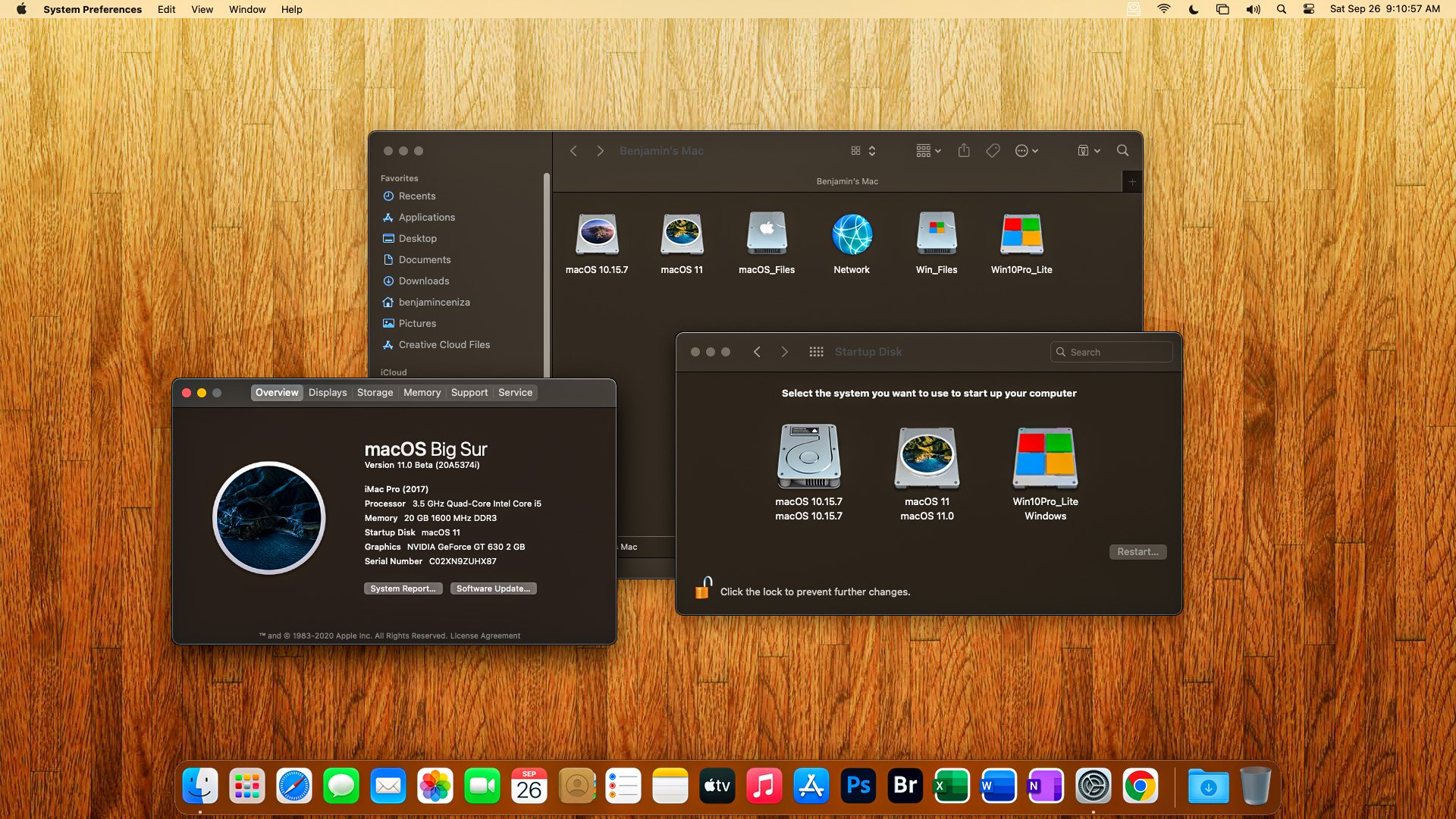

sam298 Posted September 24, 2020 Share Posted September 24, 2020 8 hours ago, eSaF said: The crazy flickering in the System Preferences/Startup Disk is back which I thought was fixed in Beta 7 Reveal hidden contents Screen Recording 2020-09-23 at 16.11.40.mov Beta 7 fixed it for me. Link to comment https://www.insanelymac.com/forum/topic/344428-pre-release-macos-big-sur/page/112/#findComment-2738239 Share on other sites More sharing options...
sam298 Posted September 24, 2020 Share Posted September 24, 2020 13 hours ago, eSaF said: Yea - How is it in Beta 8? Just updated to Beta 8. No flickering in startup disc settings page. Link to comment https://www.insanelymac.com/forum/topic/344428-pre-release-macos-big-sur/page/112/#findComment-2738277 Share on other sites More sharing options...
Partime Posted September 24, 2020 Share Posted September 24, 2020 22 hours ago, eSaF said: The crazy flickering in the System Preferences/Startup Disk is back which I thought was fixed in Beta 7 Reveal hidden contents Screen Recording 2020-09-23 at 16.11.40.mov Good news, I don't see the flicker. Bad news, I don't see my Windows HD as an option. 1 Link to comment https://www.insanelymac.com/forum/topic/344428-pre-release-macos-big-sur/page/112/#findComment-2738280 Share on other sites More sharing options...
hiphopboy Posted September 24, 2020 Share Posted September 24, 2020 so when GM update or final release Link to comment https://www.insanelymac.com/forum/topic/344428-pre-release-macos-big-sur/page/112/#findComment-2738288 Share on other sites More sharing options...
sam298 Posted September 24, 2020 Share Posted September 24, 2020 5 hours ago, Partime said: Good news, I don't see the flicker. Bad news, I don't see my Windows HD as an option. You mean in system prefs - startup disk? Try resetting nvram in opencore menu and reboot. It will make windows as default option in opencore boot menu. I remember in some beta I also saw only the macOS. Link to comment https://www.insanelymac.com/forum/topic/344428-pre-release-macos-big-sur/page/112/#findComment-2738316 Share on other sites More sharing options...

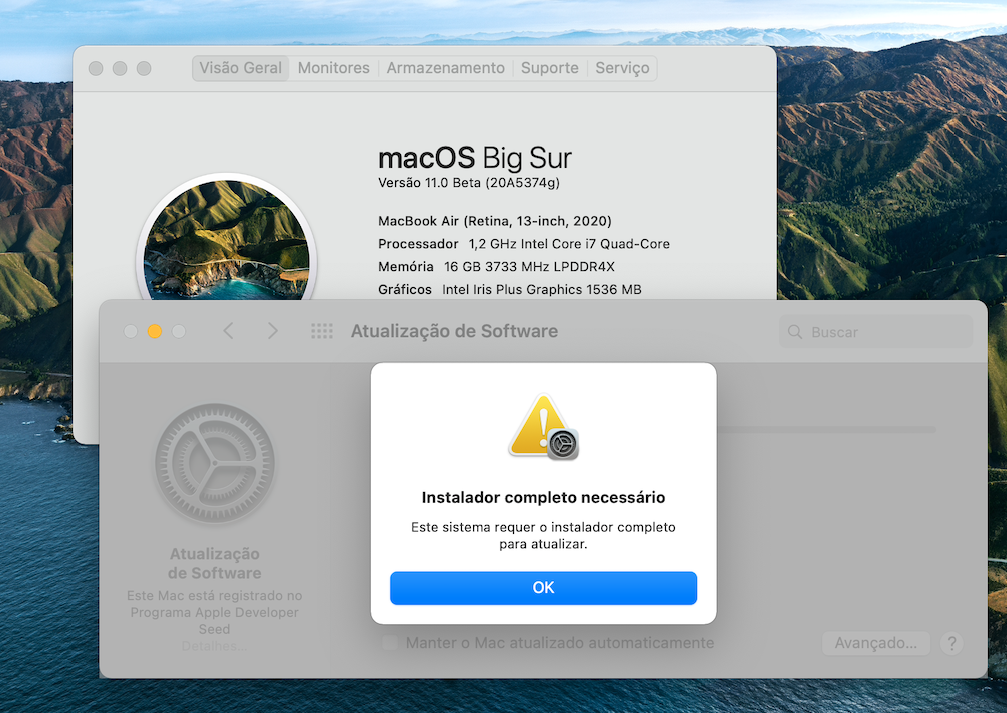

OrpheusInHell Posted September 26, 2020 Share Posted September 26, 2020 Stuck at exitbs:start on the update here. Link to comment https://www.insanelymac.com/forum/topic/344428-pre-release-macos-big-sur/page/112/#findComment-2738444 Share on other sites More sharing options...
