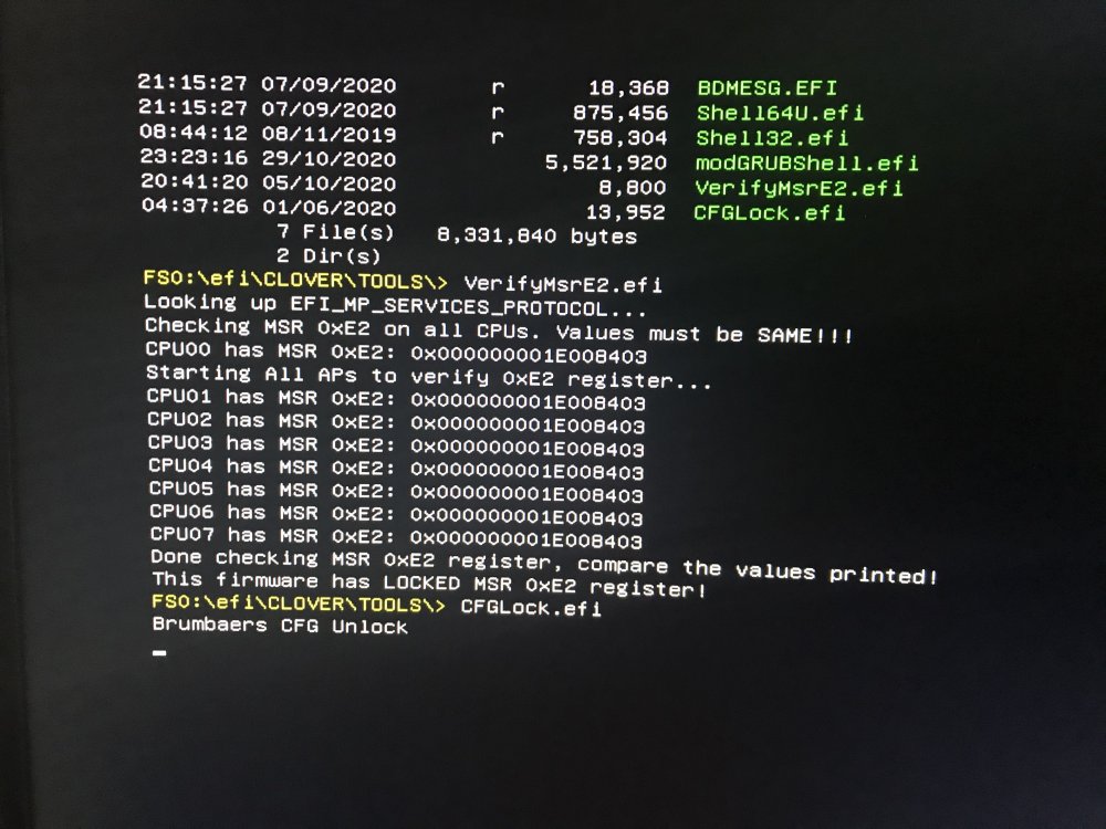

Apple Hunter Posted October 31, 2020 Share Posted October 31, 2020 while run CFGlock it freeze here. how to unlock. Link to comment https://www.insanelymac.com/forum/topic/344035-cfglock-unlock-msr-0xe2/page/2/#findComment-2742627 Share on other sites More sharing options...

MacKonsti Posted December 1, 2020 Share Posted December 1, 2020 (edited) Hello again @Brumbaer and everyone, hope you're all well and safe. So with the June release of CFGLock.efi found in the previous page, I was able to unlock the MSR Ex02 of my CPU on the NUC10i7FNH2 Hackintosh. However, when I tried the same process with the same boot USB on the NUC8i7BEH2 hack, there is a message that there was no "cfg entry" found in NVRAM. So I guess that for that NUC, Intel's firmware is using some custom name for the CPU CfgLock, yes? Because VerifyMsrE2.efi does report the CPUs being locked. Is there some "debug" parameter we can add to OpenCore's config.plist to allow for more details on what was found, perhaps, @Brumbaer ? Just curious really to see what is registered by the firmware (no BIOS entry for CPU Lock of course). Thank you again for your work. Edited December 7, 2020 by MacKonsti 1 Link to comment https://www.insanelymac.com/forum/topic/344035-cfglock-unlock-msr-0xe2/page/2/#findComment-2745956 Share on other sites More sharing options...

MacKonsti Posted March 25, 2021 Share Posted March 25, 2021 (edited) Hi guys, so @tonyx86 I added this new (and latest) ControlMsrE2 in the EFI partition, rebooted (r5131) and selected UEFI Shell. Ran it (manually in the shell). Seems to work OK (no freezes I mean, "interactive" works it seems). The other tool VerifyMsrE2 works too, actually I ran that one first just to be safe. However, NUC8 doesn't have any trace of "cfg" or "msr" in the region that ControlMsrE2 is looking at. My NUC8 remains locked. I think this is due to the fact that the BIOS comes from Intel and they may have hidden it completely. Thanks @BuXb but on my NUC I still cannot find any parameter or string that would prompt to MSR 0xE2 CFG Lock; I saw your Git Hub page, but not sure what you're prompting me to look for? Clearing NVRAM and restarting doesn't have any effect, really. Edited March 25, 2021 by MacKonsti Link to comment https://www.insanelymac.com/forum/topic/344035-cfglock-unlock-msr-0xe2/page/2/#findComment-2753823 Share on other sites More sharing options...
BuXb Posted March 25, 2021 Share Posted March 25, 2021 8 hours ago, MacKonsti said: @BuXbnot sure what you're prompting me to look for? "Right after turning on or rebooting your VivoBook [/your hackintosh], press the ESC key [or equivalent] to intercept booting and to enter the built-in Boot Menu. THIS STEP IS MANDATORY [at least on Asus VivoBook S15] so CFGLock.efi [and ControlMsrE2] can find the CFG variable if run as a tool from within Clover - DON'T SKIP IT! " Link to comment https://www.insanelymac.com/forum/topic/344035-cfglock-unlock-msr-0xe2/page/2/#findComment-2753864 Share on other sites More sharing options...
MacKonsti Posted March 25, 2021 Share Posted March 25, 2021 Hi mate, thanks for the clarification but I fail to see how different is running the CFG tool from UEFI Shell of Clover, and an entry as Tool (that I have never tried in my life). So by ESC key you mean access the Clover menu, yes @BuXb? I have a time-out of 10 seconds in all my machines (i.e. no direct boot) so I always access Clover menus etc. However, I believe that the Visual BIOS from Intel just has no setting and it's not available in the firmware's NVRAM that CFGLock.efi [and ControlMsrE2] access (that is my impression)... or they masked it very well to some crazy-Intel-internal wording.... Link to comment https://www.insanelymac.com/forum/topic/344035-cfglock-unlock-msr-0xe2/page/2/#findComment-2753872 Share on other sites More sharing options...
BuXb Posted March 25, 2021 Share Posted March 25, 2021 No.. first boot into your COMPUTER's boot menu, THEN into Clover Link to comment https://www.insanelymac.com/forum/topic/344035-cfglock-unlock-msr-0xe2/page/2/#findComment-2753874 Share on other sites More sharing options...
Slice Posted March 26, 2021 Share Posted March 26, 2021 Then into Shell and then into ControlMsrE2. The application is now compiled with Clover and will be included into next Clover release. 2 1 Link to comment https://www.insanelymac.com/forum/topic/344035-cfglock-unlock-msr-0xe2/page/2/#findComment-2753900 Share on other sites More sharing options...
