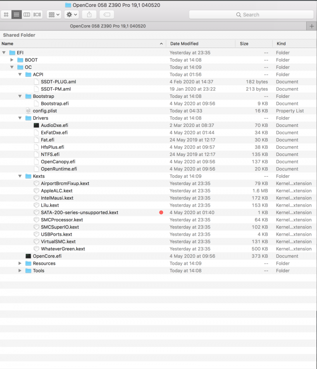

char543 Posted May 8, 2020 Author Share Posted May 8, 2020 8 minutes ago, BALDY_MAN said: Google OpenCore Desktop Guide. to build you Efi folder Hey @BALDY_MAN, Thanks for the response! I managed to get so far with the EFI folder but couldn't proceed because i need the actual hardware to start dumping SSDT's etc. Here's a screenshot of my EFI folder so far. I think I'm on the right track Link to comment Share on other sites More sharing options...
BALDY_MAN Posted May 8, 2020 Share Posted May 8, 2020 1 hour ago, char543 said: Hey @BALDY_MAN, Thanks for the response! I managed to get so far with the EFI folder but couldn't proceed because i need the actual hardware to start dumping SSDT's etc. Here's a screenshot of my EFI folder so far. I think I'm on the right track look at this link https://dortania.github.io/OpenCore-Desktop-Guide/config.plist/coffee-lake.html#starting-point. Link to comment Share on other sites More sharing options...
1Ale1 Posted May 8, 2020 Share Posted May 8, 2020 5 hours ago, char543 said: Here's a screenshot of my EFI folder so far. I think I'm on the right track Use OpenCore 0.5.8 instead, also, take particularly care about ACPI Link to comment Share on other sites More sharing options...
char543 Posted May 8, 2020 Author Share Posted May 8, 2020 6 hours ago, 1Ale1 said: Use OpenCore 0.5.8 instead, also, take particularly care about ACPI Will do, Thanks! Wasn't aware there was a new version already. Can i just copy over my accumulated drivers / kexts etc into the new version or have they been / must they be updated also? What do you mean regarding ACPI? Thanks again :-) Link to comment Share on other sites More sharing options...

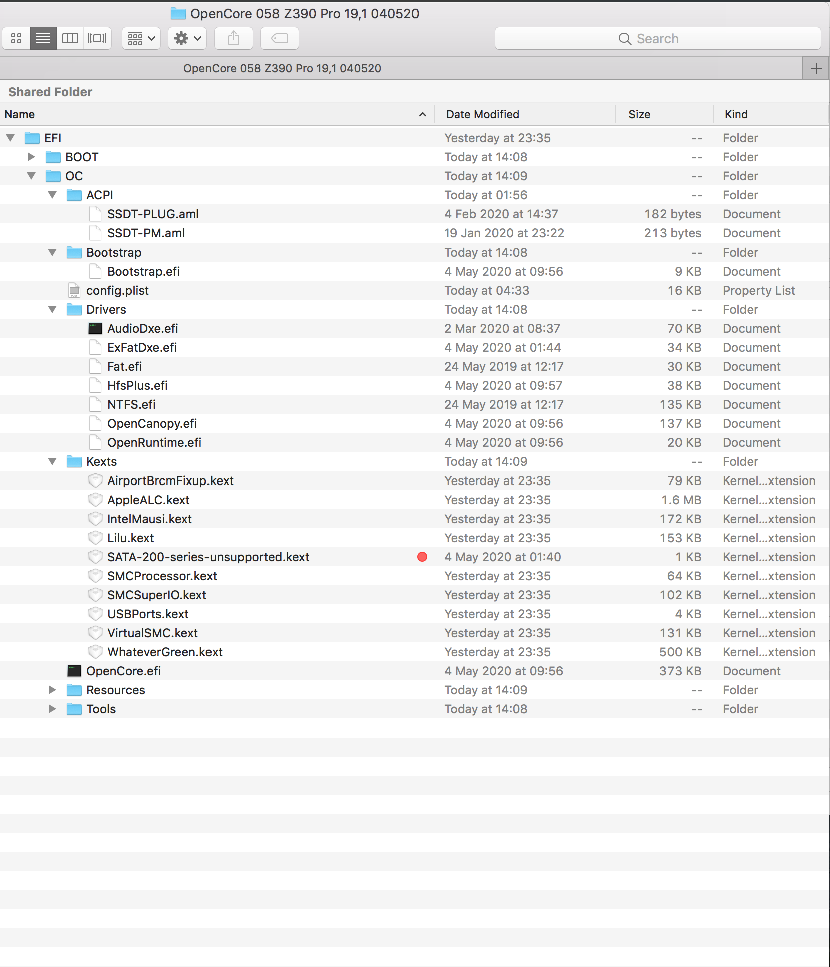

char543 Posted May 15, 2020 Author Share Posted May 15, 2020 (edited) On 5/14/2020 at 9:02 AM, Fullyarm said: https://www.insanelymac.com/forum/topic/339980-audiogods-aorus-z390-pro-patched-dsdt-mini-guide-and-discussion/ great info here! Hey bud, Thanks alot for this. I ended up downloading AudioGod's EFI folder for iMac 19,1. After that just added some of the original drivers and kexts i had chosen (FAT / NTFS support etc) Modded the config.plist to include the extra drivers + kexts. (+ remove russian language / set personal SN UUID etc, etc) I Installed bios f12d as i have the Aorus Pro Z390, then i installed and saved the profile patch in AudioGod's guide to bios for MSR Unlock It went through install without a hitch, and is now (after replacing internal efi folder) able to boot from Internal NVMe drive no probs :-) I've logged into icloud etc and can send msgs through messages app, so i presume the iServices are all working / okay. :-) I will test a little more soon regarding the iServices, Verify MSR Unlock and verify NVRAM is setup correctly / functioning. Overall very happy with how that went! I dont know if iGPU is working as it should? It shows up in system profiler under PCI but under Graphics / Displays only Vega 64 is listed. When i click on about this mac the Vega 64 is the only thing thats listed there too Thanks again for all your help! Hopefully this can be of use to someone else with similar build. Im now stuck trying to install windows 10 on another NVMe drive, without messing up the mac install on the first Its an intel 660p SSD and windows doesnt see the drive to install on i have tried putting both the actual driver for the intel nvme and the client driver onto a usb and looked to load them up from win 10 installer but it still doesnt work. I tried to disable SATA also but no joy there either. Apart fron these couple of issues im trying to iron out, it already seems very stable, install was a breeze just like a real mac! wifi and bluetooth working OTB from fenvi hb-1200 heres a screenshot of the EFI I ended up going with Edited May 15, 2020 by char543 Link to comment Share on other sites More sharing options...
