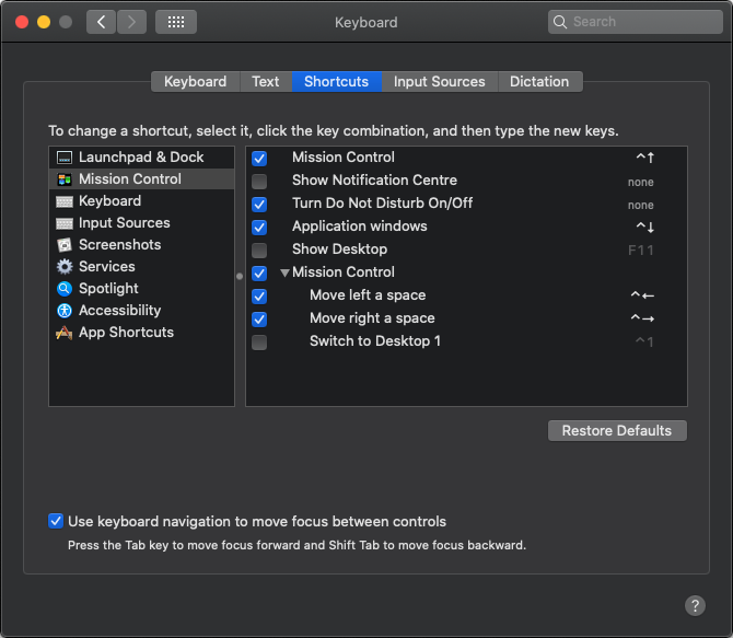

MacKonsti Posted June 16, 2020 Share Posted June 16, 2020 (edited) Good evening @MaLd0n I hope you are well and safe! Apologies for the delay (due to being busy) but I have been thinking about this, and wanted your opinion. I am sharing my EFI but I think that the problem lies in the VoodooPS2Controller.kext or plugin -- why? a) We use the same BIOS, latest Clover, latest Catalina; b) We use the same patched DSDT, and I confirmed the Brightness up/down events go through _Q11 and _Q12; c) The Notify (PS2K, 0x0405) and Notify (PS2K, 0x0406) seem common in most laptops, even Lenovo, after my research; d) The only difference? You have F13/F14 like a real Mac, for 14" models like mine, only F11/F12. e) The other difference? I do not have the shortcuts for Brightness, shown in System Preferences > Keyboard > Shortcuts (that I get on my Mac at work!) Look in my image! I believe that either the VoodooPS2Controller.kext binary needs fixing, or something must be fixed in the Info.plist of the VoodooPS2Keyboard.kext that defines keyboard keys! (it's the only one in the Plugins folder, too). Any idea where to start from? I bet that if you run my EFI folder from some USB boot-disk, your Brightness will work. P.S. My ZIP file here doesn't contain WiFi or BTLE kexts as I am still waiting for the replacement BRCM card in the post... I am including a) preboot.log b) re-dumped original ACPI tables c) my DSDT too, where I did some efforts, as a secondary option. Please note that I am not using the NullEthernet kext from Rehabman (you won't find it in kexts/Other I mean, it's known). Obrigado UPDATE: Just tried also these values form this hack, no results (still hear the beep sound when pressing F11/F12 with or without Fn, I also tried Fn+S/B that you had mentioned... https://github.com/jsassu20/OpenCore-HotPatching-Guide/blob/master/17-Brightness Shortcut Patch/SSDT-BKeyQ11Q12-LenovoAir.dsl S145-14iWL EFI 4MB https://we.tl/t-7wt0v0NuqA (valid 1 week) Edited June 16, 2020 by MacKonsti Link to comment Share on other sites More sharing options...

MacKonsti Posted June 26, 2020 Share Posted June 26, 2020 Hi @MaLd0n how are you? You will not believe it... After searching for days, eventually I decided to find a way to reset the Keyboard Shortcuts. So according to the solution proposed in this article, I deleted file ~/Library/Preferences/com.apple.symbolichotkeys.plist and rebooted. Guess what... the F11/F12 keys worked with the Notify 0x0405 and 0x0406 values... I am banging my head on the wall ! So free lesson learned, that you can use: If problems with keyboard shortcuts = delete file ~/Library/Preferences/com.apple.symbolichotkeys.plist and reboot! Thank you for your patience and help all this time. I suspect the keyboard shortcuts were never created inside the .plist as I had booted without PNLF etc. originally, that was before using your DSDT... However, in System Preferences > Keyboard > Shortcuts, I still do NOT see "Brightness" anywhere but it works. Please, if you have time, kindly check my PM that regards the overall DSDT patching Obrigado! P.S. By the way, despite your solution to fix trackpad polling works great (as I saw over at Olarila) did you try this alternate solution proposed here, please? https://voodooi2c.github.io/#GPIO Pinning/GPIO Pinning I would be very interested to get your opinion! Link to comment Share on other sites More sharing options...

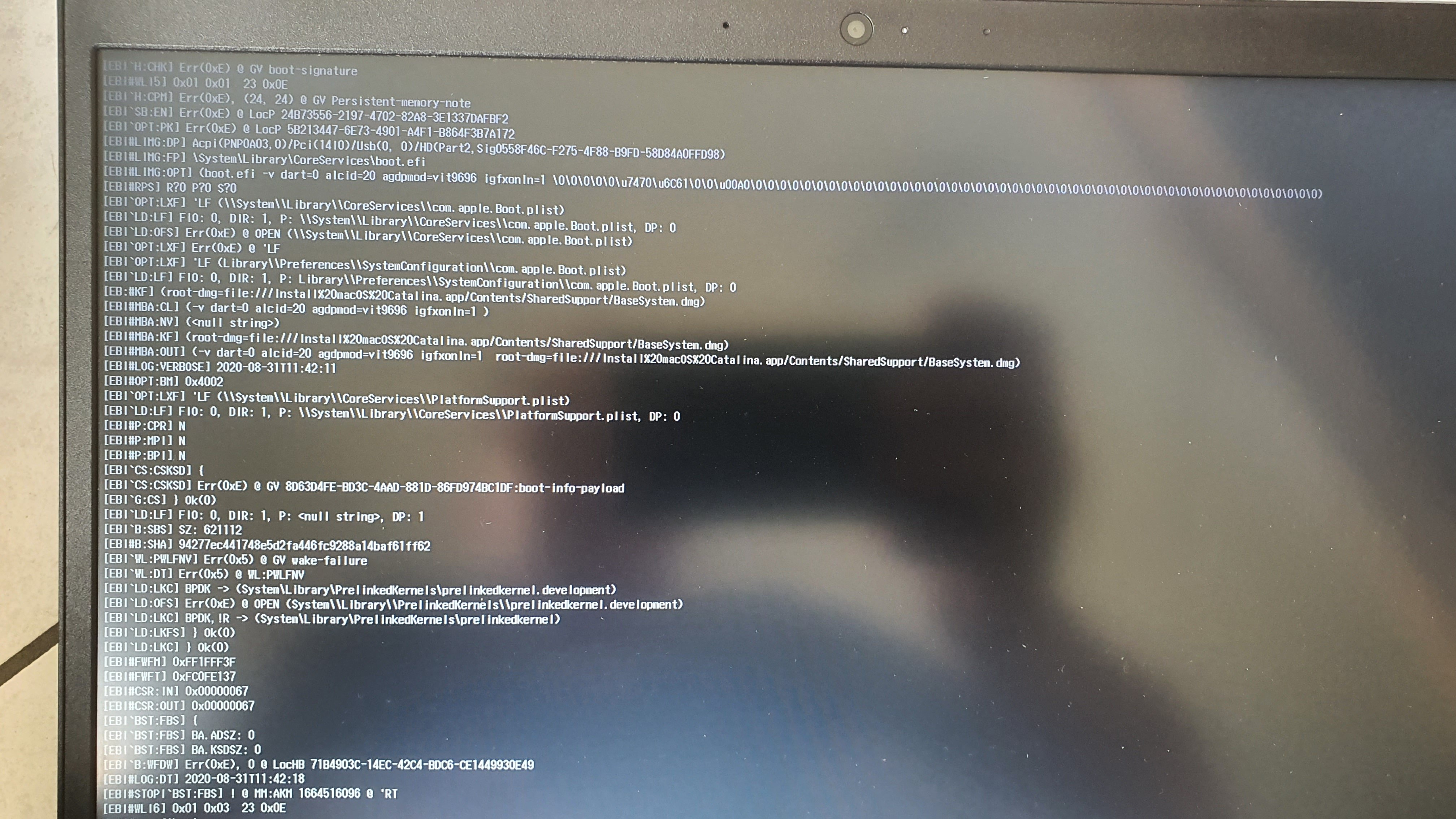

Roelander Posted August 31, 2020 Share Posted August 31, 2020 Hi everyone. @MaLdOn. Thanks for this guide. System: Lenovo S145-14IIL- Lastest Bios. I5 8GB memory. I have a problem using the clover boot installer on usb. I stops every time on start of the boot with errors on GV. First GV boot signature error. After that an error on GV persistent-memory-note. It happens with the USB files from the installation guide linked here and with the EFI files in this guide when I copy them to the EFI folder. Any idea ? Thanks. Link to comment Share on other sites More sharing options...

Roelander Posted September 2, 2020 Share Posted September 2, 2020 4 hours ago, MaLd0n said: what processor this notebook have? Hi. I5 - 1035G1 Gr Link to comment Share on other sites More sharing options...
MaLd0n Posted September 2, 2020 Author Share Posted September 2, 2020 4 hours ago, Roelander said: I5 - 1035G1 https://www.insanelymac.com/forum/topic/345041-hackbook-lenovo-ideapad-s145-10th-gen-icelake-catalina-big-sur-full-dsdt-patches-clover-and-opencore/ Link to comment Share on other sites More sharing options...
Roelander Posted September 2, 2020 Share Posted September 2, 2020 4 hours ago, MaLd0n said: https://www.insanelymac.com/forum/topic/345041-hackbook-lenovo-ideapad-s145-10th-gen-icelake-catalina-big-sur-full-dsdt-patches-clover-and-opencore/ Hi. Thank You very much. I can boot the installer with the files over there. THX Sincerly. Link to comment Share on other sites More sharing options...
