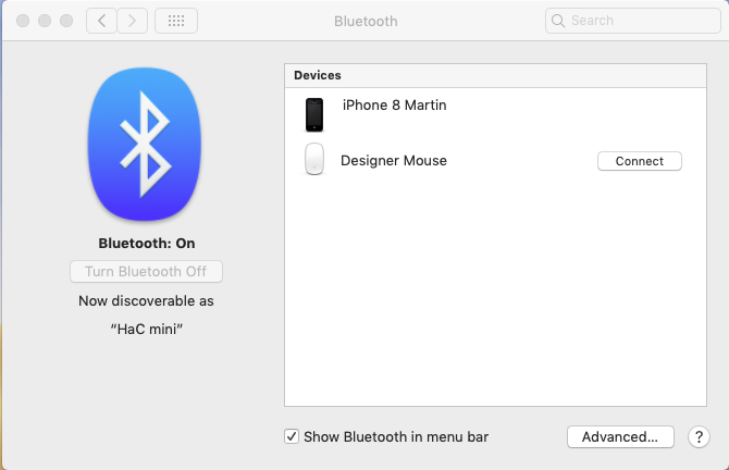

I am getting somewhere, but bluetooth still only somehow works.......

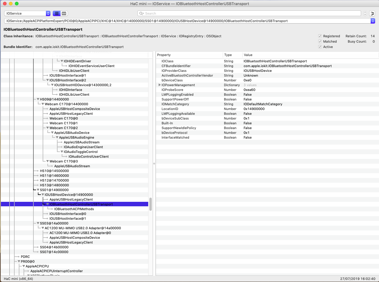

Bluetooth on SS01? Shouldn´t this be HS09? Webcam showing on HS09 is back bottom right.

Your ssdt is wrong. You basically put the wrong ports in and gave them the “right” names. Like your SS01 is actually HS09.
I would advise you to follow the usbinjectall guide again but actually as we’ve established, usbinjectall does nothing and has nothing to do with your Bluetooth issues. It’s a hardware/kext issue with that model.

Wait what’s going on there. When you posted your ioreg, the Bluetooth was on HS09. Hardware doesn’t magically move around.
I think USBInjectAll and the SSDT i made are somehow interfering with HacMini1,3
Front USB C and USB3.1 are now on PEGP0
HS01 is front USB (yellow port)
HS04 is back top right
HS09 is now back bottom right
HS10, 11, 12, 13 are empty
SS01 is now bluetooth
SS03 is now back top left
SS04 is now back bottom left
How can I correctly merge this into HacMini1,3?
Aside from this NUC, is there any evidence that this Bluetooth card is even supported by OS X? Any other builds use this card? Because you can spend all your time trying to get it to work or just buy a new card for $20.
You are right. When I remove the SSDT / USBINJECTALL it is back on HS09.
And interestingly when I insert a bluetooth USB dongle that works fine on Sierra, i get the same bluetooth issues........
