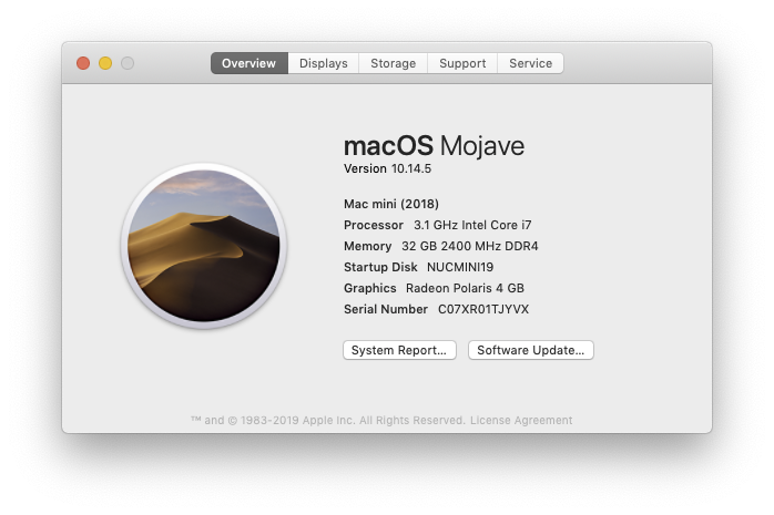

Thanks! It is working! NUC8I7HVK, 32GB RAM, EVO 970, 10.14.5 up and running like a charm!
thx. finally i got run 10.14.5!!

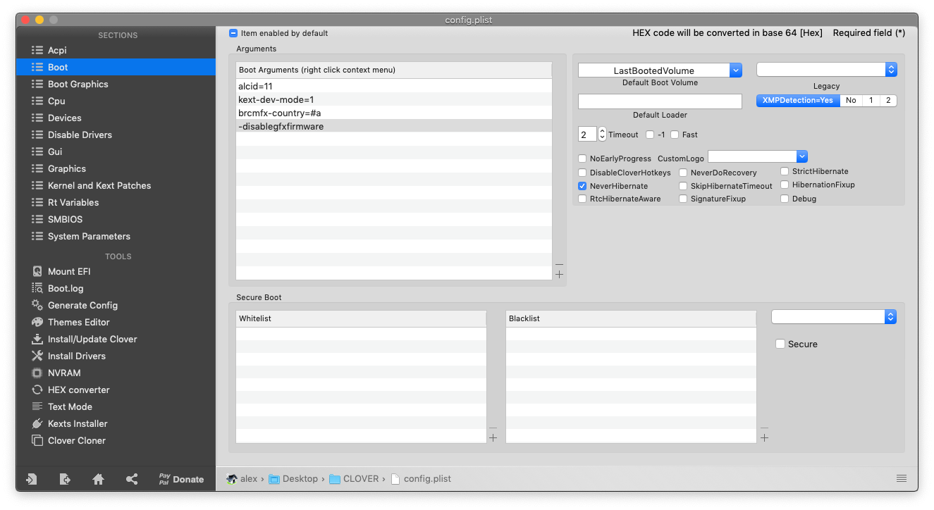

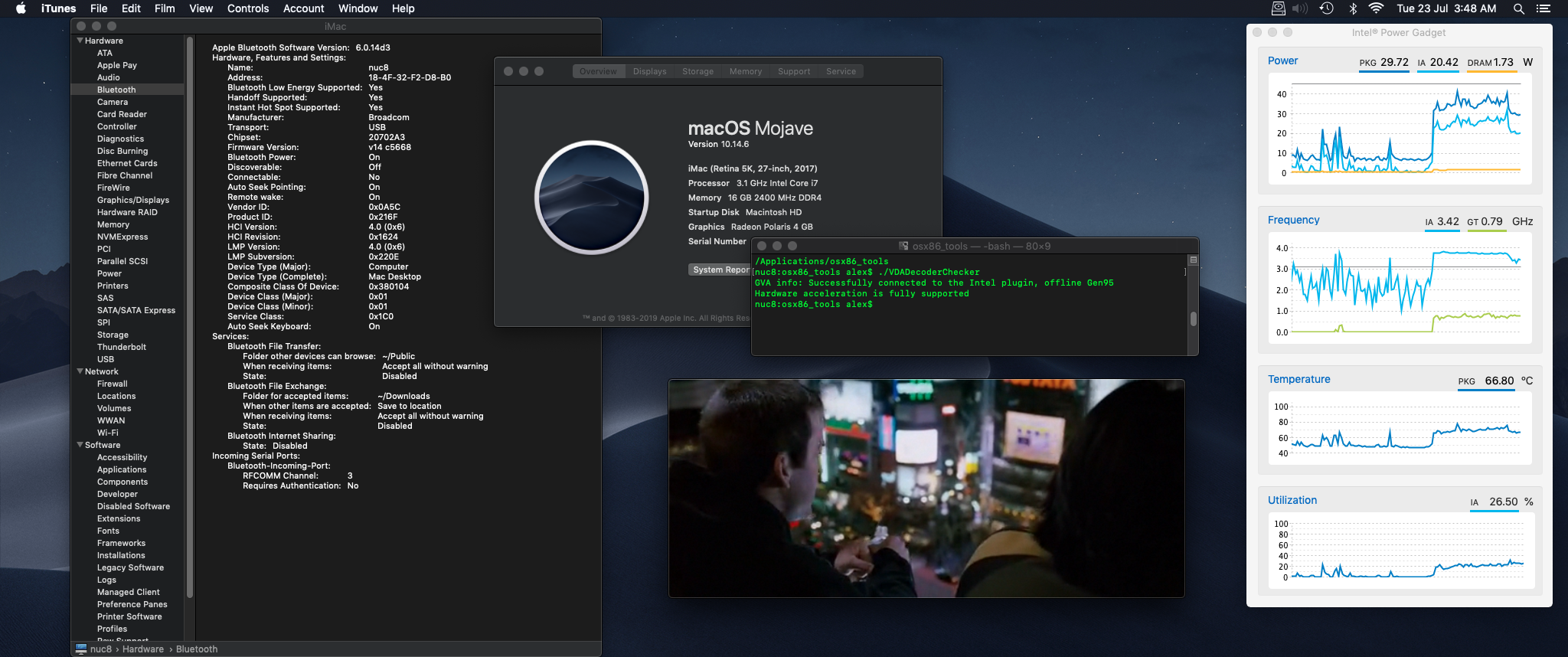

For those interested in enabling Intel Quicksync (IGPU) of NUC8i7HNK/HVK.
Changelog
   2019-0725-00
      - Add iMac18,2 as an option
      - Add iMac18,2 GPUs profile in dAGPM.kext
      - Tested on NUC8i7HVK
Requirements:
- HaC_mini 1.2 (osy, NUC8 Hero !)
- Add "-disablegfxfirmware" into Clover->boot arguments
- Add a patch "change GFX0 to IGPU" in Clover->DSDT->Patches, find hex "47465830", replace hex "49475055"
- Add a patch "change PEGP to GFX0" in Clover->DSDT->Patches, find hex "50454750", replace hex "47465830"

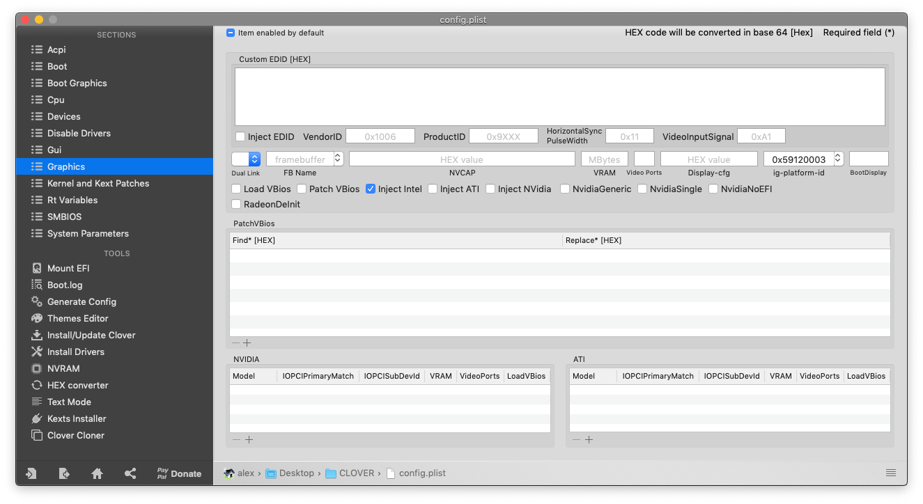

- Check Intel Inject box [/] and set 0x59120003 for ig-platform-id under Clover->Graphics

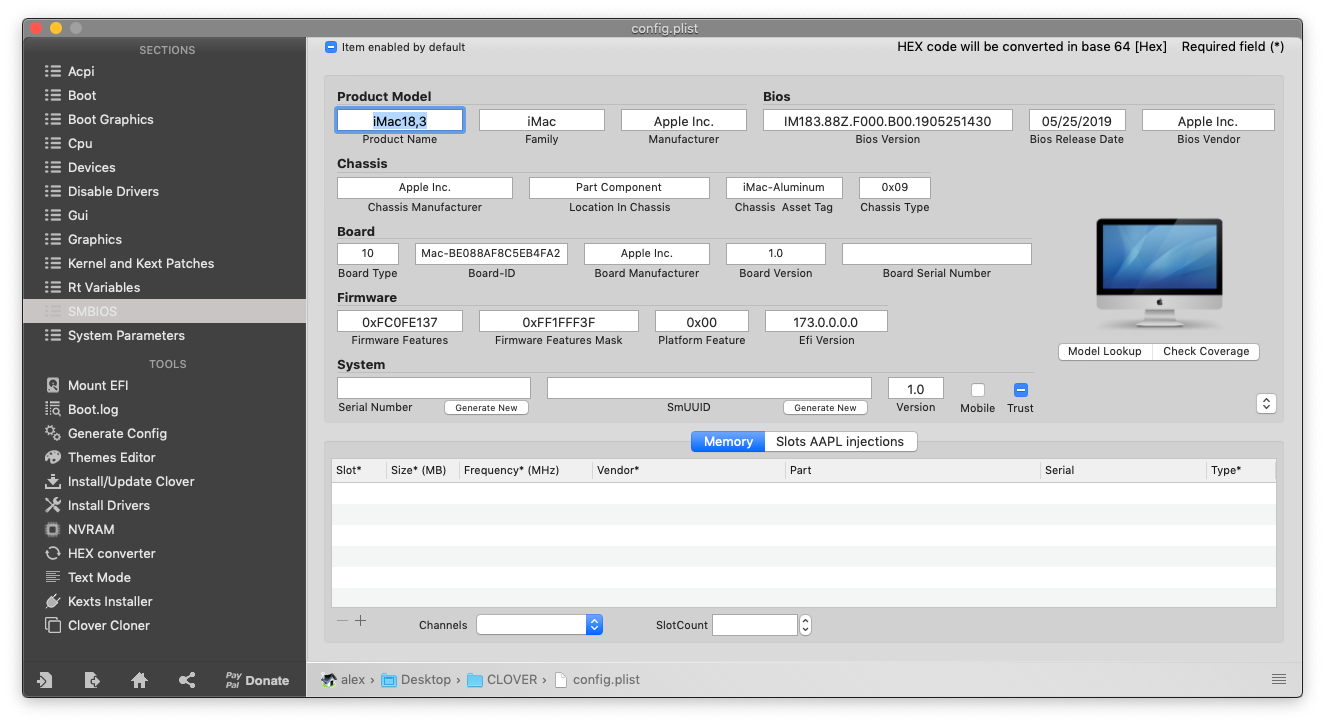

- Select iMac18,2 or iMac18,3 under Clover->SMBIOS, save and reboot to BIOS menu ( I prefer iMac18,2)
- Enable IGPU under Graphics, save and exit, boot to Desktop
- Optional, copy dAGPM.kext into Clover/kexts/others (GFX0 & IGPU AGPM profile are from iMac18,2 & iMac18,3 respectively)

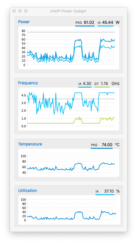

To verify Quicksync feature, download and run Intel® Power Gadget. Other than normal CPU (blue bar), you should also see additional green bar (Intel iGPU status) on the right.
Go to Gigabyte website and do some browsing or play iTune trailer movies, you should see the green frequency varies according to different load. CPU frequency will plunge as iGPU load increase in some case.

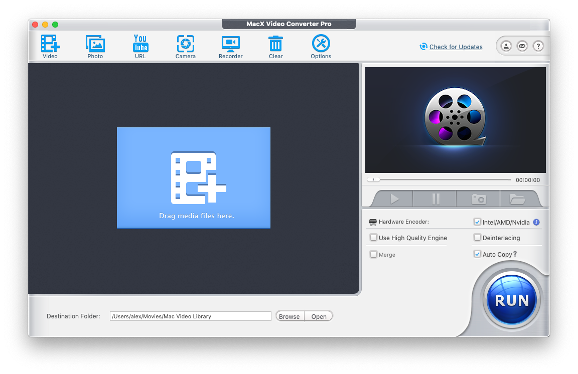

Another test is to download Trial version of MacX Video Converter Pro, make sure INTEL/AMD/NVIDIA box [l] is checked when launch and click the blue info thing, you should see "Hardware Encoding Supported YES" message.
For those using Final Cut will benefit for sure.
Have fun :)

1 hour ago, rongu said:
@osy Do you think any chance by enabling IGPU quicksync resolve Preview.app crash? My Preview.app no longer crash (or funny image) after that. X finger !
You could be right. Can you post your config.plist changes?

9 hours ago, osy said:
Any reason why you changed the model to iMac? The thermal profiles are different and I think the Mac mini profile is closer to the NUC.
I am not sure about the thermal profiles but I think is also important to match the hardware profile.
If you choose a macmini81 the system expect IGPU to be around and always on, I checked dsdt & etc and wonder what happen if call were being made in routine related IGPU which in this case is always off (disable).
In term of hardware profile, I think iMac18,3 is closer as it has a GFX0, and a IGPU connected to nothing, like our NUC (from some Intel NUC spec). That why I guess my preview.app's problem goes away as the log tells me the problem is due to some HW Jpeg decoding. With iMac18,3 we have IGPU doing the decoding. Also by selecting iMac18,3 we enable quicksync, this one I had check.
I think it is easier to deal with thermal profiles of the CPU by tweaking (ssdtgen, HWPValue or whatever), please correct me if I  am wrong.
At the end of the day, we will probably find out what best as we go along.
PS, I missed one very important step regarding enabling IGPU, we need a patch "change GFX0 to IGPU" for everything else to work properly especially the AGPM.
Edited by rongu
@kowbot Thanks for pointing out the error, btw you also need additional patch below & updated dAGPM.kext
dAGPM.zip
Edited by rongu
