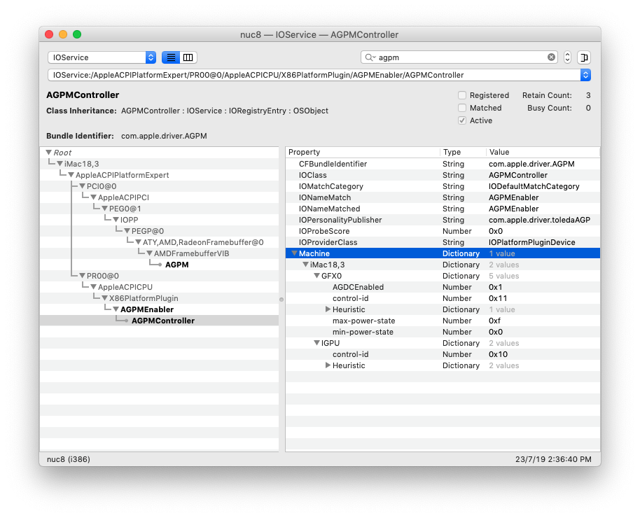

rongu Posted July 23, 2019 Share Posted July 23, 2019 (edited) For those who are interested to verify if a successful AGPM profile is being injected, you should have 2 GPUs (GFX0 & IGPU) under iMac18,3/Machine at AGPMController. See enabling Intel QuickSync for reference in previous post. Edited July 23, 2019 by rongu Link to comment https://www.insanelymac.com/forum/topic/339291-guide-hac-mini-osx-mojave-on-intel-hades-canyon-nuc8i7hvknuc8i7hnk/page/4/#findComment-2682571 Share on other sites More sharing options...
kowbot Posted July 23, 2019 Share Posted July 23, 2019 4 hours ago, rongu said: For those who are interested to verify if a successful AGPM profile is being injected, you should have 2 GPUs (GFX0 & IGPU) under iMac18,3/Machine at AGPMController. See enabling Intel QuickSync for reference in previous post. thx for sharing. u find enable VT-d and brcmpatch both work? Link to comment https://www.insanelymac.com/forum/topic/339291-guide-hac-mini-osx-mojave-on-intel-hades-canyon-nuc8i7hvknuc8i7hnk/page/4/#findComment-2682583 Share on other sites More sharing options...

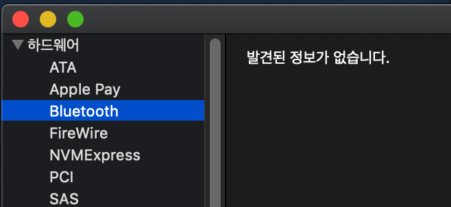

kowbot Posted July 23, 2019 Share Posted July 23, 2019 thx. i use brcmFirmwareRepo.kext and brcmPatchRam2.kext and u posted config.plist bluetooth not detected anymore. but with HaC mini config.plist work bluetooth whats difference between? Link to comment https://www.insanelymac.com/forum/topic/339291-guide-hac-mini-osx-mojave-on-intel-hades-canyon-nuc8i7hvknuc8i7hnk/page/4/#findComment-2682601 Share on other sites More sharing options...
rongu Posted July 23, 2019 Share Posted July 23, 2019 (edited) 5 minutes ago, kowbot said: thx. i use brcmFirmwareRepo.kext and brcmPatchRam2.kext and u posted config.plist bluetooth not detected anymore. but with HaC mini config.plist work bluetooth whats difference between? You should only used BrcmFirmwareRepo.kext & BrcmPatchRAM2 in /Library/Extensions OR BrcmFirmwareData.kext & BrcmPatchRAM2 in clover/kexts/others. HaC mini config.plist work bluetooth ??? Edited July 23, 2019 by rongu Link to comment https://www.insanelymac.com/forum/topic/339291-guide-hac-mini-osx-mojave-on-intel-hades-canyon-nuc8i7hvknuc8i7hnk/page/4/#findComment-2682602 Share on other sites More sharing options...
kowbot Posted July 23, 2019 Share Posted July 23, 2019 13 minutes ago, rongu said: You should only used BrcmFirmwareRepo.kext & BrcmPatchRAM2 in /Library/Extensions OR BrcmFirmwareData.kext & BrcmPatchRAM2 in clover/kexts/others. HaC mini config.plist work bluetooth ??? yes. your config is not detected bluetooth chipset. Link to comment https://www.insanelymac.com/forum/topic/339291-guide-hac-mini-osx-mojave-on-intel-hades-canyon-nuc8i7hvknuc8i7hnk/page/4/#findComment-2682606 Share on other sites More sharing options...
kowbot Posted July 23, 2019 Share Posted July 23, 2019 2 minutes ago, rongu said: What wifi/bt card are you using ? Tell me more about your setup. dw1830 but 0a5c:21ff i make custom patch. i think igpu patch is problem Link to comment https://www.insanelymac.com/forum/topic/339291-guide-hac-mini-osx-mojave-on-intel-hades-canyon-nuc8i7hvknuc8i7hnk/page/4/#findComment-2682608 Share on other sites More sharing options...

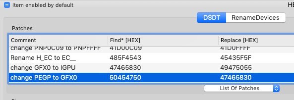

kowbot Posted July 23, 2019 Share Posted July 23, 2019 1 minute ago, rongu said: I am sorry I don't know about dw1830. What igpu patch you think is the problem ? hacmini config add igpu patched bluetooth is gone. Link to comment https://www.insanelymac.com/forum/topic/339291-guide-hac-mini-osx-mojave-on-intel-hades-canyon-nuc8i7hvknuc8i7hnk/page/4/#findComment-2682612 Share on other sites More sharing options...
kowbot Posted July 23, 2019 Share Posted July 23, 2019 1 minute ago, rongu said: Are you are referring to patch "change GFX0 to IGPU" ? yes. enable disable both not working. ok. i restart to original config and step by step add patch Link to comment https://www.insanelymac.com/forum/topic/339291-guide-hac-mini-osx-mojave-on-intel-hades-canyon-nuc8i7hvknuc8i7hnk/page/4/#findComment-2682615 Share on other sites More sharing options...
kowbot Posted July 23, 2019 Share Posted July 23, 2019 18 minutes ago, rongu said: Just take mine, latest working version config.plist to prevent typo error. config.zip same result. bluetooth chipset not detected Link to comment https://www.insanelymac.com/forum/topic/339291-guide-hac-mini-osx-mojave-on-intel-hades-canyon-nuc8i7hvknuc8i7hnk/page/4/#findComment-2682620 Share on other sites More sharing options...
rongu Posted July 23, 2019 Share Posted July 23, 2019 여보세요 I don't have BCM943602BAED DW1830 so I can't really tell you much. lt very unlikely the IGPU patch cause your Bluetooth not to work but I won't rule that out. If you really think is the patch then disable it or revert back to original HaC_mini. You should know by then. Link to comment https://www.insanelymac.com/forum/topic/339291-guide-hac-mini-osx-mojave-on-intel-hades-canyon-nuc8i7hvknuc8i7hnk/page/4/#findComment-2682623 Share on other sites More sharing options...

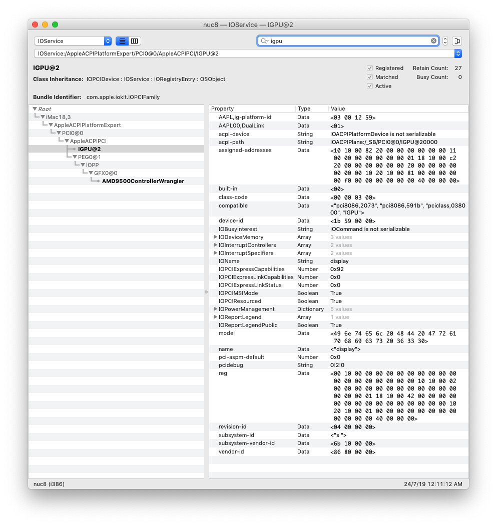

rongu Posted July 24, 2019 Share Posted July 24, 2019 (edited) 4 hours ago, kowbot said: hmm... i give up my nuc is still hard freeze randomly when < 10mins... @kowbotHey, have you tried resetting your BIOS and select Low Power Enable or Balance Enable under PrimaryPower Settings and see how it goes.... Other things your can try to isolate your issues by -Removing your windows' m.2 storage -Running your system with single stick of ram -Disable wifi/bt in BIOS Edited July 24, 2019 by rongu Link to comment https://www.insanelymac.com/forum/topic/339291-guide-hac-mini-osx-mojave-on-intel-hades-canyon-nuc8i7hvknuc8i7hnk/page/4/#findComment-2682692 Share on other sites More sharing options...
kowbot Posted July 24, 2019 Share Posted July 24, 2019 (edited) 57 minutes ago, rongu said: @kowbotHey, have you tried resetting your BIOS and select Low Power Enable or Balance Enable under PrimaryPower Settings and see how it goes.... Other things your can try to isolate your issues by -Removing your windows' m.2 storage -Running your system with single stick of ram -Disable wifi/bt in BIOS tried Remove m.2 storage => fail. tried Low Power => fail. tried Disable BT/WIFI => fail. ok. i have two more solution. 1. Running single ram. 2. Disable Speed Step or Other Power Setting Change. Edited July 24, 2019 by kowbot Link to comment https://www.insanelymac.com/forum/topic/339291-guide-hac-mini-osx-mojave-on-intel-hades-canyon-nuc8i7hvknuc8i7hnk/page/4/#findComment-2682700 Share on other sites More sharing options...
