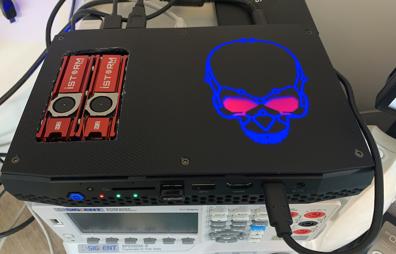

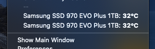

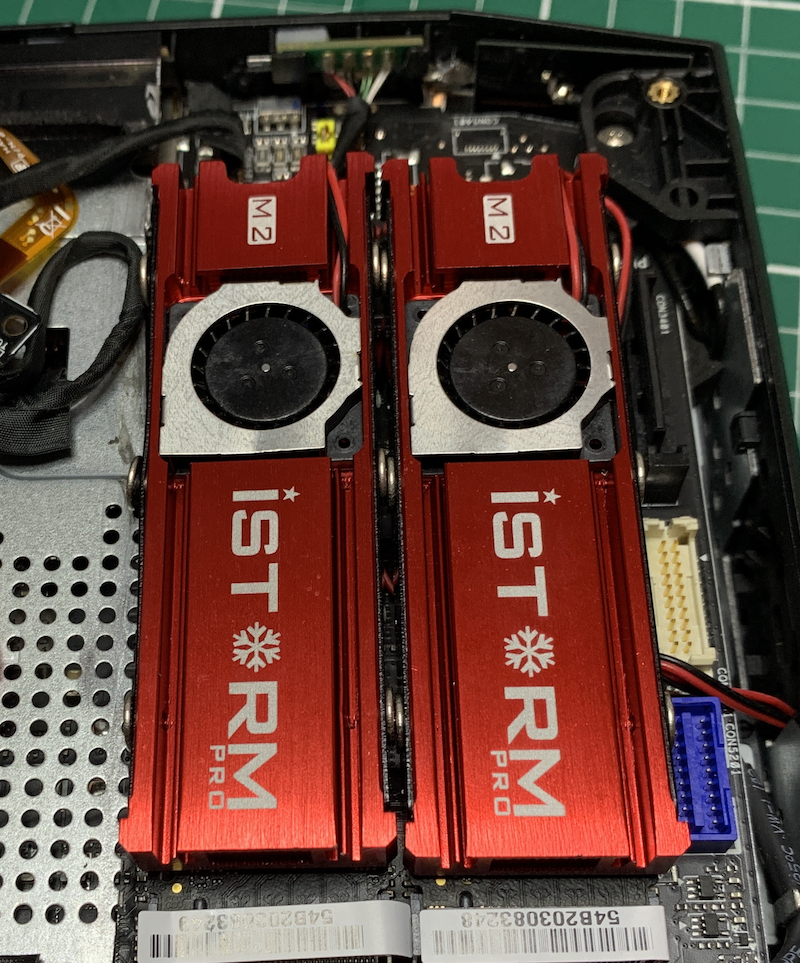

On 10/11/2019 at 8:15 AM, JaseNZ said:
I did a mod where I added some decent heat sinks to the Samsung drives I had in mine, Made the world of difference.

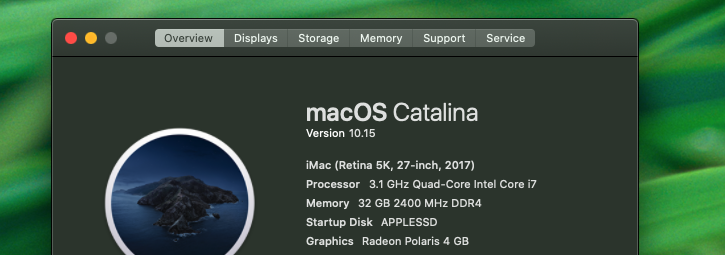

Works fine with Catalina latest version 10.15.1 , I don't use FCPX but I am sure it would work just fine.
I just use mine for mucking around on so I don't use it for something specific so cannot answer any of your other questions sorry.

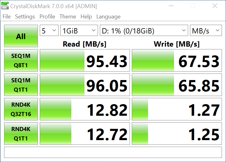

Hi All,
I'm running on 2.4 + 10.15.2. Just wanna know if any setting is needed to be apply on SD Card slot, as its speed with only <20 MB/s.
I'm using Lexar microSD with org converter (https://www.lexar.com/portfolio_page/high-performance-633x-microsdhcmicrosdxc-uhs-i-cards/).
BTW, will try another converter to check if the org one only support slow speed... And, any suggestion for the converter?
Thanks & regards,

Does it work on Windows? If so file a bug on github.
