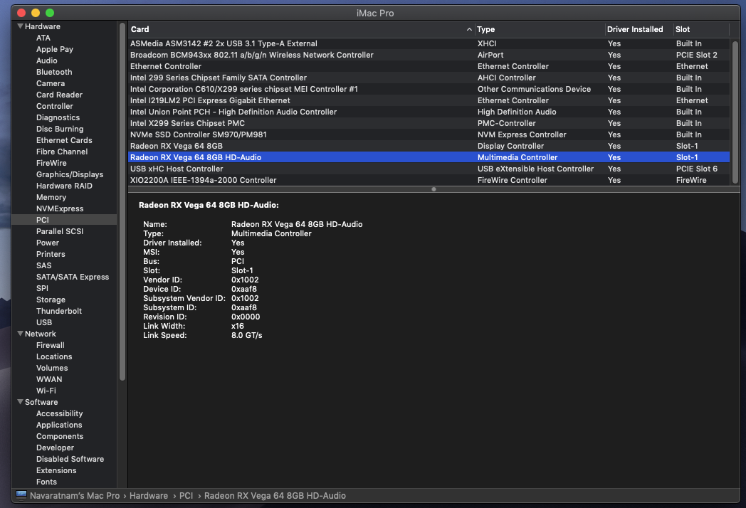

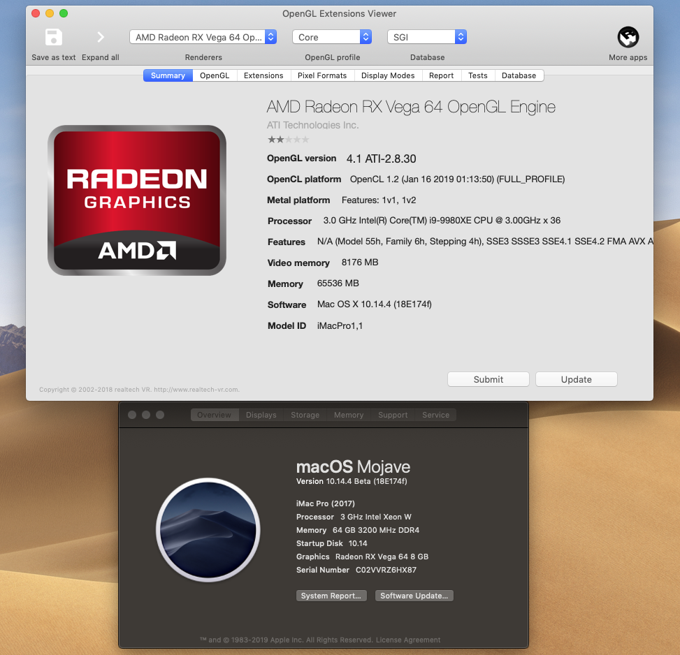

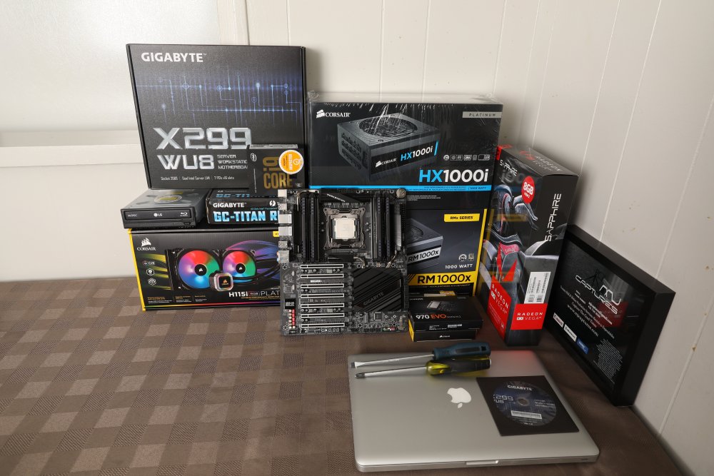

Luminadevapps Posted February 4, 2019 Share Posted February 4, 2019 (edited) X299 WU8 with Intel Core i9-9980XE Gigabyte X299 WU8 Intel Core i9-9980XE Extreme Edition Processor CORSAIR Vengeance RGB 64GB (4x16GB) DDR4 3200MHz C16 Desktop Memory Corsair H115i RGB Samsung SM 970 500GB Sapphire Radeon RX Vega 64 I already own Cooler Master COSMOS WIFI card Broadcom BCM943x FireWire IEEE-1394a OHCI Controller X299-WU8 I like this X299 server board some reason. Because this motherboard has 7 PCIex16 Slots design. Support Thunderbolt 3,PCIex4 M.2,USB 3.1,ALC 1220, Two RGBW Pin Headers. This board has 2 x USB 3.1 Gen 1 headers but not 2.0 headers. Bios Settings DSM-Disabled Extreme Memory Profile (X.M.P.) set to Profile 1 Change your CPU Clock Ratio 30 to 42 In Advanced CPU Core Settings Set Enhanced Multi-Core Performance to Enabled Set Energy Efficient Turbo to Disabled Eist Enabled C6/C7 Enabled XCPM machdep.cpu.brand_string: Intel(R) Core(TM) i9-9980XE CPU @ 3.00GHz This CPU support natively XCPM Because I don’t use any kernel patches or FakeCPUID Graphics Sapphire Radeon RX Vega 64 Open Clover Configurator thick RadeonDelnit Support kexts WhateverGreen.kext Lilu.kext VegaTab_64.kext I don’t rename some devices names via ACPI But Clover loader renames Automatically this devices GFX0,HDAU,HDEF I am very excited. XHCI This motherboard USB ports support natively. Because I don’t use any USB Injector.But I use port limit patched. Sleep work Now X299 KernelToPatch Comment xcpm_core_scope_msrs © Pike R. Alpha Find 31D2E891 FCFFFF MatchOS 10.14.x Replace 31D29090 909090 Comment xcpm_core_scope_msrs © Pike R. Alpha Find 31D2E851 FDFFFF MatchOS 10.15.x Replace 31D29090 909090 X299 KextsToPatch 10.14.x,10.15.x Comment SSD Trim Enabler Find 4150504C 45205353 4400 Name IOAHCIBlockStorage Replace 00000000 00000000 0000 Comment Disable board-id check to prevent no signal © lvs1974, Pike R. Alpha, vit9696 Find BA050000 00 MatchOS 10.14.x,10.15.x Name com.apple.driver.AppleGraphicsDevicePolicy Replace BA000000 00 Comment USB Port Limit Patch 1 - PMheart and daliansky Find 83FB0F0F Name com.apple.iokit.IOUSBHostFamily Replace 83FB3F0F Comment USB Port Limit Patch 2 - PMheart and daliansky Find 83F90F0F Name com.apple.driver.usb.AppleUSBXHCI Replace 83F93F0F Comment F1/F2 Key Patch 1 ©Wern Find 30783030 30373030 33612C30 78666630 31303032 31 Name com.apple.driver.AppleHIDKeyboard Replace 30783030 30373030 33612C30 78303030 37303033 61 Comment F1/F2 Key Patch 2 ©Wern Find 30783030 30373030 33622C30 78666630 31303032 30 Name com.apple.driver.AppleHIDKeyboard Replace 30783030 30373030 33622C30 78303030 37303033 62 Comment X299patch-1 Find 70A10000 MatchOS 10.14.x,10.15.x Name AppleHDAController Replace F0A20000 Comment X299patch-2 Find 868070A1 MatchOS 10.14.x,10.15.x Name AppleHDAController Replace 8680F0A2 Comment Rename Codec 1 Find 8B19D411 MatchOS 10.14.x,10.15.x Name AppleHDA Replace 2012EC10 Comment Rename Codec 2 Find 8D3DD411 MatchOS 10.14.x,10.15.x Name AppleHDA Replace 00000000 Comment Rename Codec 3 Find 8A19D411 MatchOS 10.14.x,10.15.x Name AppleHDA Replace 00000000 Comment ASUS 10- Gigabit XG-C100C Find 6275696C 742D696E MatchOS 10.14.x,10.15.x Name com.apple.driver.AppleEthernetAquantiaAqtion Replace 6275696C 742D696E Bluetooth Bluetooth has USB 2.0 header My Motherboard has 3.1 header I thing I need USB 3.1 to 2.0 Adapter. PCI Slot Information I update some SSDT for X299 All in one X299 All in one.zip X299 Each Devices 17 SSDT.zip I update EFI.zip If you like DSDT patches #Remove all SSDT in your EFI Before patch you have to Add ACPI patch in Clover Config Comment PC00 -> PCI0 Find 50433030 Replace 50434930 XHCI for USB 3 DTGP HDEF GFX0(VEGA64) HDAU HPET ARPT RTC IRQs RENAMED DEVICES SMBUS SHUTDOWN REMOVED DEVICES LPC0 GLAN IMEI SSD0(SM970) SAT1 PMC1 FIX WARNINGS And more enjoy. X299-Compile.rtf X299-DSDT-Device-Patch.rtf If you like Go to Gigabyte web site->Products->Server Motherboard->Professional Motherboard->X299-WU8 https://www.gigabyte.com/ca/Server-Professional-Products I really thank for everyone who support and help to this success. I update kexts. X299_Injector USB 3.kext.zip Edited October 27, 2019 by nmano 4 1 1 Link to comment https://www.insanelymac.com/forum/topic/337497-x299-wu8-with-intel-core-i9-9980xe/ Share on other sites More sharing options...

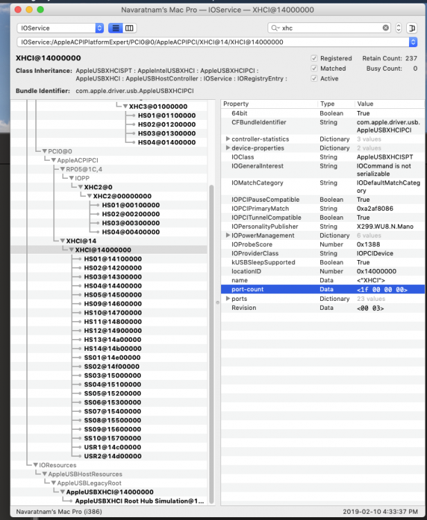

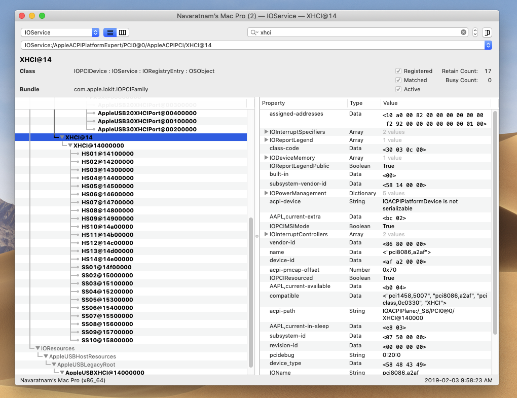

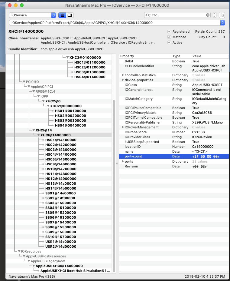

Luminadevapps Posted February 10, 2019 Author Share Posted February 10, 2019 (edited) Hi guys #Remove XHCI SSDT.aml #Remove _DSM to XDSM # set port count in your X299_Injector USB 3.kext (I have 31 ports I set 1F) #Now Create automatically All device ports. X299_Injector USB 3.kext.zip Edited February 10, 2019 by nmano Link to comment https://www.insanelymac.com/forum/topic/337497-x299-wu8-with-intel-core-i9-9980xe/#findComment-2663534 Share on other sites More sharing options...

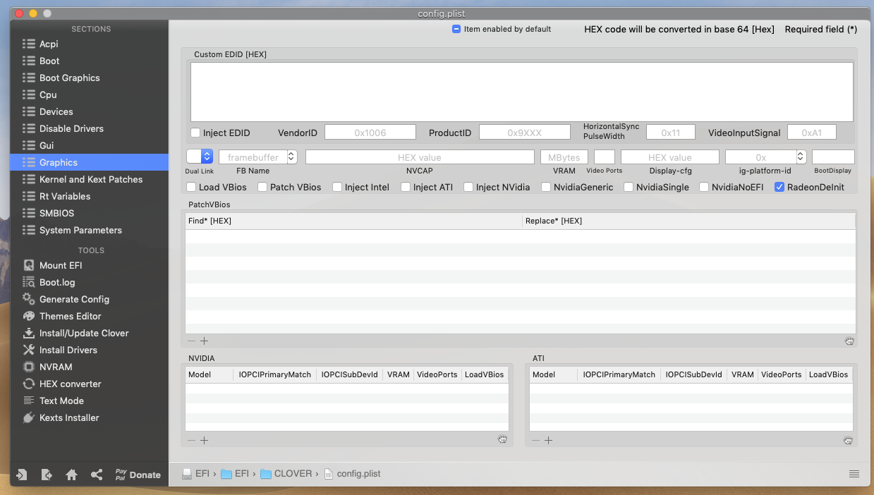

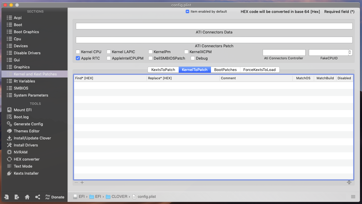

Luminadevapps Posted March 4, 2019 Author Share Posted March 4, 2019 (edited) X299 DSDT patches #Remove all SSDT in your EFI Before patch you have to Add ACPI patch in Clover Config Comment PC00 -> PCI0 Find 50433030 Replace 50434930 XHCI for USB 3 DTGP HDEF GFX0(VEGA64) HDAU HPET ARPT RTC IRQs RENAMED DEVICES SMBUS SHUTDOWN REMOVED DEVICES LPC0 GLAN IMEI SSD0(SM970) SAT1 PMC1 FIX WARNINGS And more enjoy. X299-Compile.rtf X299-DSDT-Device-Patch.rtf Edited March 4, 2019 by nmano 1 Link to comment https://www.insanelymac.com/forum/topic/337497-x299-wu8-with-intel-core-i9-9980xe/#findComment-2665953 Share on other sites More sharing options...
