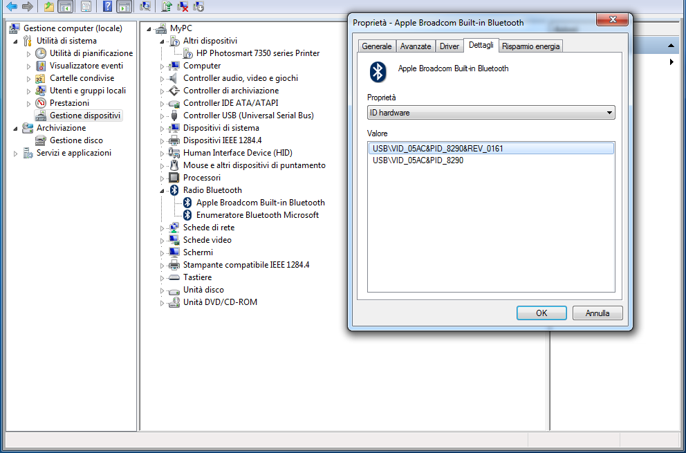

gengik84 Posted January 16, 2019 Share Posted January 16, 2019 Quali id ha il bt? Link to comment https://www.insanelymac.com/forum/topic/337193-wifi-disconnesso-anche-se-sullhackintosh-sembra-connesso-dopo-grosso-upload/page/3/#findComment-2659394 Share on other sites More sharing options...
boesbo Posted January 16, 2019 Author Share Posted January 16, 2019 (edited) 7 minutes ago, gengik84 said: Quali id ha il bt? Da dove lo evinco? Edited January 16, 2019 by boesbo Link to comment https://www.insanelymac.com/forum/topic/337193-wifi-disconnesso-anche-se-sullhackintosh-sembra-connesso-dopo-grosso-upload/page/3/#findComment-2659395 Share on other sites More sharing options...

boesbo Posted January 17, 2019 Author Share Posted January 17, 2019 9 hours ago, gengik84 said: Quali id ha il bt? ! Bo, pare allora che il pezzo arrivato a me non sia compatibile allora Link to comment https://www.insanelymac.com/forum/topic/337193-wifi-disconnesso-anche-se-sullhackintosh-sembra-connesso-dopo-grosso-upload/page/3/#findComment-2659427 Share on other sites More sharing options...

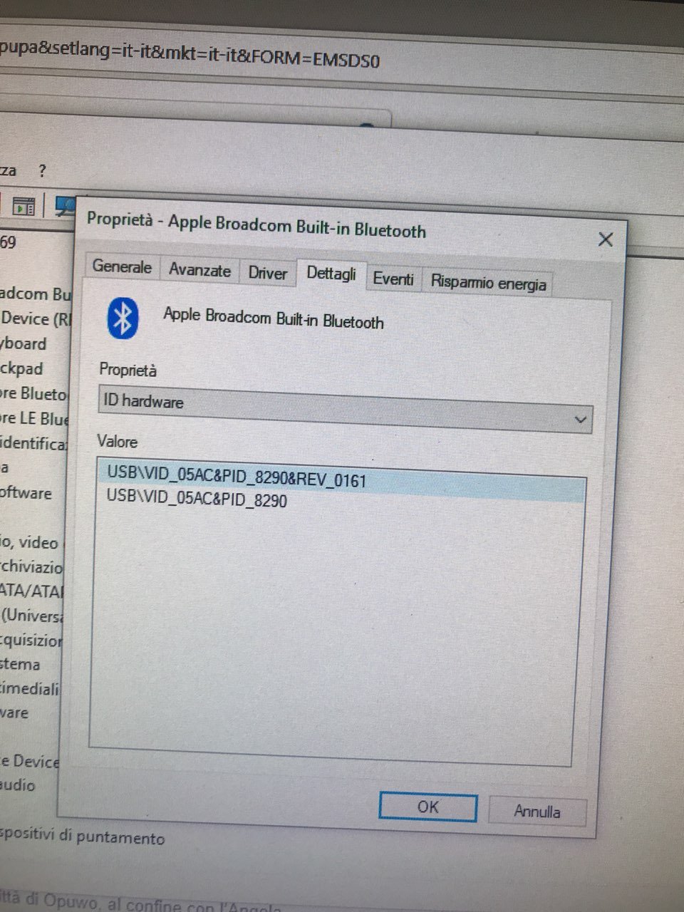

gengik84 Posted January 17, 2019 Share Posted January 17, 2019 controlla gli ID da windows @iCanaro la porta è attiva e ioreg non mente. Link to comment https://www.insanelymac.com/forum/topic/337193-wifi-disconnesso-anche-se-sullhackintosh-sembra-connesso-dopo-grosso-upload/page/3/#findComment-2659428 Share on other sites More sharing options...
iCanaro Posted January 17, 2019 Share Posted January 17, 2019 boh magari questi modelli più recenti necessitano di injector Link to comment https://www.insanelymac.com/forum/topic/337193-wifi-disconnesso-anche-se-sullhackintosh-sembra-connesso-dopo-grosso-upload/page/3/#findComment-2659430 Share on other sites More sharing options...
boesbo Posted January 17, 2019 Author Share Posted January 17, 2019 (edited) 10 hours ago, gengik84 said: per conferma da windows se vai su gestione periferiche, BT dal menù a tendina tra le varie voci una dovrebbe mostrarti il percorso acpi nel caso fai sapere..anche se continuo a pensare che il problema non sia nelle usb Dovrebbe essere dispositivi/ detagli/ proprietà/ percorsi @iCanaro Anchio lo vedo con ioreg. Ma non funziona 23 minutes ago, gengik84 said: controlla gli ID da windows @iCanaro la porta è attiva e ioreg non mente. Vado a recuperarli... Ecco: Edited January 17, 2019 by boesbo Link to comment https://www.insanelymac.com/forum/topic/337193-wifi-disconnesso-anche-se-sullhackintosh-sembra-connesso-dopo-grosso-upload/page/3/#findComment-2659432 Share on other sites More sharing options...
boesbo Posted January 17, 2019 Author Share Posted January 17, 2019 (edited) Leggento questa discussione il tizio ha risolto disattivando da UEFI il bluetooth della scheda madre (da me è già fisicamente tolta la scheda NGFF) ora sto cercando l'opzione corretta nel bios se c'è. Anche se mi pare strano visto che il modulo WIFI/BT da me è una scheda NGFF che era inserita.https://www.insanelymac.com/forum/topic/321779-bcm943602cs-combo-card-bluetooth-not-working/ Edited January 17, 2019 by boesbo Link to comment https://www.insanelymac.com/forum/topic/337193-wifi-disconnesso-anche-se-sullhackintosh-sembra-connesso-dopo-grosso-upload/page/3/#findComment-2659440 Share on other sites More sharing options...
