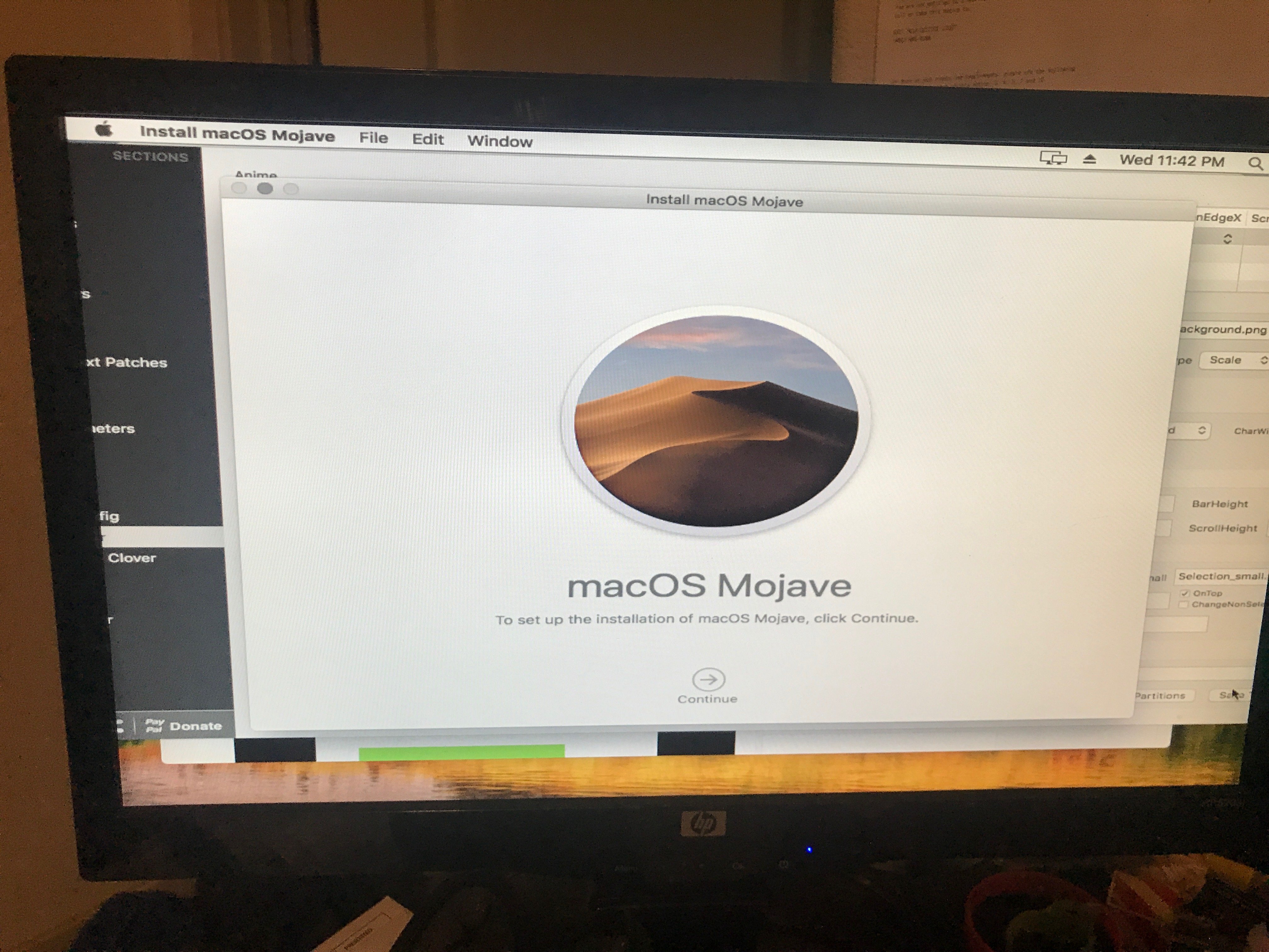

Mattbatt Posted November 25, 2018 Author Share Posted November 25, 2018 After a full day, here's where I am: 1. Created a Clover USB boot loader in windows, still nothing loading. I ask myself, "what has changed since when it was working?" Oh yes, I was running older versions of Clover from 2014 & 2015. So in Windows I created another bootloaded with Clover from 2017, boots perfect. 2. Now I created another Mojave installer loading various versions of Clover settling with 4522 to where the USB installer launches and works. Perfect. 3. Once in Mojave installer, I now select my SSD which has my broken Mojave loaded and run disk utilities to format it GUID. 4. Big trouble in little hackintosh world! Disk Utilities takes a good 15 min, I know something is wrong. At the end it fails and said something like "could not format, met end of block". I reboot into Mojave installer and there is a 2.1 GB partition (my SSD is 120 GB). I run Terminal diskutil eraseDisk "Sucks" disk1 It can't unmount. I see there are now 25 new disks all unnamed. I run diskutil force unmount for each disk successfully but it still won't unmount the main disk. Says PID 0 prohibited (that's the kernal). I take SSD out, try putting it in a USB hardrive tray reader, nothing. Now when I boot, that SSD freezes up my BIOS. I can't even get past the BIOS logo. So when I boot, I unplug it, then boot, start Clover, then plug it in, Clover freezes. Help? Link to comment Share on other sites More sharing options...

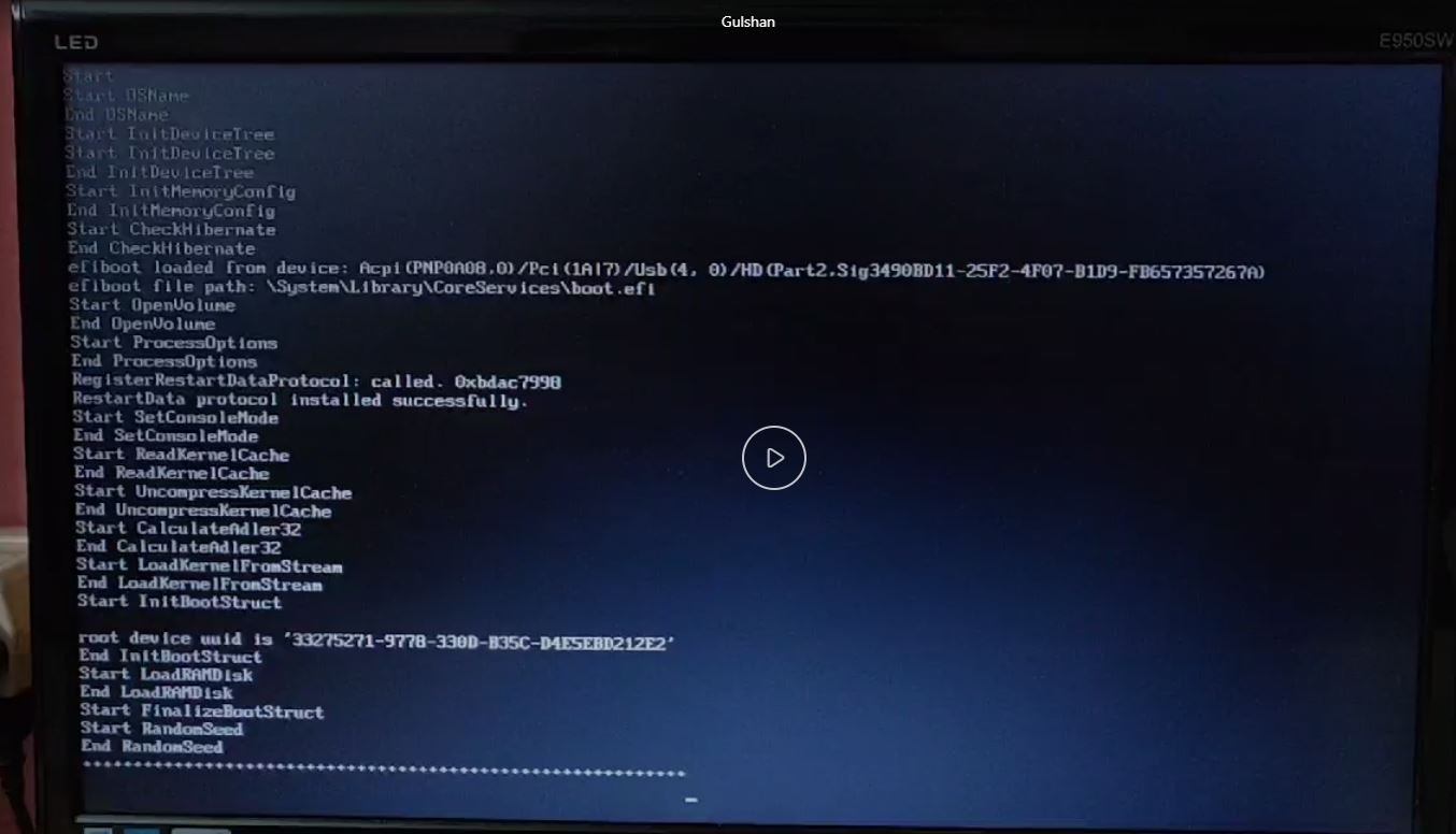

Razz Posted August 1, 2019 Share Posted August 1, 2019 On 2/10/2019 at 7:34 PM, Boreithen said: Thank you, your post helped me so much ! hello thanks for your post first of all, really appreciate it. Can you please share your pre and post clover fodlers? i'm presently using a MSI x58A-GD65 mobo and 6gb corsair kit (2gbx3) with a i7 920 processor. I have tried several thing but my clover doesn't seem to be boot and reboots the system after this error in the attachment. I ahve also tried different usb's disabled usb 3.0 but nothing goes past that screen. also nv_diable , -v, -debug0x100 have been tired for verbose loggin and gpu disable. plus i have tried inject nvidia drivers it doesn't work. Link to comment Share on other sites More sharing options...
