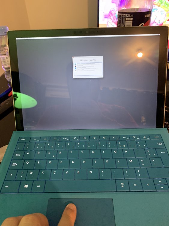

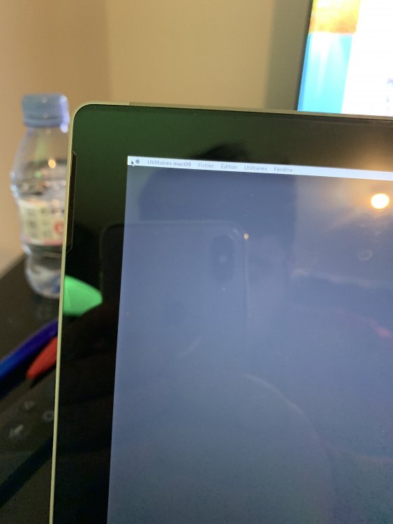

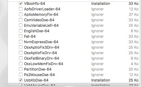

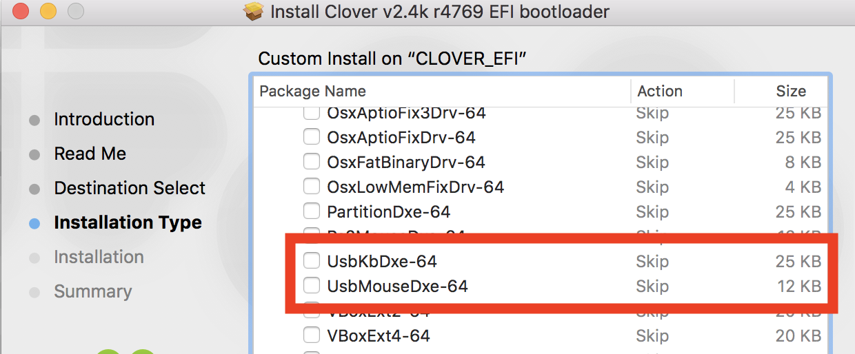

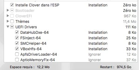

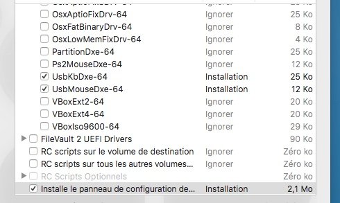

Currently trying this guide on my Surface but I can't seem to get past this error - hangs after End RandomSeed once I've selected to boot the macOS installer. I've reinstalled clover, reformatted the USB, tried adding more drivers, no luck. Any ideas? Also tried using the clover version from when this guide was created and still, nothing. Can't be the USB, as I've successfully installed Mojave onto my desktop with this same one. I'm lost.
  • 3 weeks later...
I am having the same exact issue.. Did you get it to work?
Format the u disk as :MyOsx,
10.14.x
Using:
sudo /Applications/Install\ macOS\ Mojave.app/Contents/Resources/createinstallmedia --volume /Volumes/MyOSX /Applications/Install\ macOS\ Mojave.app
to mark boot drive
Boot from USB and Before entering the system change ig-platform-id to 0x12345678 (in order to disable acceleration) and add -v argument
Edited by xuzhimin
