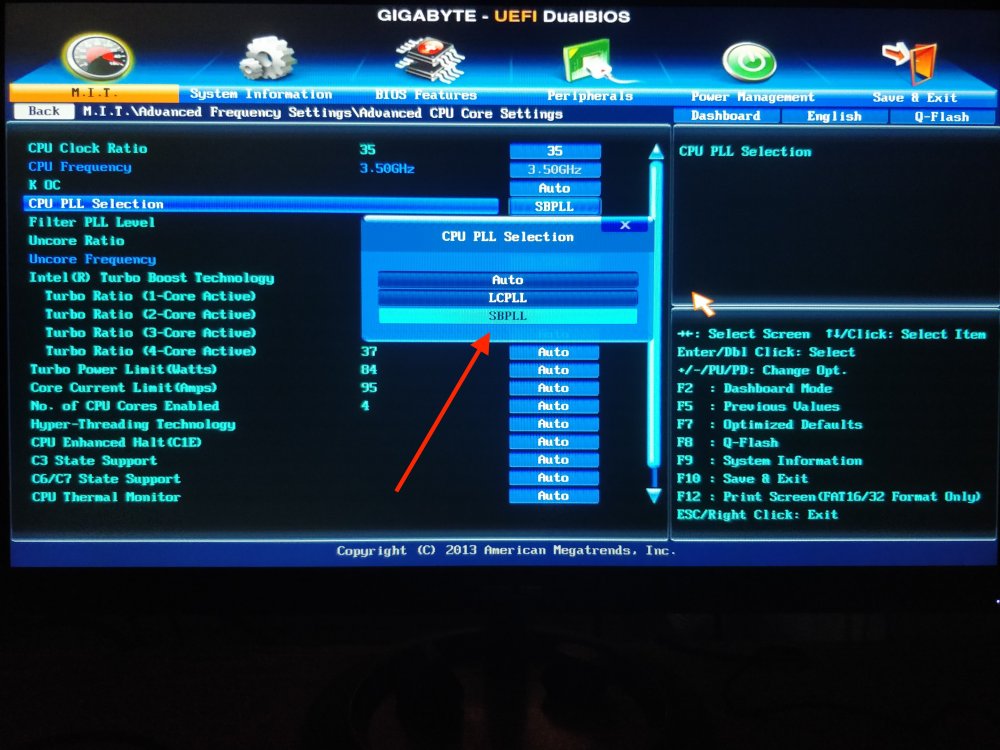

LeoVanex Posted September 2, 2018 Share Posted September 2, 2018 @Renegade I have found the issue! You have to disable or set to SBPLL an option in BIOS settings called "CPU PLL Selection" or "CPU PLL overvoltage". After that, save and reboot! Test if it works ;) Link to comment Share on other sites More sharing options...
Renegade Posted September 10, 2018 Author Share Posted September 10, 2018 (edited) @LeoVanex Thanks for helping. I'm glad you found a solution that works for you. Sadly for me, we have very different builds, I use a Coffee Lake cpu running with a Z370 chipset. To the best of my knowledge , the Z370 chipset doesn't allow tweating the PLL. Furthermore, I really don't understand why a CPU voltage tweak could affect the Roccat mouse state after wake. Are you sure you haven't modified another setting prior noticing your mouse was working normally after wake ? Edited September 10, 2018 by Renegade Link to comment Share on other sites More sharing options...
LeoVanex Posted September 13, 2018 Share Posted September 13, 2018 @Renegade Yeah, for my system (Haswell CPU and Z87) that was the only setting I had to modify in order to make it work. I would like to help but I don't know how. Maybe someone in this forum can help you solving the problem! Link to comment Share on other sites More sharing options...
