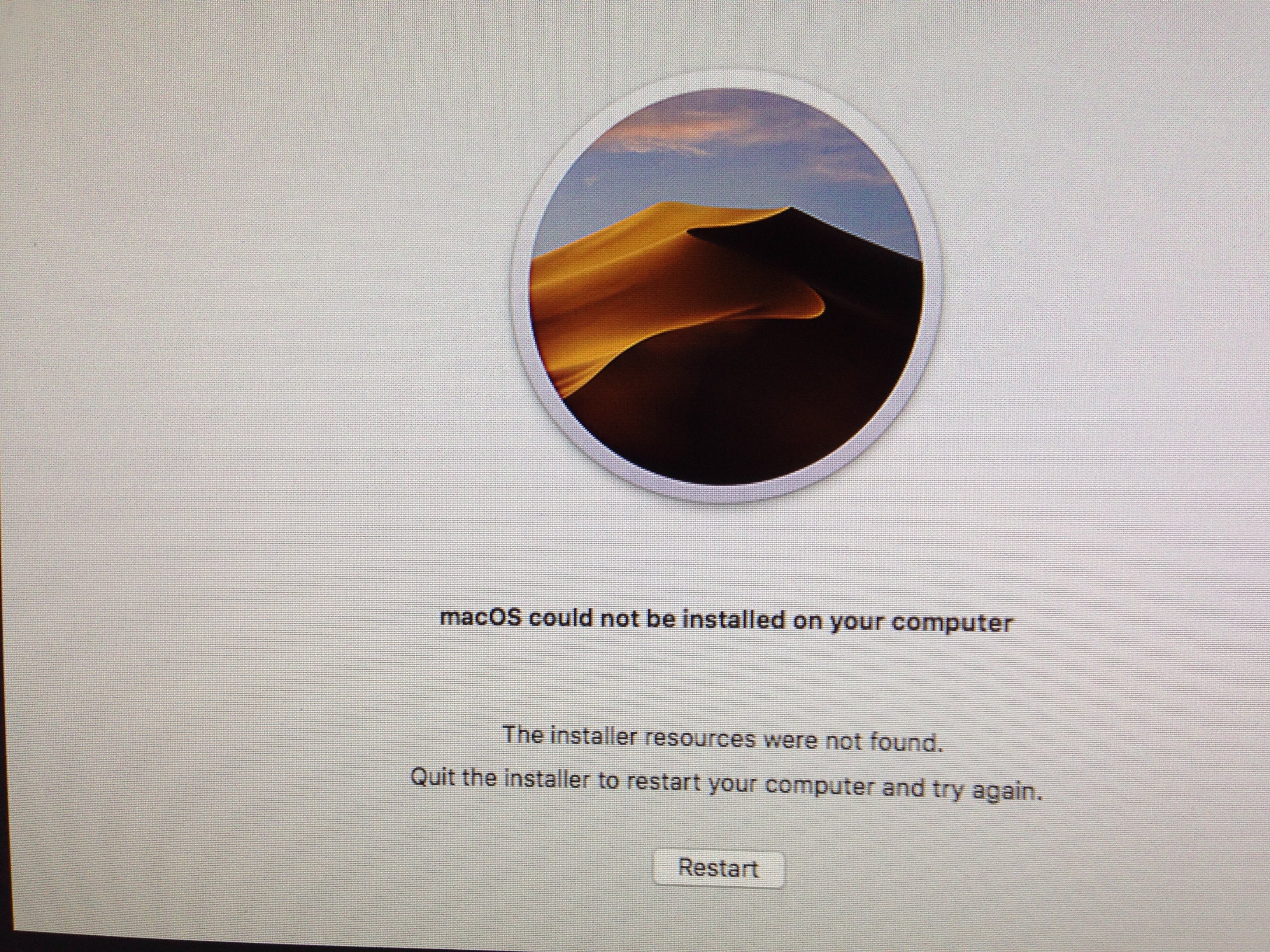

jsl2000 Posted July 7, 2018 Share Posted July 7, 2018 (edited) 3 hours ago, crazybirdy said: No. It's just added back by Apple. 2018-07-06 17:02:01 .. 091-94338 .. 10.14.18A326h Update Beta 2018-07-06 17:10:28 .. 091-94199 .. 10.14.18A326g Update Beta Thanks, it can be updated now. But I need help from you or other friends here: At 10.13.6 or lower I never got this update issue. Only starting from Mojave beta1 (18A293u) to beta3 (18A326g) always got the same error at fresh installation or update: The installer resources were not found. .............Restart ! No matter what I have done with the following methods: Using Clover 4516 or newer Booted by EFI SMBIOS: had tried MacBook Pro 14,3 / Mac Pro 6,1 / iMac 18,3 / iMac Pro 1,1 Partition formated by GPID apfs Currently I can use USB HDD from Real MacBook Pro and cloned by CCC to get the working partition in these Hackintoshs only. Edited July 7, 2018 by jsl2000 1 Link to comment https://www.insanelymac.com/forum/topic/334898-pre-release-macos-mojave/page/68/#findComment-2624680 Share on other sites More sharing options...
crazybirdy Posted July 7, 2018 Share Posted July 7, 2018 (edited) 54 minutes ago, jsl2000 said: Thanks, it can be updated now. But I need help from you or other friends here: At 10.13.6 or lower I never got this update issue. Only starting from Mojave beta1 (18A293u) to beta3 (18A326g) always got the same error at fresh installation or update: The installer resources were not found. .............Restart ! No matter what I have done with the following methods: Using Clover 4516 or newer Booted by EFI SMBIOS: had tried MacBook Pro 14,3 / Mac Pro 6,1 / iMac 18,3 / iMac Pro 1,1 Partition formated by GPID apfs Currently I can use USB HDD from Real MacBook Pro and cloned by CCC to get the working partition in these Hackintoshs only. 1. MBR method may works for you, I think it will also work with pre-formated GUID apfs. Mojave MBR HFS Firmware Check Patch 2. How did you make you installer before? and you can upload the install-log to see what's happened! use mouse to find the top side tool bar on the screen of error, Windows -> Log -> Show All Logs, or /Volumes/1014/macOS Install Data/ia.log Edited July 7, 2018 by crazybirdy 1 Link to comment https://www.insanelymac.com/forum/topic/334898-pre-release-macos-mojave/page/68/#findComment-2624685 Share on other sites More sharing options...
jsl2000 Posted July 7, 2018 Share Posted July 7, 2018 (edited) 2 hours ago, crazybirdy said: 1. MBR method may works for you, I think it will also work with pre-formated GUID apfs. Mojave MBR HFS Firmware Check Patch 2. How did you make you installer before? and you can upload the install-log to see what's happened! use mouse to find the top side tool bar on the screen of error, Windows -> Log -> Show All Logs, or /Volumes/1014/macOS Install Data/ia.log Thank you very much for your patch which can fresh install Mojave Public Beta 1 (18A314k) in MBR partition in my Z87 hackintosh without previous issue. Now I am concerning these questions : 1. Is this patch also working for GUID partition which has been confirmed by other users ? 2. If this MBR partition cloned to GUID partition, can it be updated via normal way by App store ? 3. Can you fix with similar patch to Mojave HFS+ or apfs Firmware check during updating to avoid such an issue ? Thanks a million because it's the first time I can install Mojave in my hackintosh without previous issue. Please see the attached install.log for your reference if it's what you want to check. BTW I'll send you the error log as soon as possible once I reproduce it again ! Because the previous install data were deleted during repeated installation failure ! install.log.zip Edited July 7, 2018 by jsl2000 1 Link to comment https://www.insanelymac.com/forum/topic/334898-pre-release-macos-mojave/page/68/#findComment-2624701 Share on other sites More sharing options...
crazybirdy Posted July 7, 2018 Share Posted July 7, 2018 (edited) 54 minutes ago, jsl2000 said: Thank you very much for your patch which can fresh install Mojave Public Beta 1 (18A314k) in MBR partition in my Z87 hackintosh without previous issue. Now I am concerning these questions : 1. Is this patch also working for GUID partition which has been confirmed by other users ? 2. If this MBR partition cloned to GUID partition, can it be updated via normal way by App store ? 3. Can you fix with similar patch to Mojave HFS+ or apfs Firmware check during updating to avoid such an issue ? Thanks a million because it's the first time I can install Mojave in my hackintosh without previous issue. BTW I'll send you the error log as soon as possible once I reproduce it again ! Because the previous install data were deleted during repeated installation failure ! 1.yes with GUID HFS+, not test with GUID apfs, but it should work too. 2.yes. 3.Read HowTo Q8. -- I can't find the root cause of error with the install-log. It seems you want to update to 10A326g and get error. I though it was a fresh install. Maybe you should try to use the latest version of Clover, and remove install-log, then you will get new clean install-log. Edited July 7, 2018 by crazybirdy Link to comment https://www.insanelymac.com/forum/topic/334898-pre-release-macos-mojave/page/68/#findComment-2624705 Share on other sites More sharing options...
jsl2000 Posted July 7, 2018 Share Posted July 7, 2018 3 hours ago, crazybirdy said: 1.yes with GUID HFS+, not test with GUID apfs, but it should work too. 2.yes. 3.Read HowTo Q8. -- I can't find the root cause of error with the install-log. It seems you want to update to 10A326g and get error. I though it was a fresh install. Maybe you should try to use the latest version of Clover, and remove install-log, then you will get new clean install-log. Yes, I can confirm that this MBR patch worked for both HFS+ and apfs partitions in my hackintoshs. I'll try your advice ASAP. Clover version was updated to 4586 already. 1 Link to comment https://www.insanelymac.com/forum/topic/334898-pre-release-macos-mojave/page/68/#findComment-2624718 Share on other sites More sharing options...

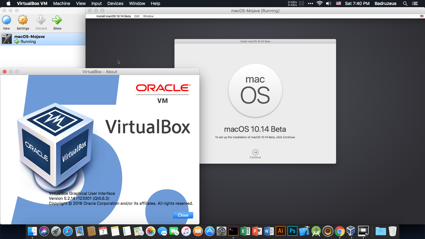

Badruzeus Posted July 7, 2018 Share Posted July 7, 2018 I found a nice guide running macOS 10.14 Mojave on VirtualBox on macOS here (if you're interested). 1 1 Link to comment https://www.insanelymac.com/forum/topic/334898-pre-release-macos-mojave/page/68/#findComment-2624729 Share on other sites More sharing options...

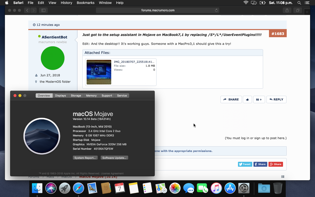

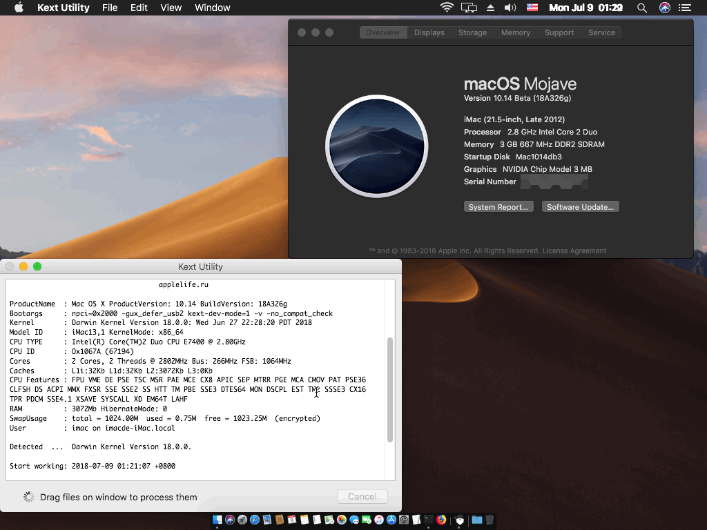

Badruzeus Posted July 8, 2018 Share Posted July 8, 2018 @crazybirdy Just found this, it seems 10.14 Beta works with Core 2 Duo CPU by replacing these from 10.13.x: /System/Library/UserEventPlugins 13 Link to comment https://www.insanelymac.com/forum/topic/334898-pre-release-macos-mojave/page/68/#findComment-2624833 Share on other sites More sharing options...
crazybirdy Posted July 8, 2018 Share Posted July 8, 2018 20 minutes ago, Badruzeus said: @crazybirdy Just found this, it seems 10.14 Beta works with Core 2 Duo CPU by replacing these from 10.13.x: /System/Library/UserEventPlugins Good news, I will try it when I have free time. 1 1 Link to comment https://www.insanelymac.com/forum/topic/334898-pre-release-macos-mojave/page/68/#findComment-2624836 Share on other sites More sharing options...
Badruzeus Posted July 8, 2018 Share Posted July 8, 2018 (edited) 30 minutes ago, crazybirdy said: Good news, I will try it when I have free time. OK, I just got MacBook4,1 on my hand right now.. also going to try with Mojave (test only, no support for GMA X3100 for sure). Edited July 8, 2018 by Badruzeus 3 Link to comment https://www.insanelymac.com/forum/topic/334898-pre-release-macos-mojave/page/68/#findComment-2624839 Share on other sites More sharing options...
Luminadevapps Posted July 8, 2018 Share Posted July 8, 2018 (edited) I FOUND SAME LINK On a Macbook7,1 aka Core 2 duo with penryn architecture Nvidia 320M MCP89 Controller, I suppose this will work on any Penryn c2d Mac too.There is no need to add and replace all the UserEventPlugins folder instead follow these steps:- leave the Mojave's S/L/UserEventPlugins untouched;- replace from a High Sierra's S/L/UserEventPlugins just this plugin: com.apple.telemetry.pluginOnly replacing this plugin you will get no Kernel Panic on C2D. found com.apple.telemetry.plugin is credit to jackluke at post#1761 Edited August 3, 2018 by nmano 5 Link to comment https://www.insanelymac.com/forum/topic/334898-pre-release-macos-mojave/page/68/#findComment-2624866 Share on other sites More sharing options...
Badruzeus Posted July 8, 2018 Share Posted July 8, 2018 15 minutes ago, nmano said: I FOUND SAME LINK On a Macbook7,1 aka Core 2 duo with penryn architecture Nvidia 320M MCP89 Controller, I suppose this will work on any Penryn c2d Mac too.There is no need to add and replace all the UserEventPlugins folder instead follow these steps:- leave the Mojave's S/L/UserEventPlugins untouched;- replace from a High Sierra's S/L/UserEventPlugins just this plugin: com.apple.telemetry.pluginOnly replacing this plugin you will get no Kernel Panic on C2D. Thanks for corrections, I just wanna edit my post but you're one step faster. 1 Link to comment https://www.insanelymac.com/forum/topic/334898-pre-release-macos-mojave/page/68/#findComment-2624869 Share on other sites More sharing options...

fantomas Posted July 8, 2018 Author Share Posted July 8, 2018 1 hour ago, nmano said: replace from a High Sierra's S/L/UserEventPlugins just this plugin: com.apple.telemetry.plugin Maybe someone could check what difference there is between these both files and see if we can use Clover's patch on the fly? 2 Link to comment https://www.insanelymac.com/forum/topic/334898-pre-release-macos-mojave/page/68/#findComment-2624888 Share on other sites More sharing options...

crazybirdy Posted July 8, 2018 Share Posted July 8, 2018 (edited) On 7/8/2018 at 7:17 PM, Badruzeus said: @crazybirdy Just found this, it seems 10.14 Beta works with Core 2 Duo CPU by replacing these from 10.13.x: /System/Library/UserEventPlugins On 7/8/2018 at 11:21 PM, nmano said: I FOUND SAME LINK On a Macbook7,1 aka Core 2 duo with penryn architecture Nvidia 320M MCP89 Controller, I suppose this will work on any Penryn c2d Mac too.There is no need to add and replace all the UserEventPlugins folder instead follow these steps:- leave the Mojave's S/L/UserEventPlugins untouched;- replace from a High Sierra's S/L/UserEventPlugins just this plugin: com.apple.telemetry.pluginOnly replacing this plugin you will get no Kernel Panic on C2D. found UserEventPlugins is credit to ASentientBot at post#1683 found com.apple.telemetry.plugin is credit to jackluke at post#1761 Test is done. Works fine here with Core2 Duo E7400 CPU with only SSE4.1, without SSE4.2. Replace only one file from 10.13.5. /System/Library/UserEventPlugins/com.apple.telemetry.plugin [edit] here for you, if anyone need it. telemetry-plugin-10135.zip telemetry-plugin-10136.zip Edited August 3, 2018 by crazybirdy 7 1 Link to comment https://www.insanelymac.com/forum/topic/334898-pre-release-macos-mojave/page/68/#findComment-2624901 Share on other sites More sharing options...
