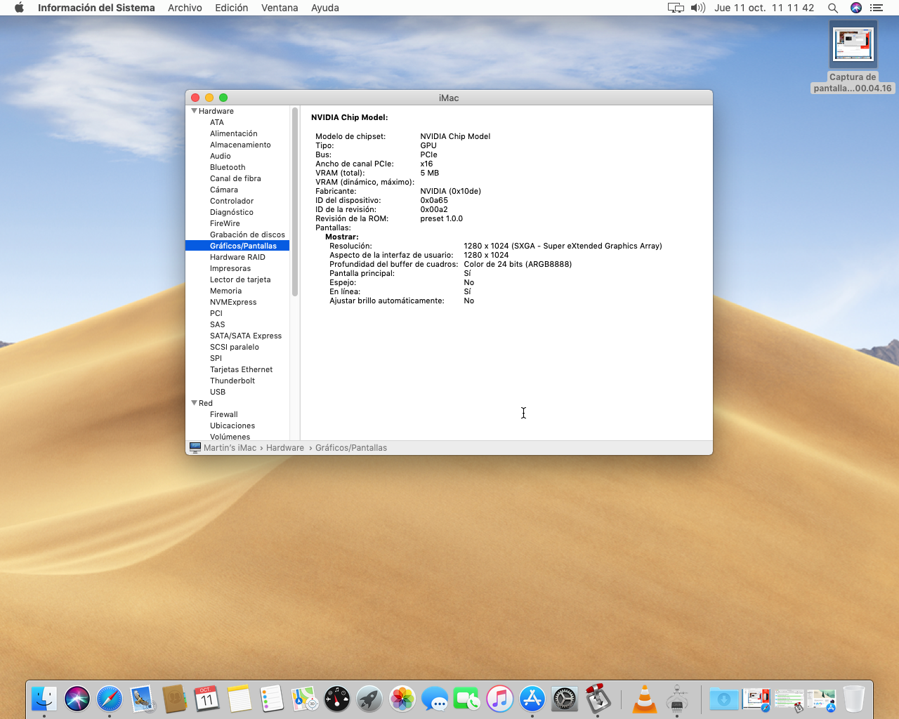

ezyrdr Posted October 11, 2018 Author Share Posted October 11, 2018 it not recognizes my card as en210 silent...maybe msi gt710 got metal support? Link to comment https://www.insanelymac.com/forum/topic/334679-existing-sierra-10126-cant-make-visible-high-sierra-install-disk/page/4/#findComment-2640210 Share on other sites More sharing options...

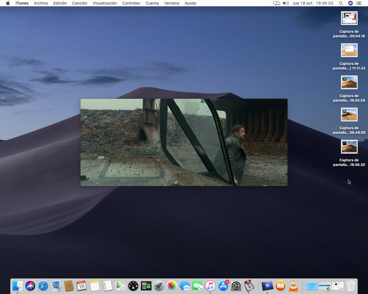

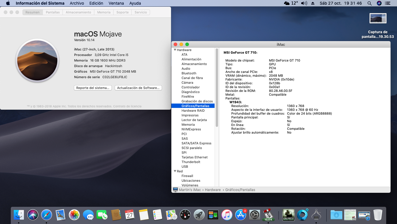

ezyrdr Posted October 20, 2018 Author Share Posted October 20, 2018 no qe/ci for tabs without graphics corruption and a minimal display resolution...hope this gt710 2GB get to work oob. it was cheap but my main concern is whether ill get recognized by apple system properties... I got Nvidia injection on...so maybe that won't mess with it Link to comment https://www.insanelymac.com/forum/topic/334679-existing-sierra-10126-cant-make-visible-high-sierra-install-disk/page/4/#findComment-2641980 Share on other sites More sharing options...

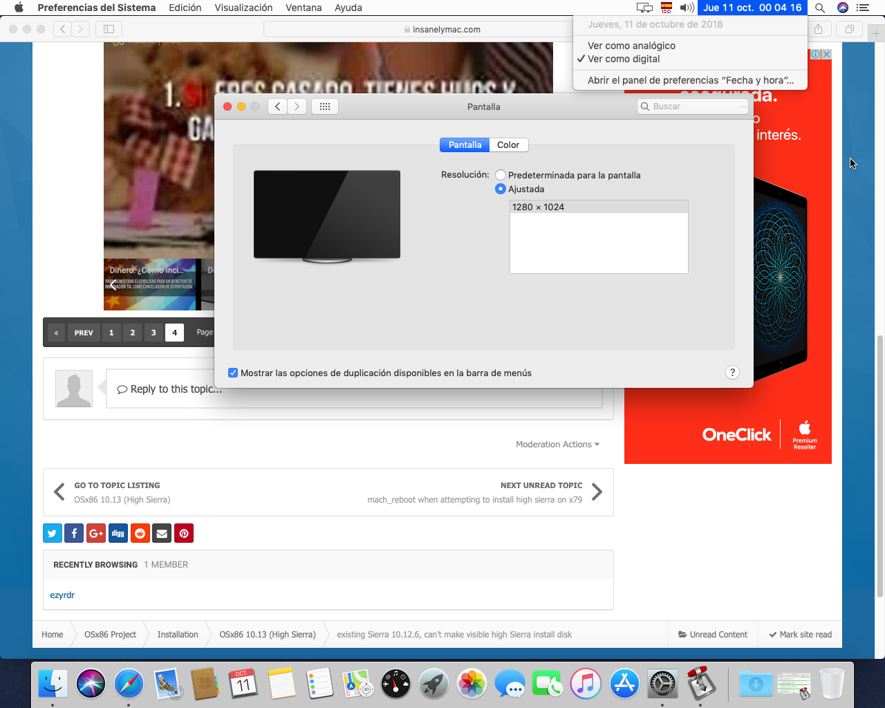

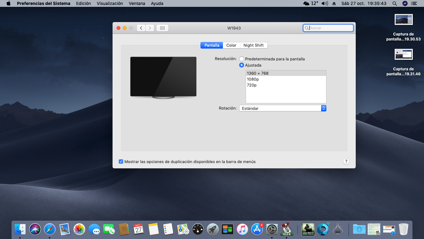

ezyrdr Posted October 27, 2018 Author Share Posted October 27, 2018 ok now...this geforce gt710 2GB DDR3 works oob like it was said on some page...gets recognized, but vga connector don't work. im using it with an HDMI to VGA adaptor. and it goes just fine. maybe a newer display next to get full hd resolution, since my ol LG display only gives me 1360x768 ... ill post the clover folder that gets me to the desktop later. but yes, MOJAVE works with Asus h97m-e CSM and MSI GeForce GT710 2GB DDR3 (you have to remember to add APFS driver efi64 to the drivers64 or you won't be able to boot, when installing clover to the usb thumb remember to add uefi boot and the driver). audio: only back panel mic and speakers. front headphones and mic don't work as far as i remember LAN: works great, don't know if oob, but RealtekRTL8111.kext gives me connectivity VIDEO:the msi card works with an HDMI to VGA adapter, so HDMI is fine Link to comment https://www.insanelymac.com/forum/topic/334679-existing-sierra-10126-cant-make-visible-high-sierra-install-disk/page/4/#findComment-2643472 Share on other sites More sharing options...

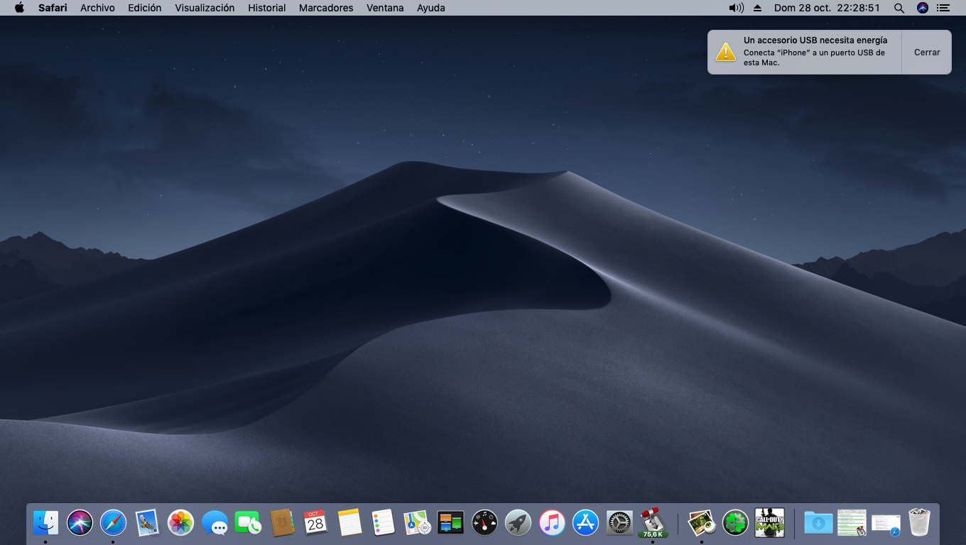

ezyrdr Posted October 29, 2018 Author Share Posted October 29, 2018 i have found that the USB ports must be not working properly...I try to connect my iPhone via usb, and all I get is a system message that sez "an USB accessory needs energy" "connect the iPhone to an USB port in this mac" anybody knows anything about USB ports that could fix this? Link to comment https://www.insanelymac.com/forum/topic/334679-existing-sierra-10126-cant-make-visible-high-sierra-install-disk/page/4/#findComment-2643659 Share on other sites More sharing options...

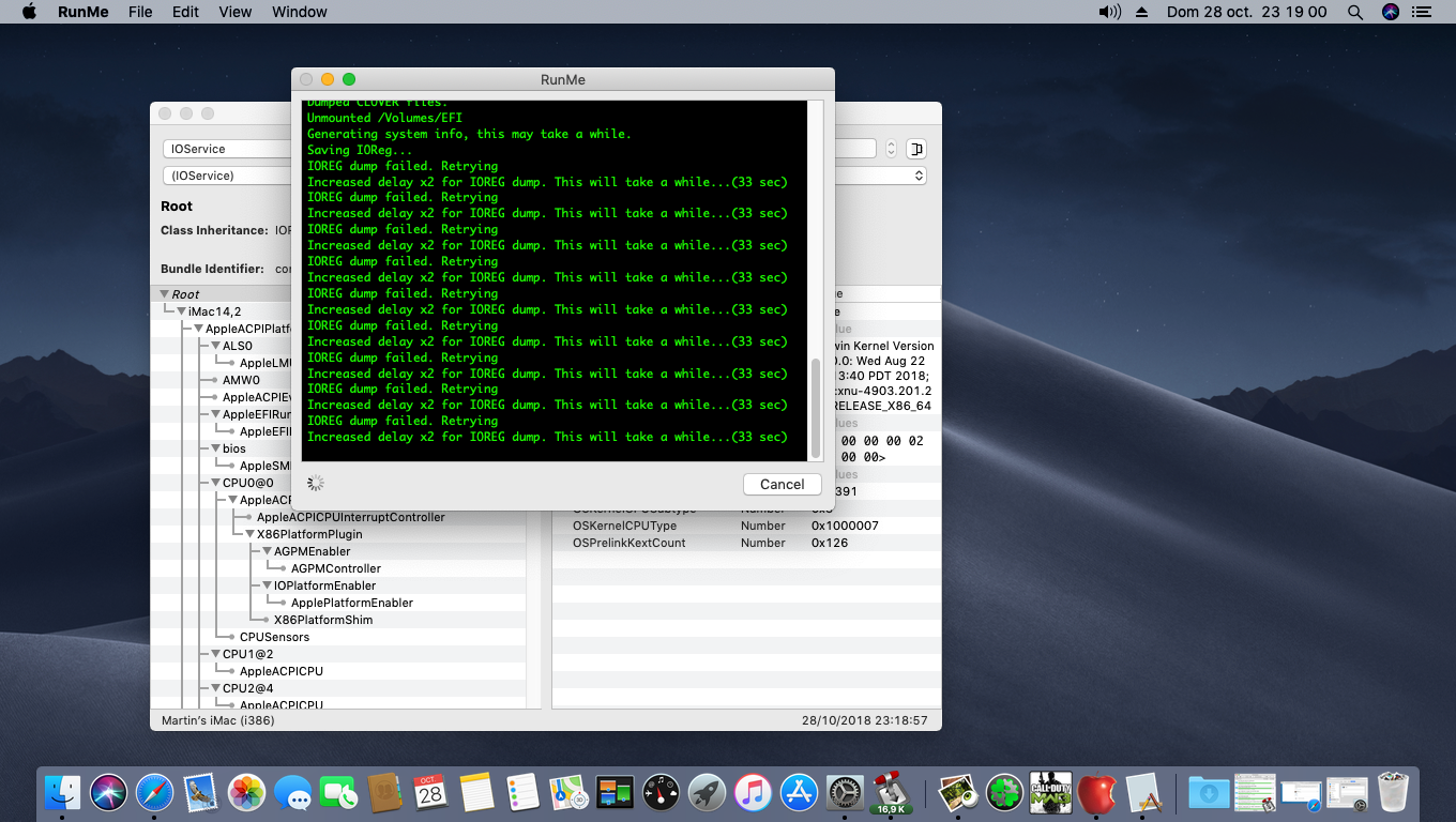

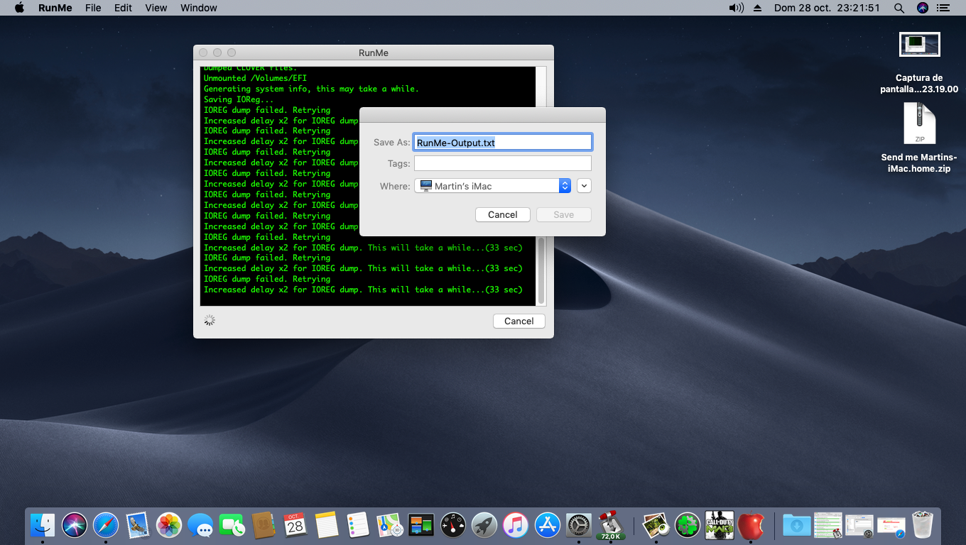

ezyrdr Posted October 29, 2018 Author Share Posted October 29, 2018 maldon, the runme app delivered I posted over tinyupload the results Link to comment https://www.insanelymac.com/forum/topic/334679-existing-sierra-10126-cant-make-visible-high-sierra-install-disk/page/4/#findComment-2643666 Share on other sites More sharing options...

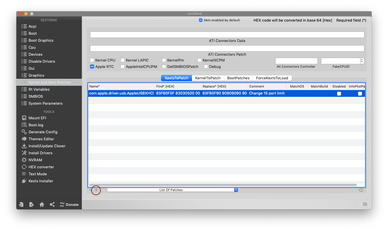

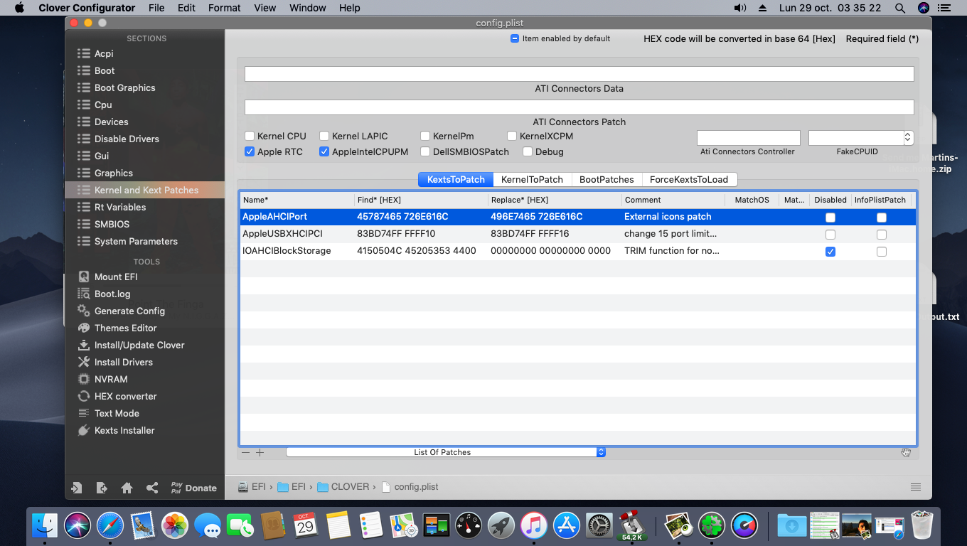

Cyberdevs Posted October 29, 2018 Share Posted October 29, 2018 Make sure you have the latest USBInjectAll.kext and the following USB limit patch: Name: com.apple.driver.usb.AppleUSBXHCI Find: 83FB0F0F 83030500 00 Replace: 83FB0F90 90909090 90 Comment: Change 15 port limit USBInjectAll.kext.zip Link to comment https://www.insanelymac.com/forum/topic/334679-existing-sierra-10126-cant-make-visible-high-sierra-install-disk/page/4/#findComment-2643677 Share on other sites More sharing options...
ezyrdr Posted October 29, 2018 Author Share Posted October 29, 2018 hello! thanks for the reply...I have a newer version of that kext, that was the first thing I checked. but I don't get where to apply these values (sorry my dumbness), I was lookin up in clover configurator, but there's nothing there?! Link to comment https://www.insanelymac.com/forum/topic/334679-existing-sierra-10126-cant-make-visible-high-sierra-install-disk/page/4/#findComment-2643679 Share on other sites More sharing options...
Cyberdevs Posted October 29, 2018 Share Posted October 29, 2018 13 minutes ago, ezyrdr said: hello! thanks for the reply...I have a newer version of that kext, that was the first thing I checked. but I don't get where to apply these values (sorry my dumbness), I was lookin up in clover configurator, but there's nothing there?! You need to add the patch under Kernel and kext Patches: You might have other (older patches) in the config.plist which you need to disable them. If the issue isn't fixed post your EFI folder and I'll take a look. Link to comment https://www.insanelymac.com/forum/topic/334679-existing-sierra-10126-cant-make-visible-high-sierra-install-disk/page/4/#findComment-2643680 Share on other sites More sharing options...

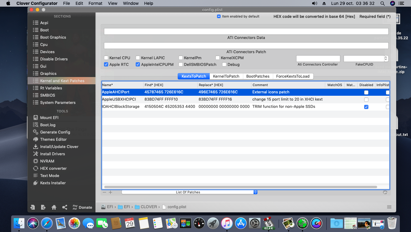

ezyrdr Posted October 29, 2018 Author Share Posted October 29, 2018 (edited) efí folder: http://s000.tinyupload.com/index.php?file_id=74975981995841112169 lus pics of my CC in the kext and patches section that's all I got Edited October 29, 2018 by ezyrdr Link to comment https://www.insanelymac.com/forum/topic/334679-existing-sierra-10126-cant-make-visible-high-sierra-install-disk/page/4/#findComment-2643687 Share on other sites More sharing options...
Cyberdevs Posted October 29, 2018 Share Posted October 29, 2018 You are using an old patch for the USB port limit and it's called: AppleUSBXHCIPCI remove it or disable it and add the new patch i gave you or use this config instead. config.plist.zip Link to comment https://www.insanelymac.com/forum/topic/334679-existing-sierra-10126-cant-make-visible-high-sierra-install-disk/page/4/#findComment-2643701 Share on other sites More sharing options...

ezyrdr Posted October 29, 2018 Author Share Posted October 29, 2018 nothing apple mouse just freezes also keyboard i dont get usb at all. now im not sure how to replace it. maybe the config.plist needed YOUR usbinjectall? cause i downloaded the newest from the github page if i remember well. now i cant use the hackintosh. im writing from the phone i tried to unplug and re plug the usb hub for apple. but it just freezes no! wait ! i plugged the hub on another USB port and now I'm writing from Mojave Link to comment https://www.insanelymac.com/forum/topic/334679-existing-sierra-10126-cant-make-visible-high-sierra-install-disk/page/4/#findComment-2643774 Share on other sites More sharing options...
ezyrdr Posted October 29, 2018 Author Share Posted October 29, 2018 the system message still pops up. says I need to plug the iPhone to an USB port. I'm tryin from the front port, but last time the back ports neither worked with the apple phone... front ports don’t work with the phone. only back panel ports work Link to comment https://www.insanelymac.com/forum/topic/334679-existing-sierra-10126-cant-make-visible-high-sierra-install-disk/page/4/#findComment-2643775 Share on other sites More sharing options...
ezyrdr Posted October 29, 2018 Author Share Posted October 29, 2018 front ports don’t work. only back ones... think ill just reinstall sierra Link to comment https://www.insanelymac.com/forum/topic/334679-existing-sierra-10126-cant-make-visible-high-sierra-install-disk/page/4/#findComment-2643777 Share on other sites More sharing options...

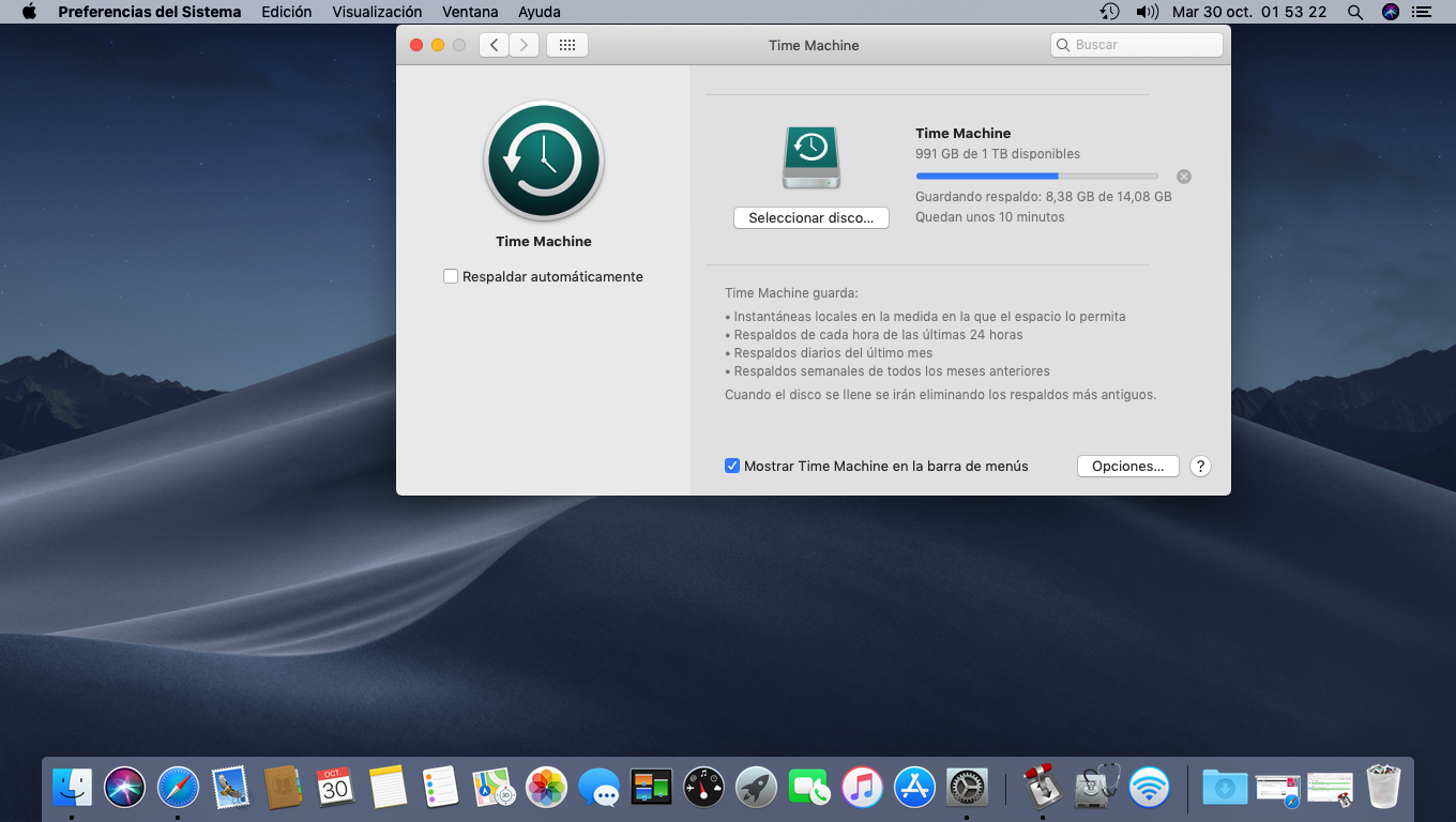

ezyrdr Posted October 30, 2018 Author Share Posted October 30, 2018 i tried the dsdt that maldon gave me. and it works! everything seems to be fine. even sleep worked. i say worked cause i tried out the new efi folder in the usb installer and got in internet straight from the usb install disk, and i got connection! just when i restarted, clover gives me a kernel error offset. ill try with time machine or start again over with the installer from scratch. but now i have more reliable media to start from! thanks for your help everybody!!! Link to comment https://www.insanelymac.com/forum/topic/334679-existing-sierra-10126-cant-make-visible-high-sierra-install-disk/page/4/#findComment-2643918 Share on other sites More sharing options...
ezyrdr Posted October 30, 2018 Author Share Posted October 30, 2018 efí folder for this mother and graphics card: http://s000.tinyupload.com/index.php?file_id=00672681609510635361 sleep wake works only with the power button, not the keyboard like at other times. now im doing a time machine backup, just in case it comes handy... Link to comment https://www.insanelymac.com/forum/topic/334679-existing-sierra-10126-cant-make-visible-high-sierra-install-disk/page/4/#findComment-2643924 Share on other sites More sharing options...
