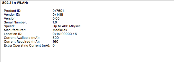

Nancy10 Posted December 13, 2017 Author Share Posted December 13, 2017 hi.. and see this too.. http://www.insanelymac.com/forum/topic/299948-usb-wifi-updated-ralinkmediatek-rt2870-rt2770-rt3x7x-rt537x-rt5572/ this send you to the previous link c.frio The drivers from mediatek, didn't work. I installed those and still have the same problems, i can see Ralink in the menu bar but clicking on it i only get the option to open wireless utility which doesn't open when clicking it. i attached the usb device information from my sysinfo. I don't know exactly how this work, but i need it to. can you help ? Link to comment https://www.insanelymac.com/forum/topic/330586-problem-with-my-ralink-usb-wireless-adapter-drivers-dont-work/#findComment-2549908 Share on other sites More sharing options...
Nancy10 Posted December 14, 2017 Author Share Posted December 14, 2017 Doh! You could have started with that, because that's an MT7601 chip, not RT5370... Look for the relevant driver at the same place provided by c.frio. https://www.mediatek.com/products/connectivity-and-networking/broadband-wifi I couldn't find any drivers for macOs, mediatek only have windows drivers for MT7601. i tried to install drivers for MT7612 ( the only ones available for mac ). it didn't bring any results other than the wireless utility not opening and the usb dongle not working. i found a post on tonymac but the link they gave for El Capitan drivers which are supposed to run okey on sierra is not available anymore. https://www.tonymacx86.com/threads/wireless-usb-dongle-ralink-mediatek-mt7601-for-sierra.222263/ Link to comment https://www.insanelymac.com/forum/topic/330586-problem-with-my-ralink-usb-wireless-adapter-drivers-dont-work/#findComment-2550670 Share on other sites More sharing options...
