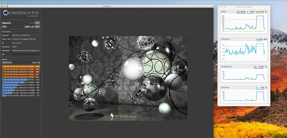

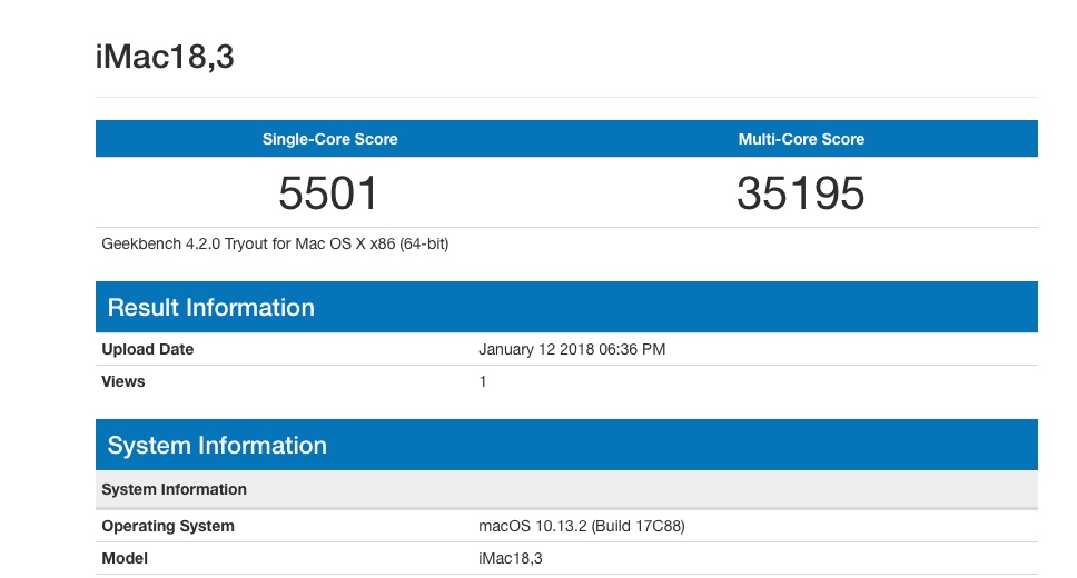

zambostraut Posted January 12, 2018 Share Posted January 12, 2018 Here are my Benchmark scores in the attached images with the settings posted below. If anyone else on here want's to throw theirs in to the thread and Slurpi doesn't mind this content in his thread I think that would be useful to work out if the RAM speed issue is purely cosmetic, BIOS or OS X based. GeekBench SINGLE 5501 : MULTI = 35195 CineBench 1895 Best so far Power Consumption MAX 183Watts Temp MAX 79c CPU Clock Ratio 4.4 (All Cores) CPU Mesh Ratio 3.2 Energy Efficient Turbo Disabled Enhanced Multi Core Enabled Hyper-Threading Technology: Enabled CPU EIST Function: Auto Extreme Memory Profile (X.M.P): Profile1 (OS X Reports 2133mhz even though my RAM is set to 3000mhz and BIOS correctly reports this speed. Not sure if this is a cosmetic error of if the RAM is actually running at XMP Profile 1 true speed.) Link to comment https://www.insanelymac.com/forum/topic/327964-msi-x299-sli-plus-and-intel-7820x-installation-and-post-installation-steps/page/2/#findComment-2568043 Share on other sites More sharing options...
slurpi Posted January 13, 2018 Author Share Posted January 13, 2018 Not a problem if you want to investigate your XMP issues here. You might not have a large audience ;-) My scores @ 4.4GHz are: Cinebench: 1923. That's the best with 17C205. I had a slightly better one before: 1928. Temps at 99C, but no throttling. Geekbench: 5490 / 36053. I also used to have a better score (a bit above 5500 / 36300). Link to comment https://www.insanelymac.com/forum/topic/327964-msi-x299-sli-plus-and-intel-7820x-installation-and-post-installation-steps/page/2/#findComment-2568478 Share on other sites More sharing options...
zambostraut Posted January 13, 2018 Share Posted January 13, 2018 Hey, Yes I imagine it's not going to be the most talked about subject ever but you never know. Your scores are pretty good and interesting to see the difference even though we are using the same hardware basically. Those temps are pretty crazy mind you, is that on water or just air? So we're both at 4.4ghz and it seems your scores are about 3% faster or so. Negligble I guess but the only difference could be the RAM / Motherboard. I get the feeling if our RAM was running at the correct XMP speed we'd see another 3-4% again. Think the new Spectre / Meltdown patch has taken a little off of our scores but I'll have another test today with different bios settings. Manually setting the timings has done some good things for other users but it seems like a lot of assing around for a small gain. It's addictive getting every last point out mind you. Will report back in due course. Link to comment https://www.insanelymac.com/forum/topic/327964-msi-x299-sli-plus-and-intel-7820x-installation-and-post-installation-steps/page/2/#findComment-2568556 Share on other sites More sharing options...
slurpi Posted January 13, 2018 Author Share Posted January 13, 2018 My cooling is air, the Noctua D15. Tests show that it is equivalent to an 240mm AIO (like the Corsair 115i) so I went for that, due to the simple setup. It forced me to have a big case though, because of it's height. The temps are so high because the core voltage for 4.4GHz is at 1.21V. Lower voltage than (or auto) and I was getting random reboots when doing the performance tests. Cheap motherboard, I guess, even with the latest UEFI. Ultimately, the thermal compound Intel used on the heat shield is really to blame, plenty of people that delid get 10C-20C lower. My usual temps under load (compilation of programs, parallel processing of data using MPI) is usually 70-80C, so I'm ok with this. And I also suspect it's the Meltown patch that cause the performance to be a bit lower. Link to comment https://www.insanelymac.com/forum/topic/327964-msi-x299-sli-plus-and-intel-7820x-installation-and-post-installation-steps/page/2/#findComment-2568656 Share on other sites More sharing options...
zambostraut Posted January 14, 2018 Share Posted January 14, 2018 Did you change your CPU Mesh Ratio or Frequency at all? I left my CPU votalge at auto and haven't noticed any reboots or stability issues. Warmest I get is 81c at full whack 4.4Ghz on all cores. Sure I can push it a bit higher but not sure the extra 500 points on GB is worth the heat / power usage. I'd far rather get this RAM speed thing working for sure. Although it's meant to be minimal in performance gainz we both have 25 -30% extra RAM speed to get out of our systems as it stands. Other X299 builds seem to be picking up the correct speeds so no idea why we aren't. Temps below 90c are ok with me I guess and I'm really quite happy with the stability of X299 on High Sierra. I'd have to find a really good reason to bump up to the SMBIOS Mac Pro 1.1. Not sure what benefit it will bring but if you go for it and notice anything do notify. Cheers! Link to comment https://www.insanelymac.com/forum/topic/327964-msi-x299-sli-plus-and-intel-7820x-installation-and-post-installation-steps/page/2/#findComment-2568907 Share on other sites More sharing options...
slurpi Posted January 14, 2018 Author Share Posted January 14, 2018 Did you change your CPU Mesh Ratio or Frequency at all? I just changed the multiplier to 44 (to get 4.4GHz) and the core voltage as low as I could get to get stability. At 1.20V, the machine would reboot during the Prime95 (in the first 10 min). This is the first time I am OC (it's the first time in 10 years that I built a computer), so everything is a bit overwhelming. Changing just the multiplier and adjusting the voltage was as far as I wanted to go. That's why I am also using XMP to OC the memory, and I don't do it manually. On paper my memory claims to be 3200MHz, but XMP only gives it 2800MHz, and I don't want to push it further. A finally issue is the dubious quality of some X299 motherboards. It has been shown that some of them can't really support the high power draw of OC, and they can overheat. My MB is on the lower end, but it has behaved well so far (knock on wood). I think 4.4GHz is as far as I dare to go, even if I had a liquid cooling system. About the iMacPro1,1, I want to give it a try. I noticed that some of the USB 3.0 ports are not recognized, and I hope with the new SMBIOS it will be fixed ;-) Mostly, I don't like to use all the DSDT + Clover patches to get a system running. The more native the better. I tried yesterday the 10.13.2 installer from the Apple store, but it still needs some fixing to install on a iMacPro SMBIOS. There are some instructions on the net on how to do that, but it is too much unnecessary work for me. Like you, I enjoy the stability and performance as it is. In addition, I am hope that 10.13.3 will be easy to install on an iMacPro hack, without any special changes, so I'll wait for that. Good luck with your issues. BTW, I read in another forum that the MSR 0xE2 Register on your BIOS can be patched so that it is writeable by macOS. The removes a Clover patch and allows for better performance and better sleep/wake functionality. Have you tried that yet? Link to comment https://www.insanelymac.com/forum/topic/327964-msi-x299-sli-plus-and-intel-7820x-installation-and-post-installation-steps/page/2/#findComment-2568973 Share on other sites More sharing options...
