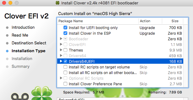

Guest Posted January 20, 2018 Share Posted January 20, 2018 :-) you have to instal clover in your UEFI boot hd (check if it is in apfs or not) with basic option and the you can overwrite EFI created with your working USB EFI one ps it is a good Idea to put in your signature your hardware so people could advice you better :-) Wow, i used a different usb port and i am in the installer now! Let's hope i don't screw this one up Thanks! Installation succesfull! Do i need to do the same things i did to my usb drive (install clover, clover configurator, copy kext, drivers64UEFI etc) on my SSD where Mac OS is installed on? Link to comment https://www.insanelymac.com/forum/topic/327964-msi-x299-sli-plus-and-intel-7820x-installation-and-post-installation-steps/page/4/#findComment-2572787 Share on other sites More sharing options...
bbuster Posted January 20, 2018 Share Posted January 20, 2018 Thnx, i installed Clover on the SSD, now i am going to copy all the files from my usb stick. I hope that doesn't make it crash. After that i can remove my usb stick and try to boot in Mac OS without the USB? And after that i can reinstall my M.2 SSD with windows? Or is another sequence better? Thanks for your help Link to comment https://www.insanelymac.com/forum/topic/327964-msi-x299-sli-plus-and-intel-7820x-installation-and-post-installation-steps/page/4/#findComment-2572790 Share on other sites More sharing options...
Guest Posted January 20, 2018 Share Posted January 20, 2018 Explain better have you one disk only for OSX and Windows (not good idea because it is more difficult to configure) Please add a signature so people can understand better Thnx, i installed Clover on the SSD, now i am going to copy all the files from my usb stick. I hope that doesn't make it crash. After that i can remove my usb stick and try to boot in Mac OS without the USB? And after that i can reinstall my M.2 SSD with windows? Or is another sequence better? Thanks for your help Link to comment https://www.insanelymac.com/forum/topic/327964-msi-x299-sli-plus-and-intel-7820x-installation-and-post-installation-steps/page/4/#findComment-2572793 Share on other sites More sharing options...
bbuster Posted January 20, 2018 Share Posted January 20, 2018 I added a signature now, No, i have a Samsung 850 Evo (250gb) for Mac OS, and a M.2 250GB Samsung 960 evo for windows (and a M.2 1TB Samsung 960 evo for data but i don't think that is important) Link to comment https://www.insanelymac.com/forum/topic/327964-msi-x299-sli-plus-and-intel-7820x-installation-and-post-installation-steps/page/4/#findComment-2572798 Share on other sites More sharing options...

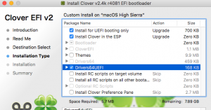

Guest Posted January 20, 2018 Share Posted January 20, 2018 ok now is more clear you have also a 1080 ti so you have to also install correct web driver (based on your osx version number) My advice is:take care of your working usb pen for now then install on your OSX ssd with this option selected (see image) then with clover configuration usb Pen partition and copy (replace) it on ssd disk then remove USB pen and try to boot with your ssd disk (remember to check apfs.efi in drivers64uefi if you have converted your disk in apfs) you should start in VESA mode (no acceleration basic gfx osx driver ) from there you can start to install NVIDIA WEB Driver and solve future problem :-) pS IMHO for installation you can also use always 1080 ti like I do... x299 is newer than x99 but it is working the same for more parts also specify osx version and SMBios you are using for windows part it quite simple you can install on your m2 drive as you would do normally then in your bios in boot option you can configure it like I do first boot disk UEFI OSX disk, second disk M2 disk with windows In my case I am using clover boot loader to start and then in boot clover menu I choose which system from which I want to boot Link to comment https://www.insanelymac.com/forum/topic/327964-msi-x299-sli-plus-and-intel-7820x-installation-and-post-installation-steps/page/4/#findComment-2572801 Share on other sites More sharing options...
bbuster Posted January 20, 2018 Share Posted January 20, 2018 Thanks! that worked! I can now boot into Mac OS without the usb stick. if i need to install kext, do i simply copy them to the SSD/EFI/Clover/Kext/Other folder? or do i need to install software for that? Link to comment https://www.insanelymac.com/forum/topic/327964-msi-x299-sli-plus-and-intel-7820x-installation-and-post-installation-steps/page/4/#findComment-2572810 Share on other sites More sharing options...
