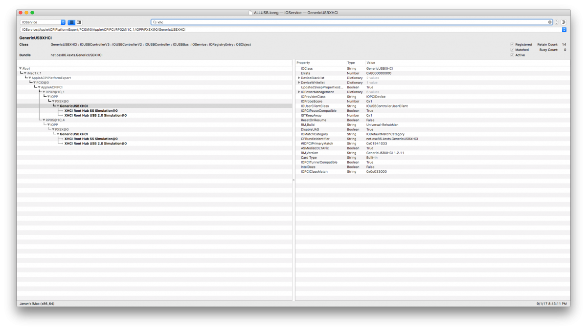

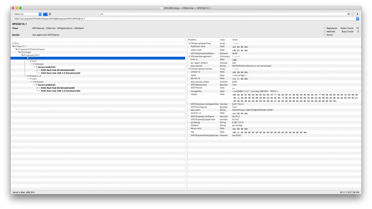

Cyberdevs Posted September 1, 2017 Share Posted September 1, 2017 unfortunately the ALLUSB file is unusable as you can see it doesn't show any USB 3.0 devices detected. Can you do something else. I need you to remove GenericUSBXHCI kext and add the USBInjectAll.kext and save those two IOReg files and send the results back to me. Update: Your ASmedia USB 3.0 port's ID is not present in the custom-SSDT-UIAC template, we have two options. Option 1: Try using the following kext that I attached. Option 2: I change the device ID in the template with yours and hope for it to work. Try option 1 and see if it makes any difference and let me know. Use the mxHC without using the genericUSBXHCI and USBInjectAll. add these ACPI fixes to your config.plist using clover configurator. change EHC1 to EH01 change EHC2 to EH02 change XHC1 to XHC mXHCD.kext.zip Link to comment https://www.insanelymac.com/forum/topic/326150-asus-p8z68v-pro-rev10-probelm-installing-sierra/page/4/#findComment-2488331 Share on other sites More sharing options...

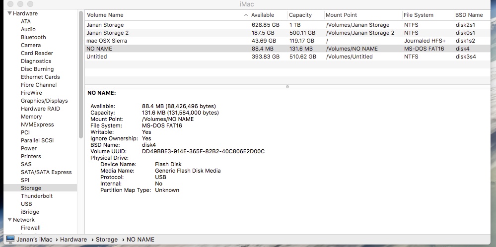

newsman1 Posted September 1, 2017 Author Share Posted September 1, 2017 ok I did option 1 but every thing still the same all ports are working (2.0 & 3.0) but on the system info it does not recognize the 3.0 ports as USB but it does recognize it as storage but the ports are working Link to comment https://www.insanelymac.com/forum/topic/326150-asus-p8z68v-pro-rev10-probelm-installing-sierra/page/4/#findComment-2488363 Share on other sites More sharing options...

newsman1 Posted September 1, 2017 Author Share Posted September 1, 2017 here is a new reading for you to check if you want too update: I can not post the ALLUSB reading because its bigger then 10 mb and I'm not allowed more then that NEWNOUSB.ioreg.zip Link to comment https://www.insanelymac.com/forum/topic/326150-asus-p8z68v-pro-rev10-probelm-installing-sierra/page/4/#findComment-2488369 Share on other sites More sharing options...

newsman1 Posted September 1, 2017 Author Share Posted September 1, 2017 I have the IOJones reading if that will work let me know please thanks Do they operate at usb 3.0 speed?Sent from my iPhone using Tapatalk no it does not Link to comment https://www.insanelymac.com/forum/topic/326150-asus-p8z68v-pro-rev10-probelm-installing-sierra/page/4/#findComment-2488399 Share on other sites More sharing options...
Cyberdevs Posted September 1, 2017 Share Posted September 1, 2017 I have the IOJones reading if that will work let me know please thanks no it does not send me your iojones file as well. this file is the same. Also send me the latest EFI folder that you are using. I want to make sure everything is in place. Remove Apple folders and themes. Link to comment https://www.insanelymac.com/forum/topic/326150-asus-p8z68v-pro-rev10-probelm-installing-sierra/page/4/#findComment-2488417 Share on other sites More sharing options...
newsman1 Posted September 1, 2017 Author Share Posted September 1, 2017 here is both files EFI.zip ALLUSB.iojones.zip Link to comment https://www.insanelymac.com/forum/topic/326150-asus-p8z68v-pro-rev10-probelm-installing-sierra/page/4/#findComment-2488459 Share on other sites More sharing options...
Cyberdevs Posted September 1, 2017 Share Posted September 1, 2017 I can still see that the GenericUSBXHCI is loading. and there's another patch in the config.plist that is not for macOS Sierra. it's for high Sierra. Use this config and before booting your pc with the new config run a kext cache cleanup. config.plist.zip Link to comment https://www.insanelymac.com/forum/topic/326150-asus-p8z68v-pro-rev10-probelm-installing-sierra/page/4/#findComment-2488463 Share on other sites More sharing options...
newsman1 Posted September 1, 2017 Author Share Posted September 1, 2017 yes I'm sorry man I did not delete the GenericUSBXHCI properly the first time, but I did now and none of the 3.0 ports are working only the 2.0 are working do you want me to do a new reading of the IOReg files and send it to you Link to comment https://www.insanelymac.com/forum/topic/326150-asus-p8z68v-pro-rev10-probelm-installing-sierra/page/4/#findComment-2488480 Share on other sites More sharing options...
Cyberdevs Posted September 1, 2017 Share Posted September 1, 2017 Well that's ok please do a kext cache clean up first and then replace your config with the last one I sent you and after that send me your ioreg/iojones file. Link to comment https://www.insanelymac.com/forum/topic/326150-asus-p8z68v-pro-rev10-probelm-installing-sierra/page/4/#findComment-2488487 Share on other sites More sharing options...
newsman1 Posted September 1, 2017 Author Share Posted September 1, 2017 ok all done and here is the files, NOUSB reading has 1 USB plugged (mouse & keyboard) ALLUSB.ioreg.zip NOUSB.ioreg.zip Link to comment https://www.insanelymac.com/forum/topic/326150-asus-p8z68v-pro-rev10-probelm-installing-sierra/page/4/#findComment-2488507 Share on other sites More sharing options...
