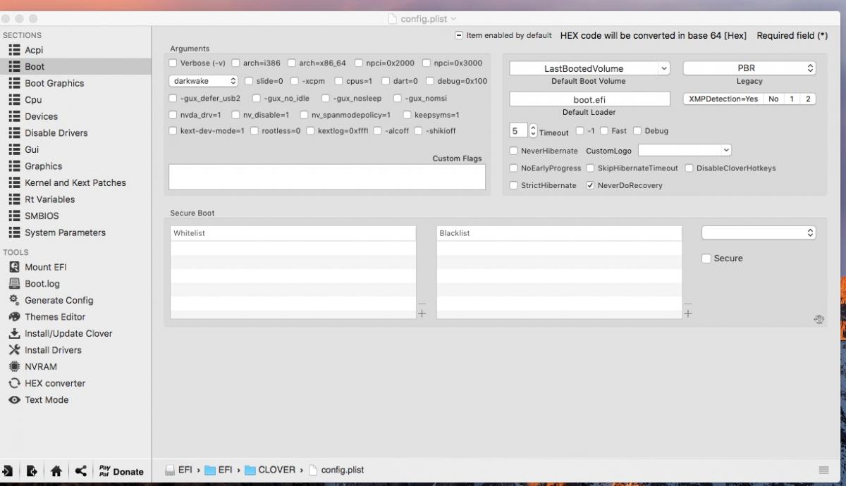

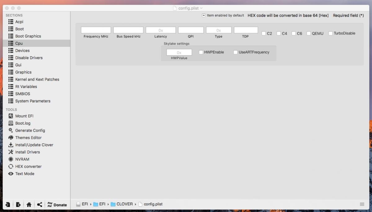

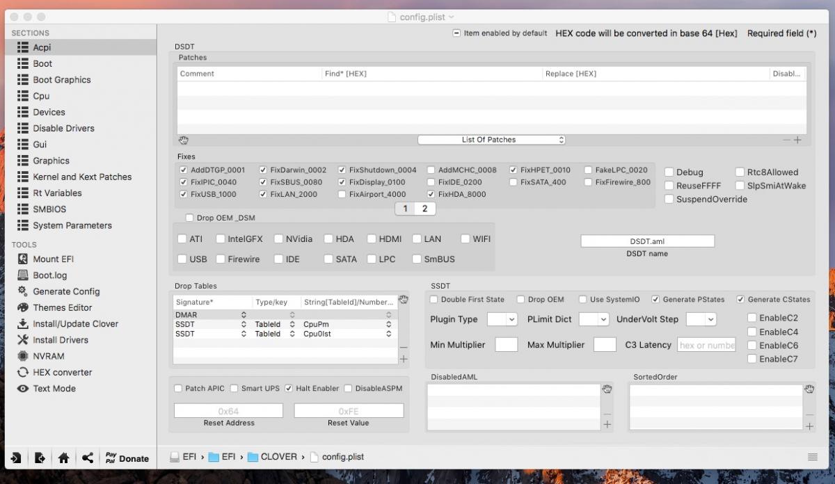

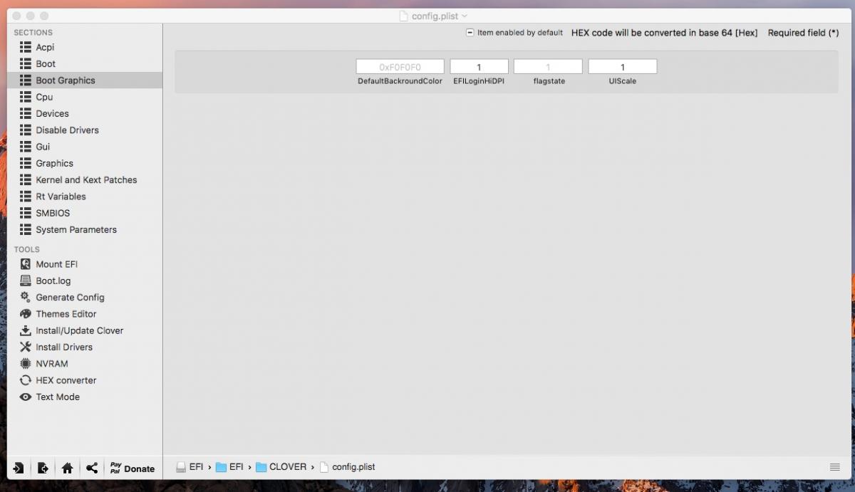

newsman1 Posted August 15, 2017 Author Share Posted August 15, 2017 hi cyberdevs I had some spare time to start this installation before my vacation. So now I'm at the point of editing my config.plist so I opened it with Clover Configurator but I did no too any thing I just screen shots of a couple thing here for you so you see it and help me get it setup please. Link to comment https://www.insanelymac.com/forum/topic/326150-asus-p8z68v-pro-rev10-probelm-installing-sierra/#findComment-2479910 Share on other sites More sharing options...
Cyberdevs Posted August 16, 2017 Share Posted August 16, 2017 hi cyberdevs I had some spare time to start this installation before my vacation. So now I'm at the point of editing my config.plist so I opened it with Clover Configurator but I did no too any thing I just screen shots of a couple thing here for you so you see it and help me get it setup please. Hi there this the the folder I used to boot and setup my P8H77-M LE the config is set to match your system's spec. Give it a try and let me know if it works. AEFI.zip 1 Link to comment https://www.insanelymac.com/forum/topic/326150-asus-p8z68v-pro-rev10-probelm-installing-sierra/#findComment-2480156 Share on other sites More sharing options...

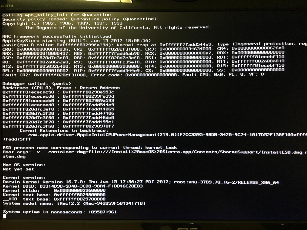

newsman1 Posted August 16, 2017 Author Share Posted August 16, 2017 hi cyberdevs, let me start by telling you what i did last night I got the bootable USB disk install clover 2.4k_4152 on the USB options: UEFI bootin theme EmuVariableUefi-64 OsxAptioFix2Drv-64 RC script on the target volume and i did add all the kext to /EFI/Clover/kext/10.12 ( i just did copy and paste from my desktop ) AppleALC.kext Lilu.kext with proper Layout-ID 1 injection with clover. IntelMausiEthernet.kext USBInjectAll.kext nVidiaGraphicsFixup.kext and it was a no go. i could not get the part installation done and this what i got: Link to comment https://www.insanelymac.com/forum/topic/326150-asus-p8z68v-pro-rev10-probelm-installing-sierra/#findComment-2480383 Share on other sites More sharing options...
newsman1 Posted August 16, 2017 Author Share Posted August 16, 2017 thanks man :thumbsup_anim: i know i'm a pain for you now with all these questions sorry man. colver needs to be installed on the usb first and and on the SSD after installing sierra now adding all kext i need for my system and configure the config.plist is that on the usb before installing sierra or on the SSD after finish intalling sierra? and the folder you have (AEFI) how to use that folder and when before or after installing sierra? thanks again for your help, :) 1 Link to comment https://www.insanelymac.com/forum/topic/326150-asus-p8z68v-pro-rev10-probelm-installing-sierra/#findComment-2480396 Share on other sites More sharing options...

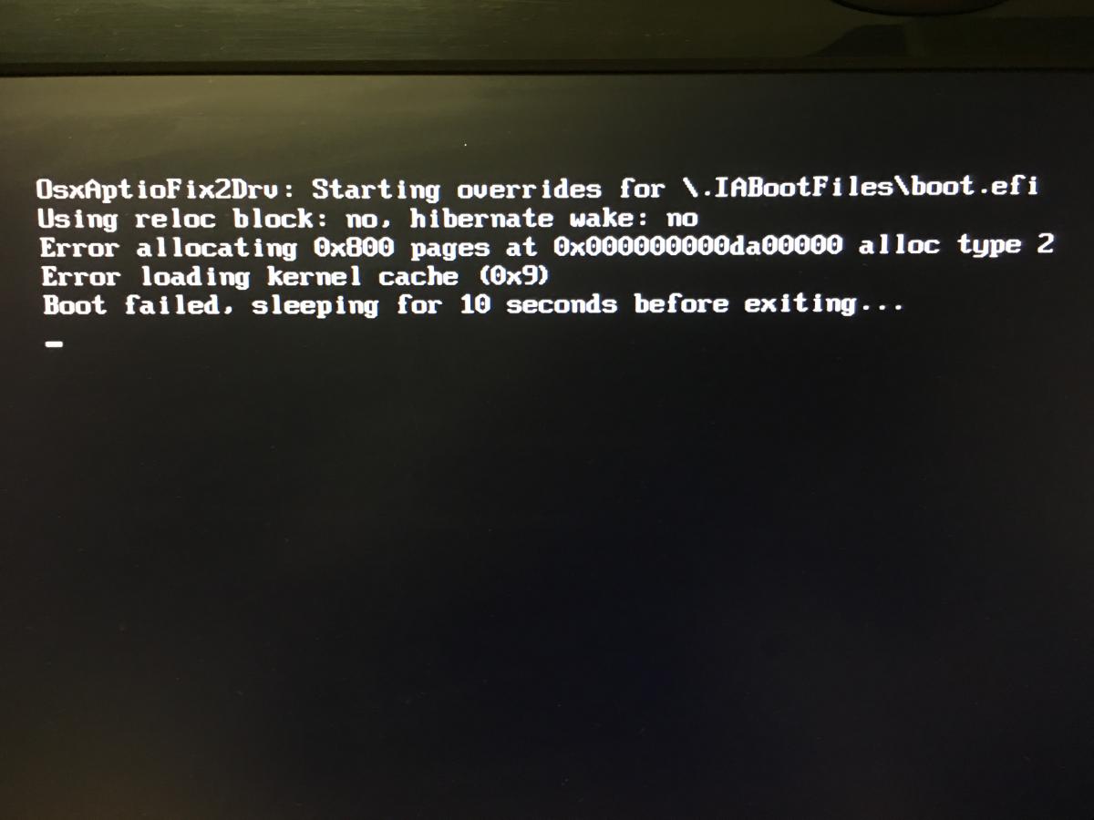

Cyberdevs Posted August 16, 2017 Share Posted August 16, 2017 Hi there The first picture is called Kernel Panic and it's usually happening when something is seriously wrong with the config.plist or other settings in the BIOS. Make sure you have SerialIO disabled in BIOS and also make sure that you have set BIOS settings correctly. The second picture is because of the bootloader which is Clover. If the boot error is happening every time you try to boot from USB/HDD with clover you can remove the OsxAptioFixDrv-64.efi and use the OsxAptioFix2Drv-64.efi. Clover EFI bootloader can be loaded from EFI partition on each USB/HDD device you can easily copy/paste the EFI folder inside any EFI partition and it will make it bootable. The folder I sent you is from my Asus P8H rig and it's set to use UEFI booting instead of Legacy booting so make sure that you have your booting options in BIOS to UEFI if you can. If you already have windows installed in legacy mode changing the boot options will affect your windows too so keep that in mind and if you are already using UEFI that's great. The AEFI folder (AsusEFI this how I name my EFI folders in my archive along with a date or a Clover build number) is working OK with both the USB installer and the installed version of the macOS if you can successfully boot into macOS installer with my EFI folder you can use it to boot into Sierra after installation as well. Getting macOS to work flawlessly on any given PC is a process with so many variables so it might take some time to get it fully working. We need to be patient in the process Let me know if you need more help 1 Link to comment https://www.insanelymac.com/forum/topic/326150-asus-p8z68v-pro-rev10-probelm-installing-sierra/#findComment-2480404 Share on other sites More sharing options...

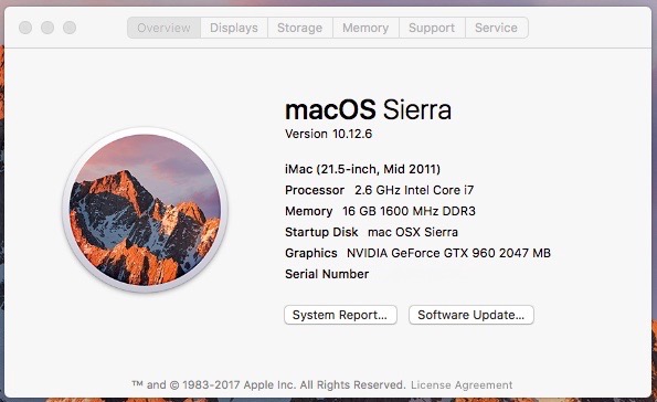

newsman1 Posted August 22, 2017 Author Share Posted August 22, 2017 this is my first post from my new hackintosh thanks to my friend cyberdevs for all the help so far I got lan to work audio is good the only problem now is the video still not working good (no acceleration) I did install the web drivers but that give me the black screen at boot. so at reboot I choose Mac OS X Sierra and I pressed the space bar and tick the Nvidia disable=1 and I also ticked use web driver and that is how I got back to Sierra but with the crappy video problem. Link to comment https://www.insanelymac.com/forum/topic/326150-asus-p8z68v-pro-rev10-probelm-installing-sierra/#findComment-2483440 Share on other sites More sharing options...
Cyberdevs Posted August 22, 2017 Share Posted August 22, 2017 this is my first post from my new hackintosh thanks to my friend cyberdevs for all the help so far I got lan to work audio is good the only problem now is the video still not working good (no acceleration) I did install the web drivers but that give me the black screen at boot. so at reboot I choose Mac OS X Sierra and I pressed the space bar and tick the Nvidia disable=1 and I also ticked use web driver and that is how I got back to Sierra but with the crappy video problem. That's great Send me your config.plist that is working and I will add a fix for your black screen issue. You can also use Lilu.kext and nVidiaGraphicsFixup.kext to avoid the black screen issue. Link to comment https://www.insanelymac.com/forum/topic/326150-asus-p8z68v-pro-rev10-probelm-installing-sierra/#findComment-2483441 Share on other sites More sharing options...

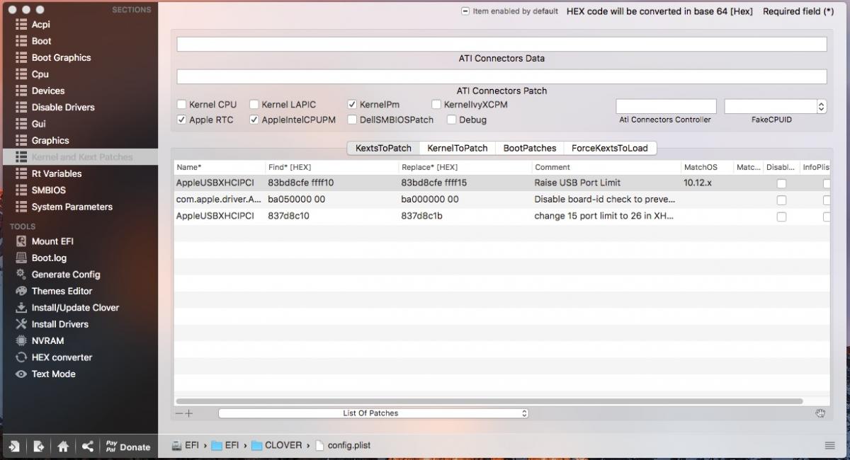

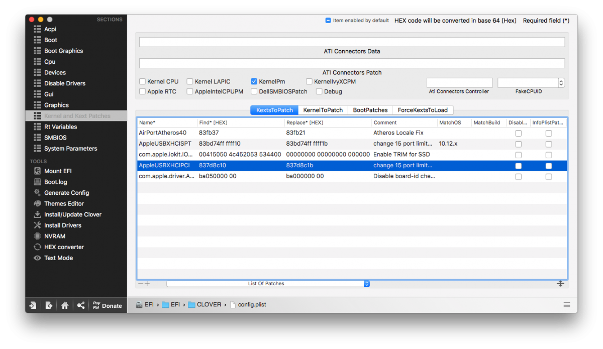

newsman1 Posted August 22, 2017 Author Share Posted August 22, 2017 ok now I did the usb 3.0 kext (USBInjectAll.kext) the same way /EFI/Clover/kexts/Other but that did not work is there is anything else that we can do to get usb 3.0 to work Link to comment https://www.insanelymac.com/forum/topic/326150-asus-p8z68v-pro-rev10-probelm-installing-sierra/#findComment-2483458 Share on other sites More sharing options...
Cyberdevs Posted August 22, 2017 Share Posted August 22, 2017 You can add these patches to your config.plist under Kernel and Kext Patches: Name: AppleUSBXHCIPCI Find: 837d8c10 Replace: 837d8c1b Comment: change 15 port limit to 26 in XHCI kext Link to comment https://www.insanelymac.com/forum/topic/326150-asus-p8z68v-pro-rev10-probelm-installing-sierra/#findComment-2483459 Share on other sites More sharing options...
newsman1 Posted August 22, 2017 Author Share Posted August 22, 2017 sorry man I had to step out for a bit I'm not sure how to add this patch because when I open config.plist is there all ready and I have been trying to use the iMessage and every contact I try it gives this message (is not registered with iMessage.) what is that mean Link to comment https://www.insanelymac.com/forum/topic/326150-asus-p8z68v-pro-rev10-probelm-installing-sierra/#findComment-2483501 Share on other sites More sharing options...
newsman1 Posted August 23, 2017 Author Share Posted August 23, 2017 Hi cyberdevs, I still could not figure out how to add the patch to get my usb 3.0 to work so this is my config.plist if you can help me with that or you explain to me how to do that and I will do, (sorry man I'm in the learning process) thanks config.plist.zip Link to comment https://www.insanelymac.com/forum/topic/326150-asus-p8z68v-pro-rev10-probelm-installing-sierra/#findComment-2484031 Share on other sites More sharing options...
