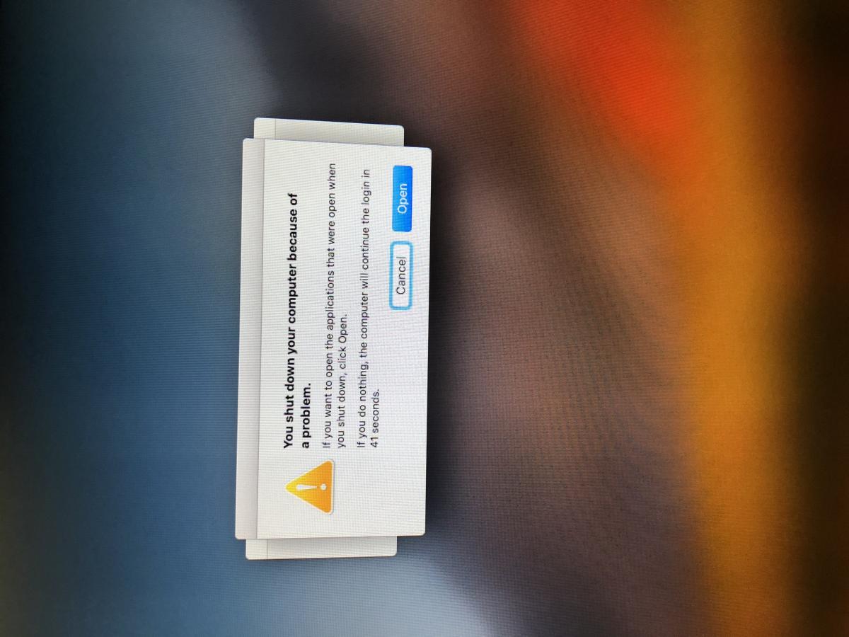

newsman1 Posted February 17, 2018 Author Share Posted February 17, 2018 that is the report restart erorr.rtf.zip 1 Link to comment https://www.insanelymac.com/forum/topic/326150-asus-p8z68v-pro-rev10-probelm-installing-sierra/page/8/#findComment-2593682 Share on other sites More sharing options...
MaLd0n Posted February 17, 2018 Share Posted February 17, 2018 problems com.paragon-software.filesystems.ntfs and com.sophos.kext.oas use Tuxera 2016.1 version, work fine in Sierra/HighSierra Link to comment https://www.insanelymac.com/forum/topic/326150-asus-p8z68v-pro-rev10-probelm-installing-sierra/page/8/#findComment-2593684 Share on other sites More sharing options...
newsman1 Posted February 17, 2018 Author Share Posted February 17, 2018 thanks man I will work on those 2 problems now I want to report to you about overall performance it is not like it used to be with old setting I had. Now everything is slow meaning when I open the mail app it takes 2-3 seconds to be open andit takes even longer to loads all my emails and now my email accounts are not working. that for for all other apps that I have and also a couple of time when I was working on my high sierra the machine just crashes and it reboots im not sure if that is relates to 2 problem you found 1 Link to comment https://www.insanelymac.com/forum/topic/326150-asus-p8z68v-pro-rev10-probelm-installing-sierra/page/8/#findComment-2593882 Share on other sites More sharing options...

newsman1 Posted February 17, 2018 Author Share Posted February 17, 2018 thanks man ok so I did a fresh install and the only I did so far is installing the Nvidia web drivers and I'm still the same restart error I'm using High Sierra 10.13.3 (17D47) Link to comment https://www.insanelymac.com/forum/topic/326150-asus-p8z68v-pro-rev10-probelm-installing-sierra/page/8/#findComment-2593955 Share on other sites More sharing options...
MaLd0n Posted February 17, 2018 Share Posted February 17, 2018 u install paragon again? the problem is paragon ntfs Link to comment https://www.insanelymac.com/forum/topic/326150-asus-p8z68v-pro-rev10-probelm-installing-sierra/page/8/#findComment-2593966 Share on other sites More sharing options...
newsman1 Posted February 17, 2018 Author Share Posted February 17, 2018 no I did not the only thing I did is install the web drivers and something is wrong with email app the main email account ISP is not connecting the only account working is the hotmail account Link to comment https://www.insanelymac.com/forum/topic/326150-asus-p8z68v-pro-rev10-probelm-installing-sierra/page/8/#findComment-2593978 Share on other sites More sharing options...
MaLd0n Posted February 17, 2018 Share Posted February 17, 2018 is a system config, u need check it about restart error, post new log without paragon and we check Link to comment https://www.insanelymac.com/forum/topic/326150-asus-p8z68v-pro-rev10-probelm-installing-sierra/page/8/#findComment-2593988 Share on other sites More sharing options...
newsman1 Posted February 17, 2018 Author Share Posted February 17, 2018 here is the new restart error file Hi Mald0n, I did download your image Olarila 10.13.2 hfs or apfs but I'm not sure how to use it please some help Untitled.rtf.zip Link to comment https://www.insanelymac.com/forum/topic/326150-asus-p8z68v-pro-rev10-probelm-installing-sierra/page/8/#findComment-2594033 Share on other sites More sharing options...

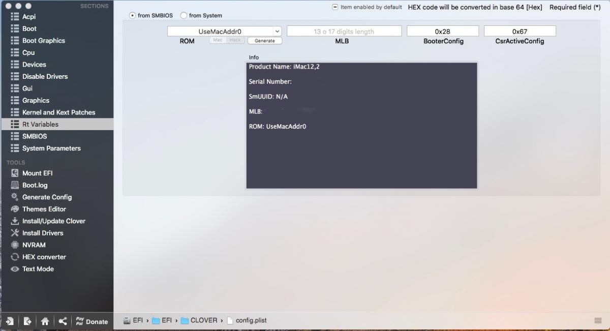

MaLd0n Posted February 17, 2018 Share Posted February 17, 2018 lol man u need use my folder, ur processor need a iMac12 smbios, u use iMac17 my folder have all u need Link to comment https://www.insanelymac.com/forum/topic/326150-asus-p8z68v-pro-rev10-probelm-installing-sierra/page/8/#findComment-2594039 Share on other sites More sharing options...
newsman1 Posted February 17, 2018 Author Share Posted February 17, 2018 thats is what I'm using I just checked it with clover configurator after I installed clover I did replace the clover folder with the one you send me and I also added the SSDT.aml you created to clover/ACPI/patched did I miss anything? Link to comment https://www.insanelymac.com/forum/topic/326150-asus-p8z68v-pro-rev10-probelm-installing-sierra/page/8/#findComment-2594053 Share on other sites More sharing options...

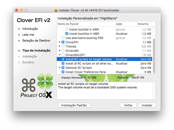

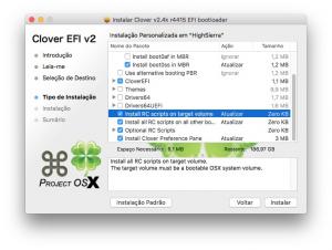

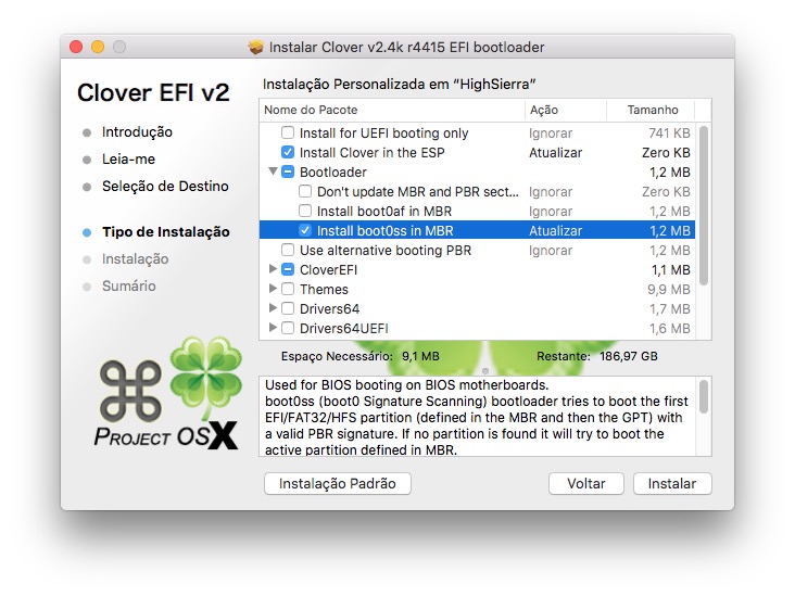

MaLd0n Posted February 17, 2018 Share Posted February 17, 2018 1- Install Clover boot loader with options 2- Replace full Clover folder http://www.insanelymac.com/forum/index.php?app=core&module=attach§ion=attach&attach_id=290911 3- Put SSDT in Clover/Acpi/Patched http://www.insanelymac.com/forum/index.php?app=core&module=attach§ion=attach&attach_id=291154 4- Install Web Driver 5- Reboot Link to comment https://www.insanelymac.com/forum/topic/326150-asus-p8z68v-pro-rev10-probelm-installing-sierra/page/8/#findComment-2594066 Share on other sites More sharing options...
newsman1 Posted February 17, 2018 Author Share Posted February 17, 2018 I did every thing you asked me step by step and it is still happening that is the new error file Untitled.rtf.zip Link to comment https://www.insanelymac.com/forum/topic/326150-asus-p8z68v-pro-rev10-probelm-installing-sierra/page/8/#findComment-2594077 Share on other sites More sharing options...

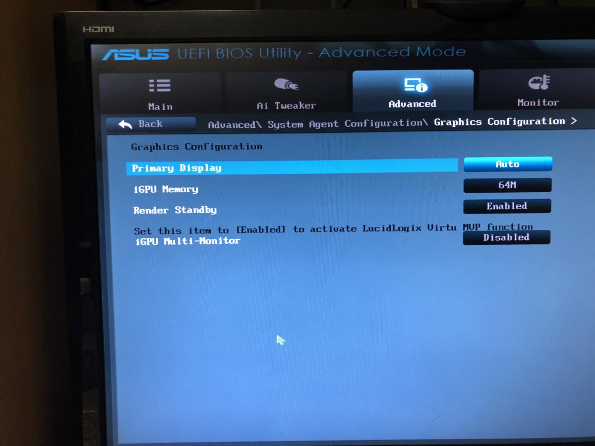

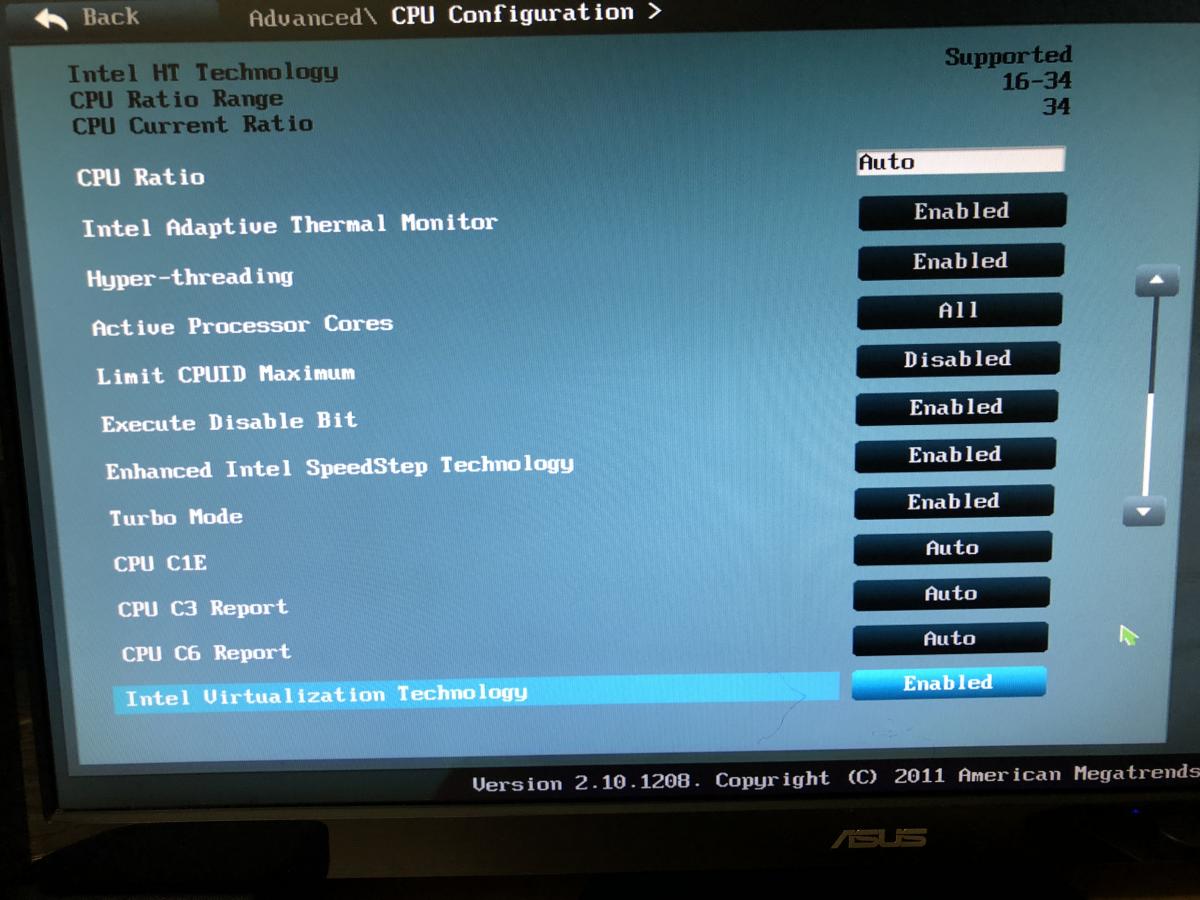

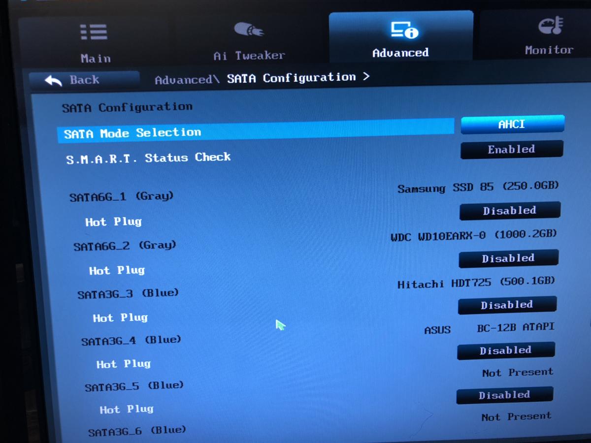

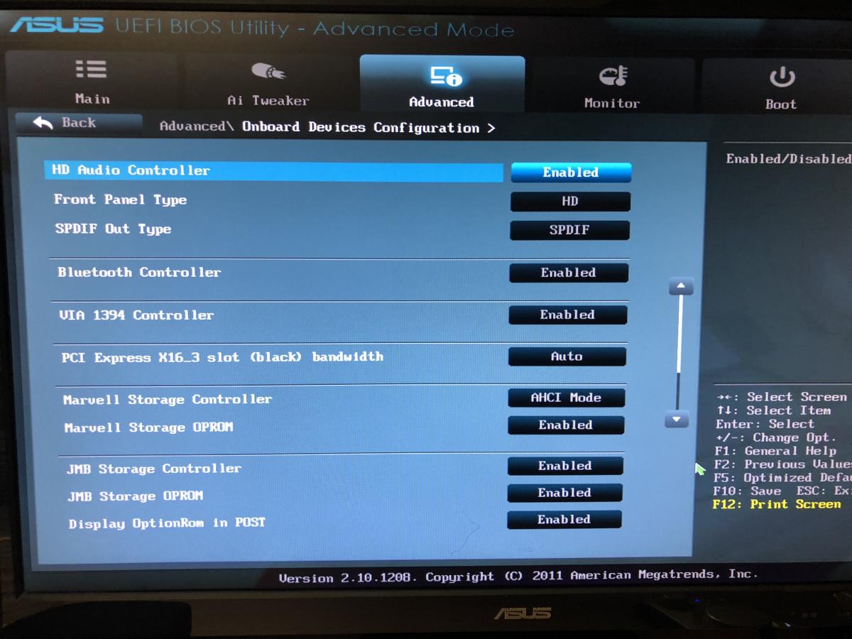

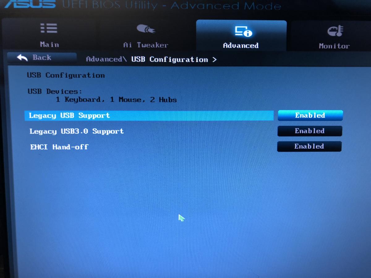

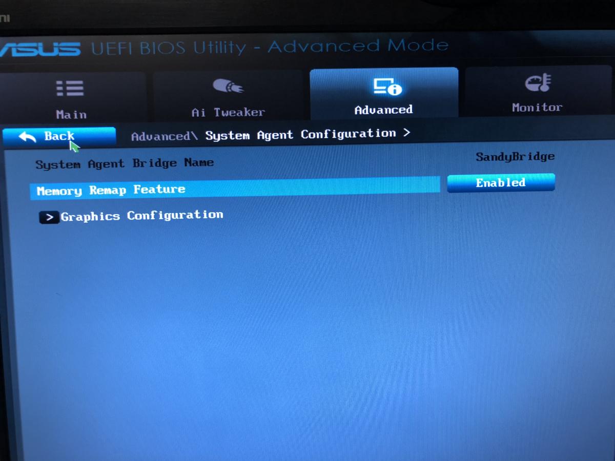

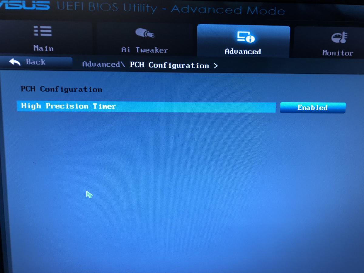

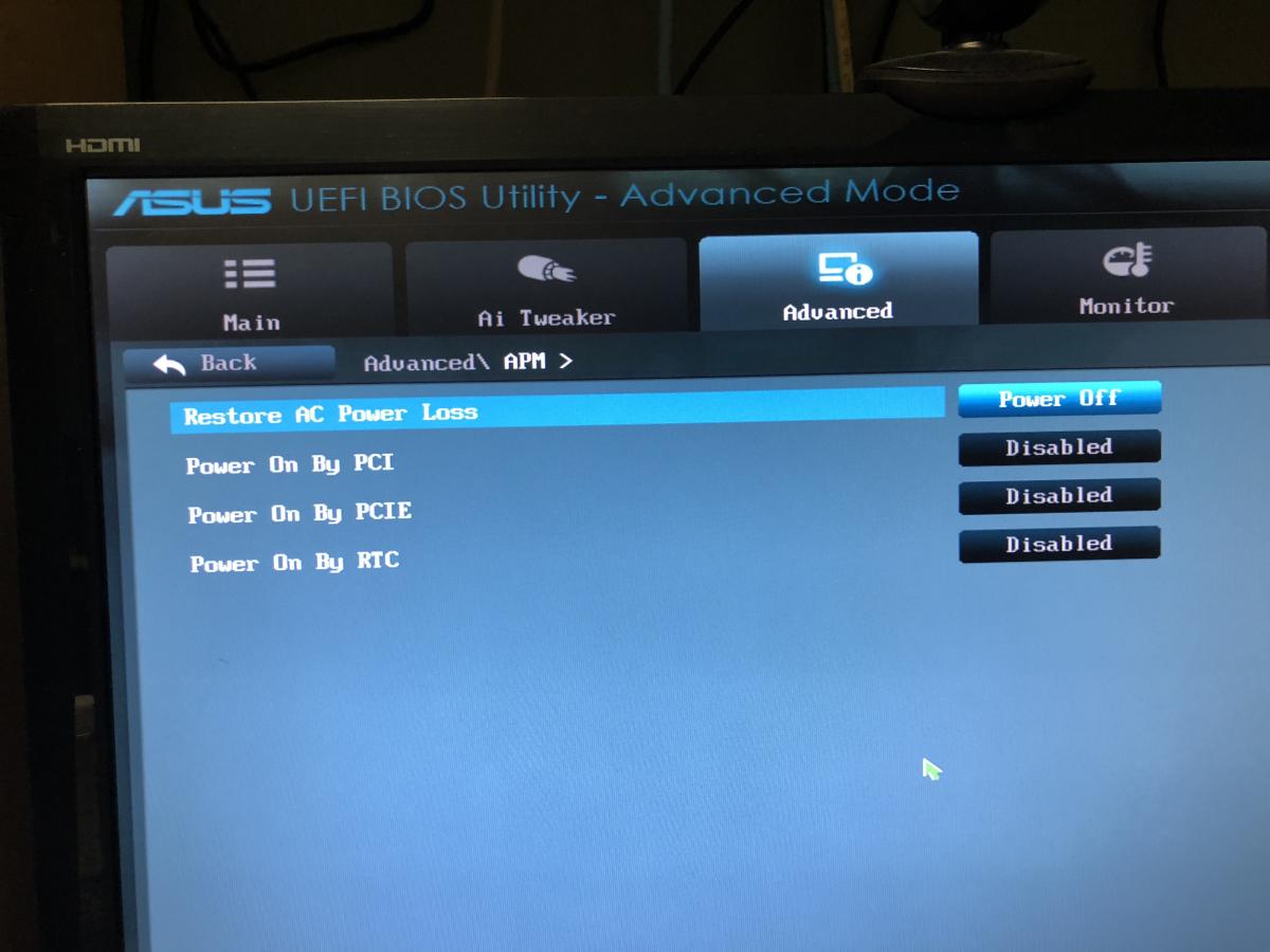

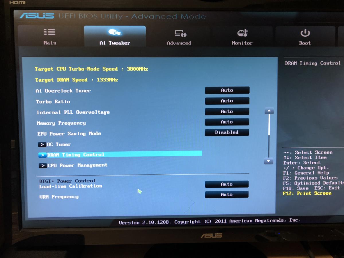

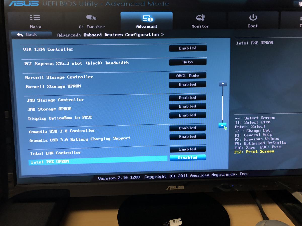

newsman1 Posted February 19, 2018 Author Share Posted February 19, 2018 Hi MaLd0n, i'll take picture of my bios setting and posted for you to see if i have anything wrong with my bios 1 Link to comment https://www.insanelymac.com/forum/topic/326150-asus-p8z68v-pro-rev10-probelm-installing-sierra/page/8/#findComment-2594908 Share on other sites More sharing options...
MaLd0n Posted February 19, 2018 Share Posted February 19, 2018 try without a genericxhci kext and check if system stay good, jst for test, without it u loose usb 3 Link to comment https://www.insanelymac.com/forum/topic/326150-asus-p8z68v-pro-rev10-probelm-installing-sierra/page/8/#findComment-2594942 Share on other sites More sharing options...
