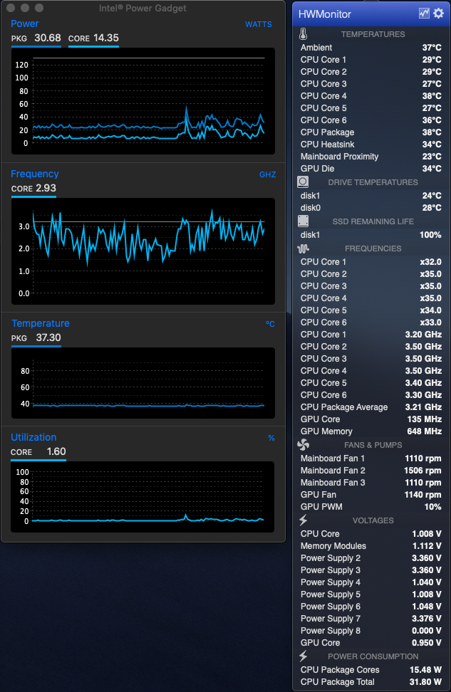

Hi!
I've placed this in S\L\E. It works in 14.2!
My 3930 has bad SpeedStep (temporary), but before this kexts - power consumption was 60-70 watts, after - 28 in idle mode. And coolers are slow down.
And by Cinebench R15 - power almost 130 watts.

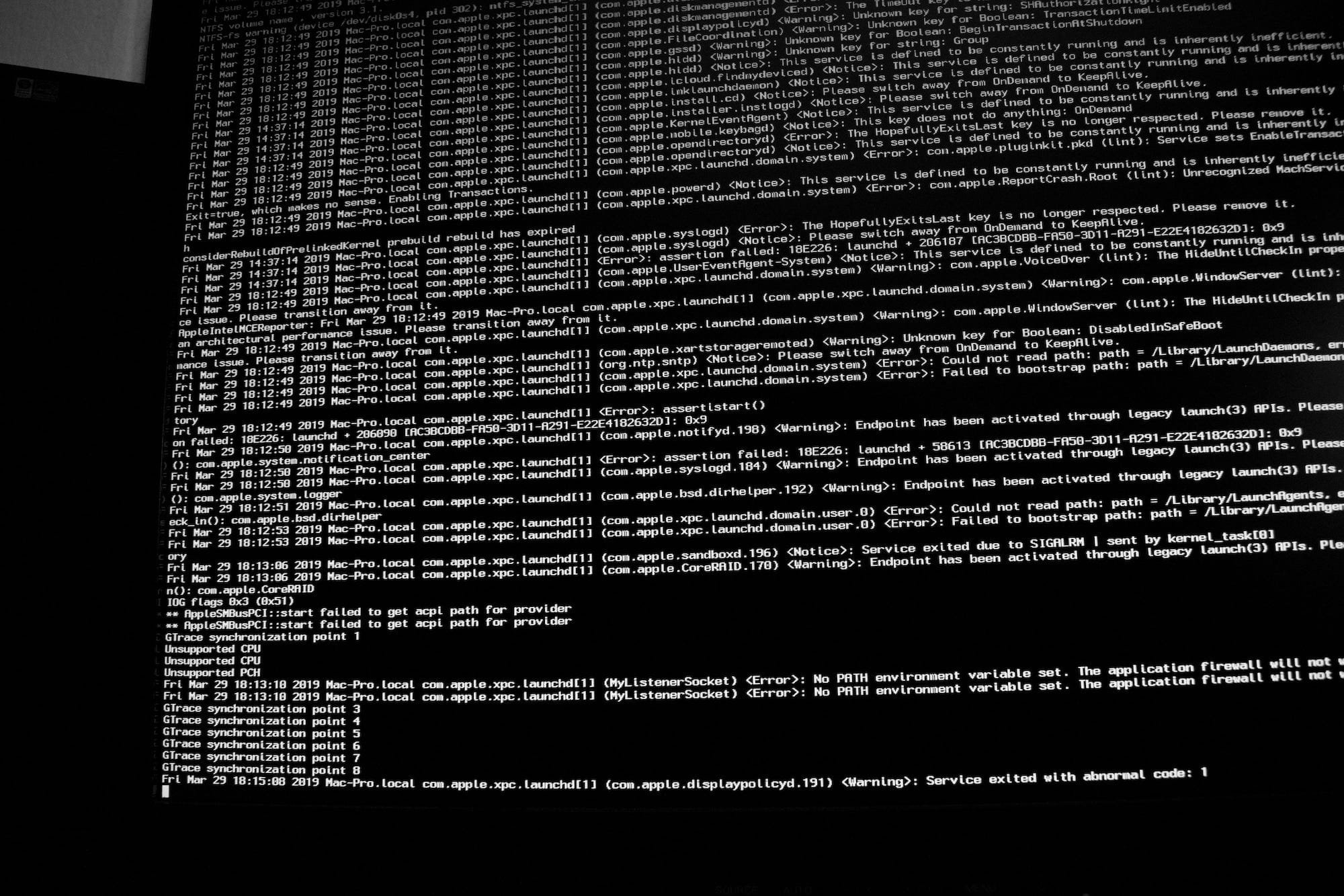

You are right, uploading clover, screenshots of L/E folder and verbose boot where it hangs.
System:
i7-3930k
GA-X79s-UP5-wiss
24GB DDR3 RAM
Sapphire RX 580 Nitro+ SE
macOS 10.14.2
Although i am not sure if it can be of any use, could you upload your clover folder to see if i can get any ideas?

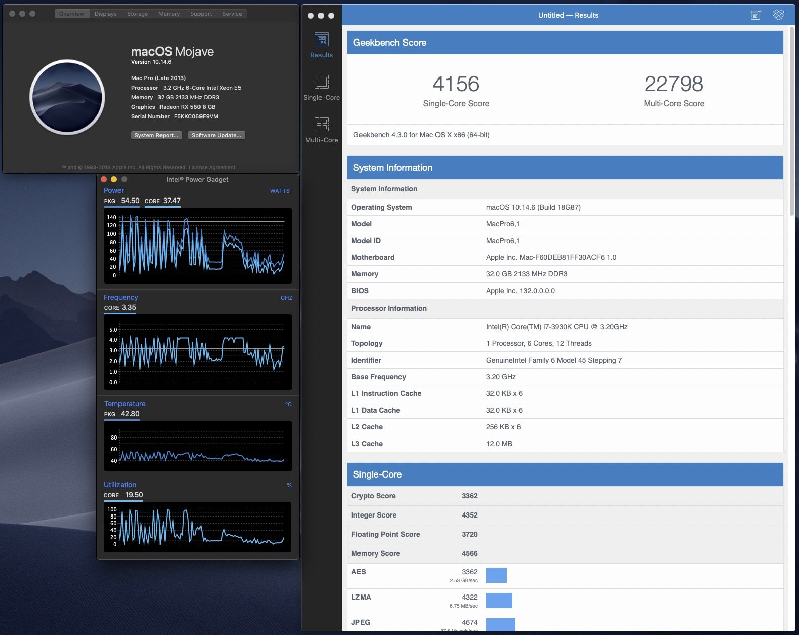

On 5/27/2019 at 12:46 AM, b0bd said:
Patches work for 10.14.5, but my Geekbench score. has dropped 12% single core, 32% multicore. ouch.

I downloaded the combo update for 14.5. and installed. All went fine but then i couldn't boot because of continuous panics. As far as i could understand it is a CPU power management thing but i wasn't sure. Since in your case the patches (and the kext i guess) work, this is good news. Could you share your steps (if any) before updating and which method did you use to update?(app store, update or combo update)
cheers
On 5/28/2019 at 8:21 AM, pduke said:
i am currently on 10.4.4. All works fine.
I had this too, due to a "can't set p-limit" error. If you're seeing this, and you're using a generated SSDT, you need to remove the DSM method from the SSDT. 10.14.5 is crankier.  Or generate a new one with ssdtPRGen.sh -x 0

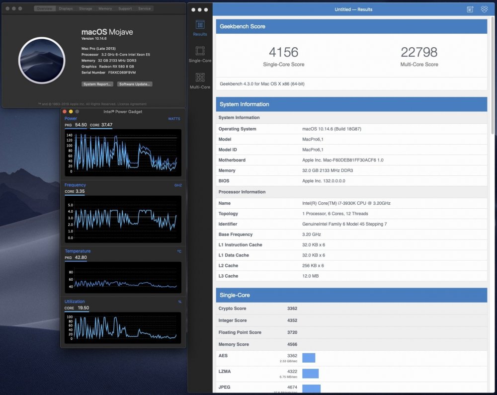

Guys, i managed to get passed my 1680 v2 panic and got it working using a DSDT made for a 2687W v2.
Strange thing is that power management seems to work fine, without using AppleIntelCPUPowerManagement.kext or nullcpumanagement.kext. I also haven't setup the patches from this topic.
Should i use the kext( AppleIntelCPUPowerManagement.kext) and the patches ?
is there a way to check if it is working better with or without?
