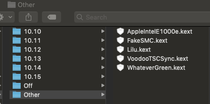

@stinga11 Thank you for your work on this!
I've got an old X79 board (GA-X79-UD3 Rev 1.0) with a Xeon E5-2620 Sandy Bridge.
I've been having all kinds of issues getting the power management to work on Mojave 10.14.6.  I still can only boot using cpus=1 flag.  I think part of the issue is the MSR 0xE2 bit 15 lock (which I'm not sure how to resolve - tried including the Clover patches listed here, with no apparent luck).
I've been using the SSDT from RampageDev's old website (now gone).
I seem to recall that you had some success with this same board many years ago - were you ever able to get power management working on the Gigabyte X79-UD3?
Here are my specs:
GA-X79-UD3 Rev 1.0  Bios F20
Xeon E5-2620 @ 2GHz (6 cores) - Sandy Bridge
24GB RAM DDR3
AMD Radeon RX 560
MacOS 10.14.6 (on one CPU core)
@stinga11
Nevermind - looks like I just had to get everything set correctly in the config.plist.
I added the MSR lock fix patches from here (credit J Lamp).
Then I added your patches from above for Mojave.
Inserted VoodooTSCSync.kext for my 6-core Sandy Bridge into CLOVER - Kexts - Other
Rebooted, and wow, way faster performance.  Thanks to everyone who has helped research & optimize the X79 mobos!
Here's what I'm using on my GA-X79-UD3 Rev 1.0 with F20 Bios:
Kext Other folder:
SSDTs and original config.plist credit RampageDev
config.plist
SSDT.aml
SSDT-1.aml
My next challenge is to upgrade to Catalina.  Will report back on that soon.
Thanks again, all!
Edited by dujones
