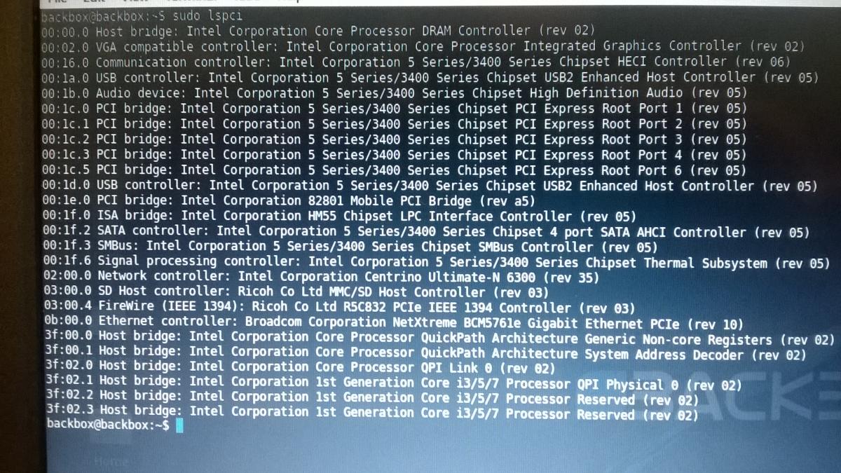

rage75 Posted March 13, 2017 Share Posted March 13, 2017 Buongiorno, cpme già accennato ho per le mani un Dell Latitude e5410 con le seguenti caratteristiche: Intel core i5 M560 2,67 Ghz Board Dell 00K2MH Intel 5 3400 Monitor 1440x900 HD Graphics 40 Hz Tastiera PS2 Standard Touchpad Dell rete Intel centrino Ultimate N6300 AGN ethernet Broadcomm netXtreme BCM5761e Firewire Ricoh rc5832 PCIe1394 Audio Intel HD Ho ancora la chiavetta con Sierra preparata per questo notebook se può essere utile http://www.insanelymac.com/forum/topic/317769-installazione-sierra-su-asus-k56cb/ Penso ci sia tutto, aspetto vostre considerazione, grazie. Link to comment https://www.insanelymac.com/forum/topic/321831-sierra-su-dell-latitude-e5410/ Share on other sites More sharing options...

rage75 Posted March 13, 2017 Author Share Posted March 13, 2017 Le info le ho prese da una live di Linux, processore i5 M560 Link to comment https://www.insanelymac.com/forum/topic/321831-sierra-su-dell-latitude-e5410/#findComment-2383619 Share on other sites More sharing options...
Jolly Posted March 13, 2017 Share Posted March 13, 2017 E quel Intel 5 3400? Grafica ? Link to comment https://www.insanelymac.com/forum/topic/321831-sierra-su-dell-latitude-e5410/#findComment-2383626 Share on other sites More sharing options...
rage75 Posted March 13, 2017 Author Share Posted March 13, 2017 dando sudo lspci appare un po dappertutto, quindo l'ho scritto non sapevo se era utile o meno, non trovo altre notizie sulla grafica Link to comment https://www.insanelymac.com/forum/topic/321831-sierra-su-dell-latitude-e5410/#findComment-2383628 Share on other sites More sharing options...
rage75 Posted March 13, 2017 Author Share Posted March 13, 2017 Ecco qua se riesci a capire, come vedi é dovunque. Link to comment https://www.insanelymac.com/forum/topic/321831-sierra-su-dell-latitude-e5410/#findComment-2383656 Share on other sites More sharing options...
Jolly Posted March 13, 2017 Share Posted March 13, 2017 Meglio tu dia una occhiata qua riguardo l'installazione: http://www.insanelymac.com/forum/topic/286092-guide-1st-generation-intel-hd-graphics-qeci/ Link to comment https://www.insanelymac.com/forum/topic/321831-sierra-su-dell-latitude-e5410/#findComment-2383673 Share on other sites More sharing options...
