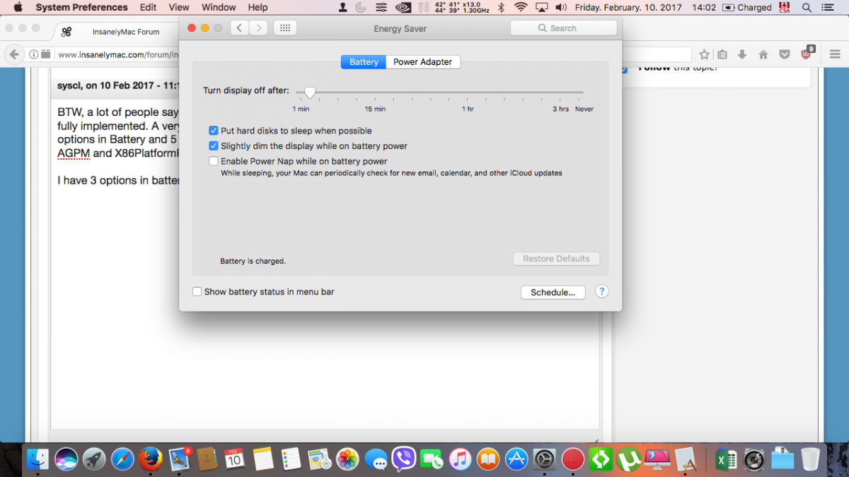

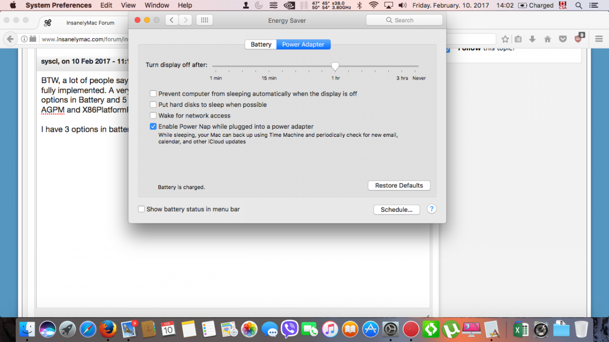

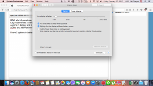

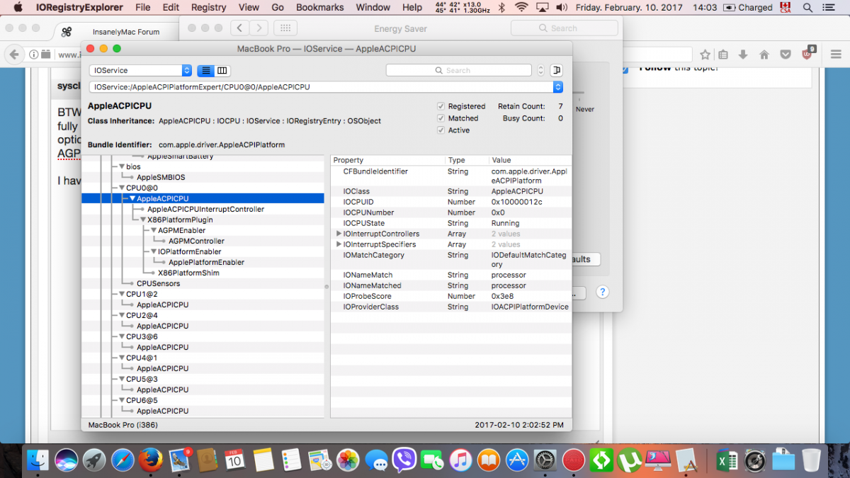

slayer2333 Posted February 10, 2017 Share Posted February 10, 2017 BTW, a lot of people say that they have HWP enable, but they ignore whether their power management is fully implemented. A very simple/useful way is open System Preferences -> Energy Saver to see if there's 3 options in Battery and 5 options in Power Adapter. More accurate way you need to open ioreg to search AGPM and X86PlatformPlugin, use kextstat to list all cpu/gpu relate kexts. I have 3 options in battery and 4 in Power adapter (what is the 5th option supposed to be ? Maybe depends on the hardware ) ? Link to comment https://www.insanelymac.com/forum/topic/321021-guide-hwpintel-speed-shift-enable-with-full-power-management/page/2/#findComment-2366054 Share on other sites More sharing options...
syscl Posted February 10, 2017 Author Share Posted February 10, 2017 BTW, a lot of people say that they have HWP enable, but they ignore whether their power management is fully implemented. A very simple/useful way is open System Preferences -> Energy Saver to see if there's 3 options in Battery and 5 options in Power Adapter. More accurate way you need to open ioreg to search AGPM and X86PlatformPlugin, use kextstat to list all cpu/gpu relate kexts. I have 3 options in battery and 4 in Power adapter (what is the 5th option supposed to be ? Maybe depends on the hardware ) ? Screen Shot 2017-02-10 at 2.02.39 PM.png Screen Shot 2017-02-10 at 2.02.44 PM.png Screen Shot 2017-02-10 at 2.03.00 PM.png Sorry, my typo, should be 4 options. Thank you for remind, I corrected it. syscl Link to comment https://www.insanelymac.com/forum/topic/321021-guide-hwpintel-speed-shift-enable-with-full-power-management/page/2/#findComment-2366136 Share on other sites More sharing options...

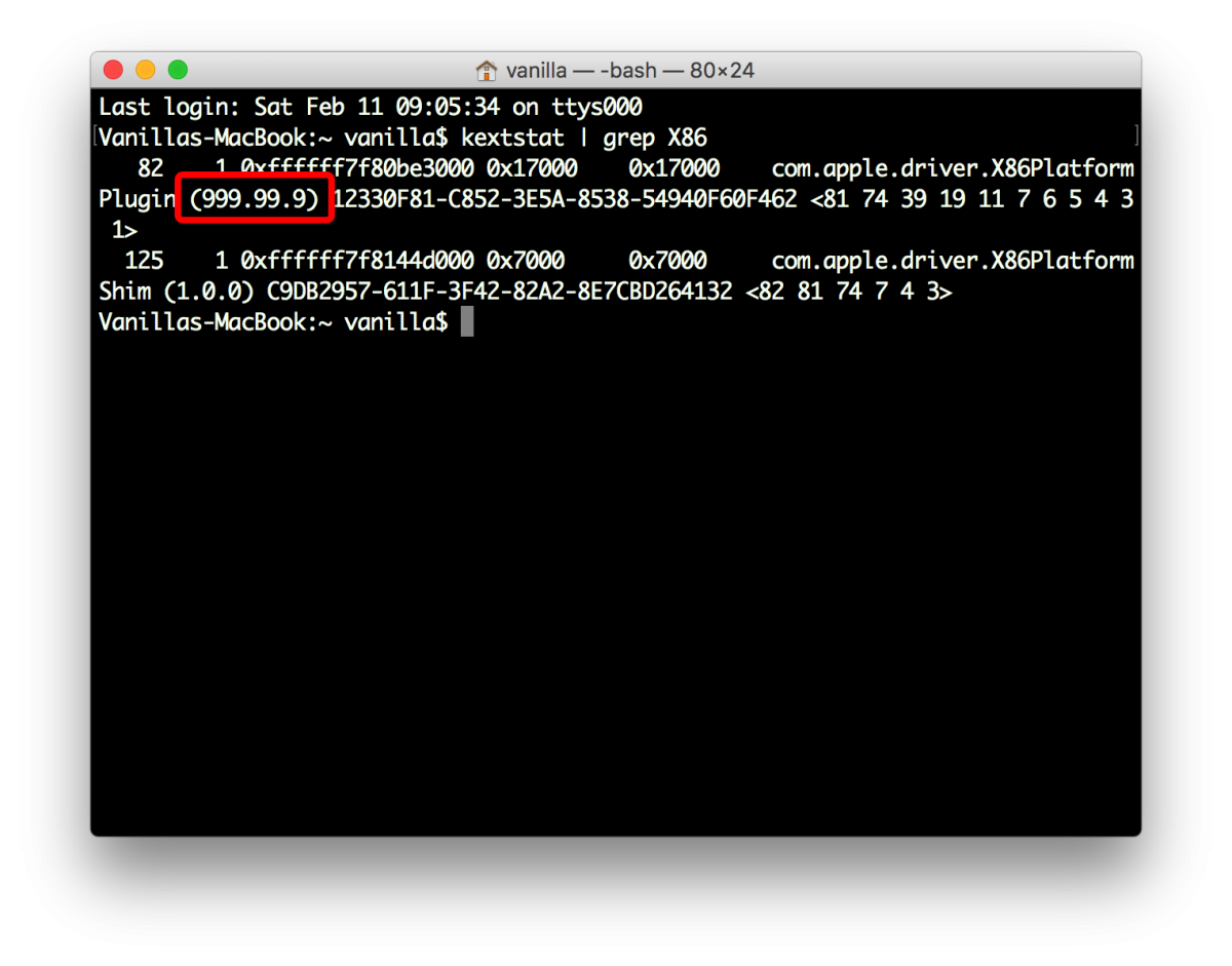

dpassmor Posted February 11, 2017 Share Posted February 11, 2017 Use Clover to active HWP, not the kext. syscl A couple of notes; You no longer have to use Clover or HWPEnabler to enable HWP. If X86PlatformPlugin is loaded with a model identifier that supports HWP (MacBook9,1, MacBookPro13,x) the OS will enable HWP, and keep it enabled after sleep. Not only that, but the OS will dynamically manipulate the HWP request values depending on load and whether the system is on AC or battery. Also, I don't believe it is necessary to use a full SSDT generated by ssdtPRGen, it should be sufficient to use one that just sets the plugin-type property on CPU0: // inject plugin-type on CPU0 to enable GPU power management DefinitionBlock ("ssdt_pr.aml", "SSDT", 1, "APPLE ", "CpuPm", 0x00006500) { External (\_PR_.CPU0, DeviceObj) External (DTGP, MethodObj) Scope (\_PR_.CPU0) { Method (_DSM, 4, NotSerialized) // _DSM: Device-Specific Method { Debug = "Writing plugin-type to Registry!" Local0 = Package (0x02) { "plugin-type", One } DTGP (Arg0, Arg1, Arg2, Arg3, RefOf (Local0)) Return (Local0) } } } 4 Link to comment https://www.insanelymac.com/forum/topic/321021-guide-hwpintel-speed-shift-enable-with-full-power-management/page/2/#findComment-2366178 Share on other sites More sharing options...
PMheart Posted February 11, 2017 Share Posted February 11, 2017 (edited) A couple of notes; You no longer have to use Clover or HWPEnabler to enable HWP. If X86PlatformPlugin is loaded with a model identifier that supports HWP (MacBook9,1, MacBookPro13,x) the OS will enable HWP, and keep it enabled after sleep. Not only that, but the OS will dynamically manipulate the HWP request values depending on load and whether the system is on AC or battery. Also, I don't believe it is necessary to use a full SSDT generated by ssdtPRGen, it should be sufficient to use one that just sets the plugin-type property on CPU0: // inject plugin-type on CPU0 to enable GPU power management DefinitionBlock ("ssdt_pr.aml", "SSDT", 1, "APPLE ", "CpuPm", 0x00006500) { External (\_PR_.CPU0, DeviceObj) External (DTGP, MethodObj) Scope (\_PR_.CPU0) { Method (_DSM, 4, NotSerialized) // _DSM: Device-Specific Method { Debug = "Writing plugin-type to Registry!" Local0 = Package (0x02) { "plugin-type", One } DTGP (Arg0, Arg1, Arg2, Arg3, RefOf (Local0)) Return (Local0) } } } Have you ever tested your theory? Only add 'plugin-type' == '1' is not enough. At least. X86* will not load. I tested it previously. (Similar to your tiny SSDT, but I used Clover's PluginType and set that to 1.) No. X86* not loaded. You still have to inject APSS, ACST, etc. Otherwise X86* won't load. That's truth. This could be a bug in X86 but anyway. The truth is here. [EDIT] No. For Skylake with HWP enabled in FrequencyVectors we don't need APSS, ACST anymore. Thanks to dpassmor! tluck, you can use this to judge if your HWP is enable or not. Note: you need to remove this kext and rebuild kernel cache before you reboot, otherwise this kext will cause your system panic. syscl Hi @Drfrag, I am pretty sure we need. Actually, once I received my XPS 13 9350 in Nov. 2016, I soon found the HWP power management is incomplete. See the log from my maclog here: 2016-11-23 18:06:07.281075-0600 localhost kernel[0]: (IOPlatformPluginFamily) <IOPlatformPluginFamily`DebugPrint> WARNING: IOPlatformPluginUtil : getCPUIDInfo: this is an unknown CPU model 0x4e -- power management may be incomplete or unsupported Due to the fact cpu power management was incomplete, AGPM(Apple Graphics Power Management) was not implemented either. Usually, laptop manufactures will protect MSR 0xE2(read only) which wmrsr64 would write value on it to cause kernel panic. If you are lucky enough to unlock MSR 0xE2 lock like Dell Precision M3800 or XPS 9530, then you may not need this kernel patch. BTW, a lot of people say that they have HWP enable, but they ignore whether their power management is fully implemented. A very simple/useful way is open System Preferences -> Energy Saver to see if there's 3 options in Battery and 5 4 options in Power Adapter. More accurate way you need to open ioreg to search AGPM and X86PlatformPlugin, use kextstat to list all cpu/gpu relate kexts. Tune frequency vectors is optional, only when you need more ideal situation then you can tune it to fit your CPU/GPU. I will post injector method latter(which @Sherlocks has proven worked well using my modified version of X86PlatformPlugin.kext like a dummy AppleHDA). syscl The dummy X86PlatformPlugin will work. I can confirm it here as well. Edited February 11, 2017 by PMheart Link to comment https://www.insanelymac.com/forum/topic/321021-guide-hwpintel-speed-shift-enable-with-full-power-management/page/2/#findComment-2366187 Share on other sites More sharing options...
dpassmor Posted February 11, 2017 Share Posted February 11, 2017 Have you ever tested your theory? Only add 'plugin-type' == '1' is not enough. At least. X86* will not load. I tested it previously. (Similar to your tiny SSDT, but I used Clover's PluginType and set that to 1.) No. X86* not loaded. You still have to inject APSS, ACST, etc. Otherwise X86* won't load. That's truth. This could be a bug in X86 but anyway. The truth is here. Yeah, I'm testing it as we speak, and have been for several days. All that's necessary is plugin-type. bash-3.2# cd /Volumes/EFI/EFI/CLOVER/ACPI/patched/ bash-3.2# iasl SSDT-PR.aml Intel ACPI Component Architecture ASL+ Optimizing Compiler version 20161210-64(RM) Copyright (c) 2000 - 2016 Intel Corporation Binary file appears to be a valid ACPI table, disassembling Input file SSDT-PR.aml, Length 0x95 (149) bytes ACPI: SSDT 0x0000000000000000 000095 (v01 APPLE CpuPm 00006500 INTL 20160422) Pass 1 parse of [SSDT] Pass 2 parse of [SSDT] Parsing Deferred Opcodes (Methods/Buffers/Packages/Regions) Parsing completed Found 1 external control methods, reparsing with new information Pass 1 parse of [SSDT] Pass 2 parse of [SSDT] Parsing Deferred Opcodes (Methods/Buffers/Packages/Regions) Parsing completed Disassembly completed ASL Output: SSDT-PR.dsl - 1180 bytes bash-3.2# cat SSDT-PR.dsl /* * Intel ACPI Component Architecture * AML/ASL+ Disassembler version 20161210-64(RM) * Copyright (c) 2000 - 2016 Intel Corporation * * Disassembling to symbolic ASL+ operators * * Disassembly of SSDT-PR.aml, Fri Feb 10 20:26:13 2017 * * Original Table Header: * Signature "SSDT" * Length 0x00000095 (149) * Revision 0x01 * Checksum 0xE1 * OEM ID "APPLE " * OEM Table ID "CpuPm" * OEM Revision 0x00006500 (25856) * Compiler ID "INTL" * Compiler Version 0x20160422 (538313762) */ DefinitionBlock ("", "SSDT", 1, "APPLE ", "CpuPm", 0x00006500) { External (_PR_.CPU0, DeviceObj) // (from opcode) External (DTGP, MethodObj) // 5 Arguments (from opcode) Scope (\_PR.CPU0) { Method (_DSM, 4, NotSerialized) // _DSM: Device-Specific Method { Debug = "Writing plugin-type to Registry!" Local0 = Package (0x02) { "plugin-type", One } DTGP (Arg0, Arg1, Arg2, Arg3, RefOf (Local0)) Return (Local0) } } } Link to comment https://www.insanelymac.com/forum/topic/321021-guide-hwpintel-speed-shift-enable-with-full-power-management/page/2/#findComment-2366190 Share on other sites More sharing options...
PMheart Posted February 11, 2017 Share Posted February 11, 2017 (edited) Yeah, I'm testing it as we speak, and have been for several days. All that's necessary is plugin-type. bash-3.2# cd /Volumes/EFI/EFI/CLOVER/ACPI/patched/ bash-3.2# iasl SSDT-PR.aml Intel ACPI Component Architecture ASL+ Optimizing Compiler version 20161210-64(RM) Copyright (c) 2000 - 2016 Intel Corporation Binary file appears to be a valid ACPI table, disassembling Input file SSDT-PR.aml, Length 0x95 (149) bytes ACPI: SSDT 0x0000000000000000 000095 (v01 APPLE CpuPm 00006500 INTL 20160422) Pass 1 parse of [SSDT] Pass 2 parse of [SSDT] Parsing Deferred Opcodes (Methods/Buffers/Packages/Regions) Parsing completed Found 1 external control methods, reparsing with new information Pass 1 parse of [SSDT] Pass 2 parse of [SSDT] Parsing Deferred Opcodes (Methods/Buffers/Packages/Regions) Parsing completed Disassembly completed ASL Output: SSDT-PR.dsl - 1180 bytes bash-3.2# cat SSDT-PR.dsl /* * Intel ACPI Component Architecture * AML/ASL+ Disassembler version 20161210-64(RM) * Copyright (c) 2000 - 2016 Intel Corporation * * Disassembling to symbolic ASL+ operators * * Disassembly of SSDT-PR.aml, Fri Feb 10 20:26:13 2017 * * Original Table Header: * Signature "SSDT" * Length 0x00000095 (149) * Revision 0x01 * Checksum 0xE1 * OEM ID "APPLE " * OEM Table ID "CpuPm" * OEM Revision 0x00006500 (25856) * Compiler ID "INTL" * Compiler Version 0x20160422 (538313762) */ DefinitionBlock ("", "SSDT", 1, "APPLE ", "CpuPm", 0x00006500) { External (_PR_.CPU0, DeviceObj) // (from opcode) External (DTGP, MethodObj) // 5 Arguments (from opcode) Scope (\_PR.CPU0) { Method (_DSM, 4, NotSerialized) // _DSM: Device-Specific Method { Debug = "Writing plugin-type to Registry!" Local0 = Package (0x02) { "plugin-type", One } DTGP (Arg0, Arg1, Arg2, Arg3, RefOf (Local0)) Return (Local0) } } } I see... But weird. For me the APSS, ACST are still needed. Or (Only injecting plugin-type == 1) X86* won't load... [EDIT] I guessed that that bug had been fixed. Fabulous. Or for Skylake with HWP we don't need the redundant APSS, ACST, that's all HWP can do... In any case, I think APSS ACST are still needed for the older platforms. Edited February 11, 2017 by PMheart Link to comment https://www.insanelymac.com/forum/topic/321021-guide-hwpintel-speed-shift-enable-with-full-power-management/page/2/#findComment-2366195 Share on other sites More sharing options...
dpassmor Posted February 11, 2017 Share Posted February 11, 2017 I see... But weird. For me the APSS, ACST are still needed. Or (Only injecting plugin-type == 1) X86* won't load... Try my SSDT. The Clover PluginType option doesn't do anything, as far as I can tell. Link to comment https://www.insanelymac.com/forum/topic/321021-guide-hwpintel-speed-shift-enable-with-full-power-management/page/2/#findComment-2366196 Share on other sites More sharing options...
PMheart Posted February 11, 2017 Share Posted February 11, 2017 (edited) Try my SSDT. The Clover PluginType option doesn't do anything, as far as I can tell. Sorry I forgot to tell. I also tested a tiny SSDT at that time but without calling DTGP(). But I don't think it's actually related to that. BTW also check my edit at #33 [EDIT] DefinitionBlock ("", "SSDT", 1, "APPLE ", "CpuPm", 0x00021400) { External (_PR_.CPU0, DeviceObj) Scope (\_PR.CPU0) { Method (_DSM, 4, NotSerialized) { If (LEqual (Arg2, Zero)) { Return (Buffer (One) { 0x03 }) } Return (Package (0x02) { "plugin-type", One }) } } } This is the tiny SSDT I used in the past. Which made no difference. X86* won't load for my Ivy Bridge hack. For Skylake with HWP enabled we just need this tiny SSDT! Fabulous. Edited February 11, 2017 by PMheart 1 Link to comment https://www.insanelymac.com/forum/topic/321021-guide-hwpintel-speed-shift-enable-with-full-power-management/page/2/#findComment-2366199 Share on other sites More sharing options...
